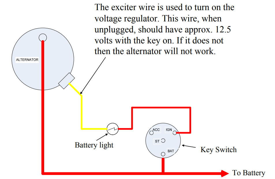

Not a good idea to pull the positive while the engine it running. If by chance the alternator is working and you don't have a battery, you can over-voltage your entire system. While that may not be true on this particular vehicle, that is general knowledge for all vehicles. The battery can act as a regulator and without it, voltage can go all over the place damaging electronics.
I think you found the problem, or are at least on the right track. The exciter wire to the alternator should have 12v on it.

looks like you are on the right track with the diagram help.

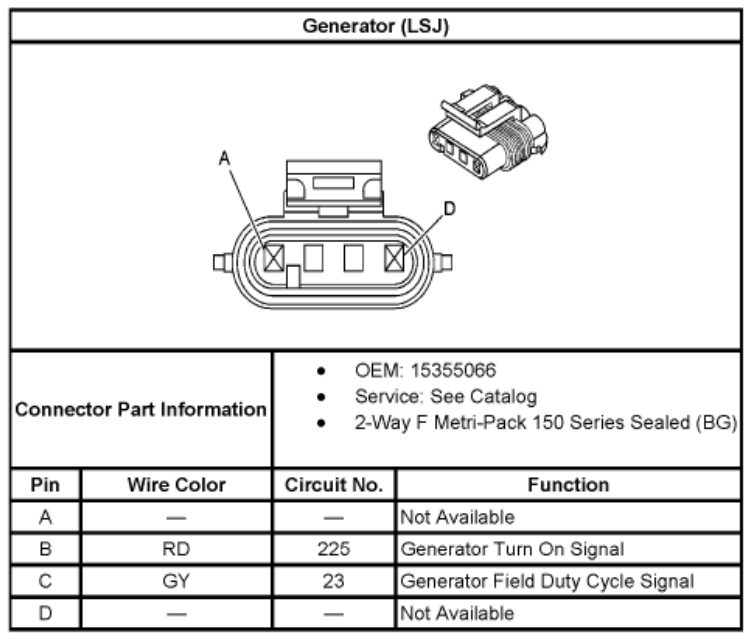

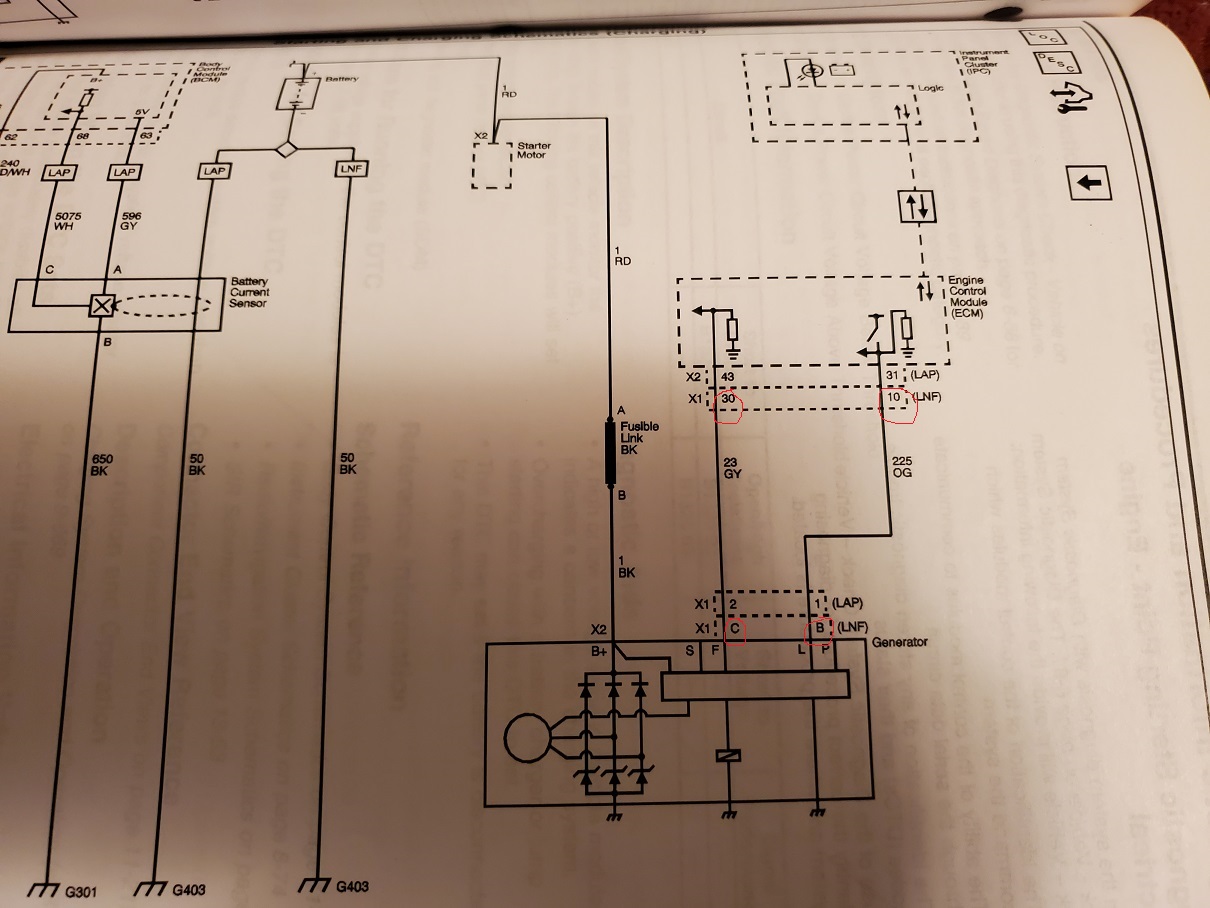

According to Chad's diagram, it may be in the connection between the key switch and the exciter/trigger wire that goes to the alternator. Does anyone have a pin diagram with that info? I tried to do a continuity test on pin 10 and pin 30 on both black multi-plugs that go to the ecm with the two wire connector plugged into the alternator and ignition on but motor not running. I used a sewing needle to stick into the plug so I'm not sure if I was making good contact or not. I'm not sure what else to do except try the same thing with the ignition switch wires once I know which pins to test. As a side note, I'm terrible at wiring, it's all voodoo magic to me.
The diagram that Chad posted is more of a logical diagram than a physical one. There is no direct connection between the alternator and the key switch. The battery light on logic originates in the ECM, and then travels over the low speed GMLAN network to your gauge cluster.
Like what others mentioned, this is a super easy circuit to troubleshoot.
Unplug your generator connector and measure continuity from the gray wire on the connector over to pin 30 on the bigger ECM connector. Do the same thing for the orange wire, but over to pin 10 on the same connector. Those two end points are just straight wires so they should read <5 ohms regardless of key position.
Also check the fusible link that sits between your starter and alternator.
That’s on the big main wire. You need to look at the smaller wires on the side connector.
edit
well if you have 14v when running at that terminal at the alt and 12v or less at the starter connection, then you have a fusible link problem.
odds are it’s a 12v trigger feed problem.

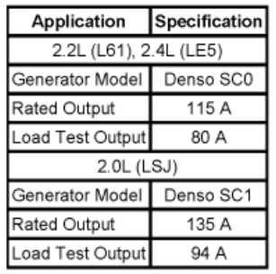

My LSJ just turned on the red battery light on the dash, and the alternator is making a squealing noise.
The used-auto-parts-yard have $27 alternators for the normal Cobalt, but don't have my SC LSJ engine's alternator.
Looking at the form factor, the two alternators look the same, physically, but the LSJ one has a different electrical plug.
I am tempted to buy the basic alternator, and the normal Cobalt electrical plug, and solder it into my engine harness... I really don't need the rare 135A alternator. Will this work? I don't have the connector/electrical view for the normal Cobalt alternator.

It should work, lsj spins counter clockwise and is a clutched alternator. The 2.2 spins clockwise but isn't clutched so it should be able to charge Either way it spins. Lsj-t's use the setup off of non supercharged ecotecs since there is no longer a S/C. One thing that may differ could be the alternator bracket though since you will need to keep the lsj one since the tensioner set up bolts to it also.
