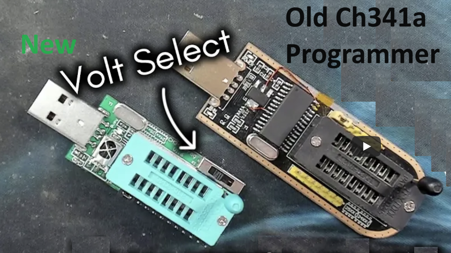

I see they have made a better chip programmer that you can set to 5V rather than modding the old CH341A programming board.
44165
I can find it on AliExpress for $12 and Ebay for $16, but it hasn't made it way to Amazon yet.
Search for: "Ch341A Programmer V1.7 1.8V Level Shift"

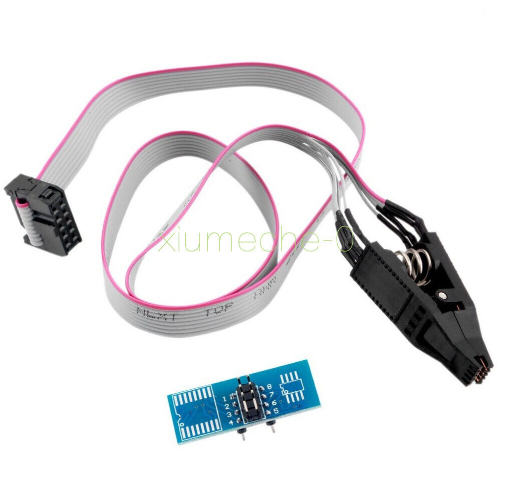

I can't find anyone selling the new board with the chip clip, so you will want to buy this too:
"Soic8 Sop8 Flash Chip IC Test Clips board Adapter Bios/24/25/93 Programmer"

Since I have already purchased the old CH341A, I'm going to try this modification to get it 5V.
Once you have a 5V CH341A programmer, and a chip clip, you can follow this video, but you don't have to unsolder the ST95080 chip from the BCM. The 5V should be enough power to program the chip on the BCM motherboard. If you have the old 3.3V programmer, you need to remove the chip from the BCM.

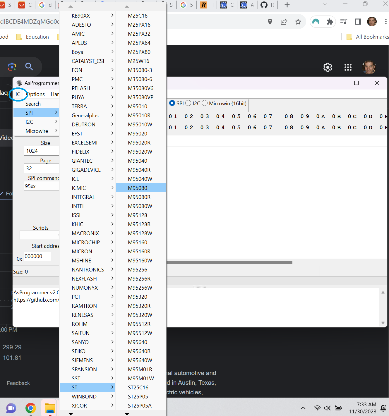

In DrShock's video, he used the AsProgrammer software and his car had 51,722 miles on it.
Once you run the AsProgrammer software, you need to find set the IC (Integrated Circuit) chip.
Go to IC/SPI/ST/M95080.
