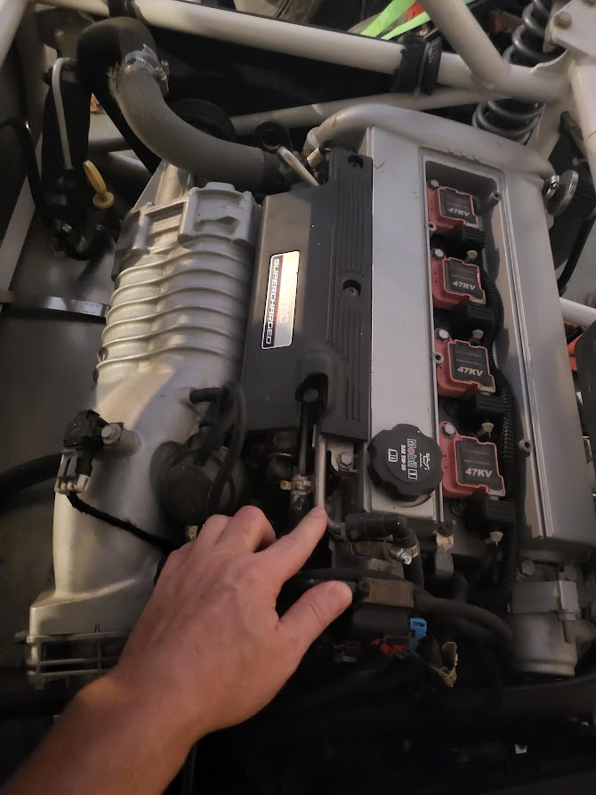

That is mostly bling.
The fuel rail is mostly hidden under the black "Supercharged Ecotec" cover.
The stock one has a pulse damper, which smooths out the fuel pressure as the fuel pump and injectors both have a pulse effect.
The fuel rail connects the fuel line to the top of each fuel injector. I guess it has a limit as to how much fuel it can deliver, but you would need to have huge injectors to hit that limit. I think most people buy it because they want the bling, and the AN connectors for their high pressure/high volume fuel pump, which also has AN connectors. Maybe someone who has one can chime in and explain a reason for buying it.

@Ross I kinda figured as much with the blink aspect. So with 80# injectors, this is not necessary?
Also, I see you have the high voltage coils - not sure what levels of boost of boost you’re running, but wondering if this would be necessary with a Z54 on E85? Probably in the neighborhood of 20 psi…maybe a bit more

@finazzoty I am assuming since you mentioned them that you will be running a Z54, E85, and 80# injectors? If so, I would run the billet manifold and boost reference fuel system. Might not be needed for 20psi, but good insurance to not have fueling issues and gives headroom to grow.

Awesome thank you - so do I also need that fitting?
RCK605
You shouldn't if you are doing boost reference and return style. When you decide on a fuel system look what comes in the kit and how it is supposed to be hooked up.
