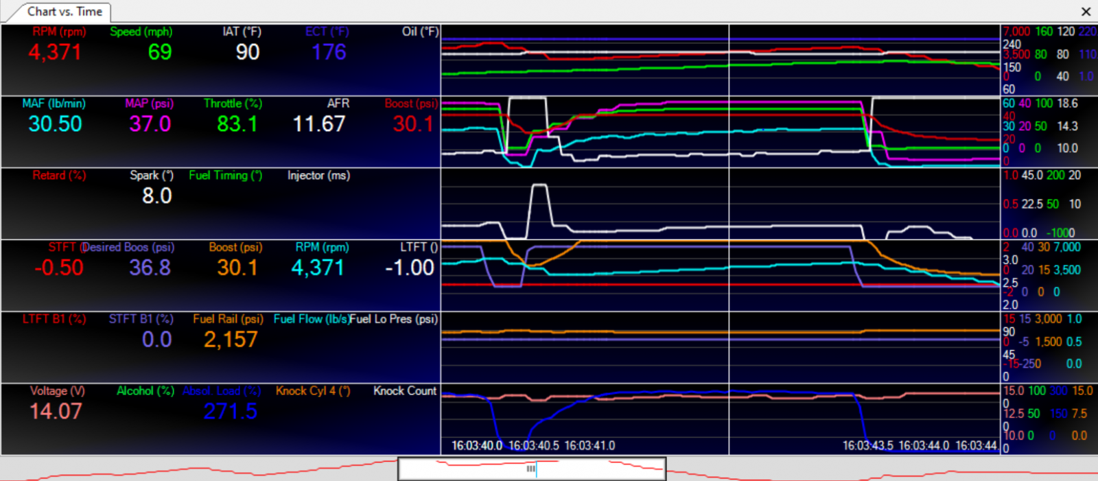

Your MAP reads 255 kpa, which is 37.5 psi.
Your boost reads 30.1 psi
Your desired boost reads 36.8 psi.
Looks like the desired is close to the MAP.
You don't need to graph the STFT B2 and LTFT B2 as our engine only has a bank 1.
Also IAT's (102F) are bouncing off the top of the chart (100F), could give them more range.
Zklonne
Trying to adjust a bit and got the wideband hooked in - now I have to try to understand whats happening. I’ve compared these logs for hours trying to see if I can tell what’s notable but nothing seems definitive.

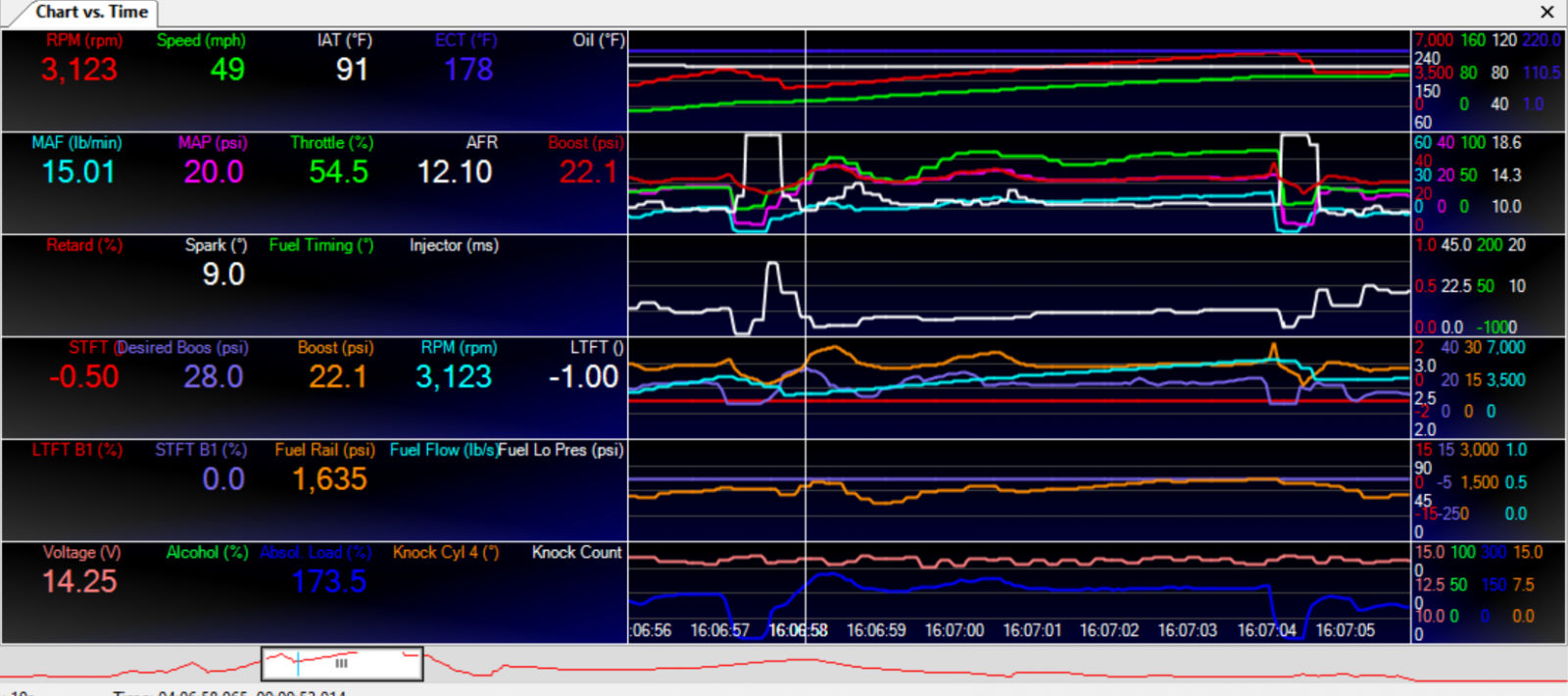

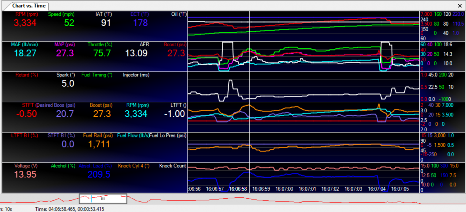

Since I’m still a rook The logs are below. First is a full 3rd gear wot with the sputtering (painful to listen to). Second and third are feathering trying to stay at 10-12psi boost (One is during the “good” part of the pull and one as soon as it spiutters and I let off the throttle a bit) where it seems to pull without sputtering. I’ve now adjusted the plugs to .032” to ensure we’re not blowing out and retested boost leaks to 30psi for a full minute so I think those are checked off. I’m starting to get to the point of “stuck” where I don’t know what to try anymore.

That first pull looks a little rich. Under power enrichment I like around 12.5:1 fuel ratio (.85 lambda), looks like you got below 10:1 at times.
Your full throttle only reads 83% ?

I thought it seemed a little rich for the wot pull on the first - lowest I saw was 11.1 :1 on the log which is low but not terribly lower than the recommended enrichment. Seems right on the edge of “ok” and “there’s a problem”. And I’m definitely a rookie on timing and spark advance but im hoping someone might be able to tell me if 5-9* at wot is normal, I believe it just highly dependent on the tuner (ZZP in this case). My biggest issue is since we ran fine With zero issues for 30-45 min last week so what could have changed so drastically to go from not working - To working fine - then to not working again. It seems like it has to be something minuscule, but at the same time it just doesn’t want to play nice!
Zklonne
As for throttle position I think I’m logging actual throttle plate position which goes from 20-80% - I have a relative throttle position pid which’s reads 0-100%
Spark tuning is basically: slowly advance it until you get knock, then retard it.
I didn't see any KR in your logs.
Is there something in the logs at the point it starts sputtering? I see where you get out of the throttle, but don't see any logged issue before that.
PS, you can post the whole log file on the forum.

Im using HP Tuners to log - i repolled parameters and got KR* to show up now. Ran a few more pulls tonight and not showing any KR which should mean either things are safe n sound or the sensors are garbage - uploaded the log file in case any of our local experts care to peak. I definitely dont like holding it pinned through the sputtering but im hoping something pops out. All I really notice here is in 4th gear "feathering" at medium boost/throttle/load levels (this is where it pulls smoothly, just below sputtering) I have a ton of negative short term fuel trim -30%, which goes right back to 0% - ish after mashing the throttle. Confirmed the same thing in another log while feathering the throttle. This was my first drive having the stock O2 sensor reconnected since I just found the 2nd bung for my wideband sensor, which may be adding to the big short term trims?

The only thing I noticed in the log files was the STFT trims seemed off.
When it is "sputtering", I wonder if it is running on 3 cylinders. If you have a point-and-shoot temp gauge, I think you could test this theory. Kill the engine after a few seconds of sputtering, and coast to the side of the road, take the temp of each exhaust port, and see if only 1 is colder.
Might be that one with low compression... or a bad spark plug/coil.

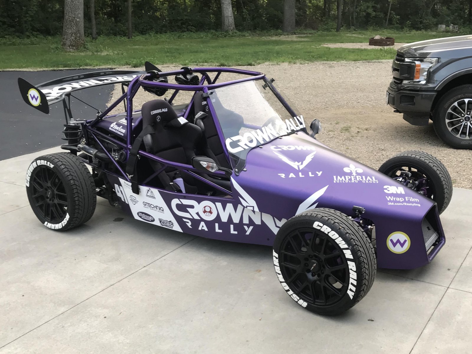

In the meantime, we got the livery kit for Crown Rally installed a few weeks ago - 2 weeks now until launch. I'll make a new post for some of our prep work we've done to the car to prepare for the 3 day, 2000 mile trip.
