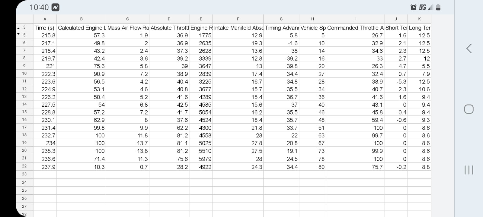

I have had an issue with my goblin bogging down when my foot is to the floor in 1st and 2nd gear. The only check engine lights I have were the evap and 2nd 02 sensor as I'm running an afr gauge. I sent the ecu off to get tuned and remove the torque limits, increase rpm redline, remove check engine lights etc. I got it back and it feels better but again from like 3rd gear on. The picture is live data from stand still to 80. I shifted to second at 3k mainly because I wasn't moving and the engine was just increasing rpm without changing speed much. It still seems like the throttle body isn't opening up like it should until I hit 3rd gear. When you launch it in first or second initially it feels like the butterfly wants to open but it just doesn't then it bogs down and does the same thing as stated above.
The throttle position data seems weird as the whole time my foot was buried unless I was shifting. 3rd and 4th feel like an entirely different animal just trying to get the other gears to do the same.

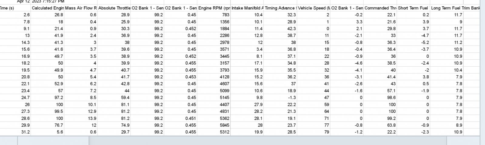

The cobalt didn't have this issue.
This was an issue before the tune.
Throttle opens fully when key is in the on position and the pedal is pressed.
It also opens fully on revving the engine in neutral, and in gear with clutch in.
I also added additional data on a second launch foot to the floor.
As you can see 0-50 took 15 seconds and on both sets of data once I hit 50mph everything opened up and it moved.
