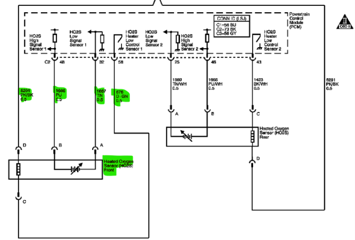

Can anyone pull the wiring diagram for a 2006 SS (Supercharged) for the Bank 1 oxygen sensor? I'm looking for where the wires go to in the ECU or Fuse Block. I can't get Charmi to load (work firewall) and AllData is being slow getting my license renewal done.
I'm getting code P0134 - O2 Circuit No Activity Detected. I cannot see the O2 sensor in HPTuner so want to check continuity. I've already tested the sensor itself.

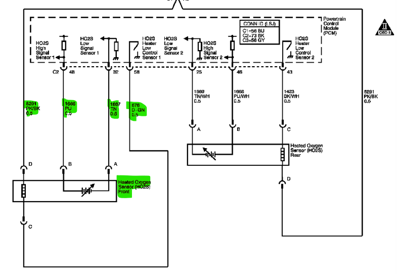

Circuit 1 two black wires (heater)
Circuit 2 the white and the blue wire (sensor)

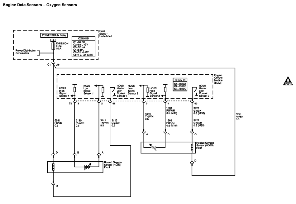

This is the wrong chart... see Rauq post below.
53859

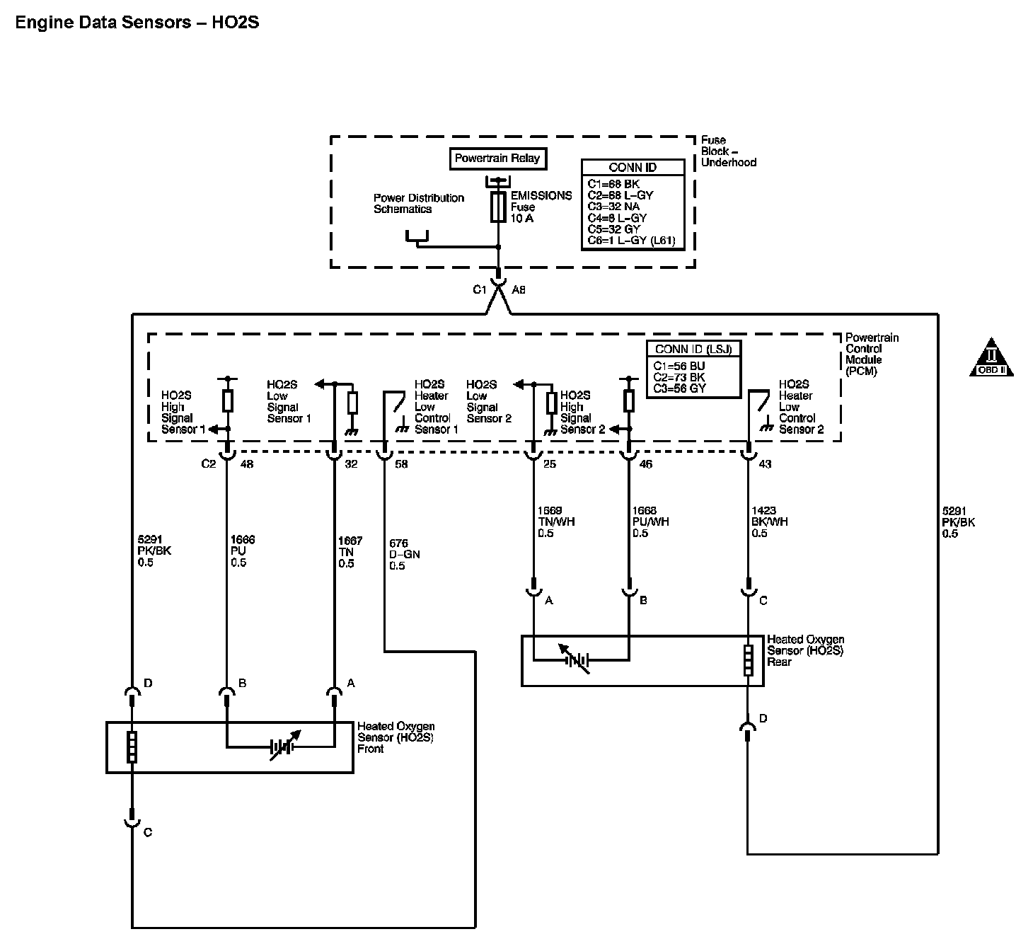

Alert! Unfortunately the diagram Ross posted may not be accurate for an '06 LSJ - the giveaway in the posted diagram is the reference to "Engine Control Module (ECM)". An LSJ diagram should refer to "Powertrain Control Module (PCM)". I've had pretty good results searching for similar diagrams on the '05 in charm.li
The '05 diagram is here:
53862

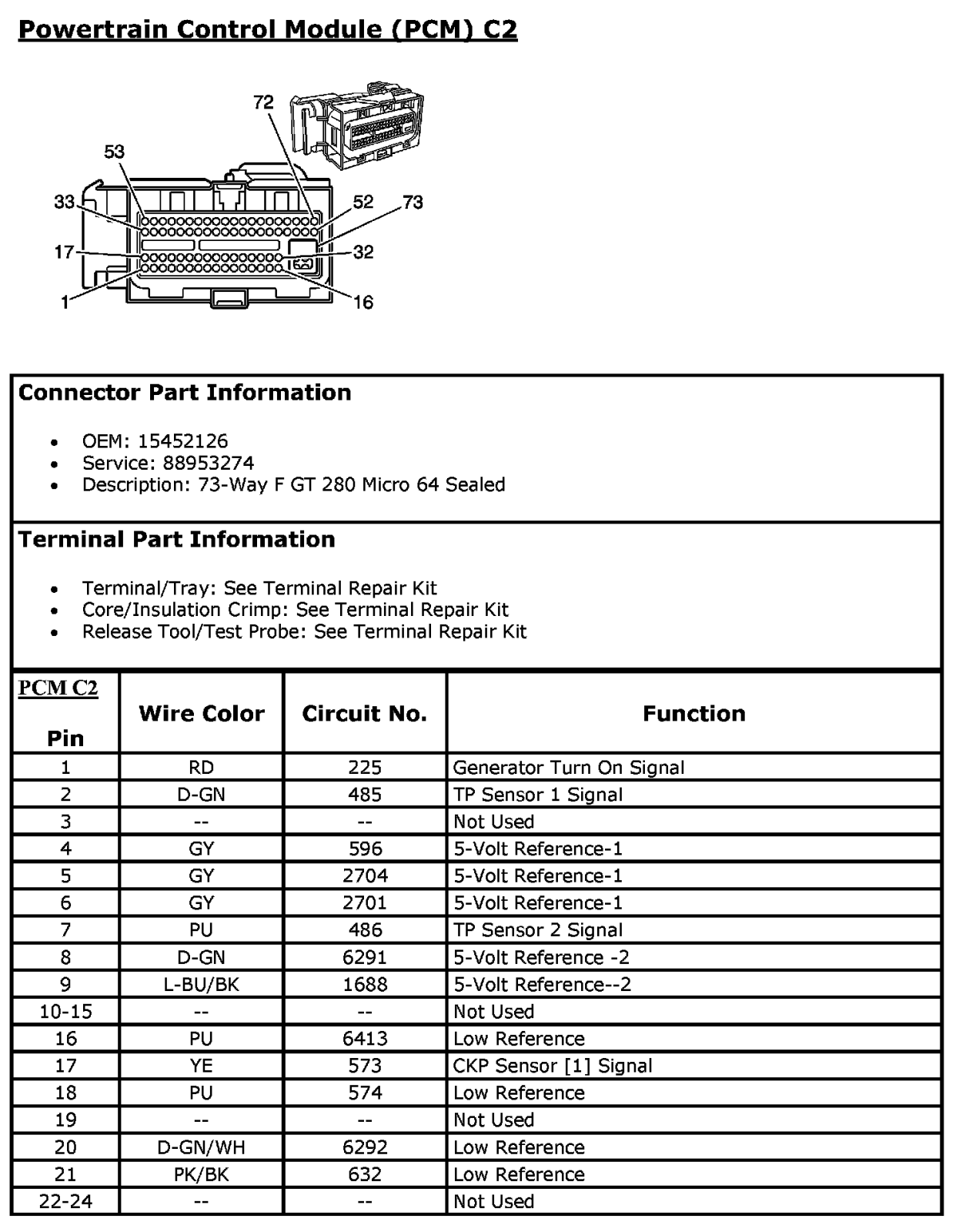

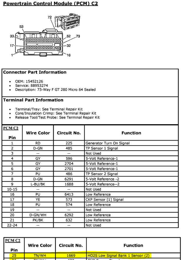

The C2 pinout generally confirms this.
53864

Thanks, this gives me something to check. I did check my 10A emission fuse, it was ok. Just making sure I'm reading this right, this is the upstream O2 sensor? Rear should be the downstream (post-cat) which I do not have any longer.
53866
Yes you are reading it correctly. Emission's fuse will only affect the heater. And with the pull up and pull down resistors, I think you would get different codes with broken wires on the sensor circuit, but I couldn't say that for sure without checking the service manual.
Good catch. I did follow the links for a 2006 LSJ, but Charmli lead me astray.
I could have worded that better- you posted the right diagram, but Charm.li's diagram contains bad info. That's not on you, that's on them. I'm just very aware of the ECM/PCM difference on diagrams because of some wiring stuff I'm working on. All good!

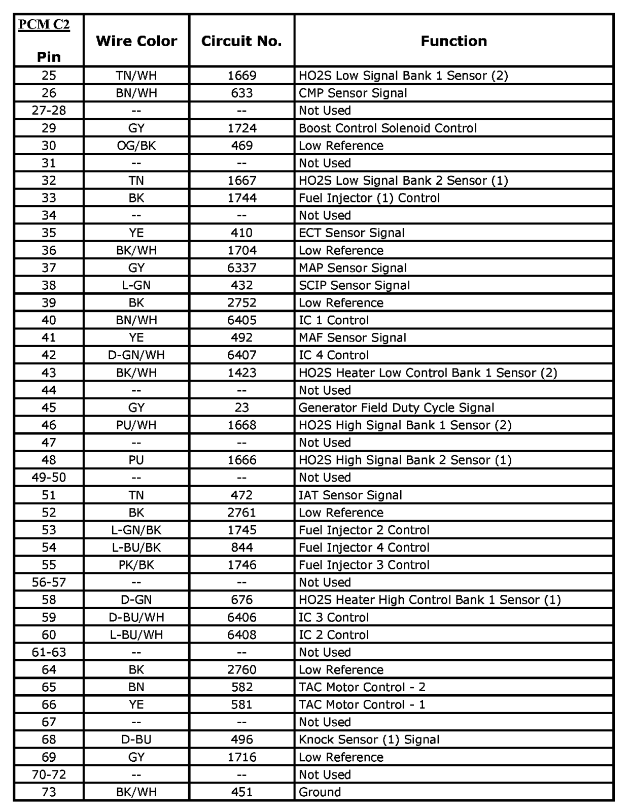

Probed the wires to test continuity from the diagram. Any suggestion what to test next here?
5291 Pink/Black to fuse block C1-8 --> Continuity. This circuit I'm not sure about. It joins to many other 5291.
1666 Purple to ECM C2-48 --> Continuity
1667 Tan (Yellow?) to ECM C2-32 --> Continuity
676 Green to ECM C2-58 --> Continuity
53945
Check for voltage.
With the car on, you should get 5V+ on the Purple, high signal reference.
The Tan, HO2S should be <5V+ and >0V. I see this is grounded internally inside the PCM, so check ground on the PCM case.
The Pink/Black wire should have 12V+ when the key is on.
The Dark Green should only get ground when the PCM commands the O2 sensor heater, which occurs soon after key on.
