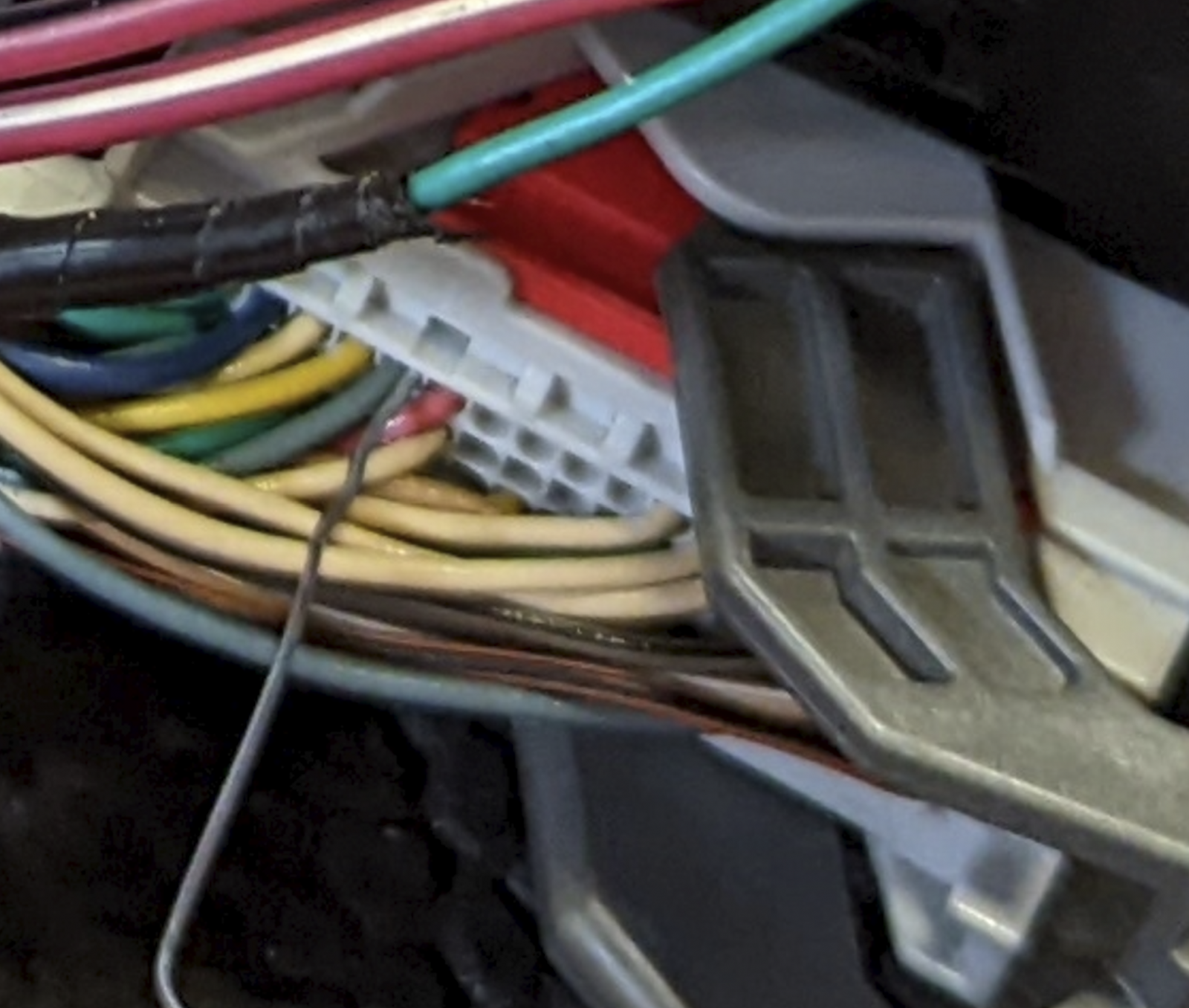

I am guessing you saw my build thread post about this. I just used a paperclip that I shoved into the back side of pin 14 (believe it is a light blue wire) and put a jumper on it to the nearest ground. Followed the tech2 process and it calibrated.

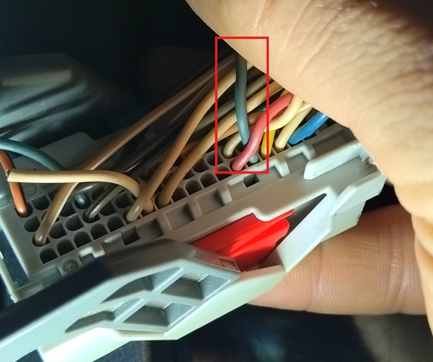

alright I think this is the right wire to use...this is the bottom horizontal connector off of the front of the BCM. can anyone confirm? thank you
the pinout chart I found has pin 6,7,8 as white and pin 13 as pink and pin 15 as yellow so this looks correct to me.
