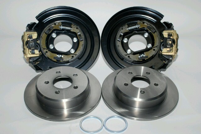

I don't know about the cobalt but i use the disc brakes off of explorers all the time when modding classics. The brakes have a drum setup inside the disc rotor. You can probably set your brakes up with something like that pretty easily.
