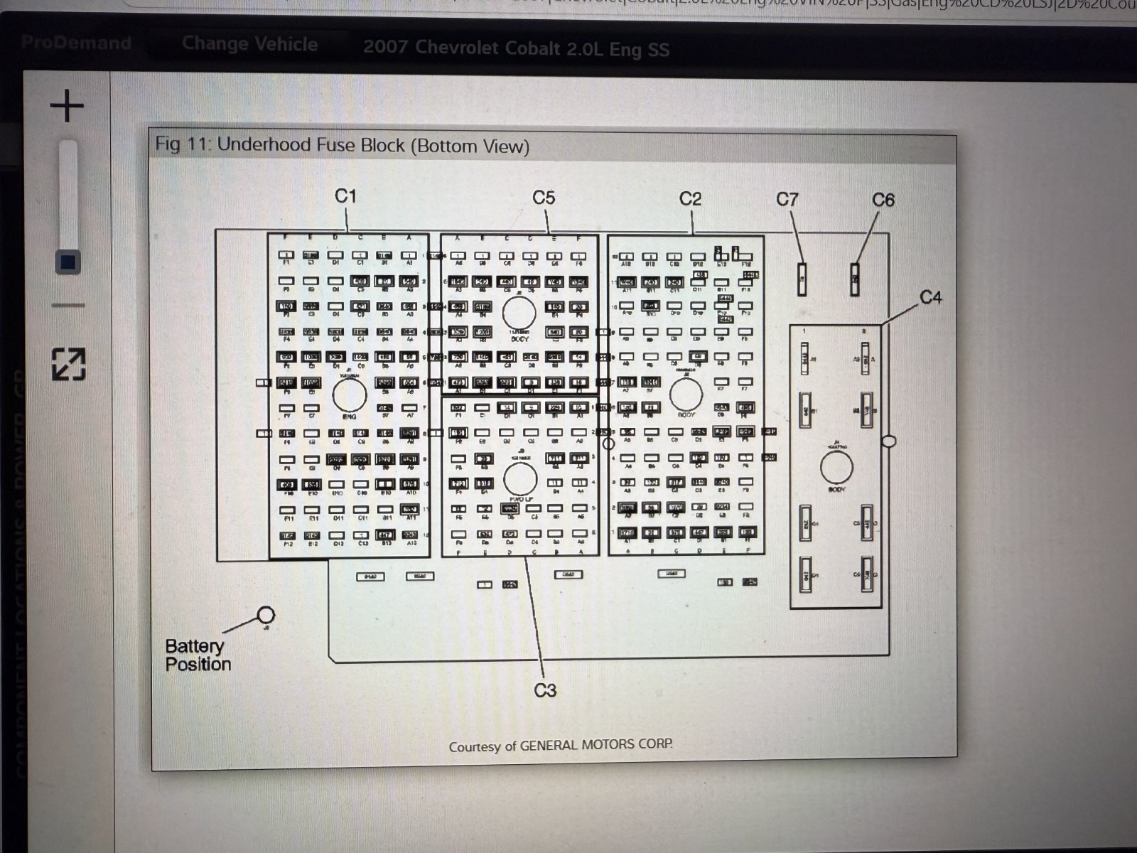

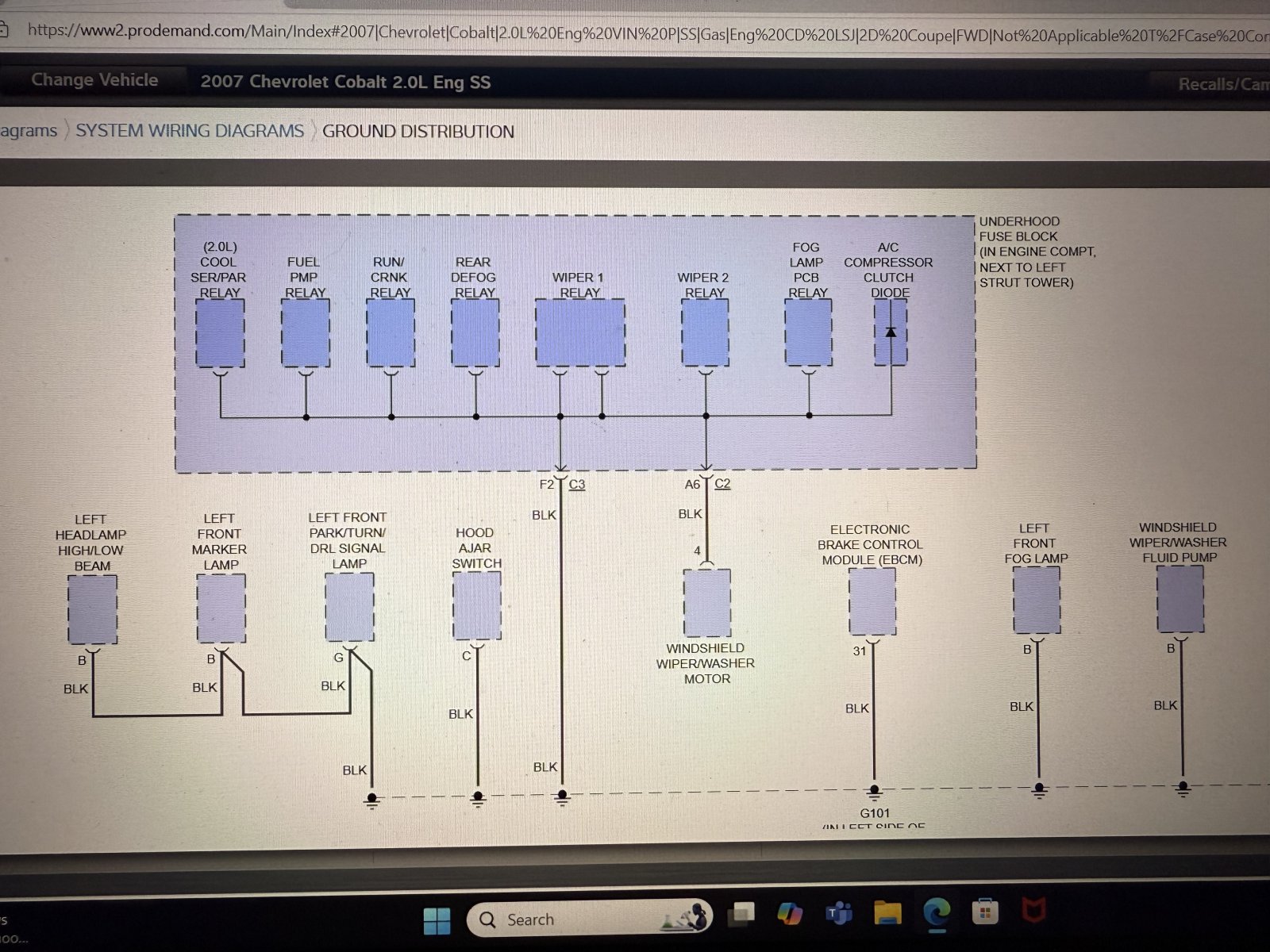

This should be what you’re looking for. Connector c3 terminal f2
