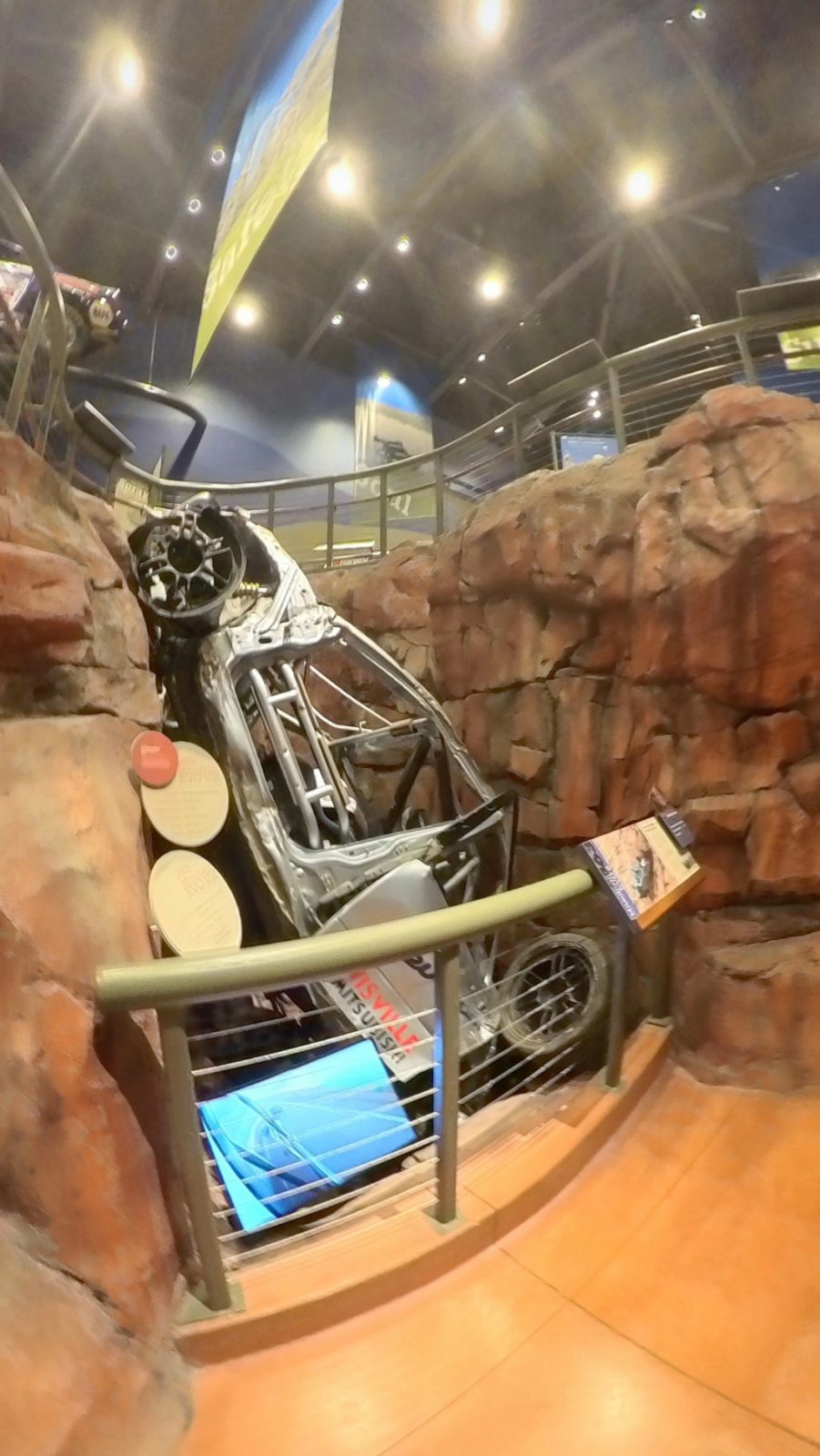

Seeing Pikes Peak was awesome, but I don't think I'd ever want to race it. Especially after visiting the museum and seeing this car

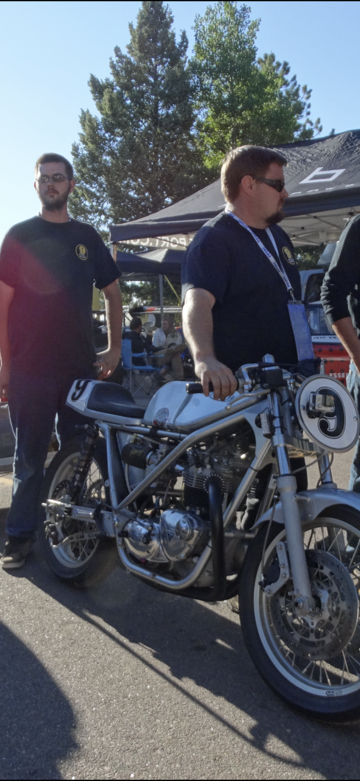

I’m familiar with the PPIHC. I was crew chief for 2 years (2014-2015) racing vintage motorcycle at pp. I can’t begin to describe what kind of brutal hell you are wishing for running that race. It’s the second most dangerous race in the world only behind idle of man………. and I still want to go back. :cool:

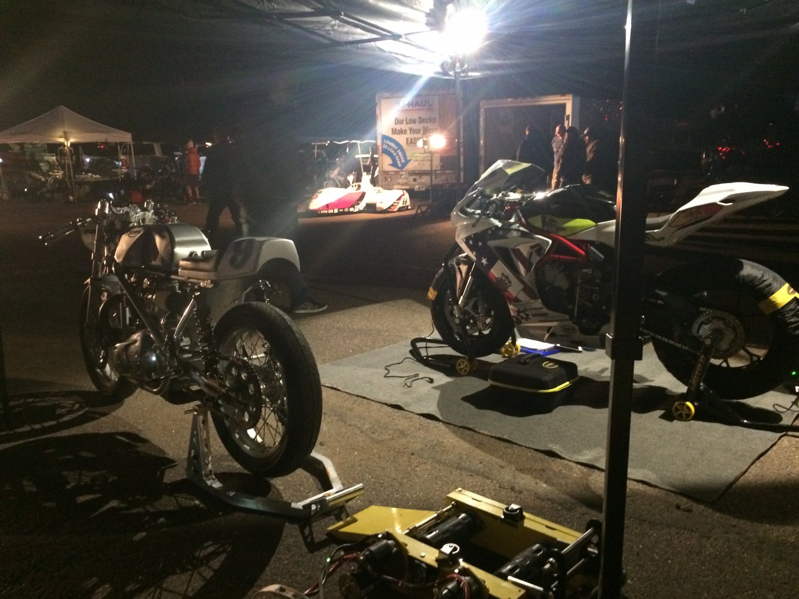

race week is brutal. You’ll need to be there by Sunday for sign in and drivers meeting. Monday is tech. Tuesday to Friday is practice. Pp is open to the public from 8am to dark. Which means you have to practice from sun up (5am) to 8am. You’ll need to be set up and ready before first practice starts and attend the drivers meeting/rollcall before hand. It takes 45 minutes to an hour to get from the base of pp to your section (changes each day). Start doing the math and you get up around 1-2am to start your day. 8 ish practice is over and you pack up and head down. Get to camp about 10am and you are ready for dinner. Then it’s time to fix anything that may have broke or need attention. Something always happens. You end up staying active all day and try to go to sleep early, because you have 4 more days of this routine……..
saturday, you are off and Sunday is go time. Hit the mountain about 3-4am, get setup, look over the car and wait for the drivers meeting. When you finally get to race, it is the longest 10+ minutes of your life. All you do is watch a tv screen and hope to see your guy trip the timers. Once he’s at the top your whole world of stress falls off you like nothing you have felt before. Then you find your trailer and sleep………for a month.
That museum opened in 2014 just after the race that year. We were one of the few teams invited to check it out the Saturday before the race. I was looking at that car from up above and said the ti guy next to me “that much have been a hell of a ride”. He said “it was”. The dude next to me was the co driver in that car. He said the driver won’t return, but he was racing that year, first time back and said he has a mountain to beat. The dude was bad ass.
