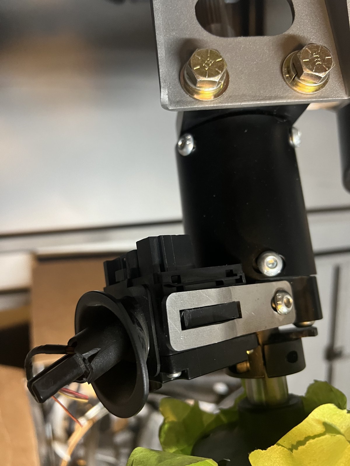

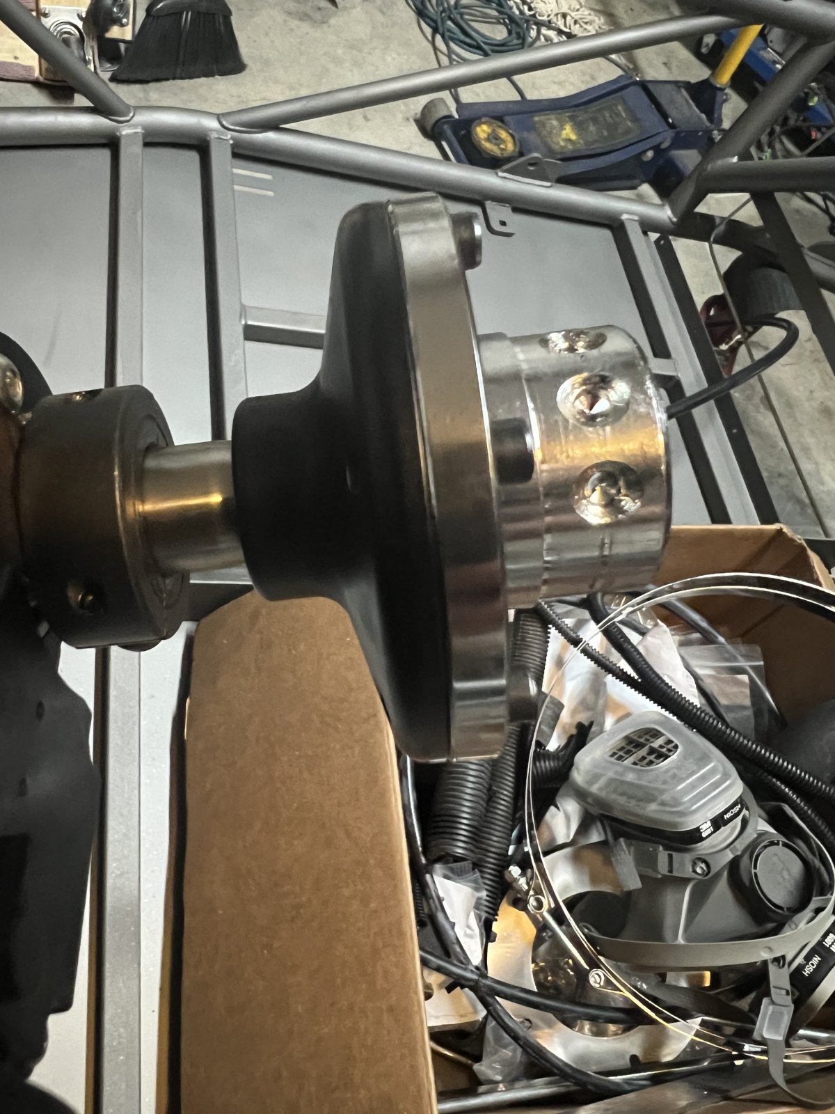

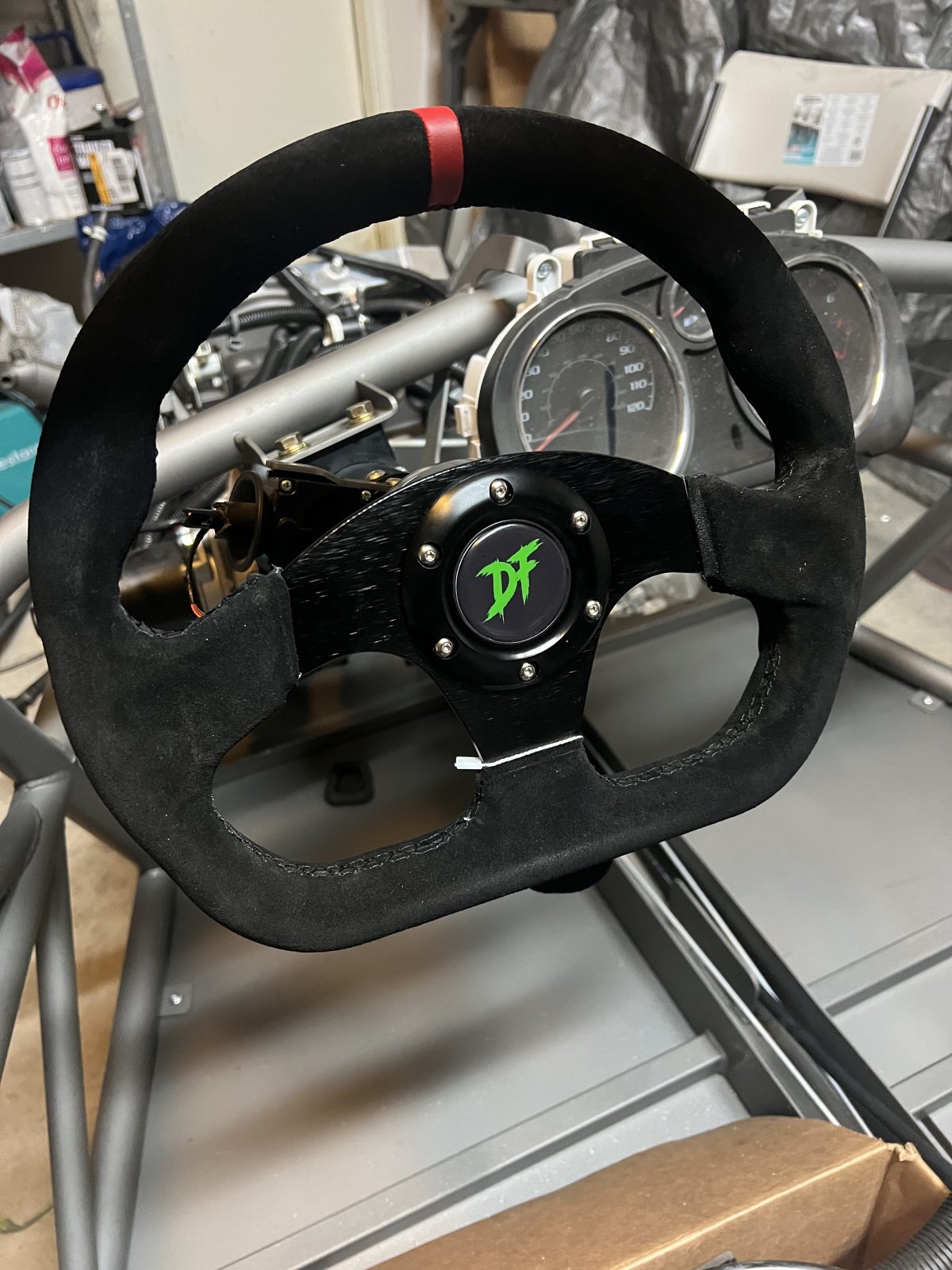

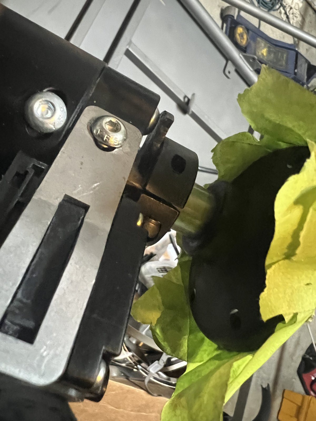

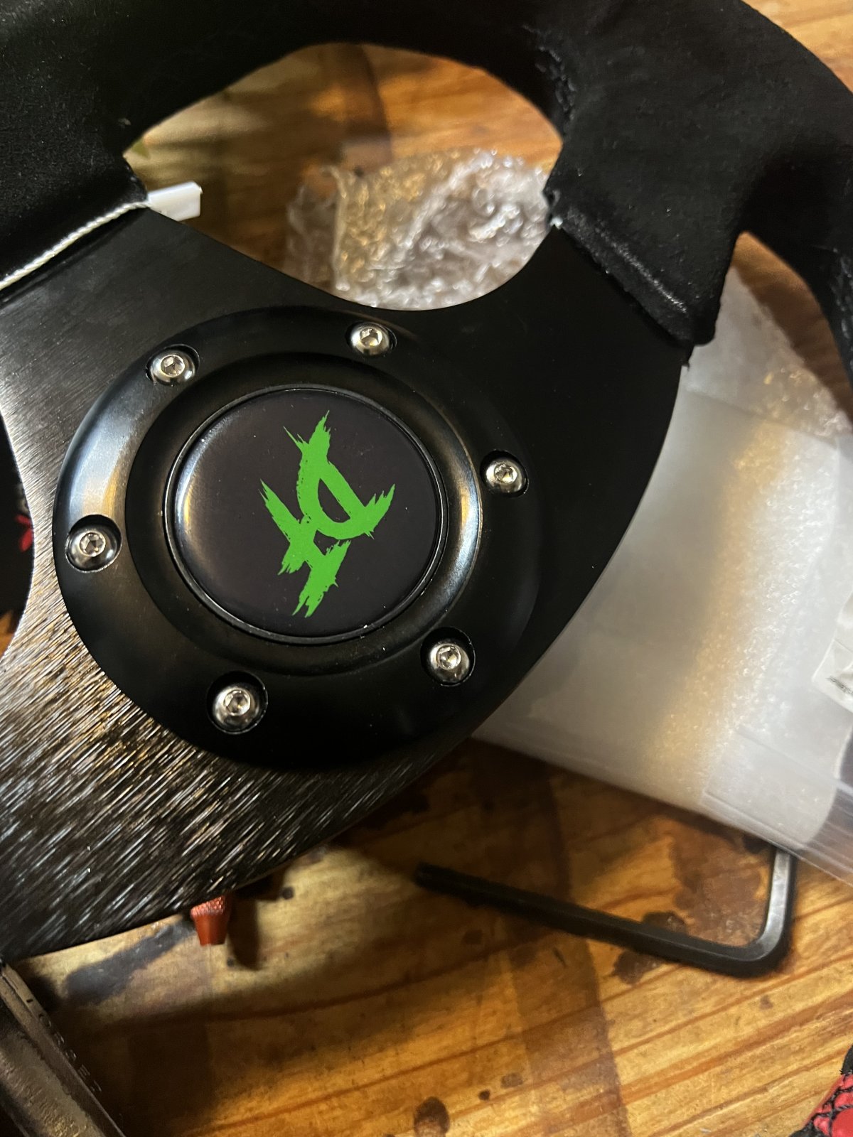

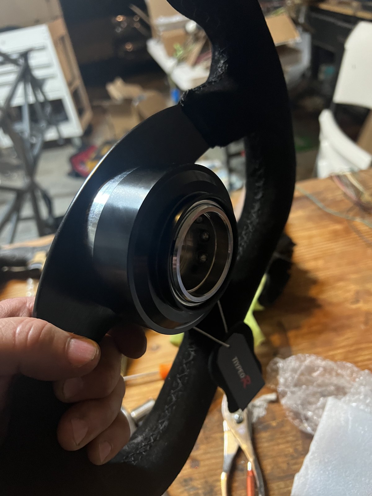

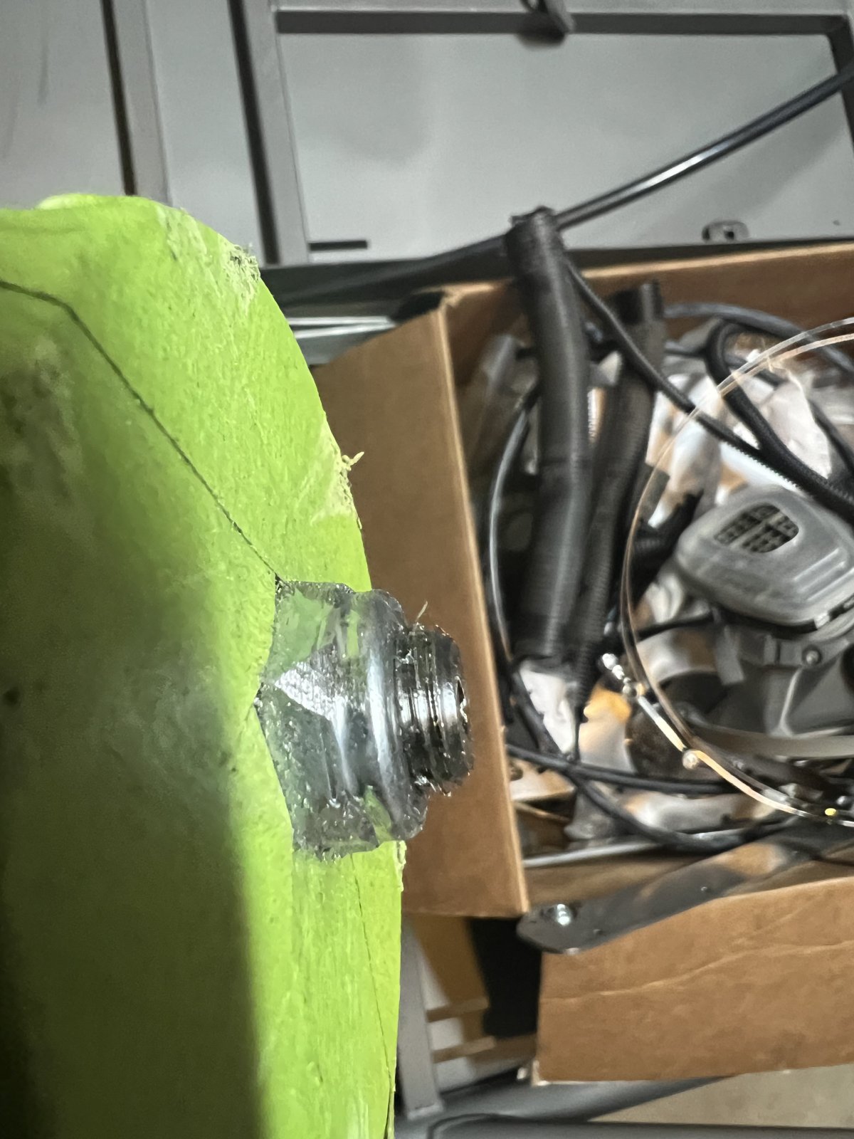

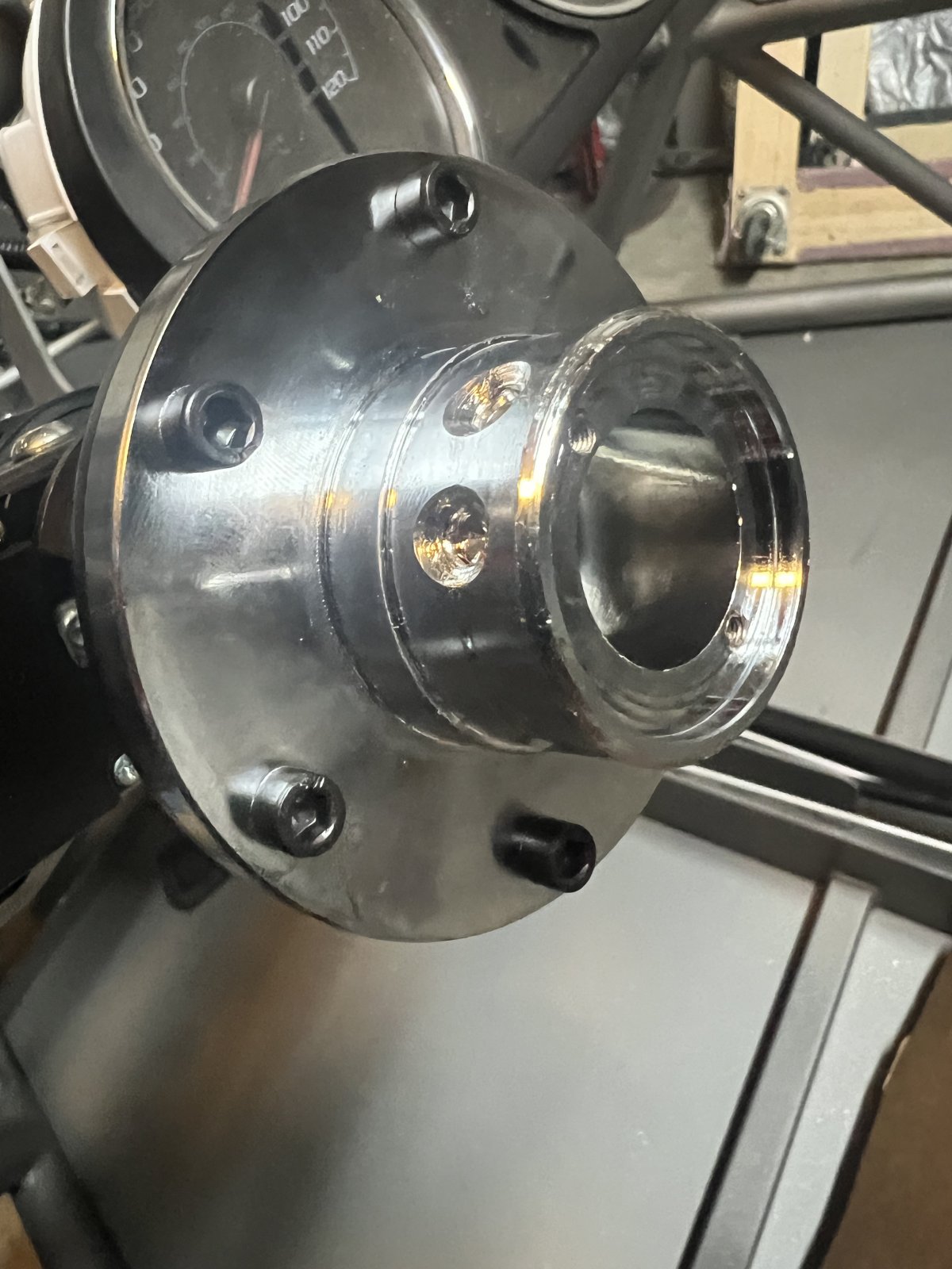

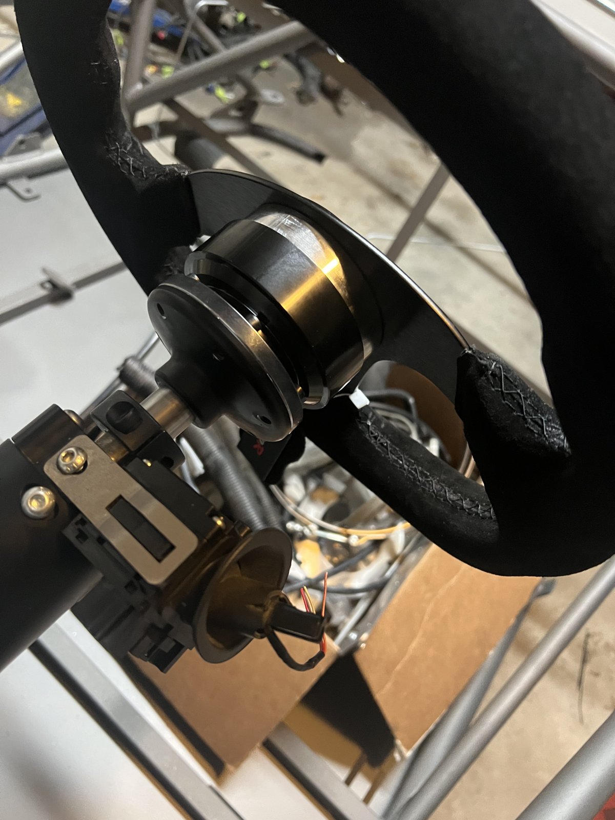

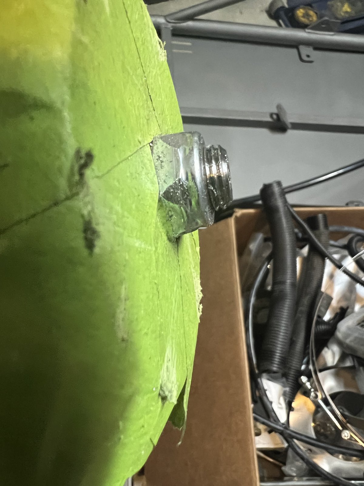

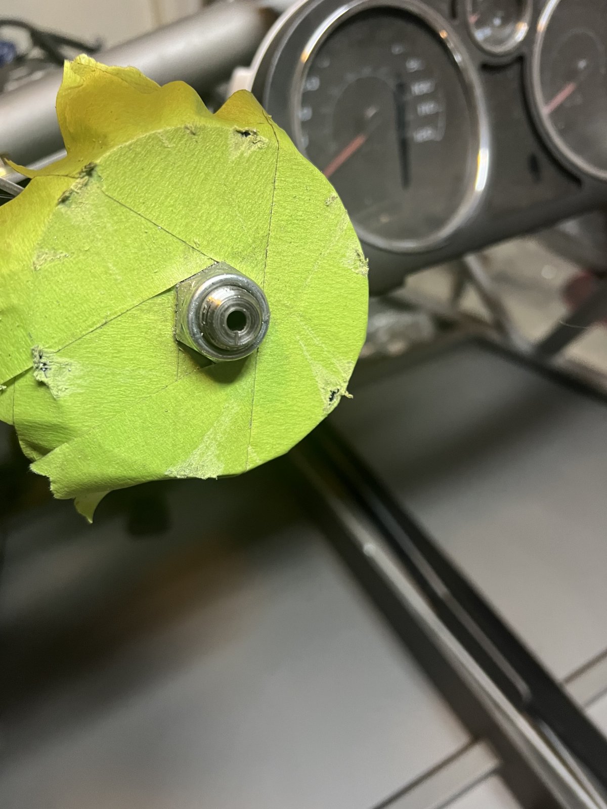

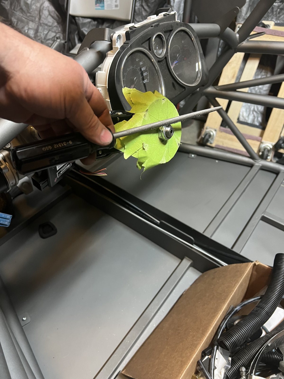

Used my rasp file in picture to take down the edges from the steering wheel nut from colbalt doner.alittle was all it took on all five edges as shown in picture. Other wise mounting plate to quick disconnect don’t sit flush.Green tape used to protect column mounting plate. Other than that it’s bolt on. The bolts I put in place seemed most logical as shown in picture.everything locks in place and turns properly. Horn button for looks not functioning at this time. Do not drill, cut or widen holes it’s not needed.
