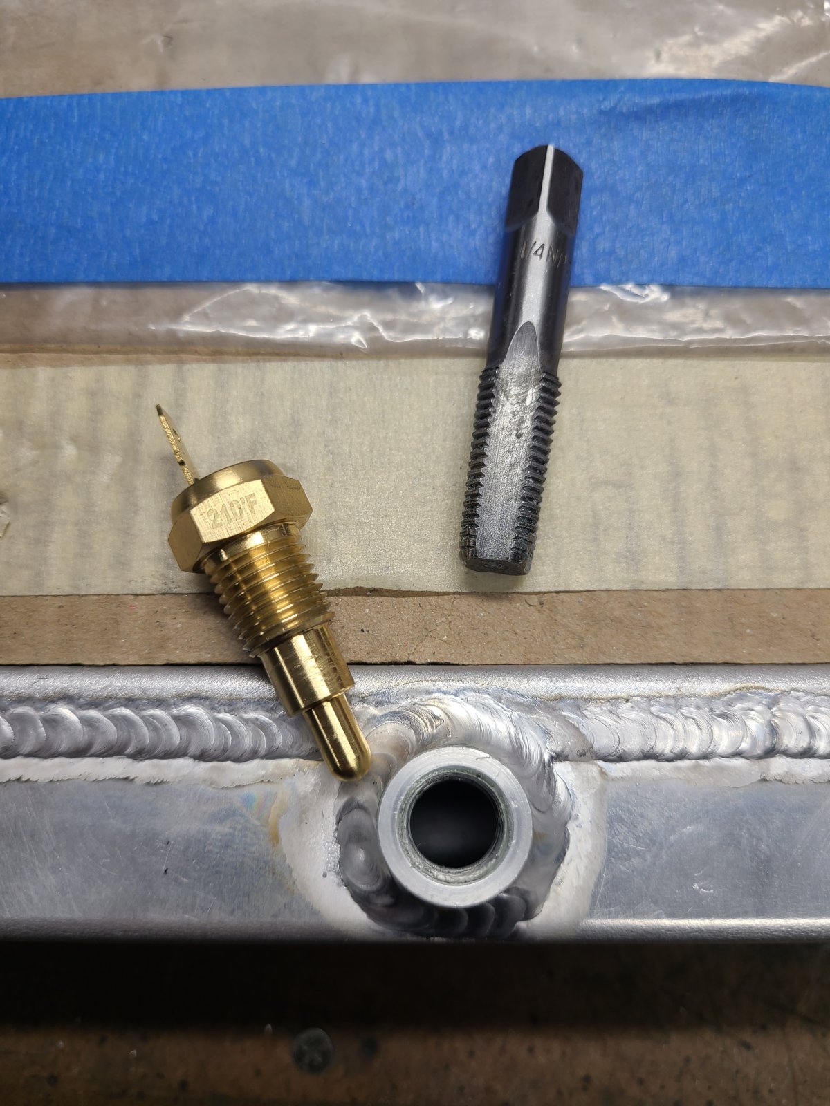

Alternative to a plug or petcock for the radiator lower drain hole:
1/4 NPT thermostat switch (on at 210, off at 190) - used for my auxiliary heat exchanger fan in my build. Just made sense to kill two birds with one stone: caps off the hole that will likely never be used in the radiator and avoids having to put a sensor adapter into the auxiliary HE coolant circuit - since it uses the engine coolant.
Tapped out the 1/4 NPT hole a little larger so the thermostat sits further into the hole - and made sure threads were clean and correct.

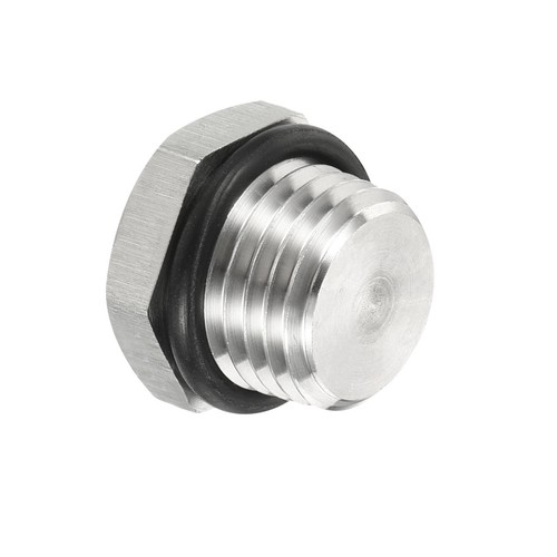

It’s probably a pipe thread so you might be able to replace with a plug. Even if it’s metric you can still plug it.
That's what I ended up doing. It was a bolt in 1/4-NPT one that ultimately fixed my issue. I'm not sure where to get one, I ended up ordering mine off the inter-web.
I may have been looking in the wrong section then. I was looking in nuts/bolts. Looks like I should have gone to the pipes section.
