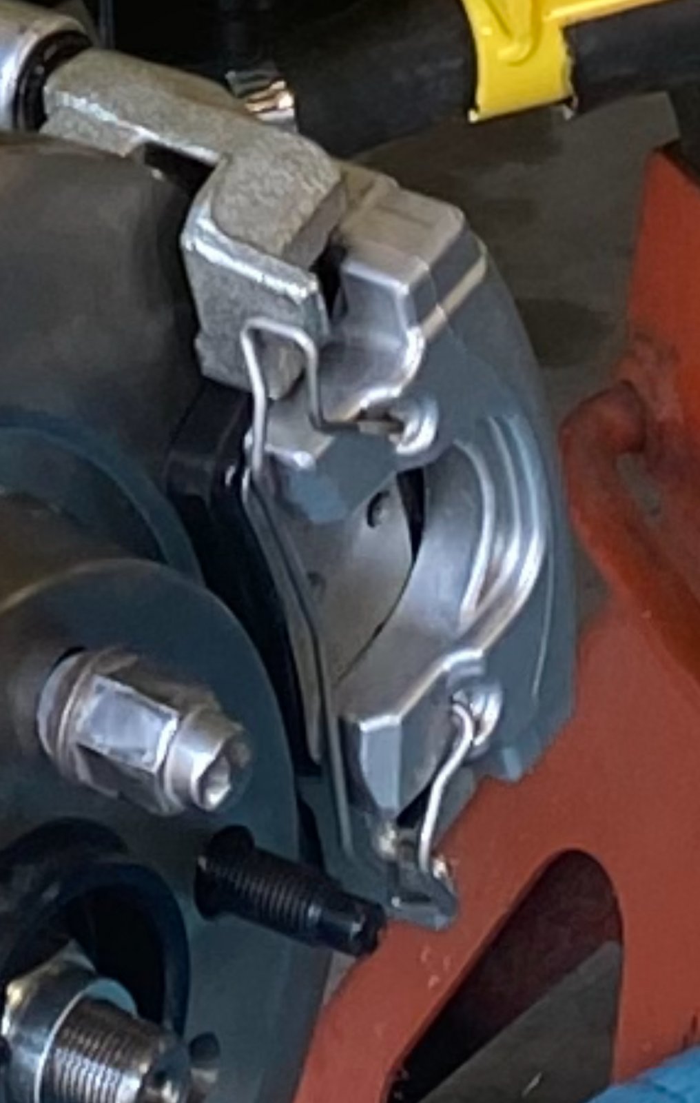

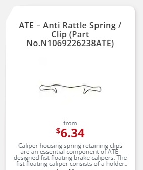

Since I only have one what I need most immediately is another "anti-rattle clip" as seen here:
52593
if anyone has numbers/source other than going thru Goblin HQ for pads and rotors that would be fabulous! Thank you in advance

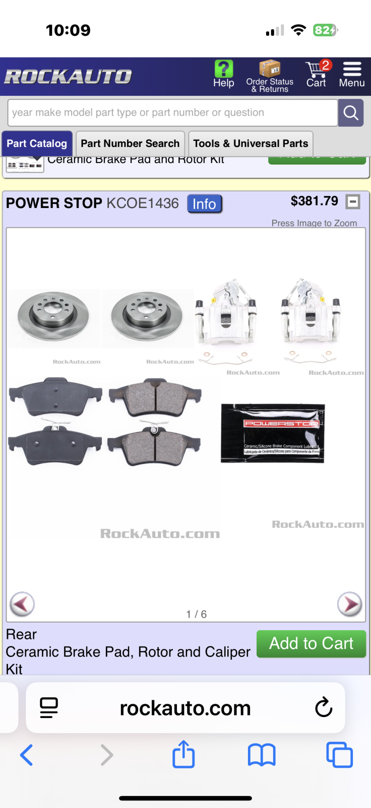

I ordered my rear brake calipers, rotors, brake pads and park brake cables from rockauto. I can get those numbers if you want them. You will need the DF brake hoses and hub centric rings for the rotors. It appears you are using 5 lug?
LaunchPad
I would LOVE and parts numbers if you have them! beer on me, should we ever meet.
Yes, this car is a five lug. but that was Adams picture from the well-hidden DF parking brake photo album. . .not sure I can post a link. . .hmm.

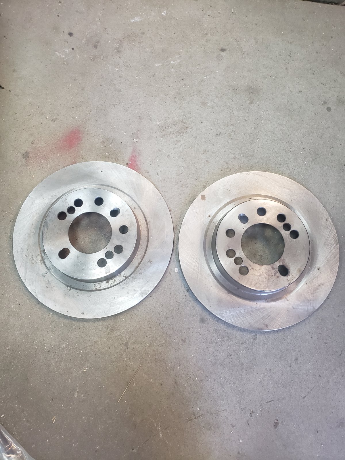

Is the rumor that these are solstice brakes, correct? I happen to have both a N/A Sky and GXP Solstice but haven't crawled under one to remove a wheel and verify. the discs i got in the DF kit had new mount holes drilled. I wasn't too thrilled about their appearance. if so then major GRRR, nothing like discontinued parts for cars long out of production.

Nothing wrong using the redrilled rotors. I use the 5x110 pattern. If you don’t have the hub rings which are in the store, you’ll need them. I also ordered the rear brake hoses from DF. Pretty much everything brake wise is for the solstice on the rear. If you want to use the park brake you will need park brake cables for the cobalt ss with rear disc
