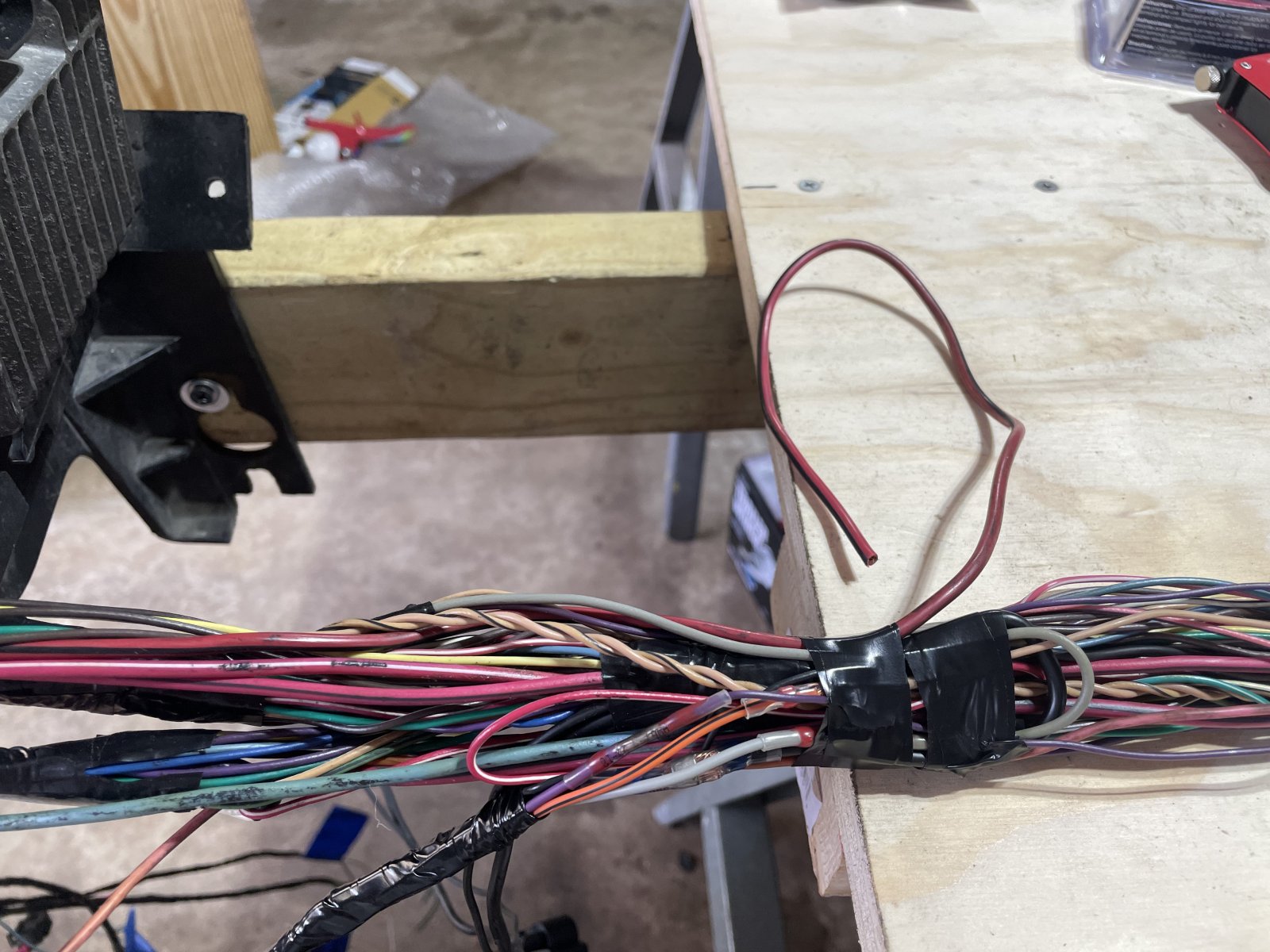

V1 Random Red/blk strip wire

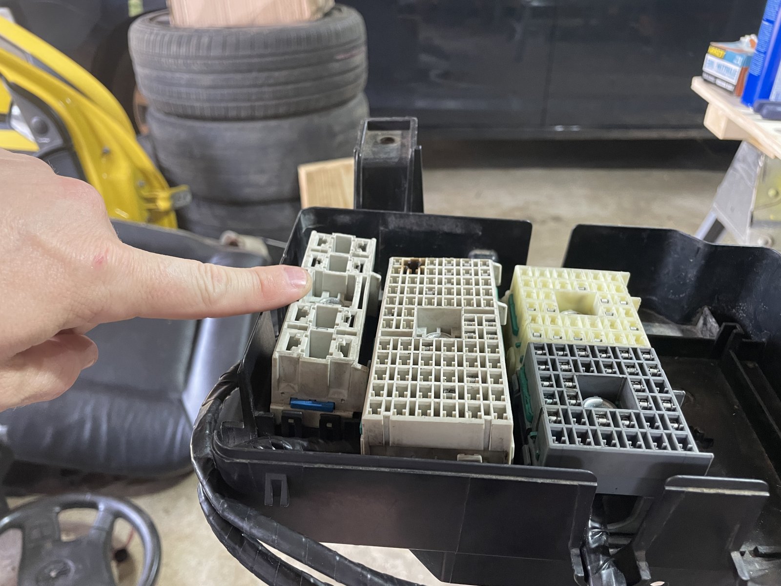

I have a random red with two black striped wire close to the fuse box. Did I miss a connection? It runs to the skinny/long connector of the left of the fuse box.

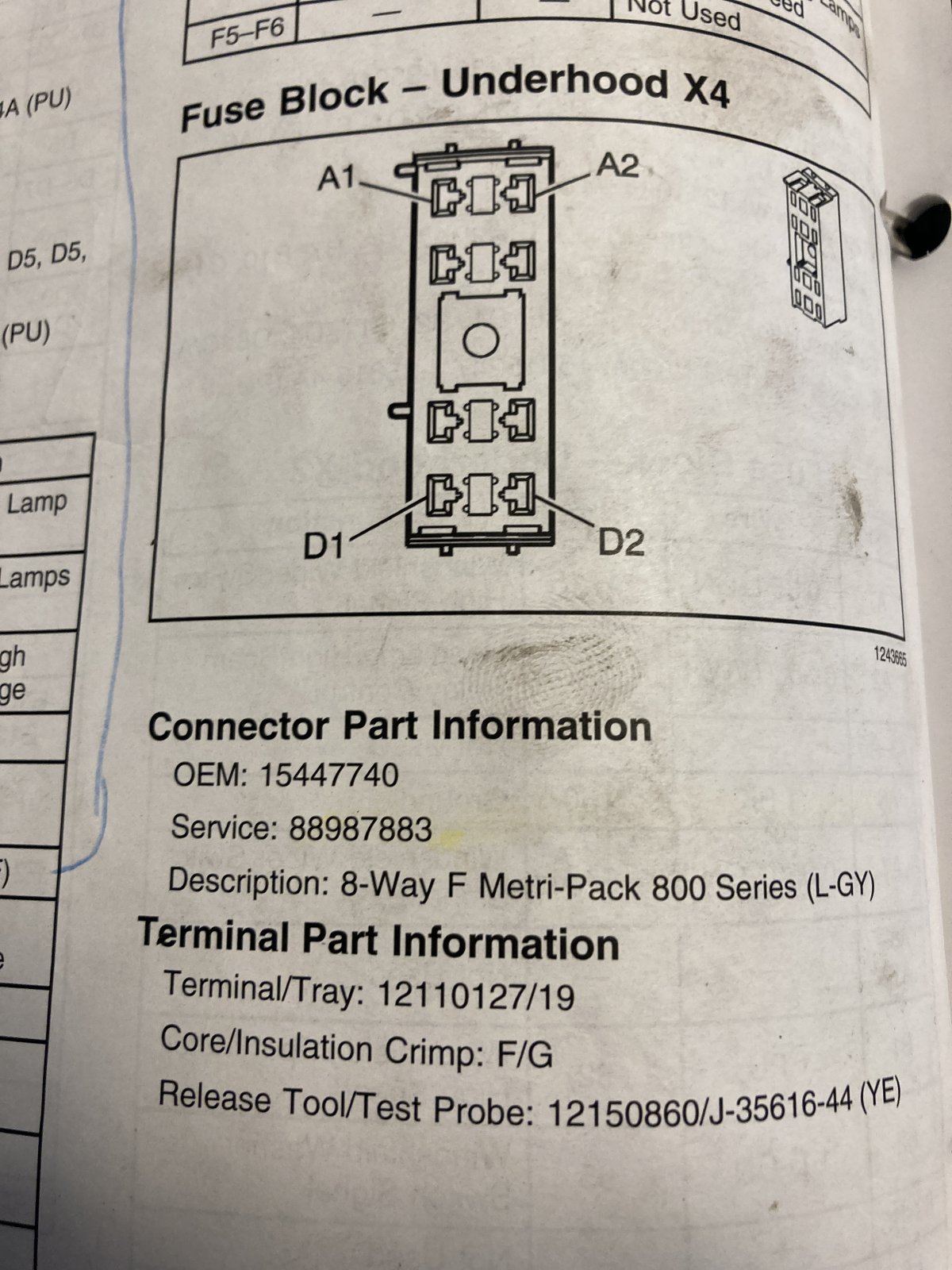

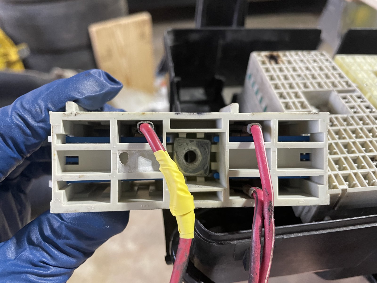

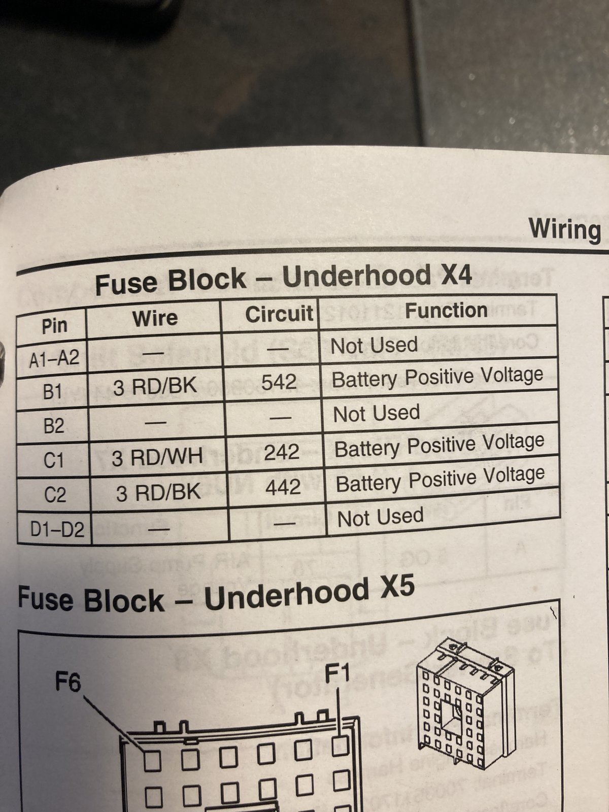

On the LNF 542 goes to the anti lock brake control and can be eliminated. 442 goes to the BCM and is needed as far as I know.

You can but it looks like it will currently be fed from a always hot 40amp fuse. Best practices would say to change out the fuse to something smaller since you will likely be using much smaller wire to wire up your accessories.
