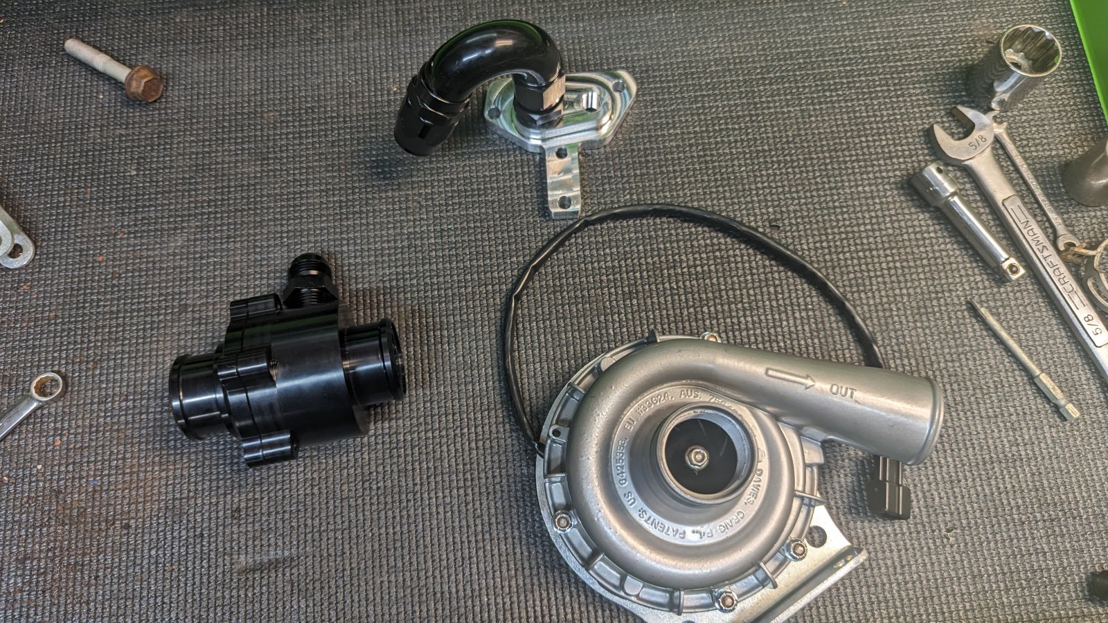

I bought the DC8930 Davies Craig 12v EWP115 Nylon Water Pump w/ LCD Controller,

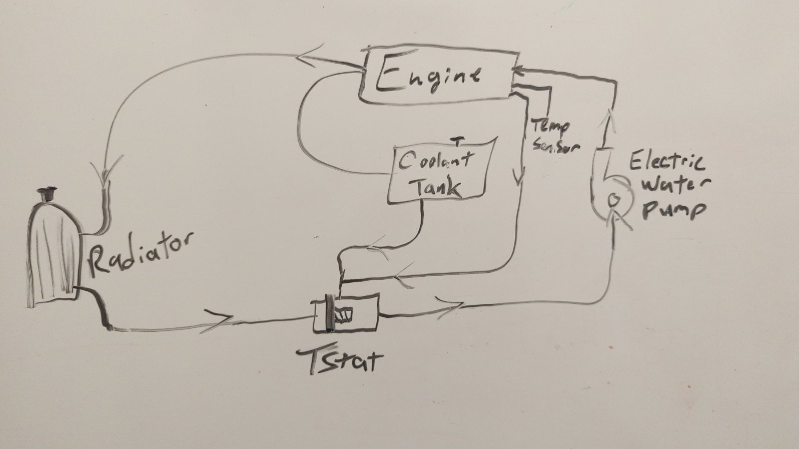

I plan to eliminate the stock thermostat and its housing with the coolant loop. The Davies Craig water pump will be located up front, beside the radiator, with the LCD controller running the fan and pump based on the coolant temperature.
The cool coolant returning from the radiator travels down the driver's side of the goblin, and needs to get back into the engine. My LSJ engine will also require coolant to travel thru the oil heat exchanger, so I am going to have to split the coolant line off, with some flow going thru the oil cooler, and the rest going thru the engine.

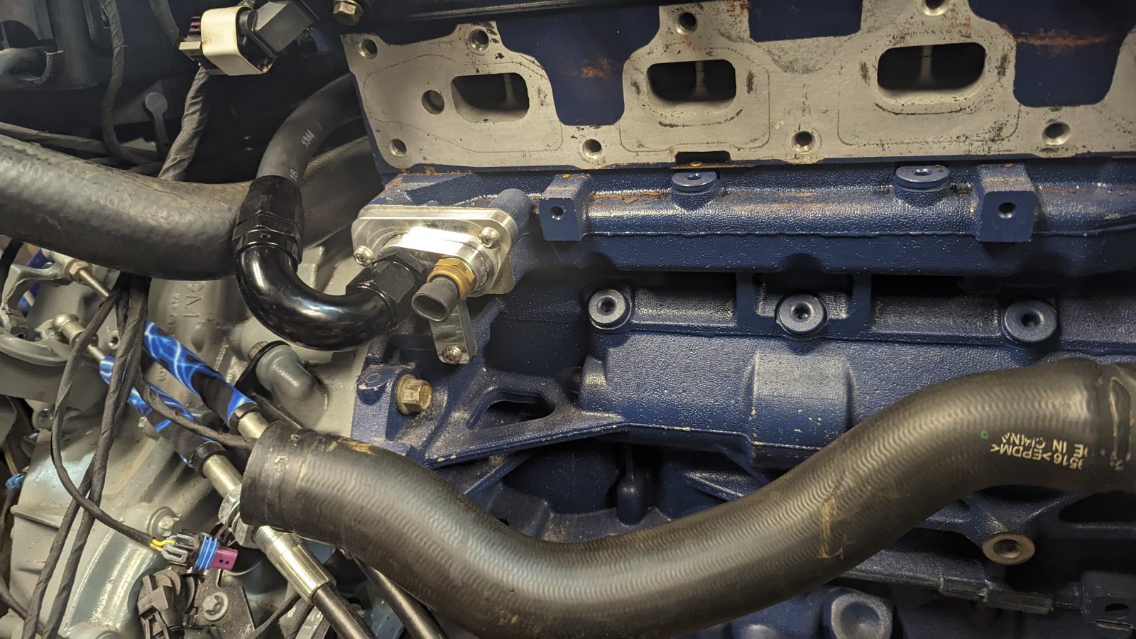

@95Blitz since you blocked off the coolant entrance into your stock water pump, where are you going to add an entrance to your engine?
The plugs in my water pump are only blocking off where the shaft when through the housing, The inlet isn't installed in the pictures to show the plug locations.
O
Bypass t-stat housing has a port for the heater hose outlet.
I am going to T off of the port, one to the adapter block, the other to the reservoir. The t stat housing is on the inlet side of the EWP.

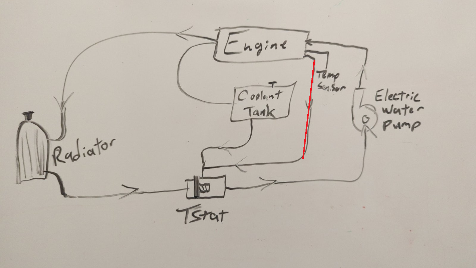

Won't almost all your coolant flow go thru the red line? Why do you even have that line in there?
42741
O
that line is only 5/8" it is there to heat the element in the tstat.
it is the Tstat's job to keep the motor warm and the radiator to keep it cool
