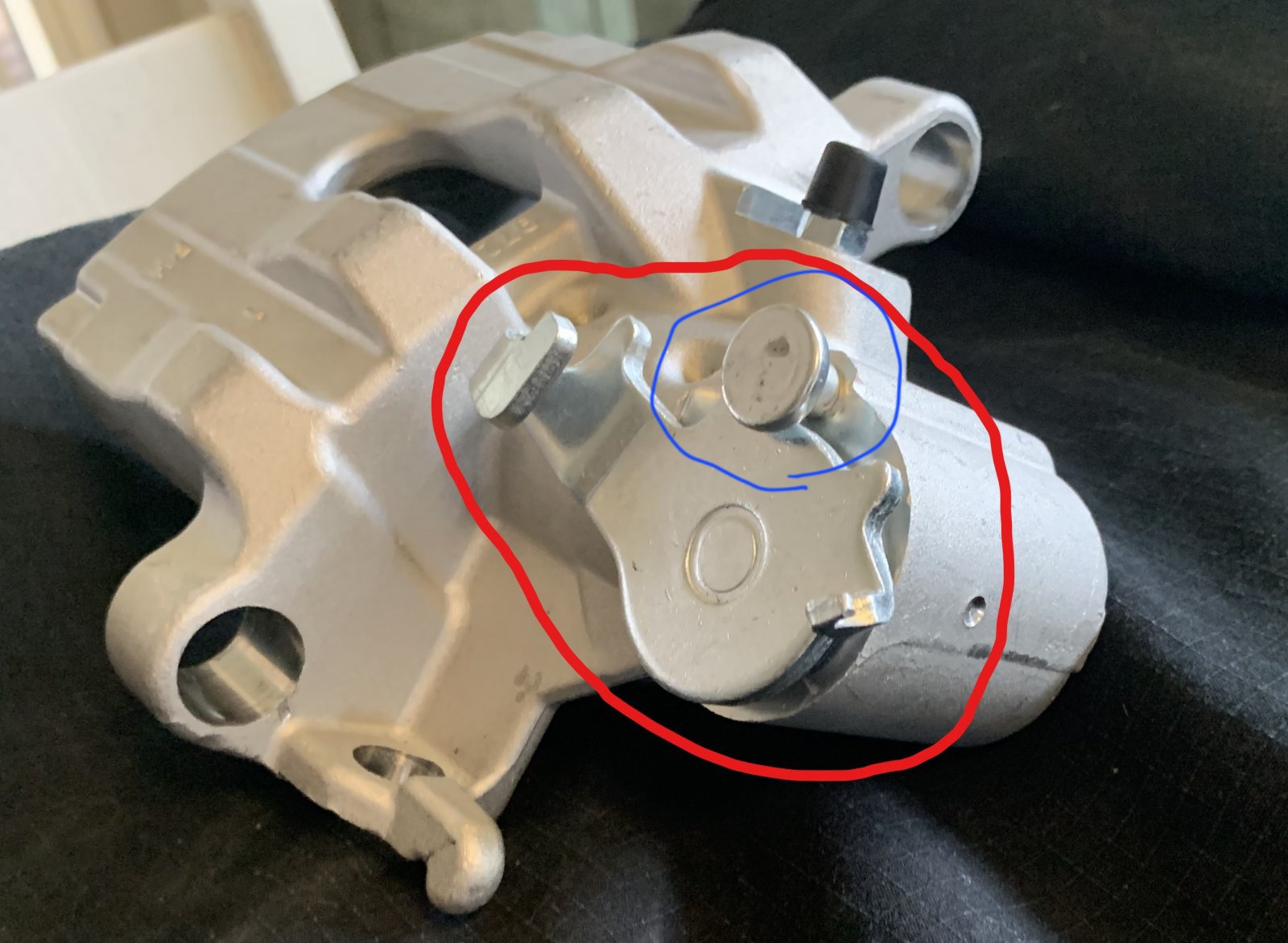

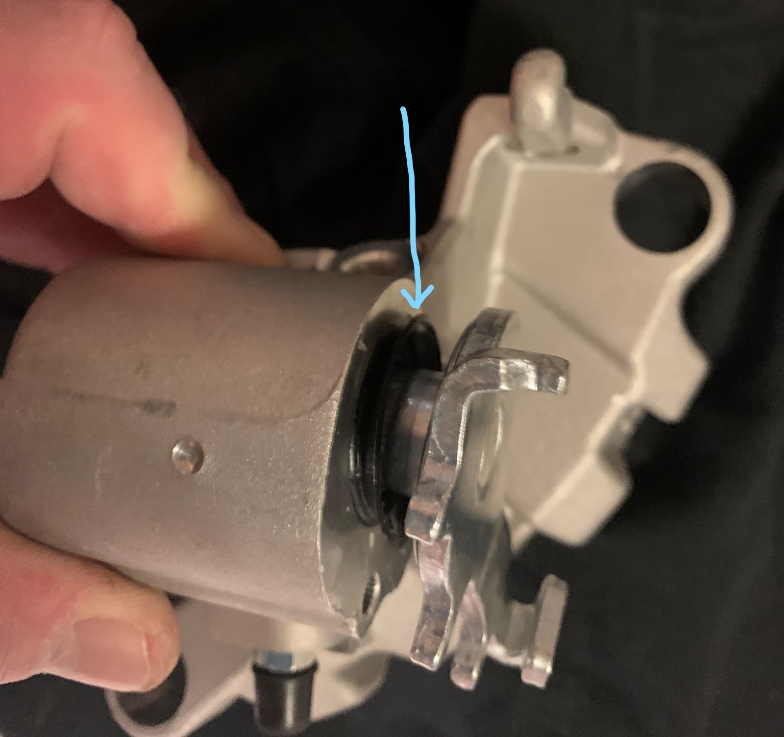

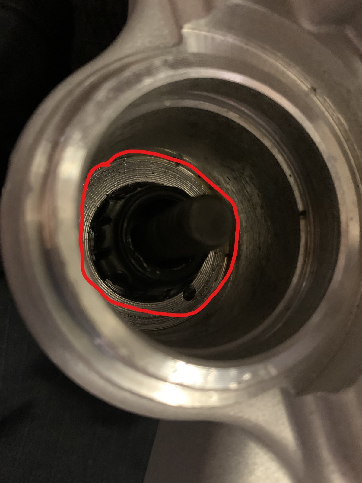

THESE ARE THE CALIPERS SUPPLIED BY DF, THERE IS A RUBBER SEAL DIRECTLY BEHIND THE CIRCLED PICTURE, I'VE GOTTON AS FAR AS PULLING THE PIN, AND IT APPEARS I NEED A SPECIAL TOOL TO REMOVE SOME SORT OF A SPRING METAL CLIP THAT SETS BEHIND THE PISTON

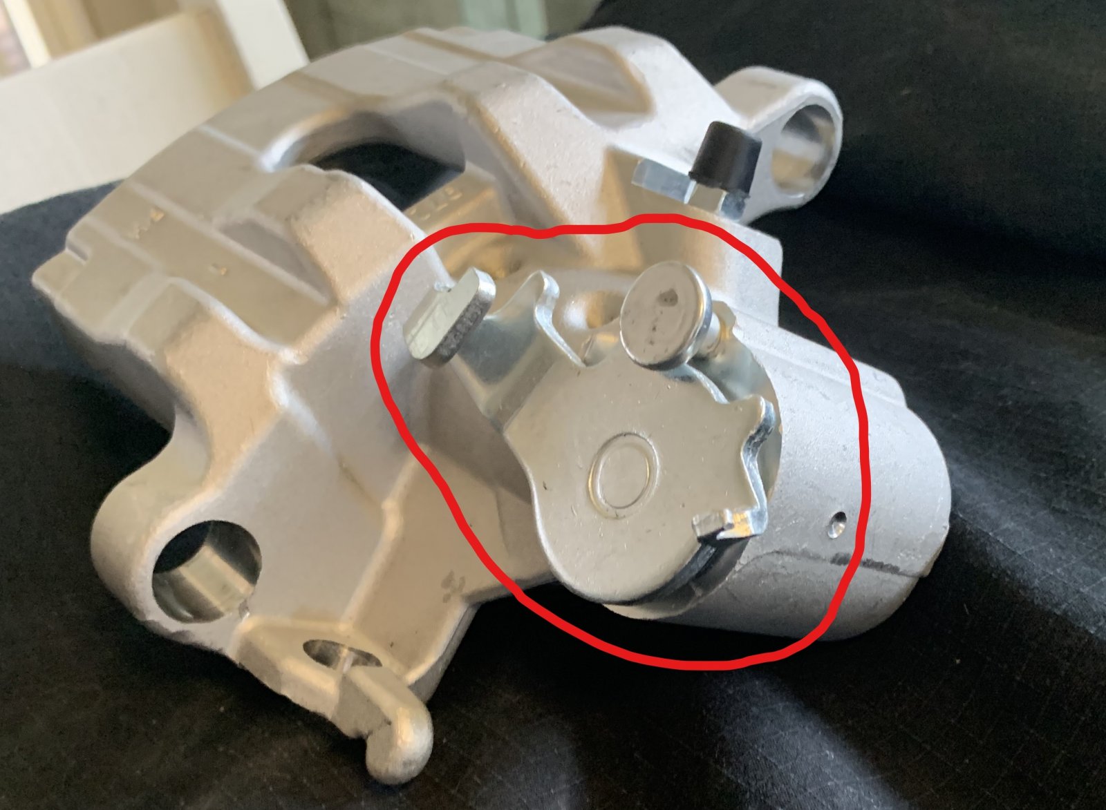

For anyone that is searching the 'parking brake disassembly' topic BEFORE making a run at it, DO NOT attempt to twist off the parking brake lever stop (blue circled portion of bigred's pic posted earlier). I did, and it took very little effort to ruin the brand new caliper by shearing it clean off.

I ended up purchasing a remanufactured caliper for powder, as the parking brake lever would no longer ratchet after the stop was gone.

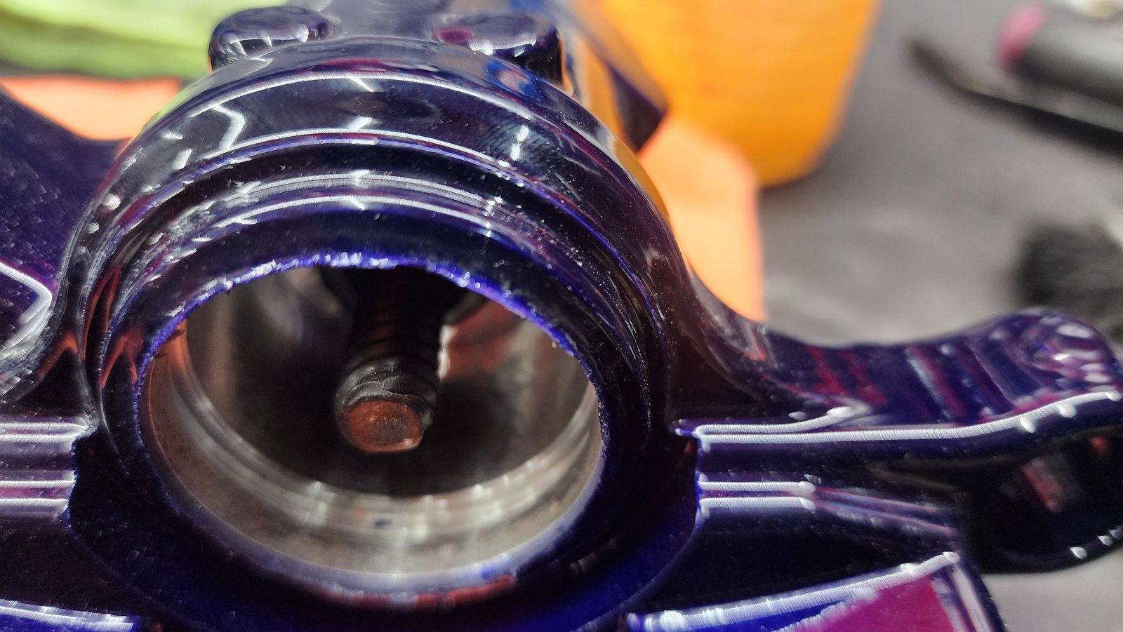

My powdercoater required sandblasting mine even though they were brand new. I removed the rubber components (slide bolt covers and piston seal) but didn't do anything with the parking break mishap I described above.
Also, the rear pistons should be "unscrewed" out, as compressed air won't work. Compressed air will work on the fronts though.
Lastly, make sure you tape off where the piston seals attach on the rear calipers. My coater only taped off the internal section and I had to sand the powder off to get them back on. See the pic.
