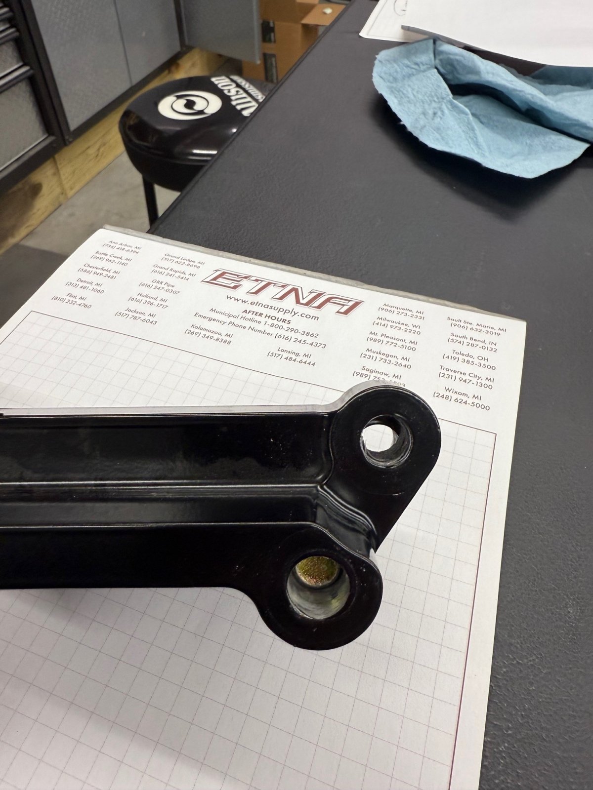

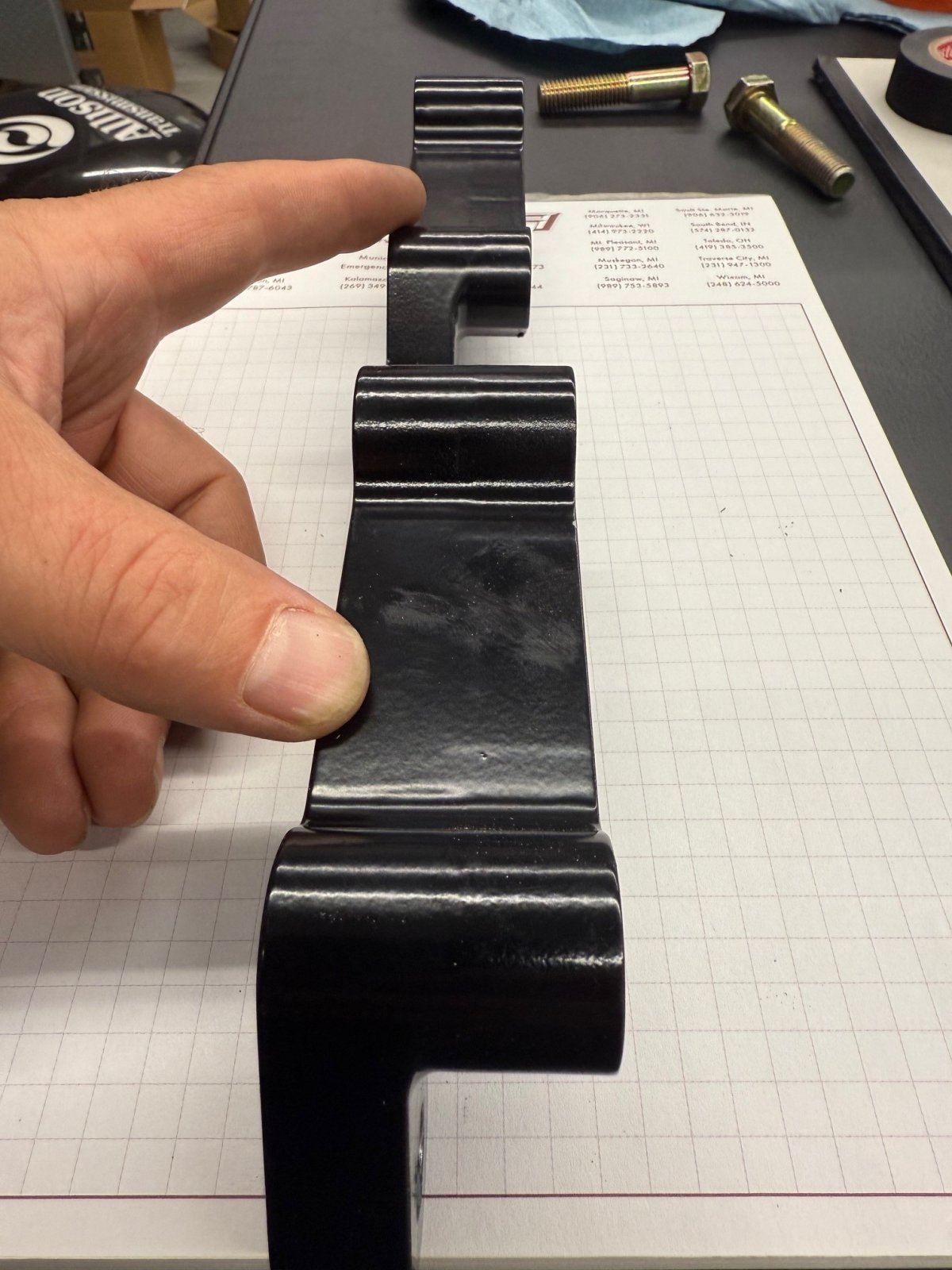

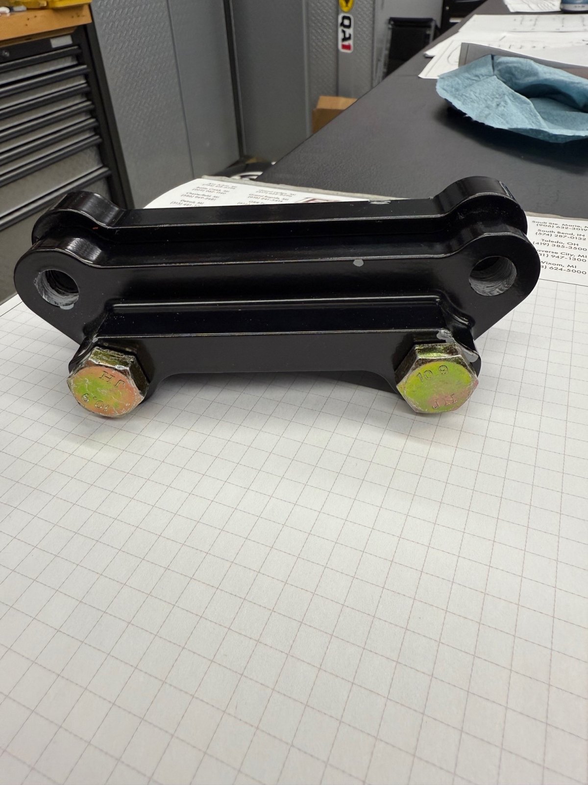

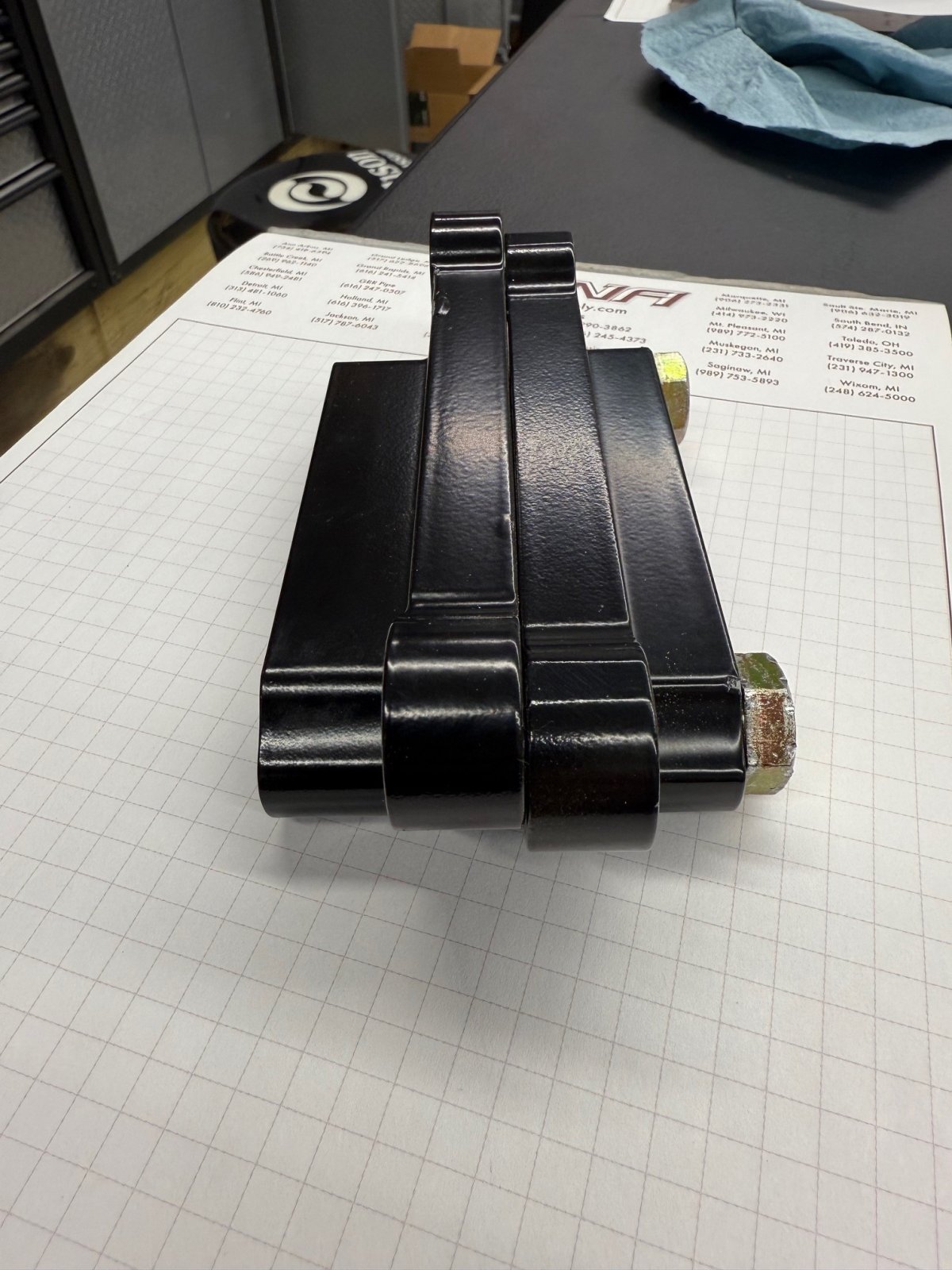

So I was installing my rear brakes and one side went on well but when I got to the other side the DF supplied aluminum caliper bracket is offset less and is overall thinner. My only guess here is that one of them is for and LNF and one is for an LSJ? Any ideas?

As a follow up to this there are different style DF supplied caliper brackets. LNF / LSJ are different. DF sent me the one I need. Thank you
