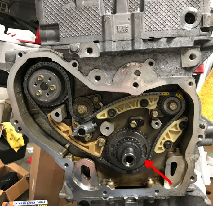

While I had the engine out and stripped I figured it was a good time to replace these parts. If anyone wants to do this, here are the notes from my “never done before venture”:
Order the following:
  • Cloyes 9-4201S Multi-Piece Timing Kit
  • Cloyes 9-4202S Balance Shaft Kit
  • For SC/TC cars the large sprocket that comes with this kit will not work. You can reuse the old one or purchase GM part number 12642713 (which I did)
  • Dorman 917-954 Timing Chain Guide Bolt (if you don’t already have one)
  • ACDelco 252-821 Professional Water Pump
  • You can use the old water pump sprocket or purchase a new one (I purchased a new one)
  • Mahle Original CS54440 Engine Conversion Gasket Set; cheaper than going with individual gasket purchases and more convenient
  • Magnetic Oil Drain Plug (if you don’t already have one)
  • Loctite 515 Flange Sealant
  • Harmonic Balancer (purchase new or use the old one); my car had 118K miles on it, so I purchased a new one
  • Harmonic Balancer Bolt (must purchase a new one if you plan on using your old harmonic balancer, at least that is what the manual says) GM part number 11589123
“Special” tools you will need (I had none of the following tools on hand. What can I say, I’m a computer geek not an auto mechanic):
  • Rent a pulley puller kit from your local Advance Auto or AutoZone. This is for removing the Harmonic Balancer
  • 1¼ inch or 32mm wrench or socket to remove/install the primary tensioner
  • 15/16 or 24mm open ended wrench to hold the camshaft in place while you loosen or tighten the camshaft sprockets/phasers
  • 10mm hex drive to remove the bolt access plug which will be replaced by the Dorman 917-954 Timing Chain Guide Bolt if your engine doesn’t already have one of these
  • Torque Wrench

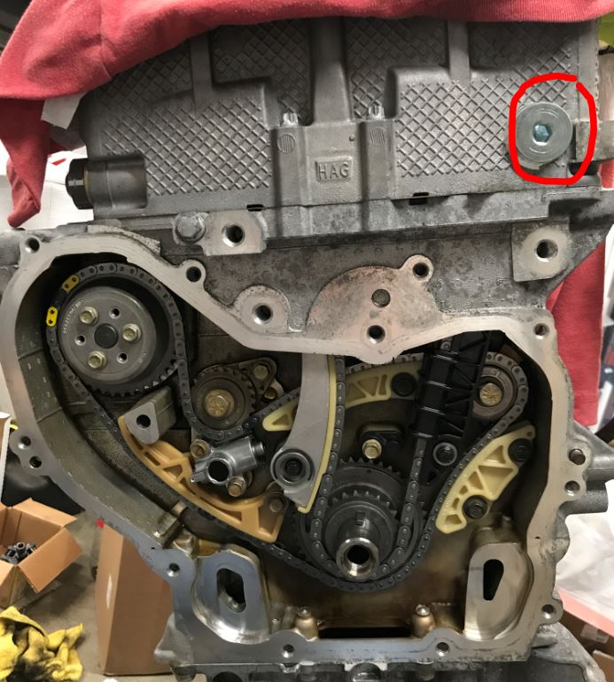

The two things I would definitely replace would be 1. the tensioner, which is the large 1-1/4 inch bolt on the exhaust side of the engine and 2. the top guide holding bolt, which is this guy:
https://www.dormanproducts.com/p-86...rttype=Engine%20Timing%20Chain%20Guide%20Bolt
The plastic guides may have wear and need replaced. Unfortunately, you really don't know if anything needs replaced without inspecting them and that means taking the timing cover off.

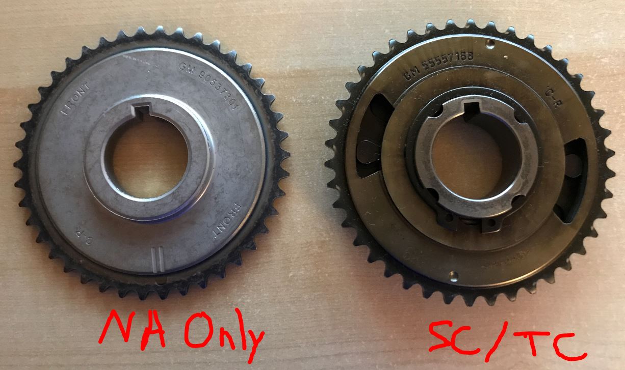

What large sprocket did you use in the picture below? The one with the Cloyes kit will not work and you can see they are different. You can only use GM part number 12642713...
9247
I don't remember the large one being different. I thought the two smaller balance shaft sprockets were the wrong ones because I kept them for a long time until I knew the engine was running fine and the finally tossed them. It may be differences in kits/engines.
JeffsGoblin
Chad, from my research, the large sprocket (right) is specifically for forced induction engines and you have to use the original or buy a new GM part number per the Cloyes video. The sprocket on the left is for NA engines and came with the Cloyes kit and will not work. The smaller balance shaft gears from the Cloyes kit should work just fine.
9250
The large one I reused per their guide I did remove the clip and reinstall.
