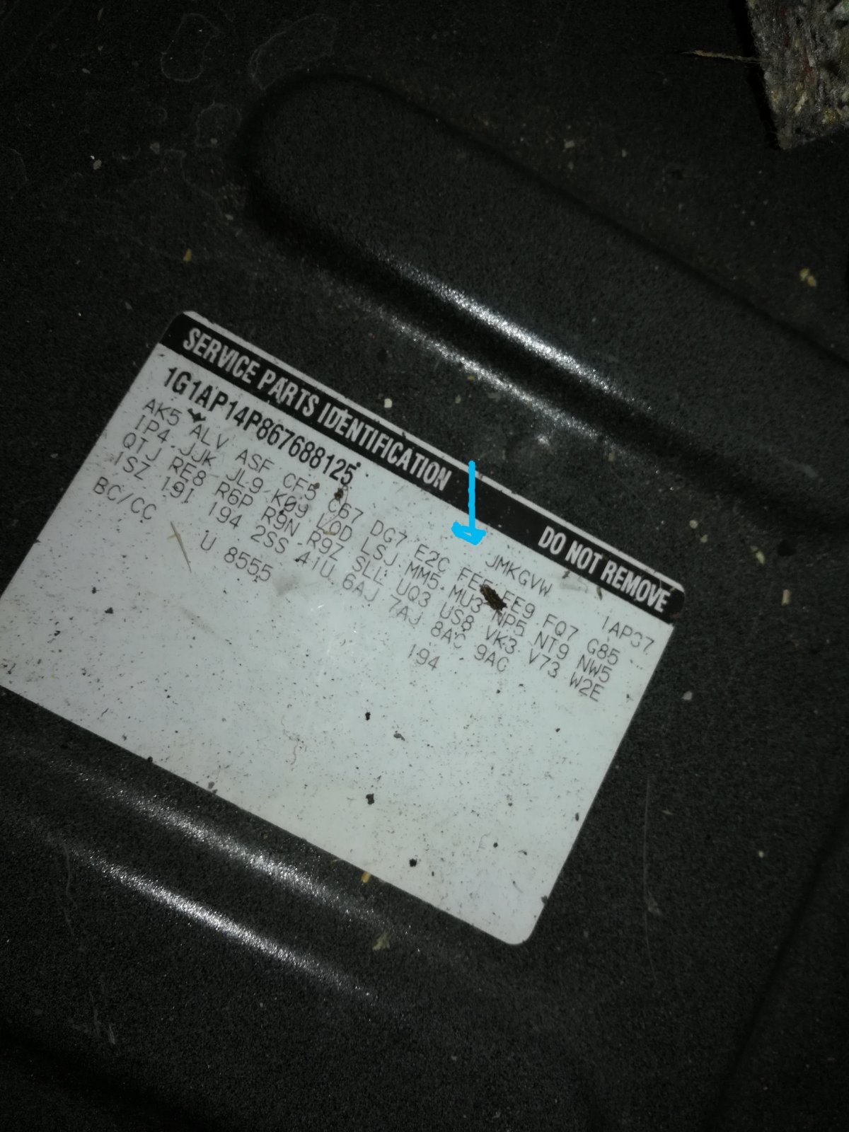

There are actually some FE5 SS/SC cars out there... I have one of them from 2006. Aluminum, fits the standard 2006 SS/SC knuckles, would be swappable to the FE3/FE1 from early models if I wanted. Trunk code definitely shows FE5. I'm not sure how rare this combo is, the car history on my donor started in the GM testing area of Michigan for a couple thousand miles before being sold into South Carolina.
Murcielago311
Huh, looks like I can confirm this. 06 SC.

The FE5 RPO code was used for all model years, but was revised for 2008 because the SS/TC used a revised knuckle. I've posted about the applicability of the suspension RPO codes to specific donors previously.
My 06 SS/sc is the same. FE5 on RPO code with steel control arms stock. The aluminum ones fit perfect. I even mic’d the ball joint to confirm size.
