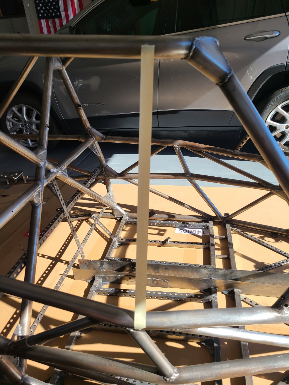

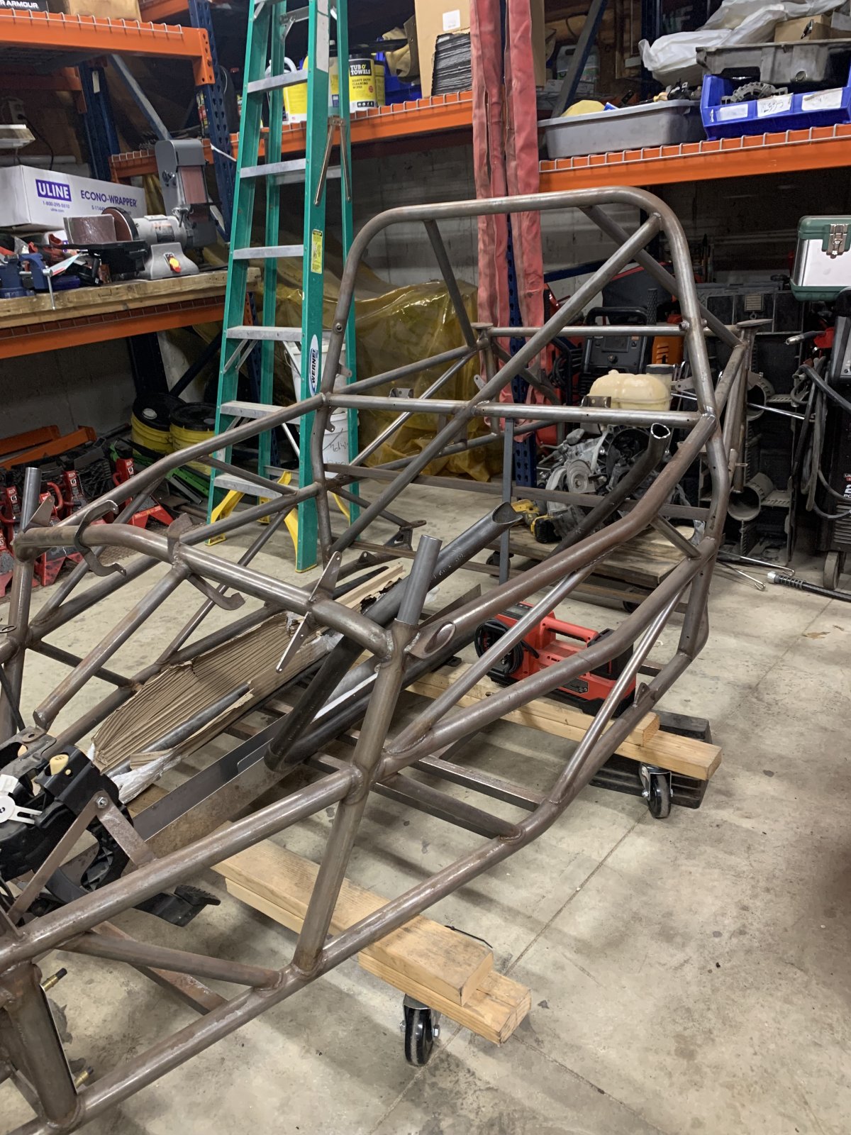

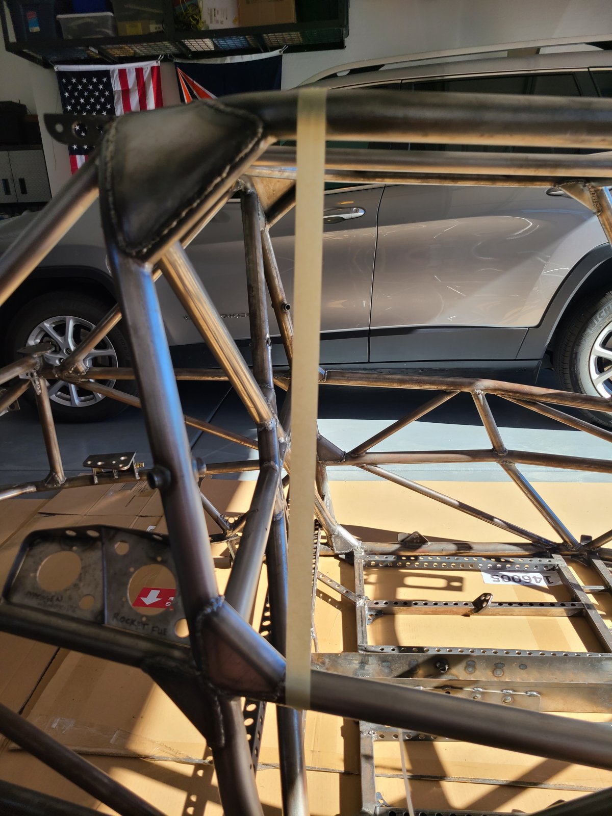

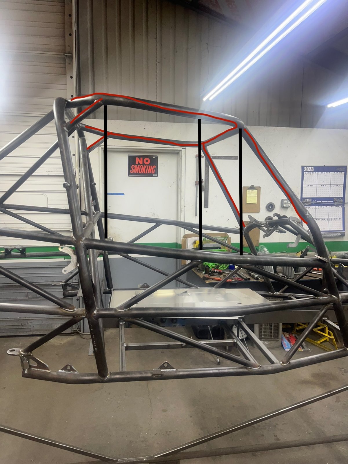

Hello so I have an extended frame, regular side entry with no roll cage. I ordered the full roll cage from DF and I am gonna weld it on in the next couple days. I am looking for some measurements from the side entry to the bottom of the halo. attached are some images showing what measurements I am looking for (the black lines). I would really appreciate those three measurements at those points so I can use them to make sure the halo is sitting right. Thanks

From left to right:
19 1/2 inches at the upper frame tube up to the bend in the upper halo
20 3/4 inches at the bend in the upper frame tube up to the upper halo (centered between your two forward lines in the pic)
Hope this helps. :D
