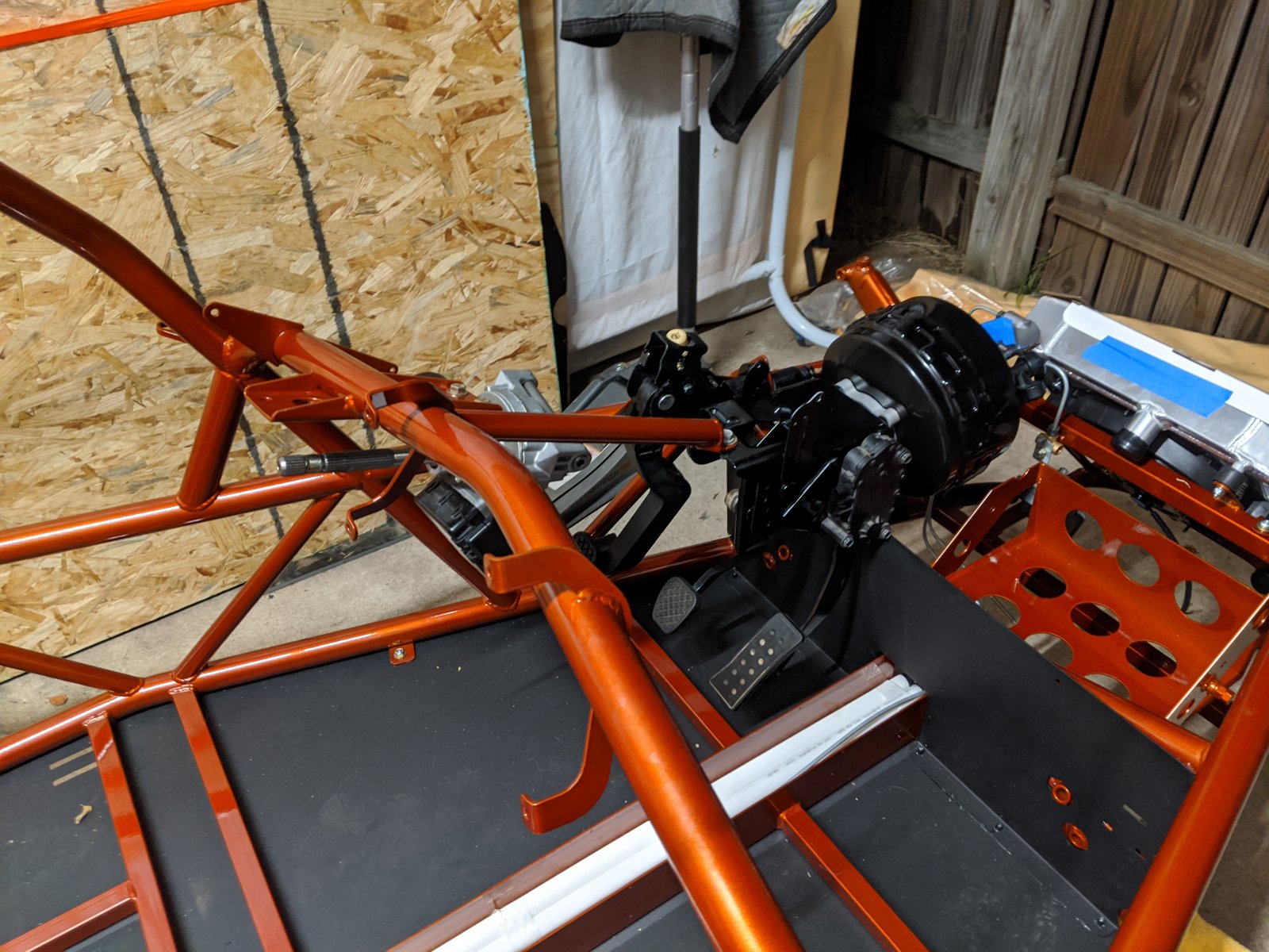

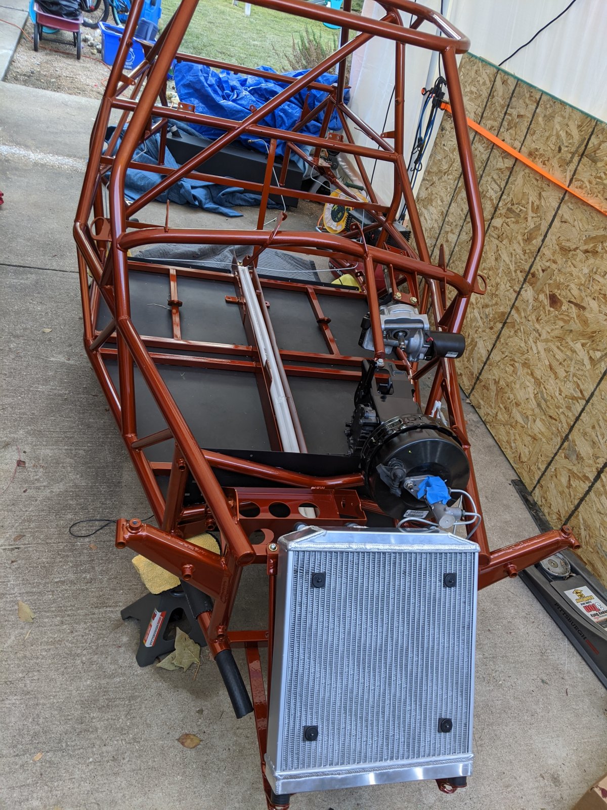

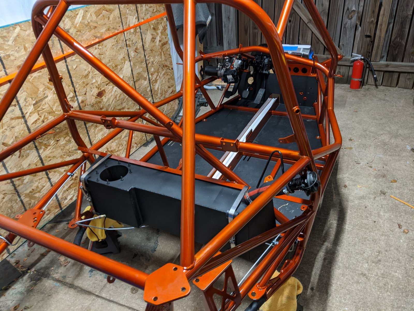

Made some progress over the weekend. I'm feeling pretty space constrained sometimes its like jenga moving parts to get to other parts. With that in mind the more I can bolt on the car the better. I also had some "help" from my youngest son.
10686
10687
10688
10689
10690
I got the brake lines, clutch lines, pedal box, power steering, pedal box, brake booster, radiator, and gas tank mounted. I decided to order a new steering rack so that is on its way. I hoping to take off most of Thanksgiving week and make some progress on some of the engine and transmission work I need to do before mounting.

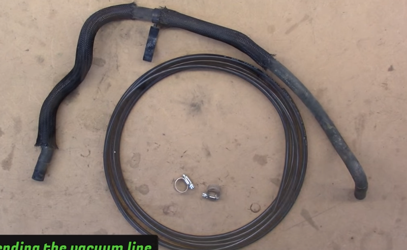

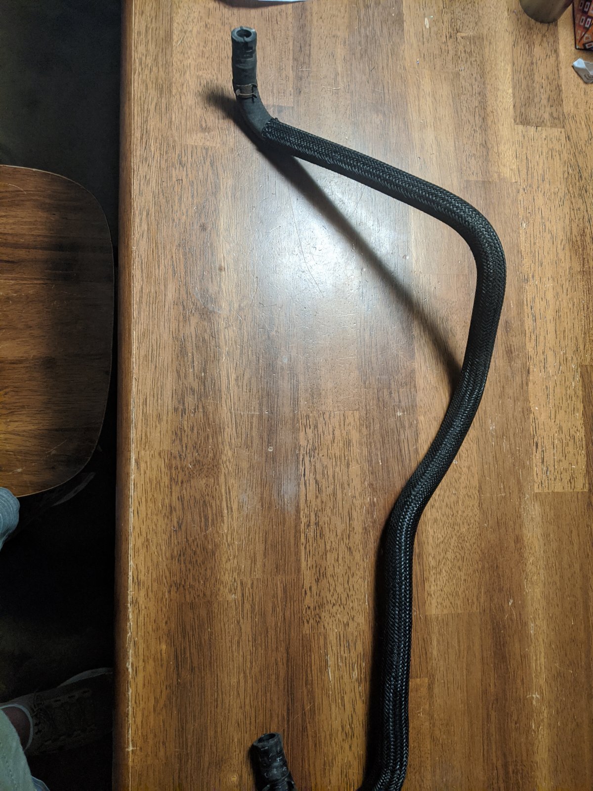

3. For the vacuum hose running from the brake booster to the back of the car my hose doesn't look like the video. The closest I can find is the hose below. In part 17 of the build guide they have us measure 6" from one end and then cut, measure 2" and cut again. I'm not sure what they do with the 6" piece later. They show using 2" to connect to brake booster. Is this a difference in in Turbo vs. N/A? or do I have the wrong hose? If so what is the hose called so I can order a new one.

WRT vacuum lines, our kit included a roll of nylon-ish/semi-rigid(?) tubing which, in addition to the brake-booster-vacuum run is also suitable, as I recall, to convey brake fluid from the reservoir to your clutch and master cylinder.
Yes in the video they show cutting a 2 inch piece of original vacuum hose off to use as an adapter for the nylon roll. I can cut that out of the hose pictured, just not sure what it was for originally. Also in the video they cut off a 6" piece and say to set aside for later. I don't remember them ever doing anything with that piece later though.

The vacuum and cooling-line installations are going to require a fair degree of creativity and initiative from the builder. In our case, I got so creative that I nearly ran out of hose clamps (did run out of those ~1" splice pipes and had to make a few extra). Ended up with a quite-satisfying result, though.

Thanks for the replies. I got the radiator plumbed in and made executive decision on the vacuum hose.I tried with the steering column but will be ordering a new one.

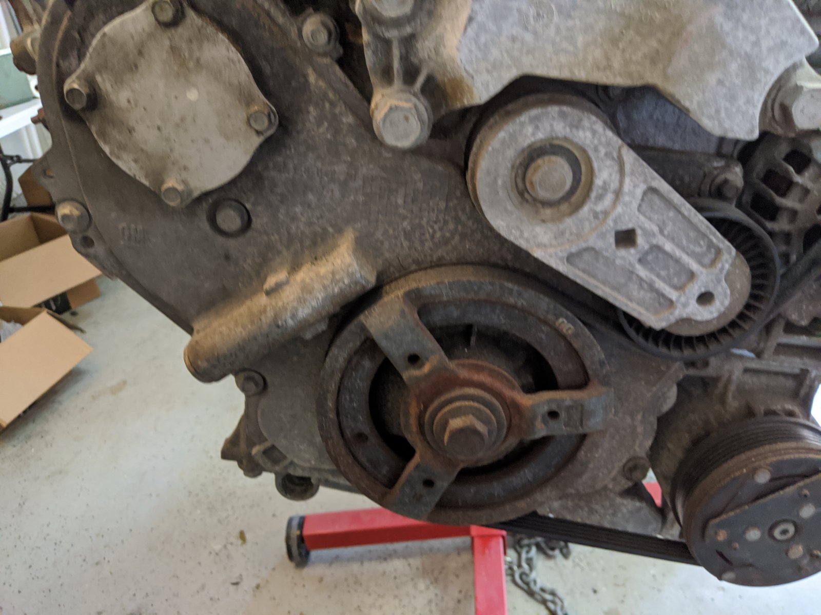

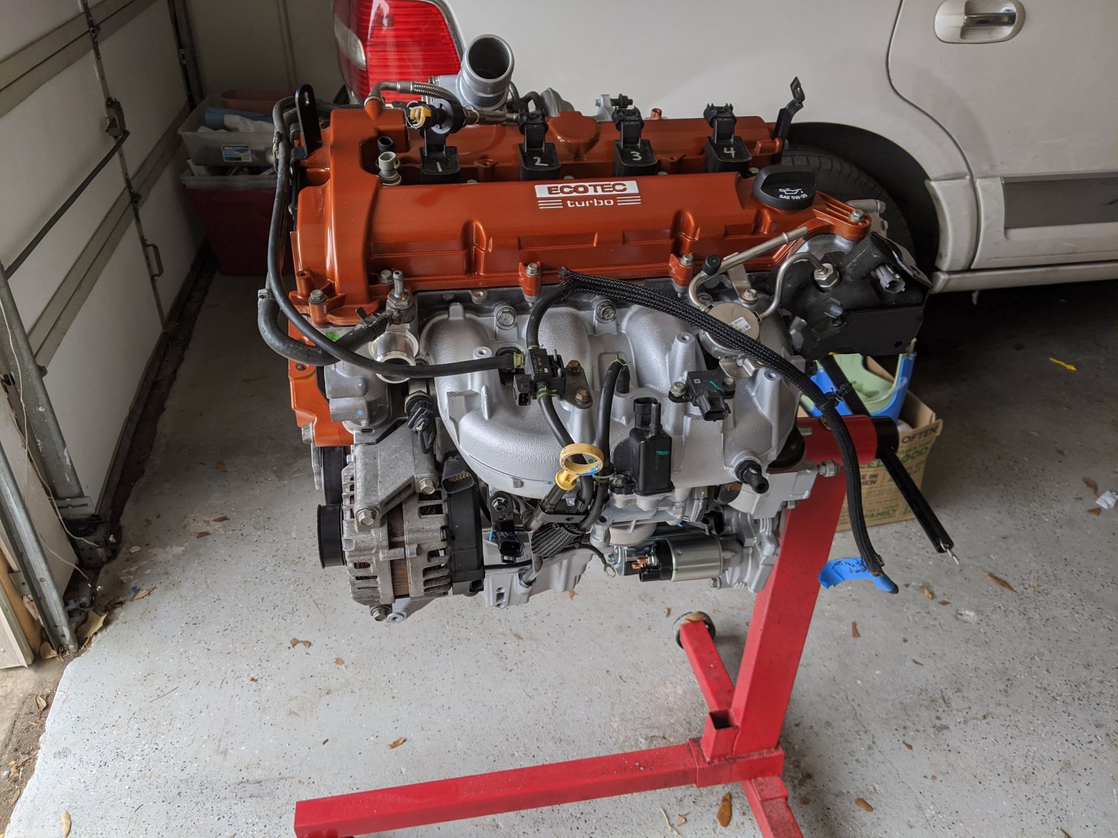

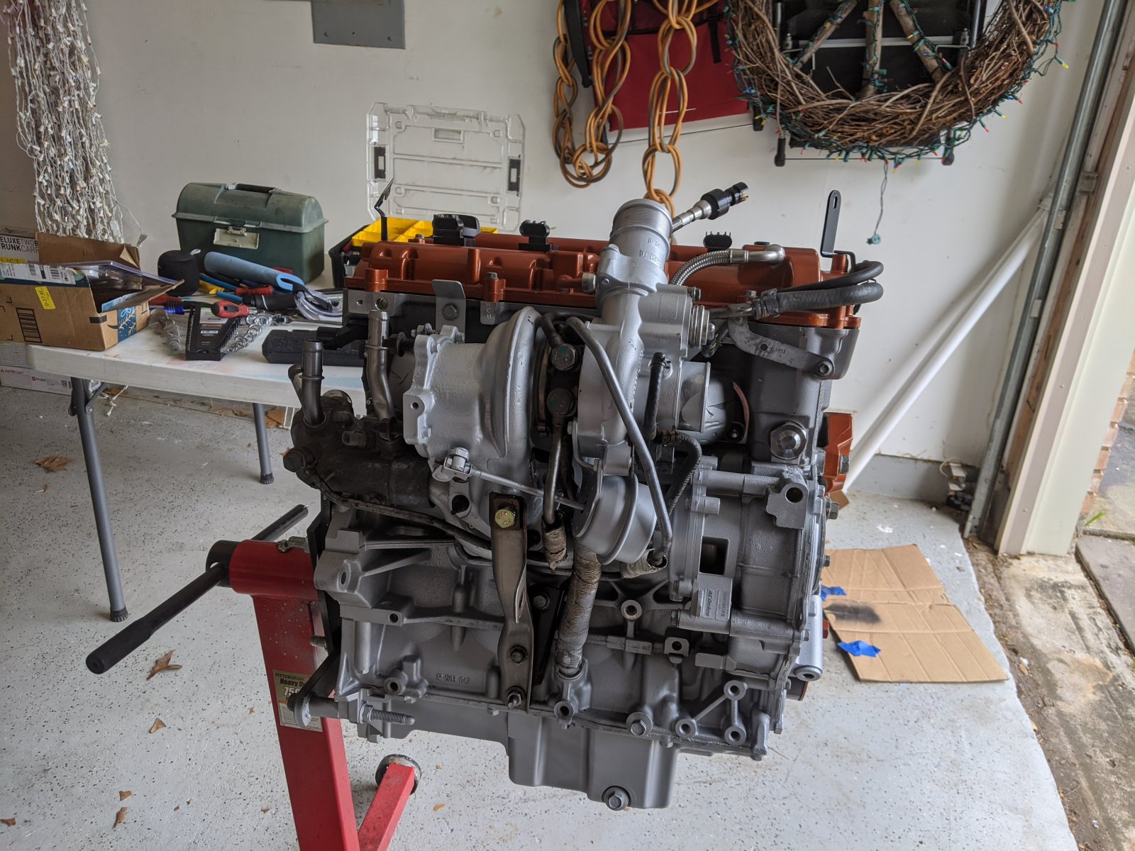

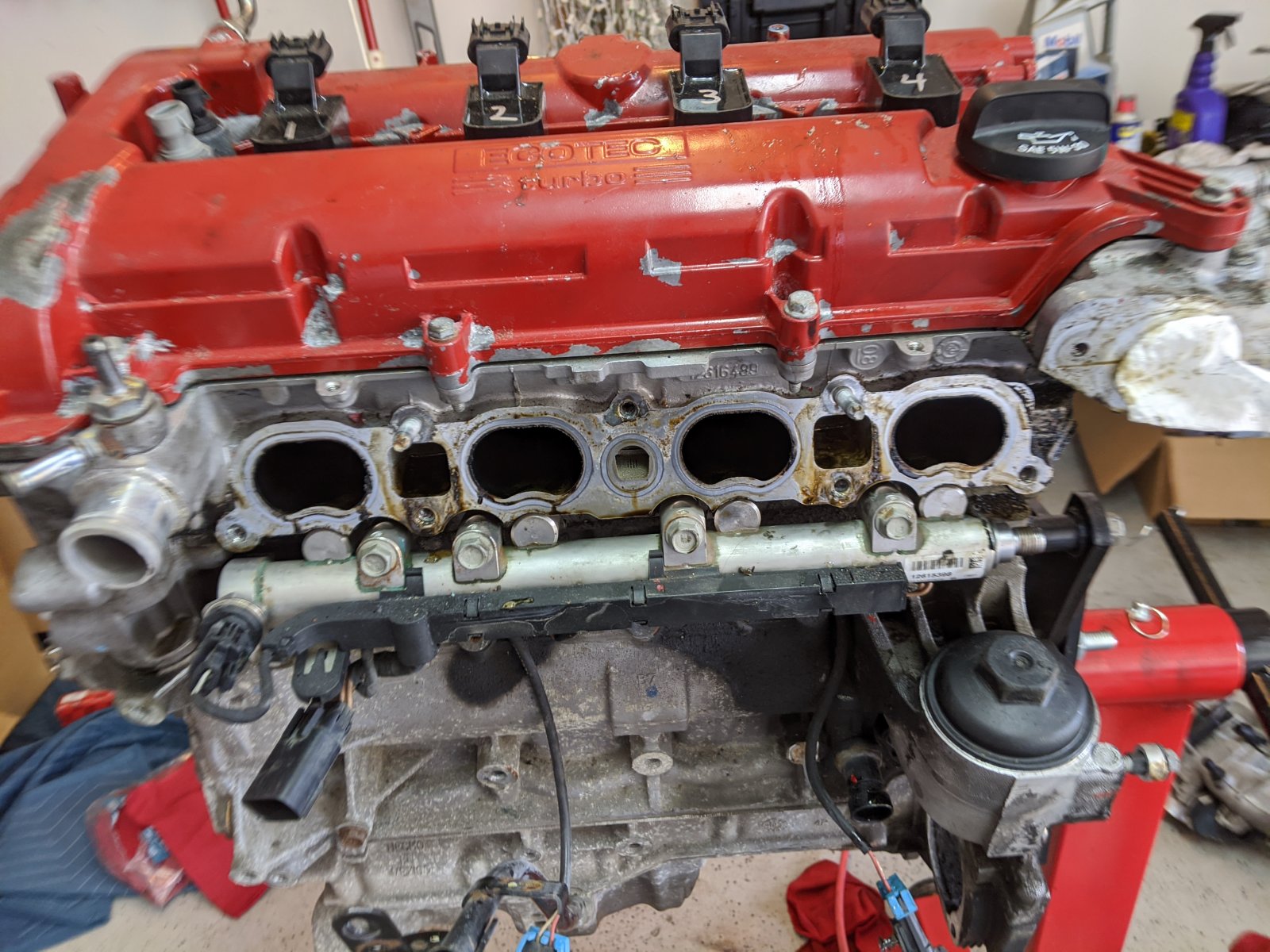

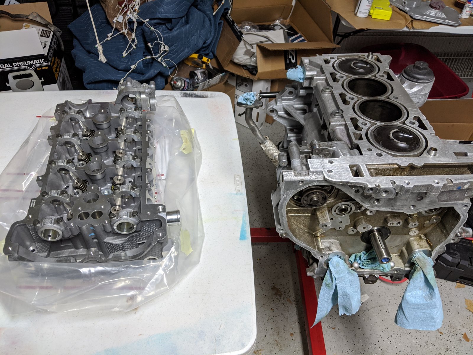

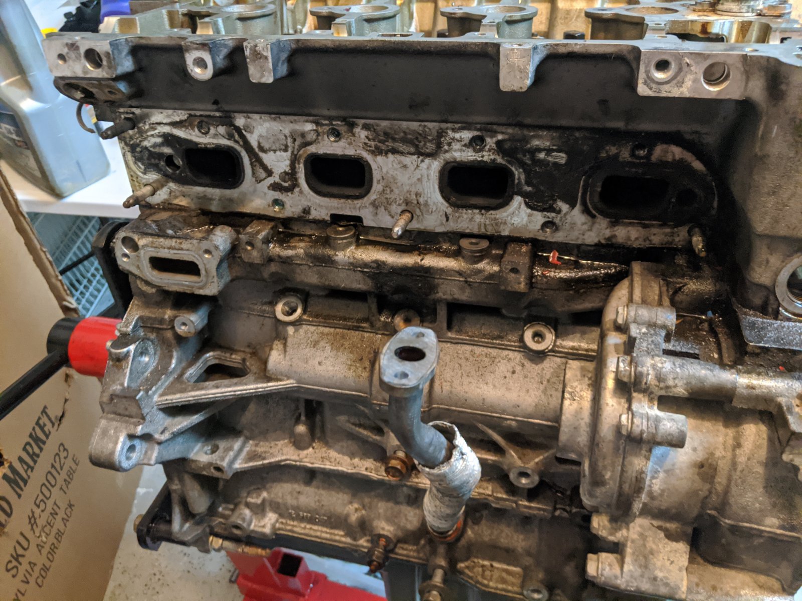

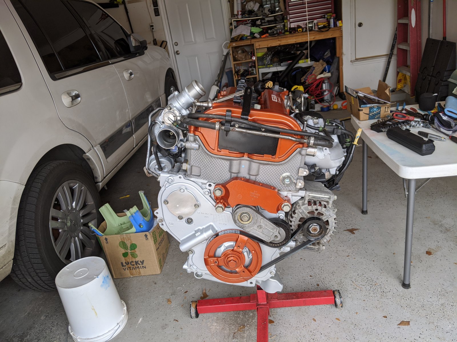

It's been a few months since I have updated the build log. I haven't been idle but have been going pretty slow cleaning up and rebuilding the motor a bit. I am finally ready to take it off the engine stand and mate it to the transmission. This has been a huge learning experience, which was the point but the more time I spent with the motor the more I wished I had bought a new crate motor.
Before:
13007
13009
13011
13012
After
13013
13014
13015
