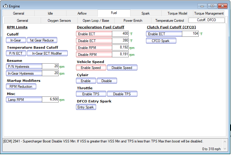

In order to create your own template, start with a tune file you want to use as your base to work from. Doing a Full Read from you vehicle is a great place to start. Then make all the changes to the file you wish to make as part of your template. Make only changes you want included in your template.
For example, these are changes I want to make as part of my template highlighted in pink:

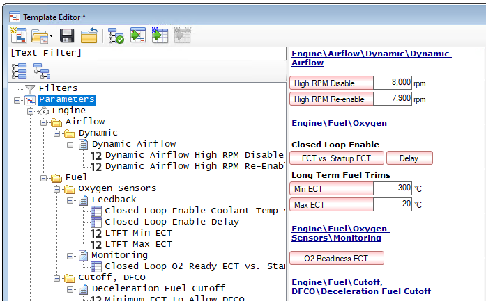

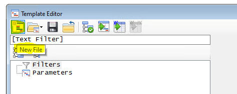

Next, go to [Tools] [Template Editor] and click on the [New File] icon.

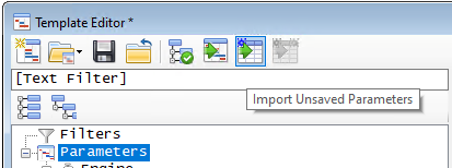

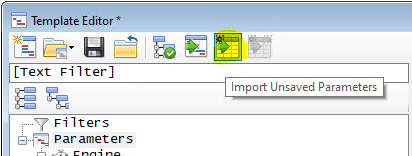

Next, click on the [Import Unsaved Parameter] icon.
Now you will see all of the parameters that have been changed since you opened your base file. On the left is the tree to each of the parameters and on the right a list of the actual changes in each parameter. This is just an example below.
After you verify all of the changes are correct and this is exactly how you want your template set up, click on the [Save File As] icon above and save the file to a location you know (usually in your Templates folder which makes the most sense). See, I told you it was easy. Now, for how to apply your new template.

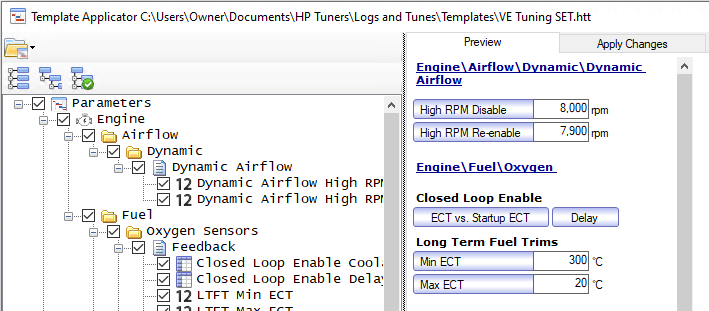

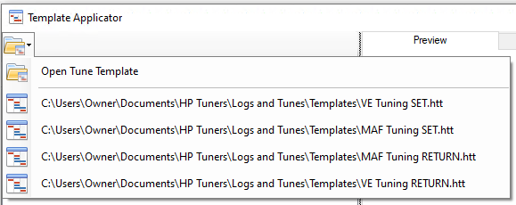

Go to [Edit] [Template Applicator] and click on the [Open File] icon (do not go back to the Template Editor, the editor and applicator are two different things). Select your template file you created.
It will display all of the changes between your base file and the template.

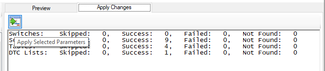

Verify all the changes just to make sure you selected the correct file and then go to the [Apply Changes] tab. Click on the [Apply Selected Parameters] icon.
You will see the successes and hopefully not failures. The only reason you should see a failure is that the base file and the template file are different in structure, such as different vehicles or ECMs.
Now write the flash to the vehicle and you have successfully applied a template.
