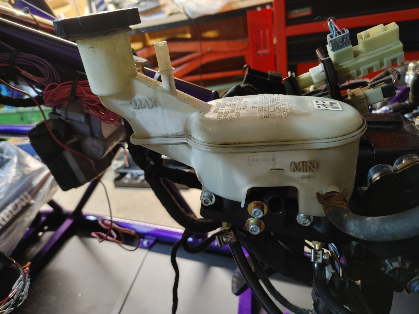

Brake reservoir installed and connected to the clutch/master cylinder.
32734

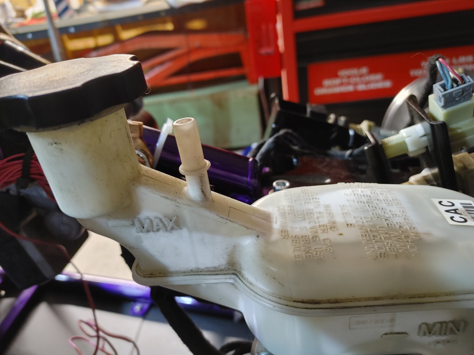

What is the function of the nipple on the top next to the cap? I don't recall anything being connected to this on the donor:

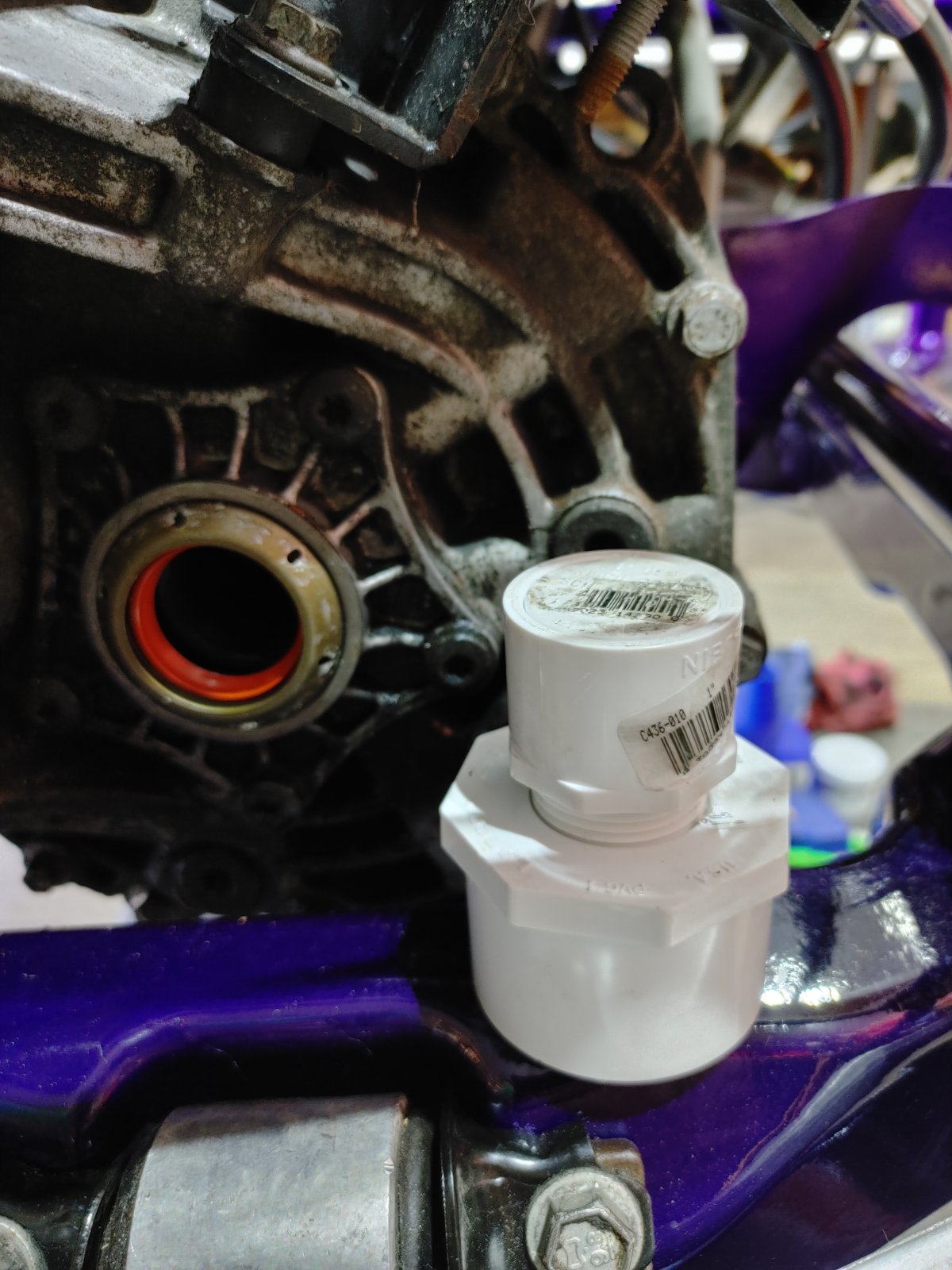

I was able to get the axle seal installed. I don't have a seal install tool so I made my own. After trying a large socket with only a ruined seal to show for it, I brought my other seal to Menards to build the right tool.
A 2"x1" Bushing, a 1" PVC Male Adapter, and a 1" PVC Plug turned into the following tool:
32861
It fit the seal perfectly and after a few swings with the dead blow, I switched to the 3 pounder and it was in with 2 swift swings. The PVC didn't crack and the entire seal snugged up flush.
My new axles came with axle nuts, but my donor axles used washers and nuts. Should I be re-using the washers on the new axles?

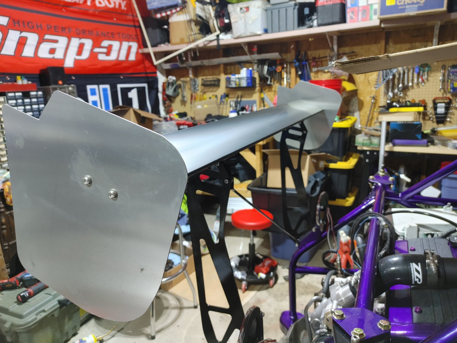

Bolted on some stuff in between swearing at the brakes:
