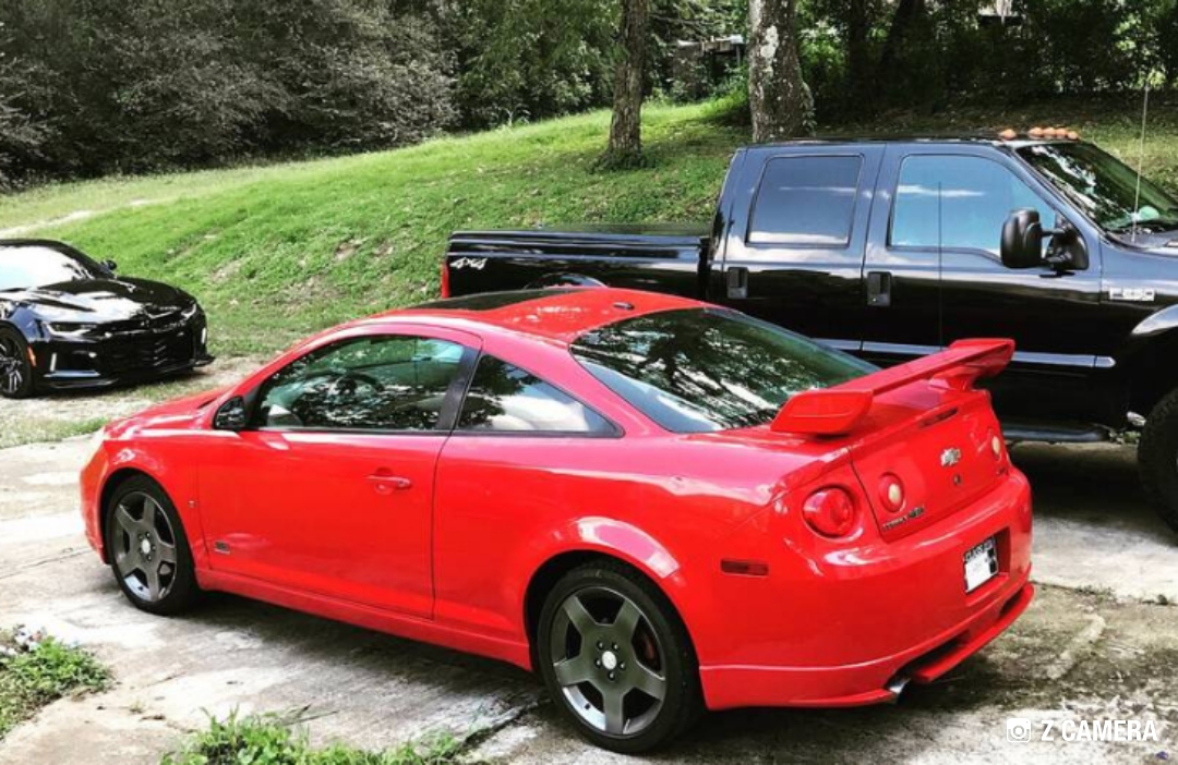

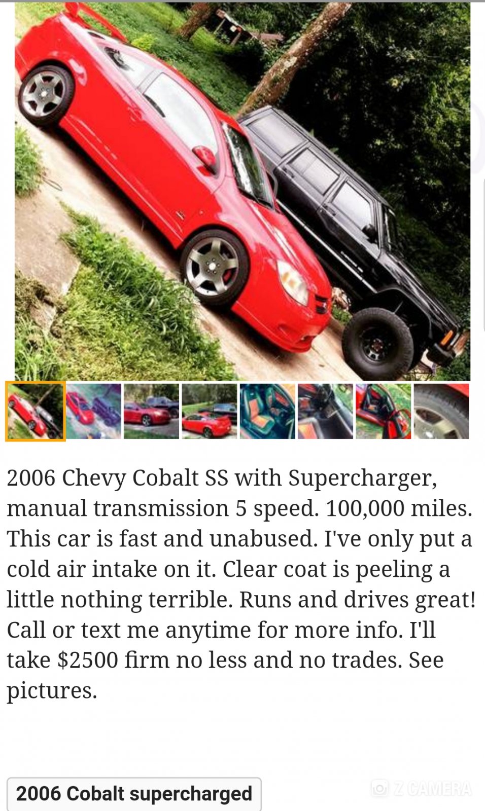

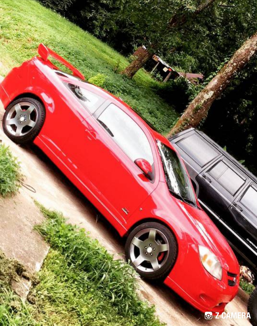

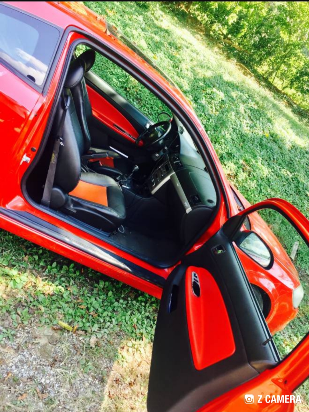

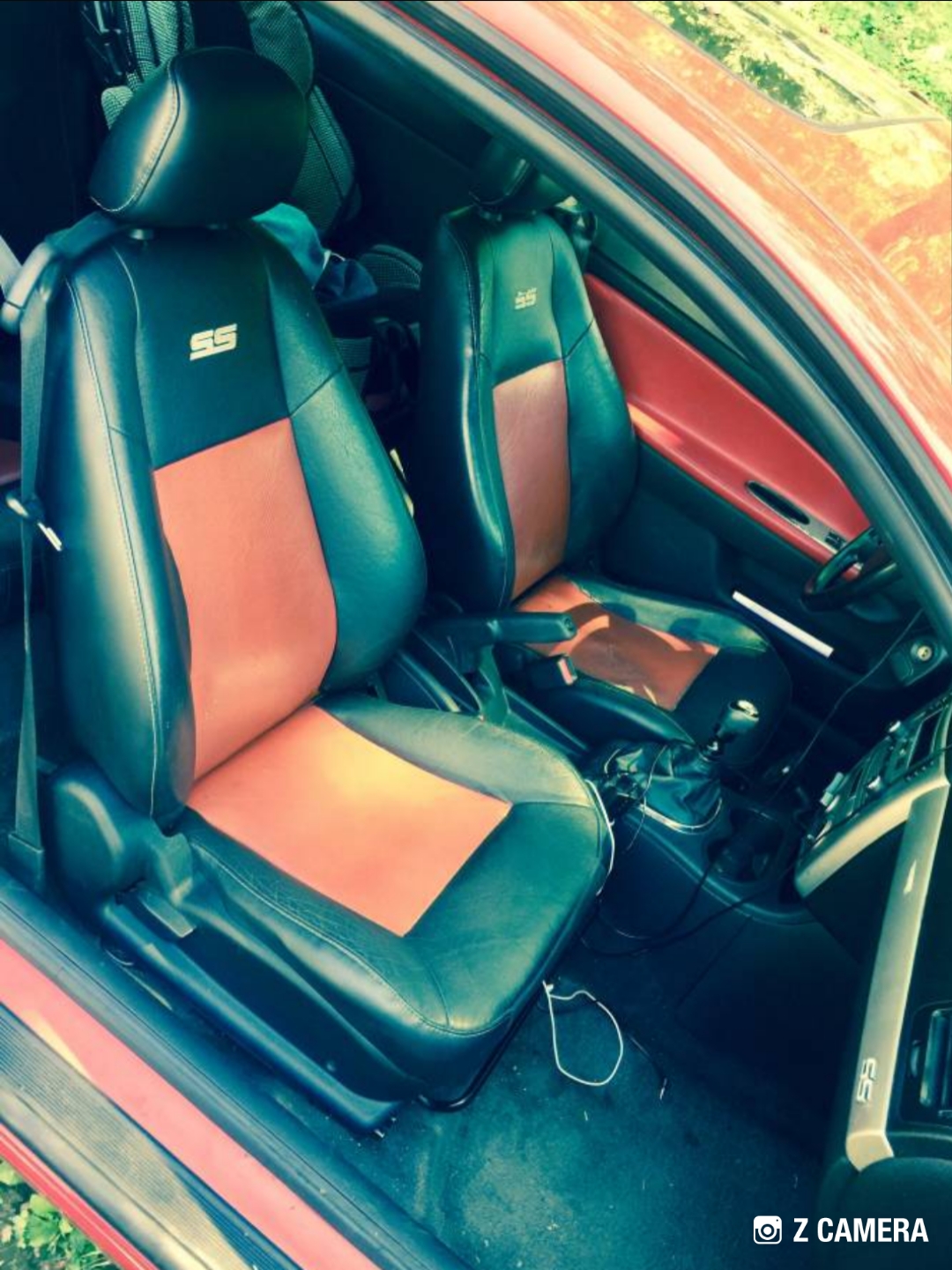

Well I caught one today within a few minutes of the guy posting his Cobalt SS for sale on Craigslist. 2006 SS SC just turned 100k with the 5 speed (not sure which one yet). Only modification that has been done since it was new is the cold air induction. Called him and we figured out a time tomorrow to meet up around 11 so I can look it over and drive it. His asking price is $2500 firm for it. What do you guys think for a clean title car right about an hour drive from home that looks like this.

Jump on my it! I paid a little more for the exact same car that had some damage plus fees, etc.
I had the cash on me yesterday. I offered to go ahead and meet up with him before dark yesterday, but he was going someplace with his wife. I will be there around 10 or 11 today to meet up with him when my doctors appointment is over... Im taking a driver for my truck Just in case Im coming back with two vehicals
