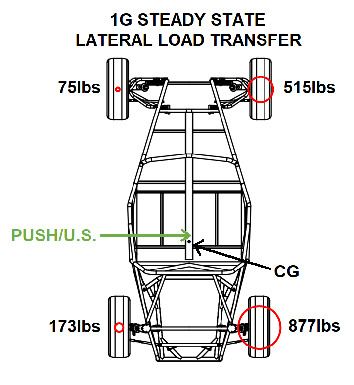

Steady State Weight Transfer:
38082
The image above is a graphical representation of the steady state lateral load transfer in a corner with a lateral acceleration of 1G. The red circles represent the vertical load on the tires.
The green line represents the front TLLTD. If the front TLLTD is greater than the front weight distribution, it will contribute to understeer/push. If the front TLLTD is less than the front weight distribution, it will contribute to oversteer/spin. There are many factors that contribute to the overall balance of the car, and this is just one of them.
The Goblin's front TLLTD is 2.5% higher than it's front weight distribution, which contributes a small amount of understeer/push.

At approximately 1G lateral acceleration, the front inside wheel will be at full droop. Higher accelerations will result in the tire coming off the ground.

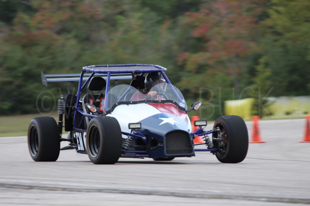

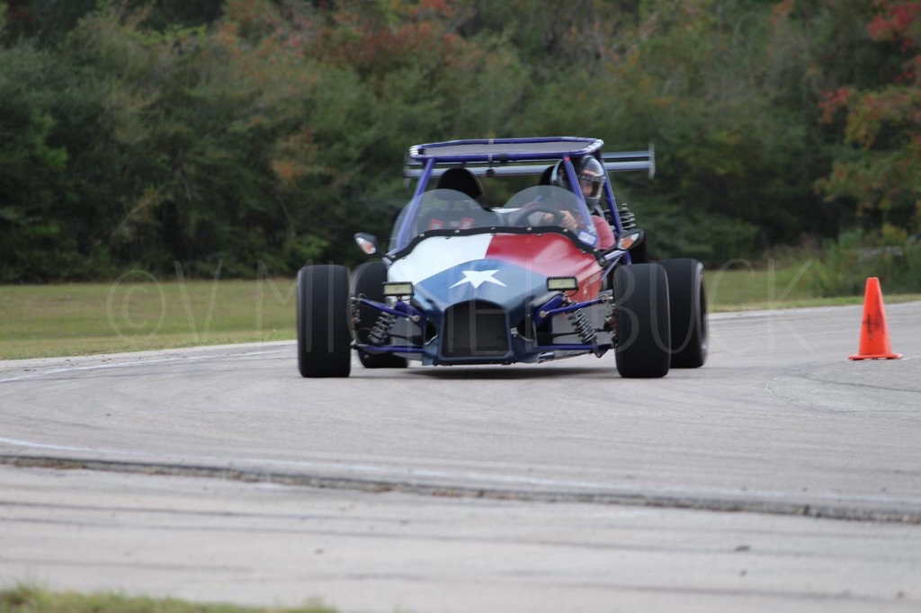

I think some pics we have taken (in general) visually support your conclusions.
