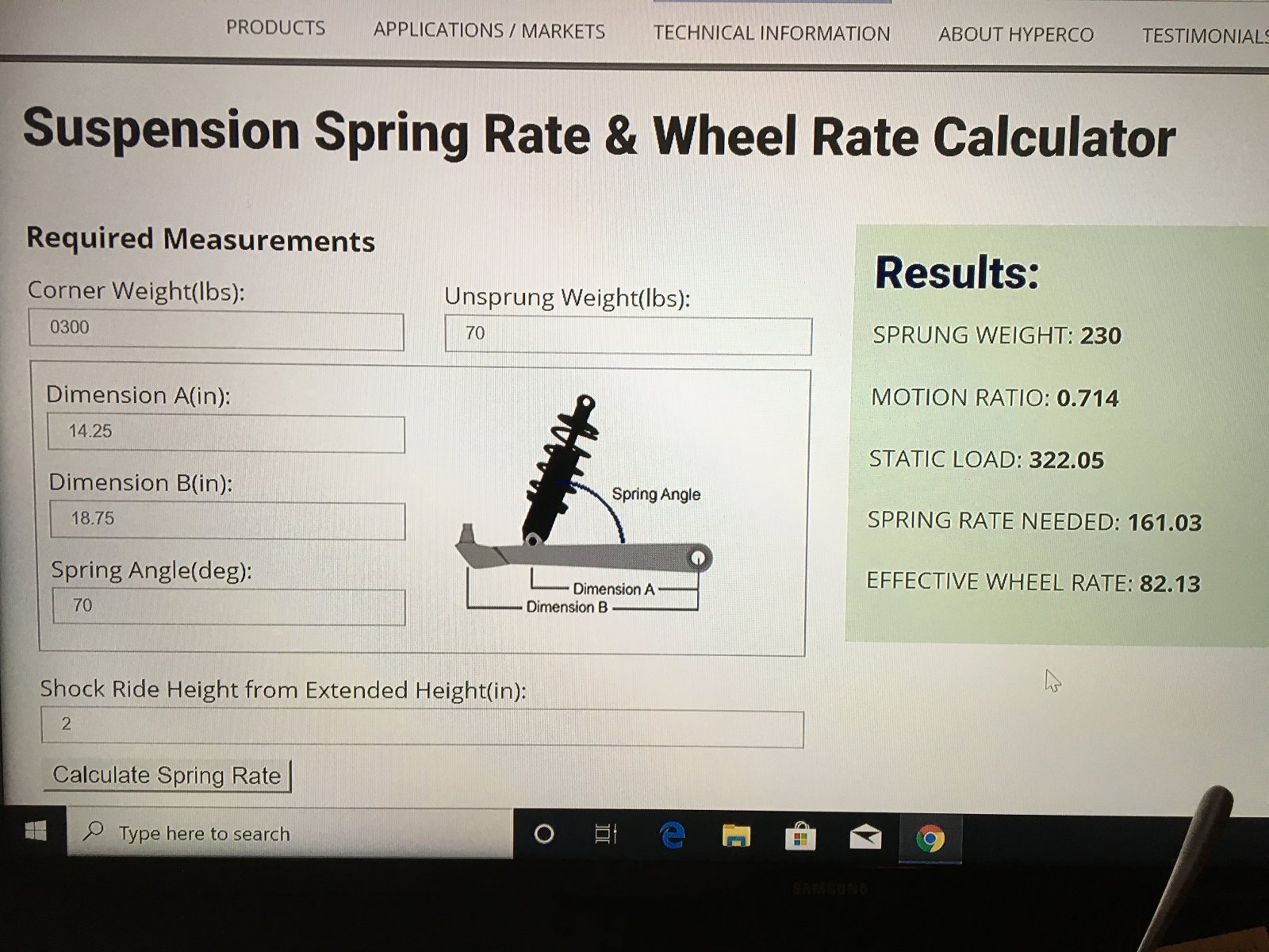

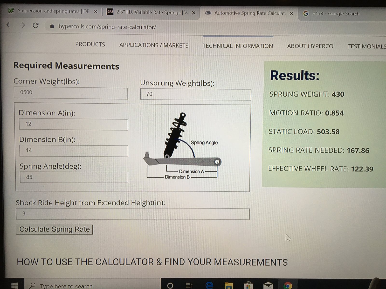

On the rear the wheel rate is about 89% of spring rate. I use 50% when guessing front wheel rate.
If you use a 500# spring your rear spring will hanging loose on the inside wheel of a turn.

On the skid pad rear inside was in the air with the 175lb springs ! 500 was way to much !
Are you running the rear swaybar? The SS came with a 23mms - way too stiff - but the base models came with a 18mm, which has possibilities. It would allow running softer springs but still keep the inside rear wheel on the ground. In my thinking, getting the rear to keep both wheels in contact with the pavement using as soft springs as possible, then tune the front to match as it has much more adjustability. :)
