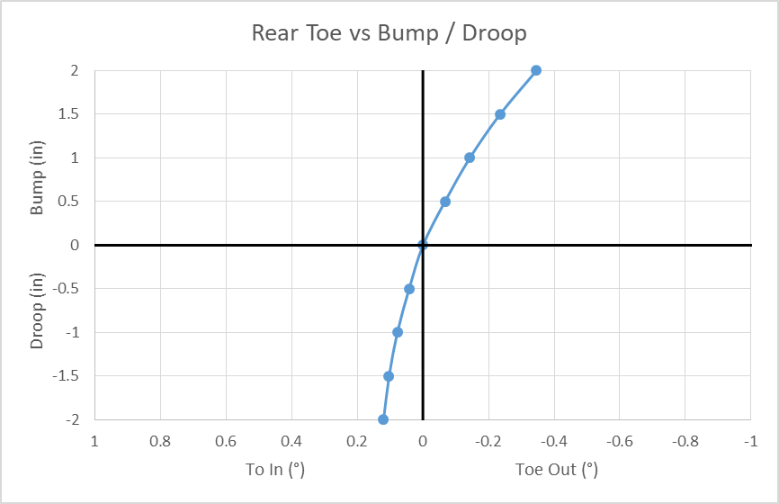

Toe:
38041
Here we have toe out on bump and toe in on droop. This contributes to roll oversteer in the rear. There are many factors that contribute to the overall balance of the car, and this is just one of them.
Understeer and oversteer are not necessarily good or bad. Some highly skilled drivers may prefer oversteer, because of their ability to adjust and react quickly. Most production cars are setup with understeer, because most drivers are not skilled enough to take advantage of oversteer characteristics.

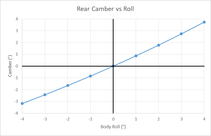

Camber:
38042
In general, as this curve approaches horizontal, grip in a corner will go up and grip in a straight line while accelerating or decelerating will go down.
The main drawback of the strut suspension is it's poor camber gain characteristics. The roll camber here is quite low, even by strut standards. This may be a good drag setup, but not ideal for street or track use.

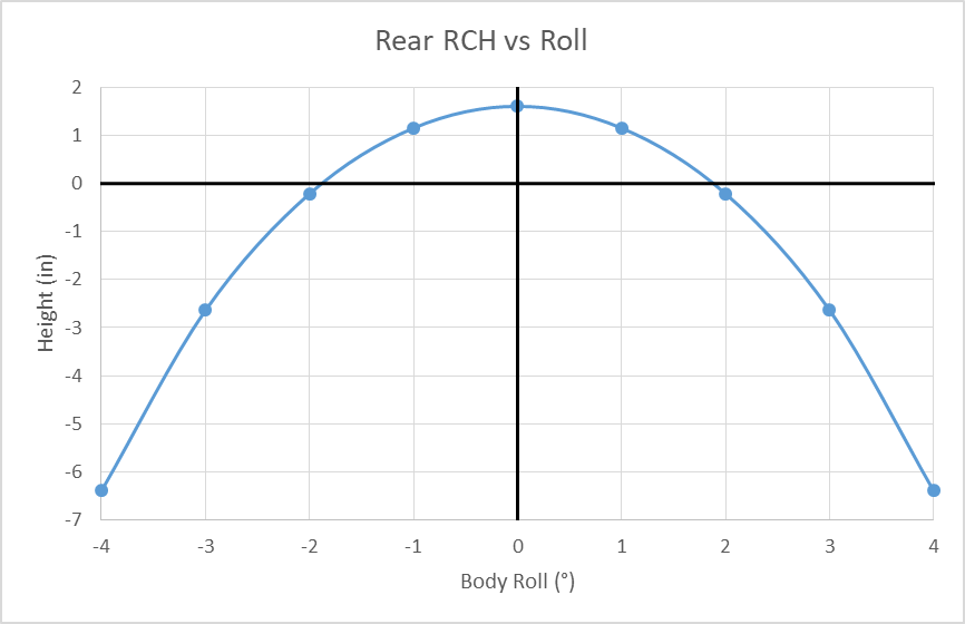

Roll Center Migration:
38043
There is some debate over the importance of lateral roll center migration, but most agree vertical height stability is important. It looks like vertical height stability was not a consideration in the design of this suspension.
