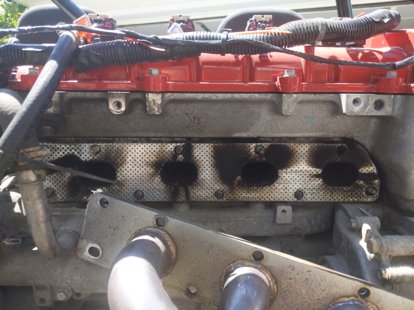

Check your Chinesium header for cracked welds. I found one today on mine.

Checking your header for leaks is important. Any exhaust leaks will ruin your tuning data, and make your custom tune a waste of money, potentially making your engine run worse.
Hang a cotton ball (or feather) on a string, and dangle it around your exhaust, when the engine is running. Check if any exhaust air moves the cotton ball around. Check for soot exhaust marks near any gaskets. My cheap header caused me to waste 6 months of tuning, and the stock cast exhaust header mades the engine run much better.

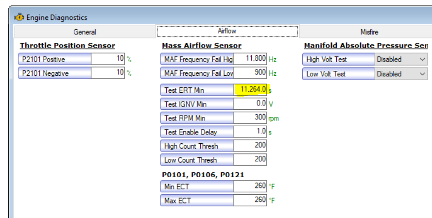

Someone on the HP Tuners forum turned me onto a timer setting for the MAF fail frequency. This is from jirwin's tune, but mine had the same value.
34194
This timer is set for just over three hours stock, which is longer than any of my runs.
The way I was running VE tuning, I would set the fail high frequency to 100, so it would fail "immediately."
My theory is the timer prevents the test from running, so the car is still calculating airflow using the MAF. It would explain inconsistencies in my VE tuning results.
I set the timer to 20 seconds (matches my wideband timer) and will give it a test when I get the exhaust back together. Hoping to have good data by Wednesday.

Haha... well... slight leak :p

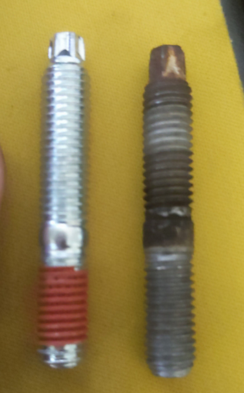

I ordered new studs since mine are pretty old and rusty. I also found out that the nuts for the studs are oval-ed like the axle nuts to help keep them on, so I figured they would be worth replacing. I figured right. Half of them were finger tight (I know I tightened them before), and one had even fallen off. So I looked around and found these online: https://www.dormanproducts.com/p-132535-03422cd.aspx
2010 Cobalt 2.2L was specified as compatible...
34228
They are the right thread and all that but the issue is the position of the... what do you even call it? The break in the stud? The part where there's no thread. Here is a comparison of the old stud and the new one:
34229
The new ones are a bit shorter before they hit the non-threaded part. I don't think this is a concern - they will just not go in as far, but will function the same otherwise. Do you guys agree?
Might be a slight concern since they go into an aluminum head and fewer threads mean not as strong, assuming the original studs came close to using all of the threads. Check the depth of the hole and see how much depth is available. You can always switch to bolts.
jirwin
Upon closer inspection, on the head side the thread length is the same. The old stud just has a taper after the threads. So I should be ok

I used a 2 piece Felpro just now. Seems to have worked better. I used to have a tick on startup, which I now know was just an exhaust leak. After it warmed up it probably closed. It started up nice and quiet now. Even idles a bit better. Thanks for making me check guys

Well, I tried to run in just VE mode by unplugging the MAF sensor and it wouldn't idle. Would run if I held the RPMs higher. Was running pretty lean so I scrapped that idea. This does tell me the MAF was still working into the airflow calculation previously as I suspected.

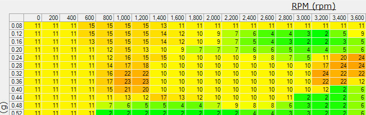

One upside. The car felt truly gutless at low-moderate throttle in the 75-100 KPA range. I took out a whole bunch of intake cam timing in that area, and it was like a flipped a switch. My car was an XFE model, so it had a lot of overlap in to reduce the volumetric efficiency and save gas. Getting rid of the overlap really helped. May have to dial back the ignition timing a bit to make up for the higher cylinder charge. That sea of 10s below was high teens and mostly 24 degrees.
