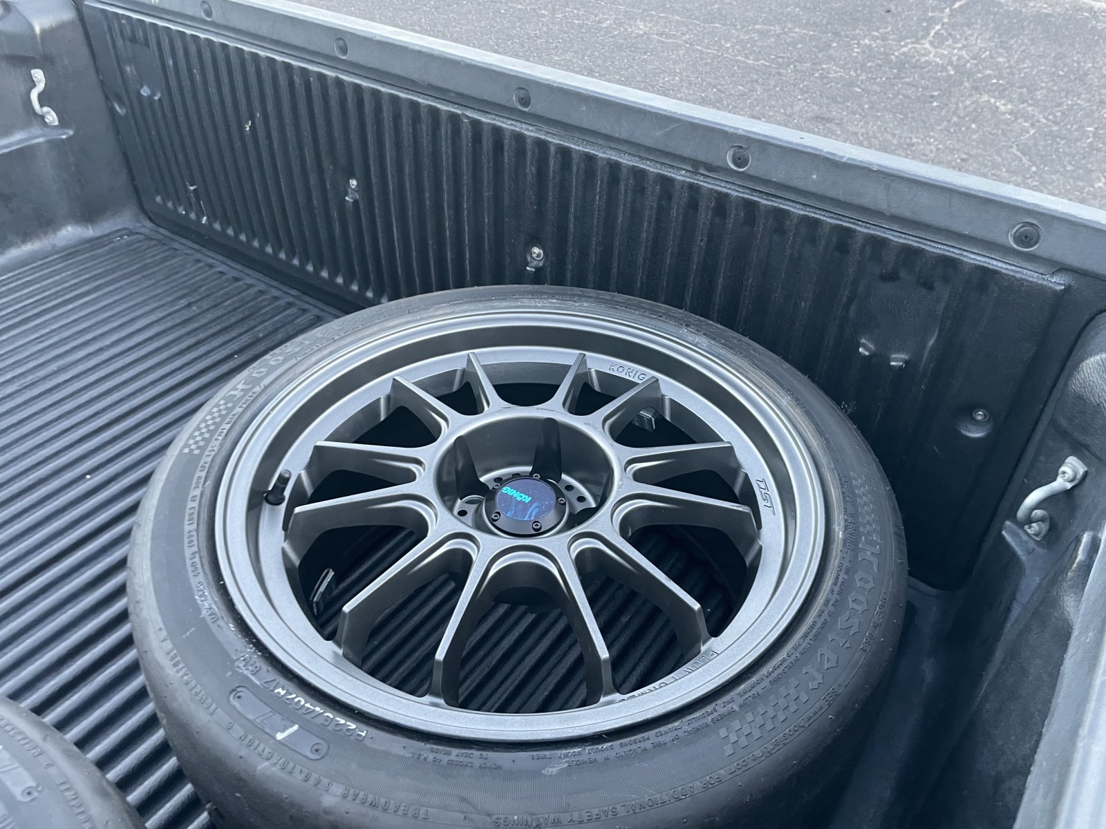

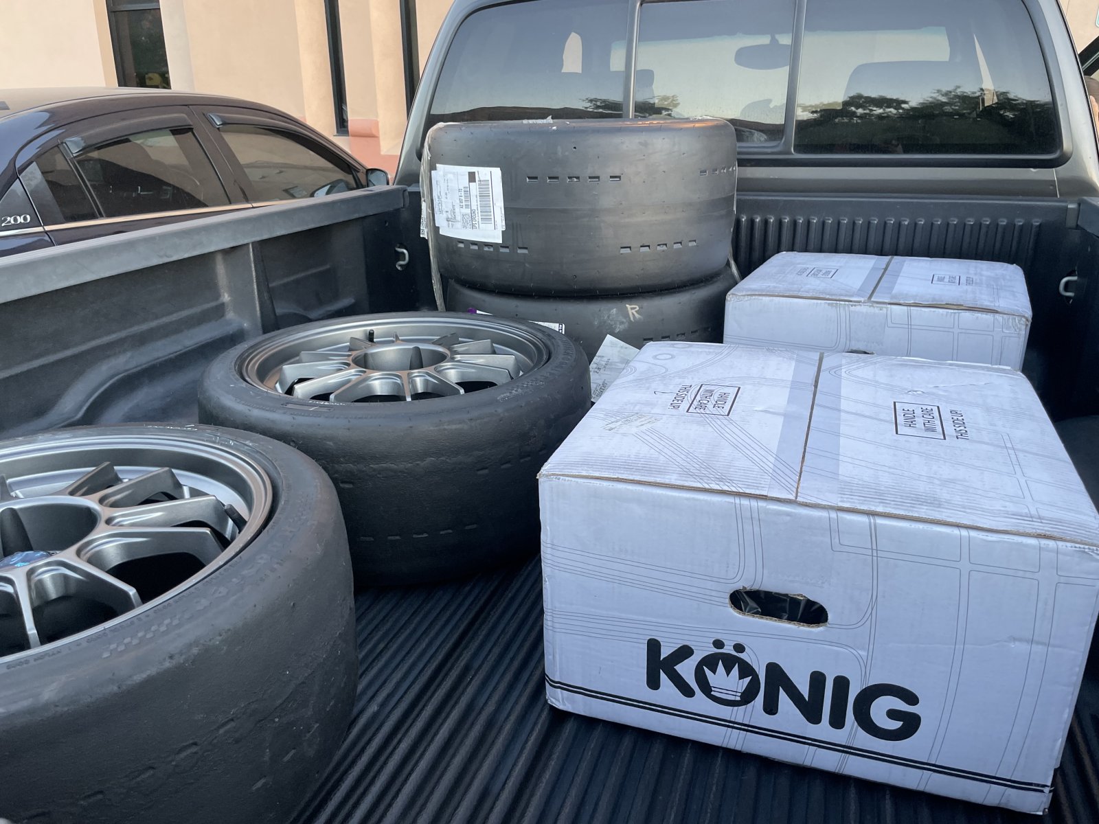

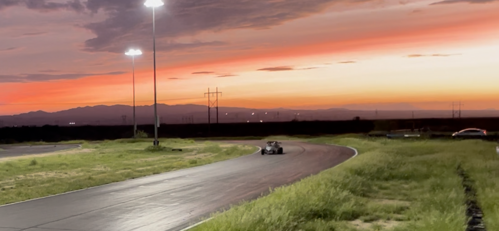

Just an update. We have been shaking down the EV Goblin recently here in Tucson at the Musselman Honda track. The first issue we worked through was related to the regenerative braking present in the Tesla drive motor, it was greatly unbalancing the car through the turns. We were able to turn it off and this made great improvement. Second issue was massive front end hop during hard braking after the long straight (90mph+ then hard braking for a left hand turn). We adjusted the shock valving to full soft and this greatly reduced. We believe we need more front suspension travel so we will be adjusting the coil overs to increase the spring length. We are also getting tire squeal in a part of track that should not be experiencing. We are going to look carefully at suspension settings but believe we need some slight toe-out. Another challenge with the EV is just the abundance of torque with just slight throttle input. For this we will be installing RaceChip XLR controller on the throttle pedal to use its eco settings to see if we can reduce pedal sensitivity. After this, we will look at running with racing tires (Hoosier A7). The track record is 56 seconds for street car and we want to sort the car to the point we can get close to this. Last outing we didn’t have the transponder in proper location so did not acquire timing data. A Callaway Camaro in front of us was running 1:08 and we had to let off because we caught him so fast so I think currently we are in the low 1 minute time range with our street tires.

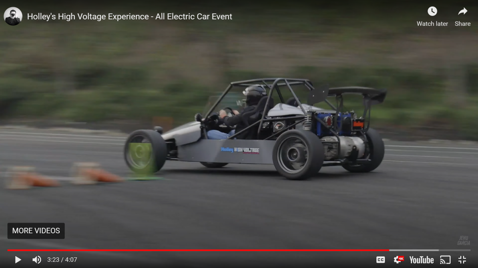

There is a Holley EV event in Sonoma, CA that I am thinking of bringing the Goblin too in Nov. (I think 13-14). If anyone is out that way drop me a line.

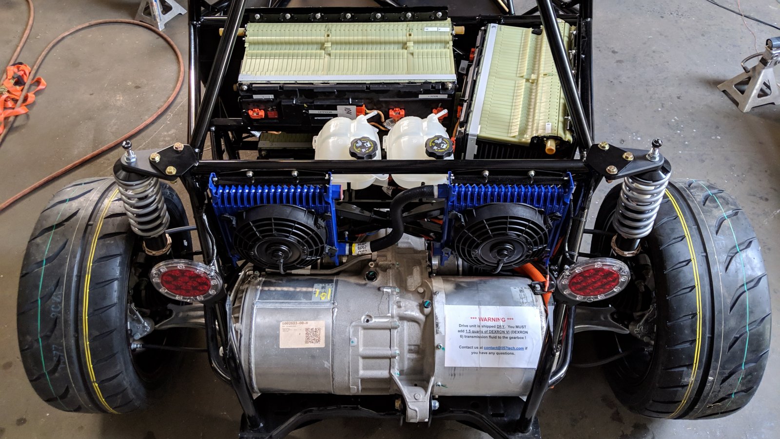

Thanks for posting that link. That's actually the Tesla Goblin we helped to build in-house. The owner of the that Goblin reached out to us at the end of 2018 about doing a Tesla Goblin. We knew it would require some major custom fab work so we decided to handle that ourselves. He delivered the drive unit, batteries and other electrical things to us in early 2019.
** Edit: When it left our shop is was not driving. He was handling all of the steps to get from being a roller to being able to drive under its own power. **

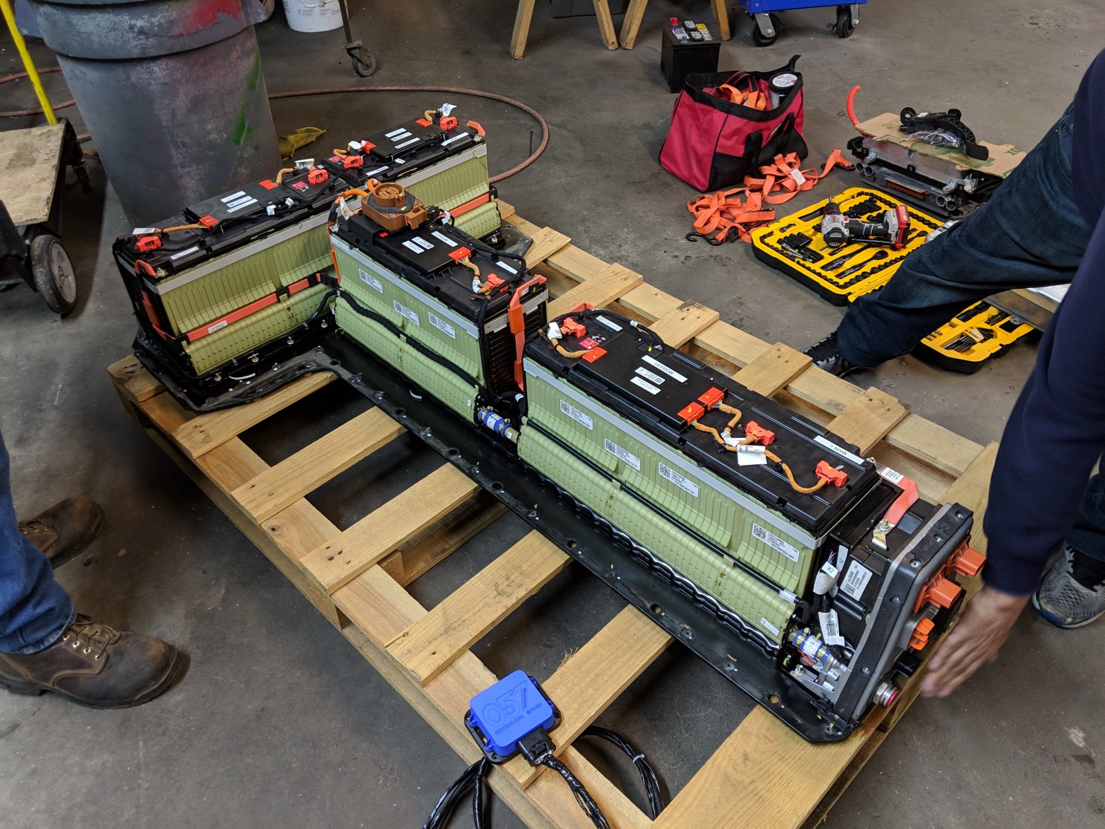

It's using a Model S drive unit that goes for ~$12k on EV West. The batteries are from a Chevy Volt and if I recall correctly they came in at $2500.
The final weight when it left our shop was 1702.
