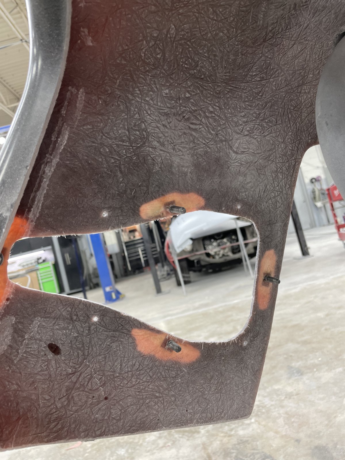

SmsDetroit

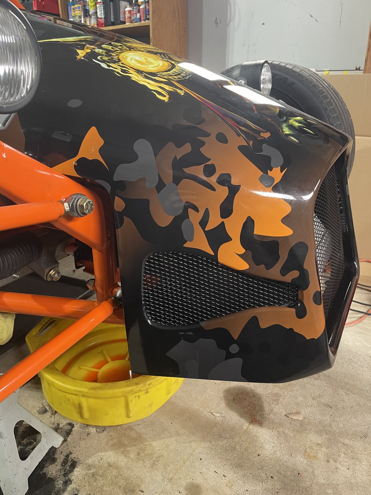

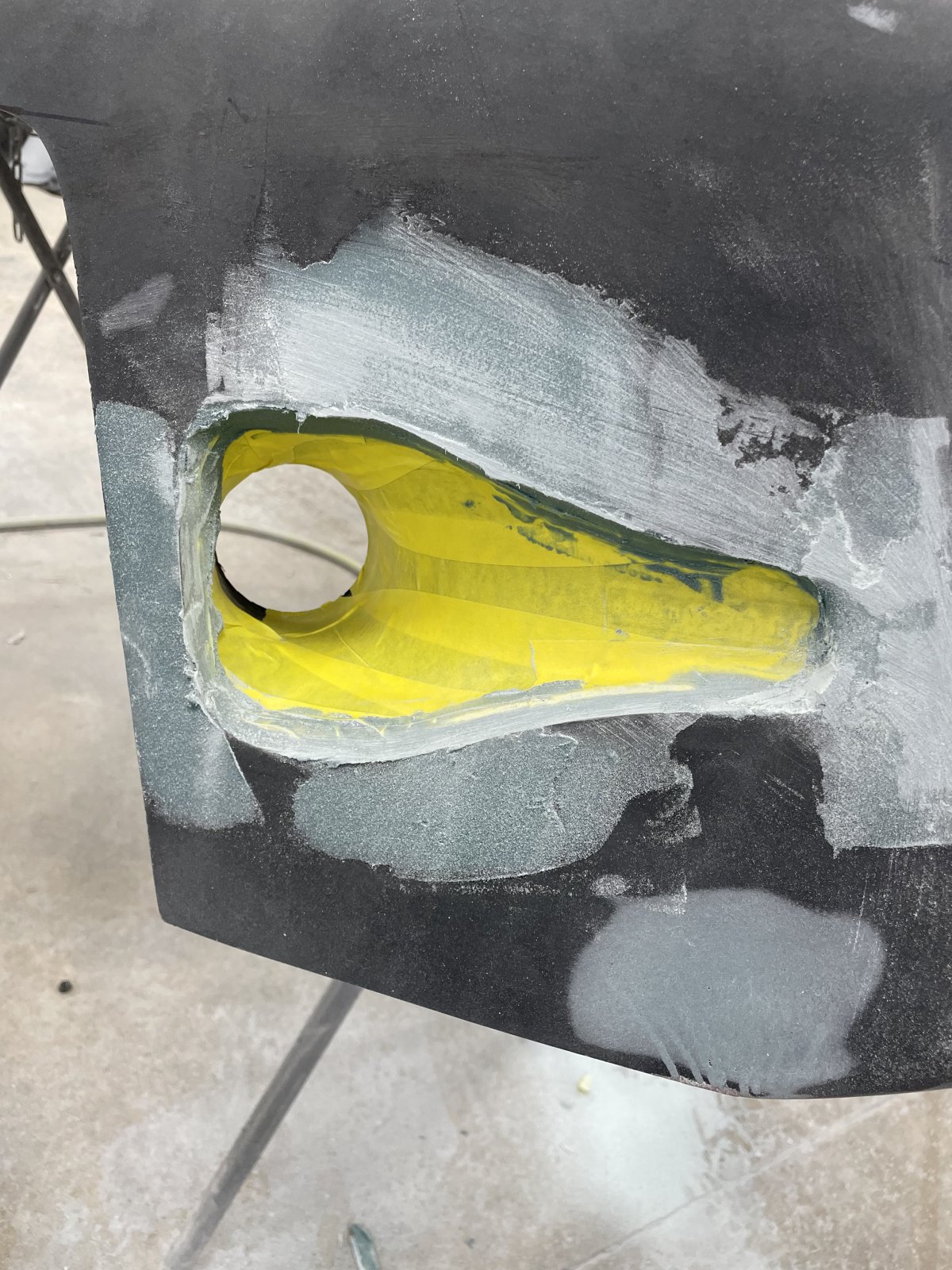

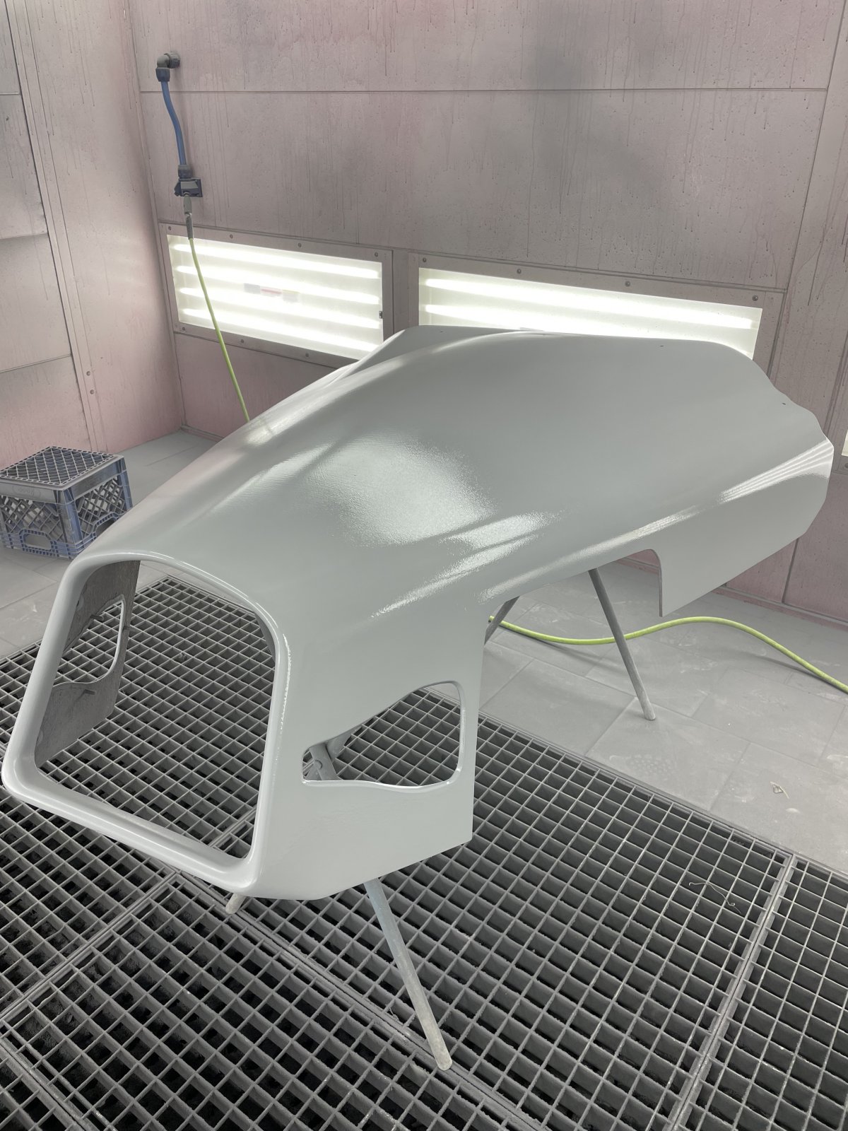

Cut it for vents on inside.
I bonded in studs on the inside so I could take them on and off. I did put screen in between too. Also sanded the edges for a smooth transition.

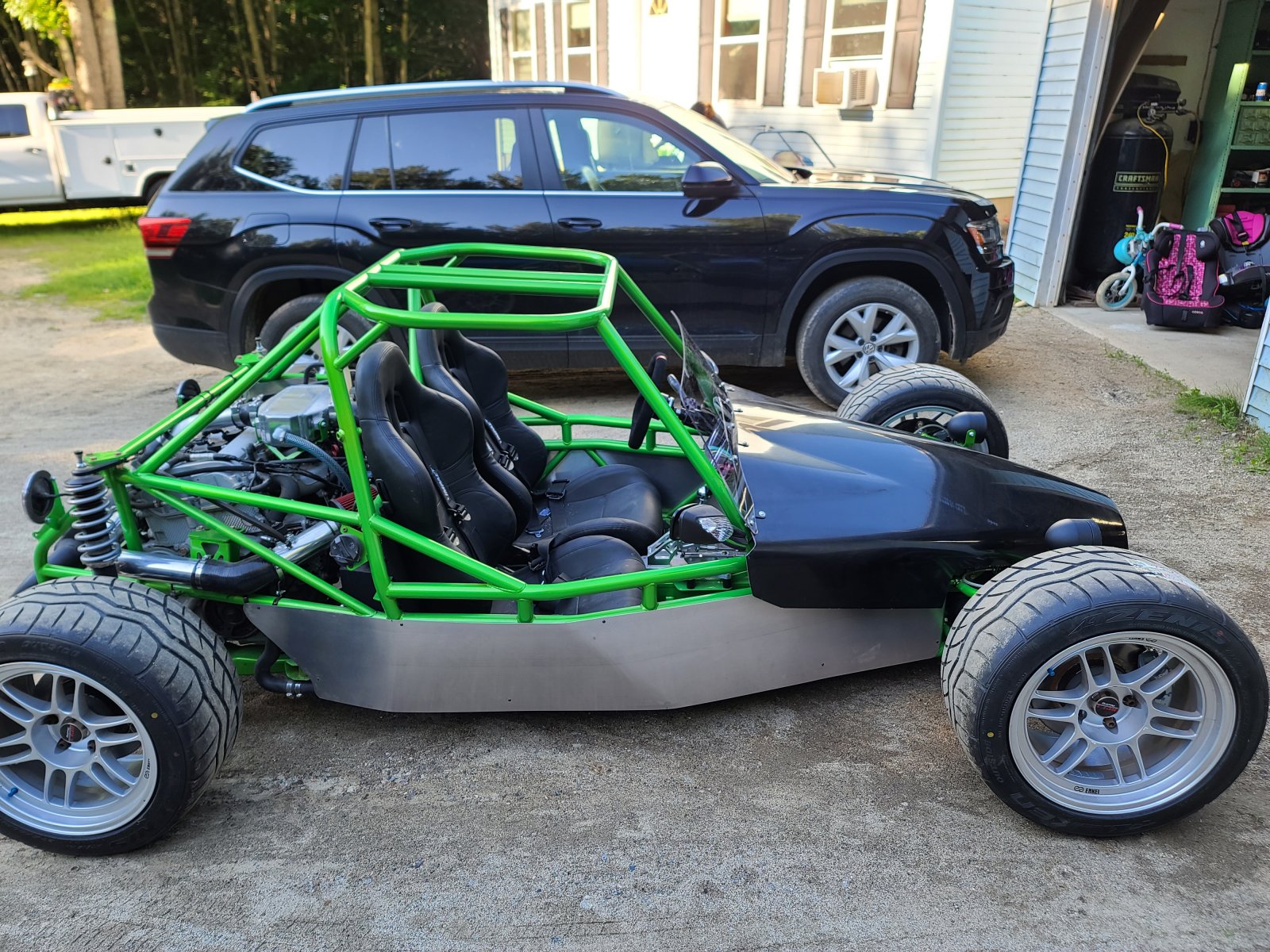

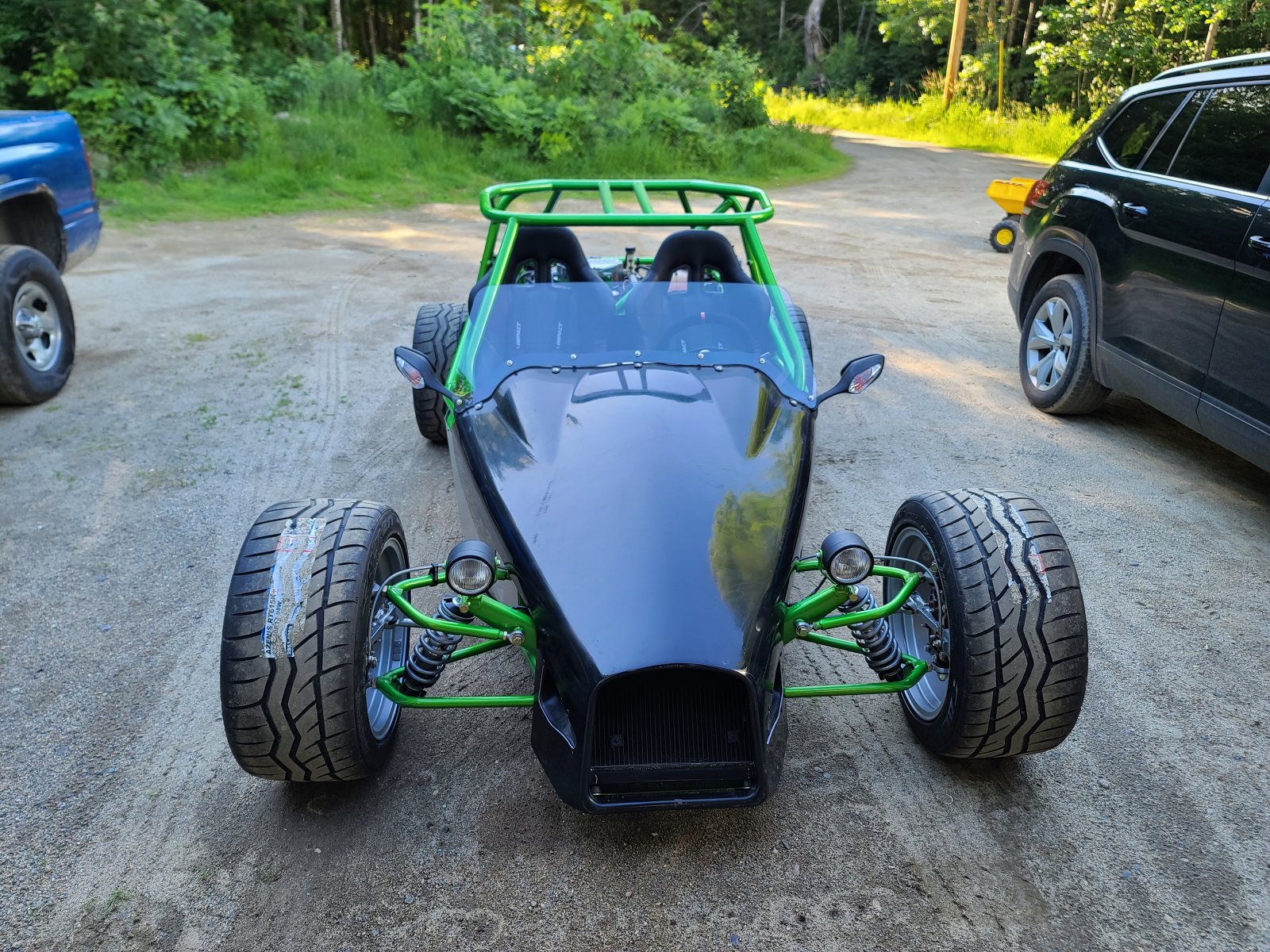

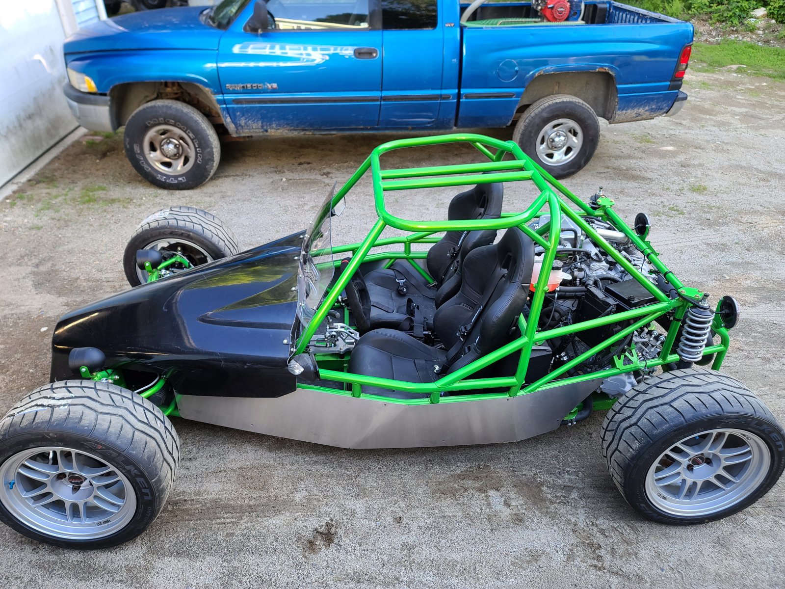

Fixed calipers, bled brakes fitted windshield hood and sides at same time forthe first time. Worked a little closer to insurance

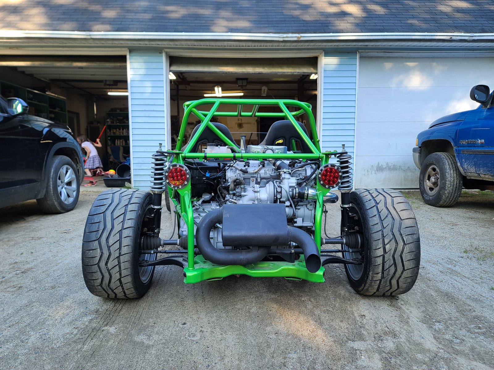

TheDon

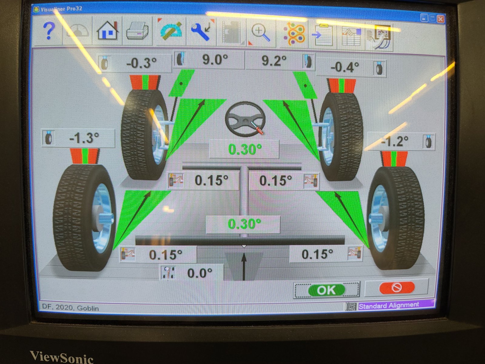

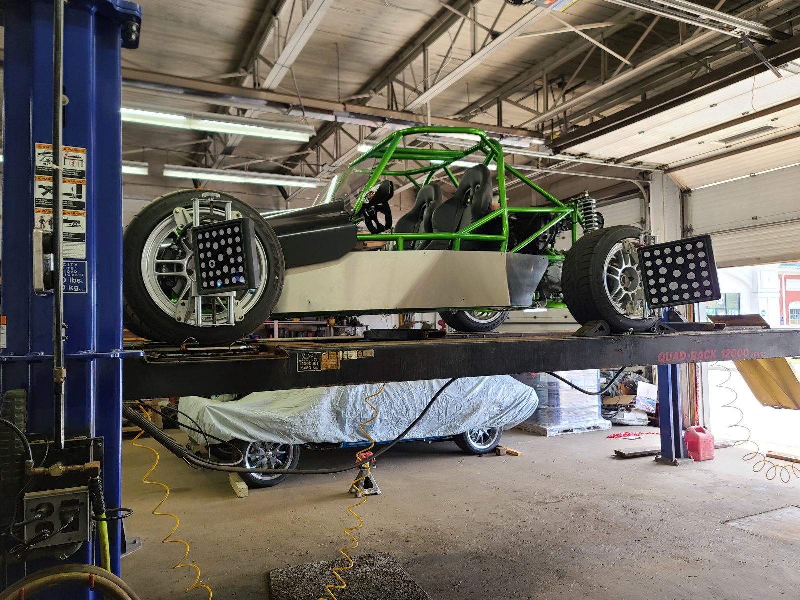

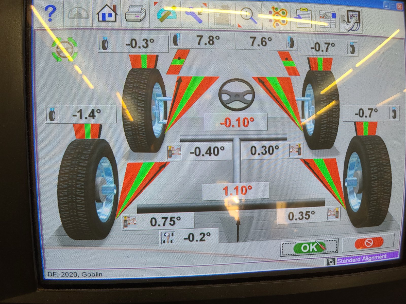

I did the best i could with toe plates and angle gauge but this was my first time doing an alignment.
Before and after pic professional allighnment.
Was late and went straight home on a straight road but feels so much better already
