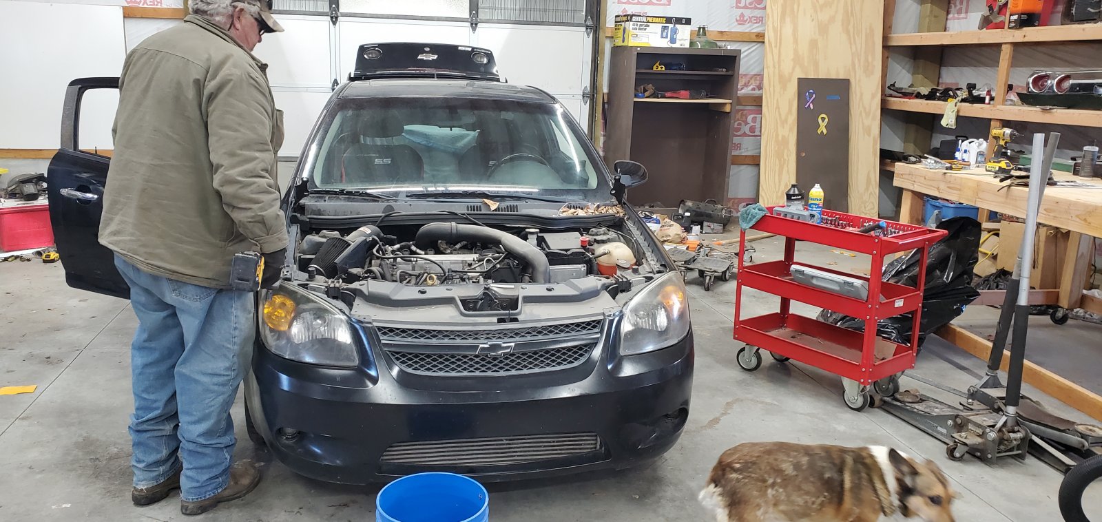

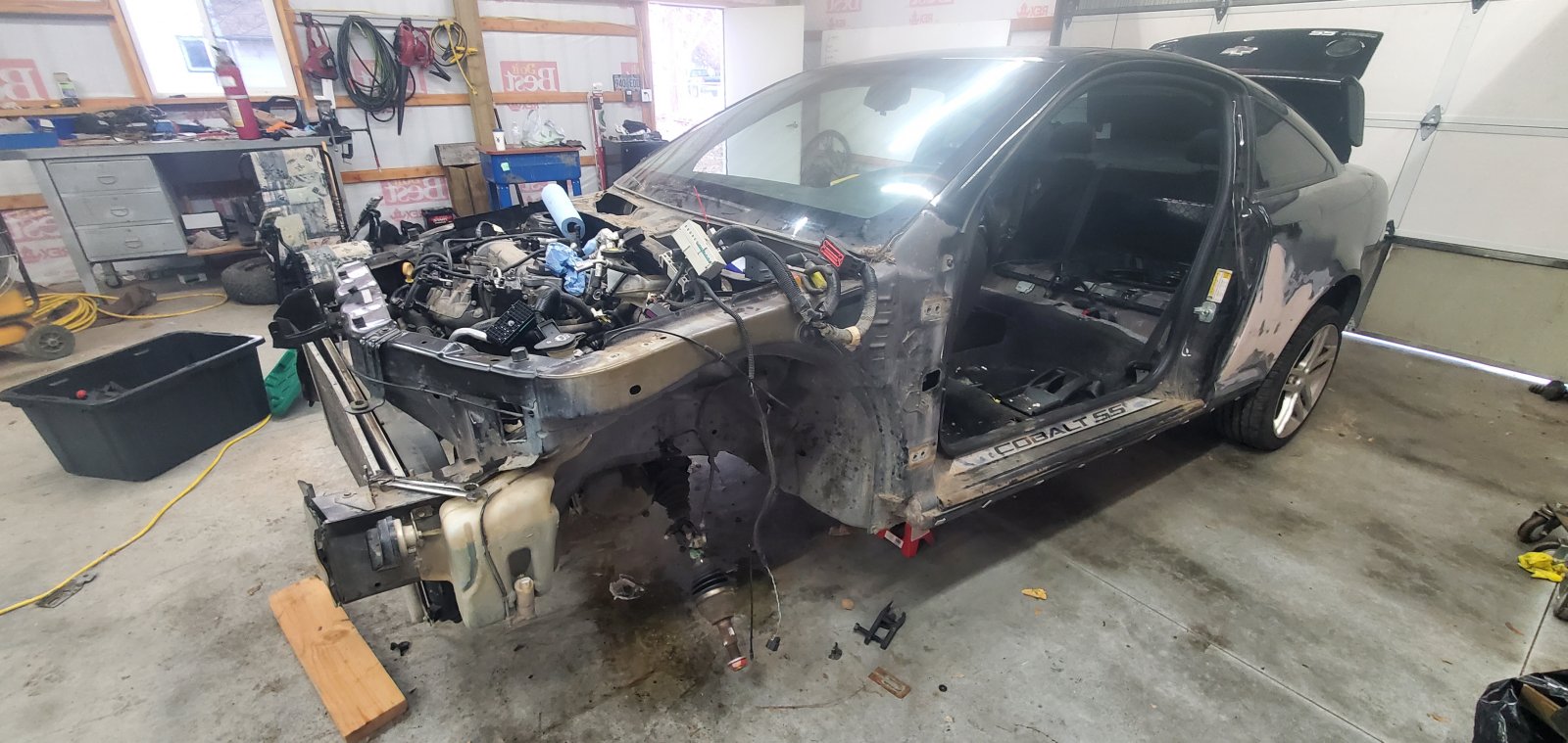

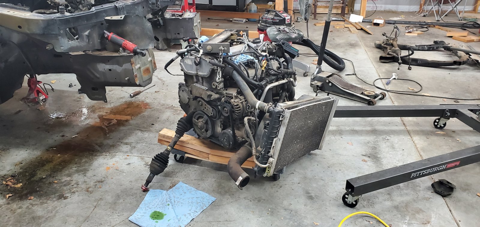

Started my donor teardown this weekend, so I guess it's time to start my build log.
Like most I've been lurking in the shadows of DF kit cars for years. Bought my donor a few years ago off Copart with some light front and driver side damage, but mechanically sound other than some routine service. It's a 2009 Cobalt SS/TC manual. I've spent the last few years driving it semi-daily and chasing the few minor electrical gremlins left over from the accident, but my ultimate goal was to build a Goblin.
Fast forward to last November. I had received word the the kit price was going up, and I had a trip planned to the Dallas area already so I visited the shop and thats when I for sure knew I NEEDED a Goblin. Seemed like perfect timing, tags on the Cobalt are up in Feb, my kit should be on the jig 3rd or 4th week in Feb, and delivery to Oregon hopefully mid to late March.

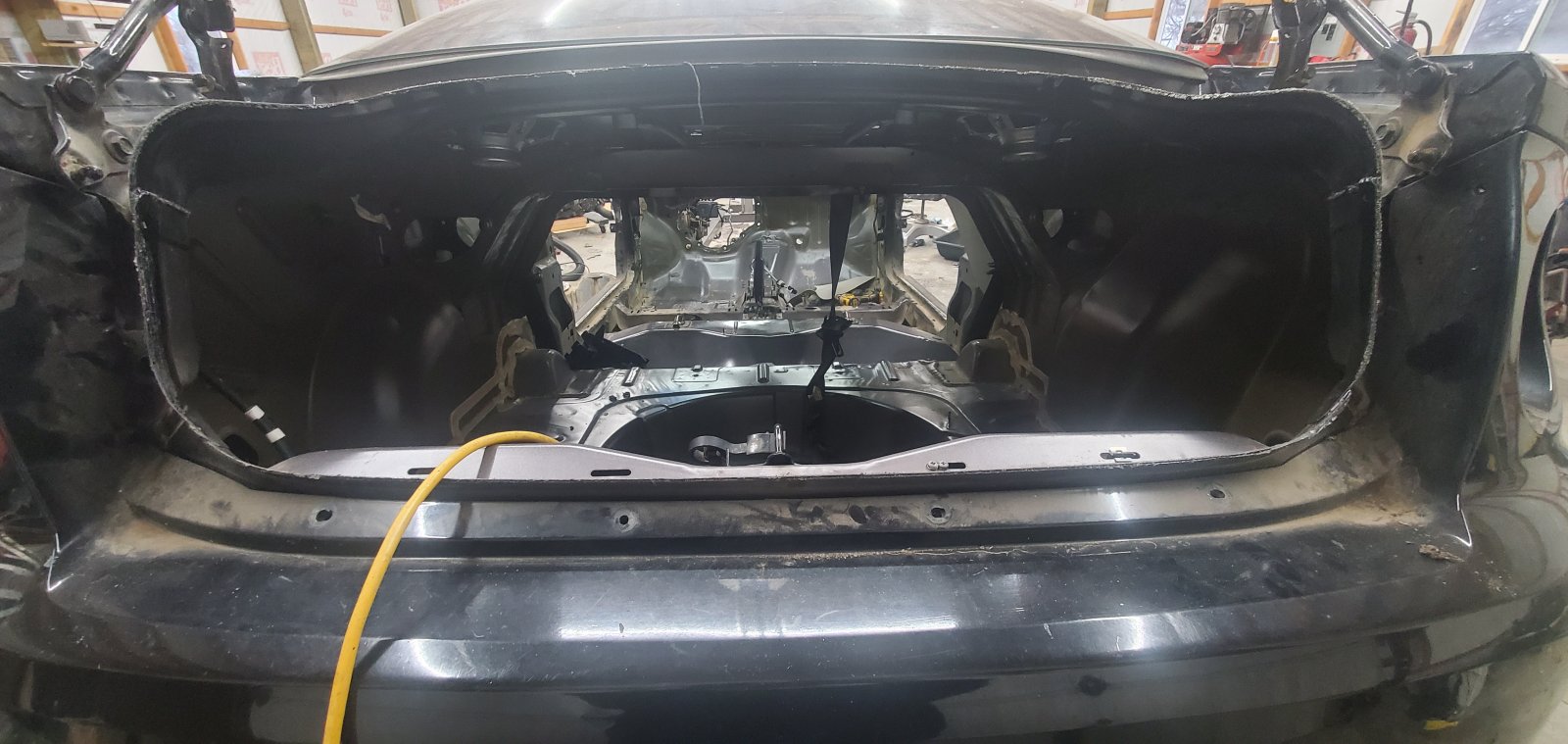

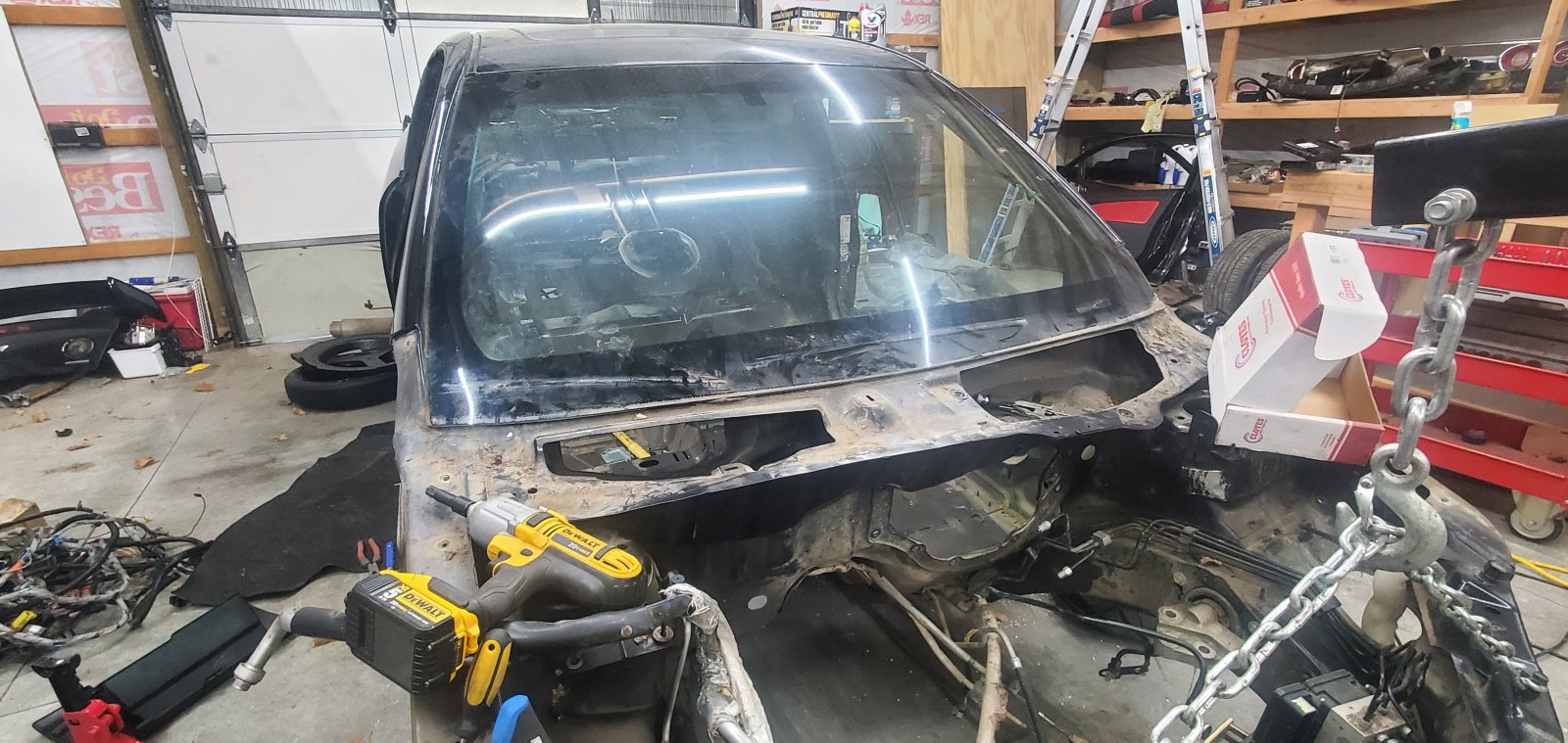

Started my teardown on Sunday, and as of yesterday (January 25, 2022) I made it part way through video 5. Powertrain is out along with most of the interior, with just the dash and wire harness left to remove.
Everything has gone super smooth so far, partly thanks to my Dad helping out. I think he is more excited for this build than I am!

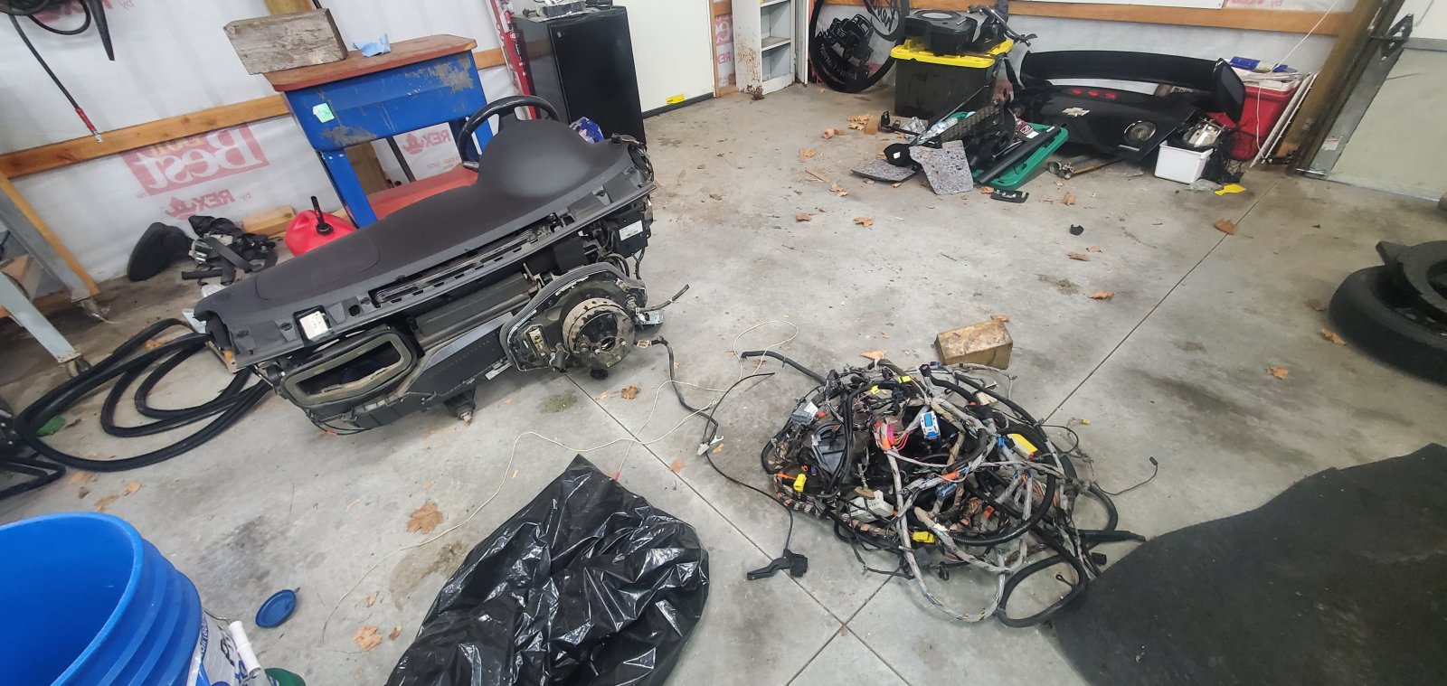

Due to a mix of procrastination, weather, work, and personal life getting in the way; my 3 months of prep work have turned into maybe a week. And I haven't gotten much farther than my last post. Dash is torn apart, steering shaft is 90% done, and still need to thin the harness and disassemble the rear end of the donor. Also need to clean and paint parts soon.

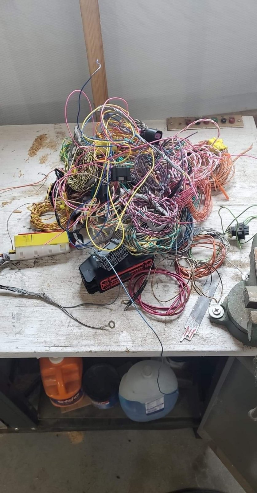

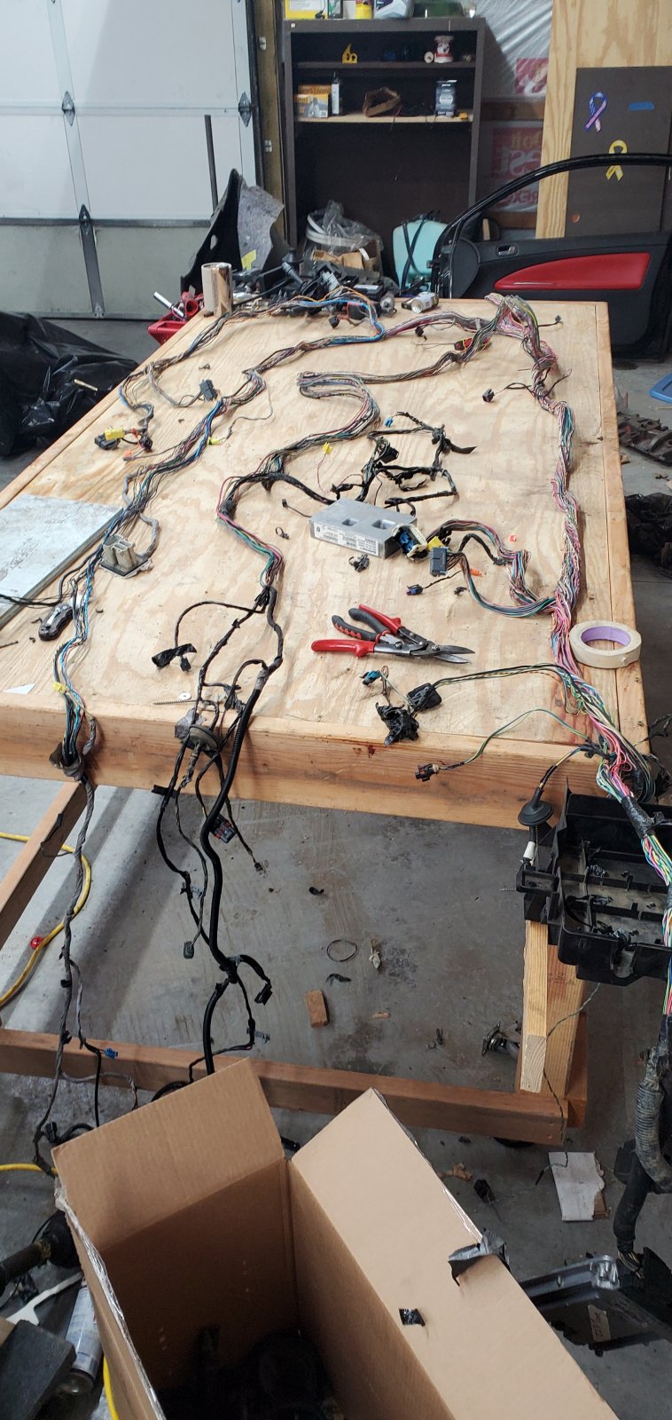

Through video 1 of thinning, and so far so good, other than some gross sticky tape that doesn't seem to stick to anything but my hands.
Abs, airbag, and door wiring is out. Now for part 2, hopefully it's as straight forward as part 1.
