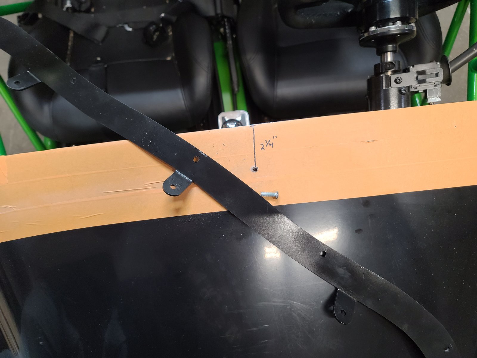

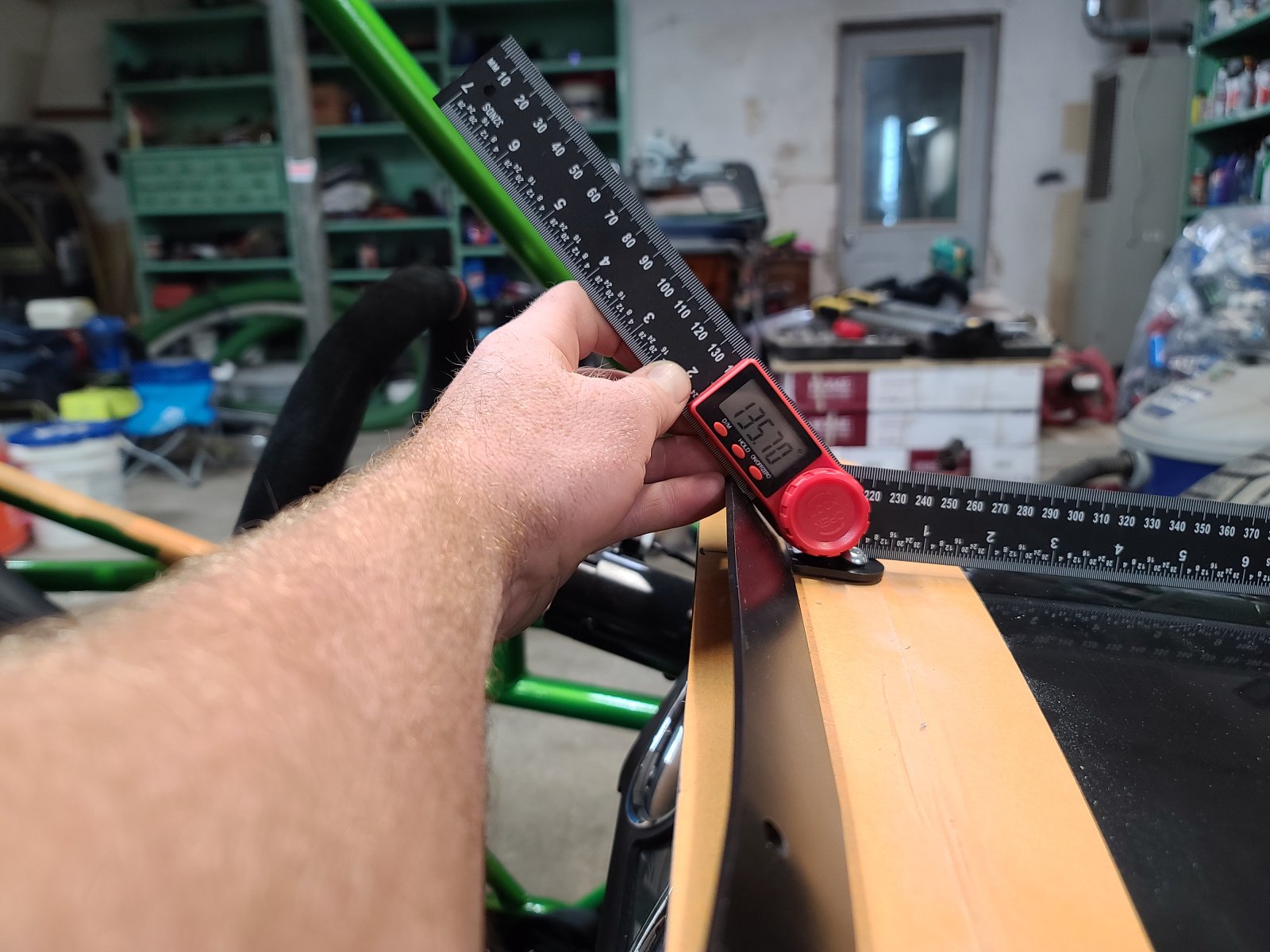

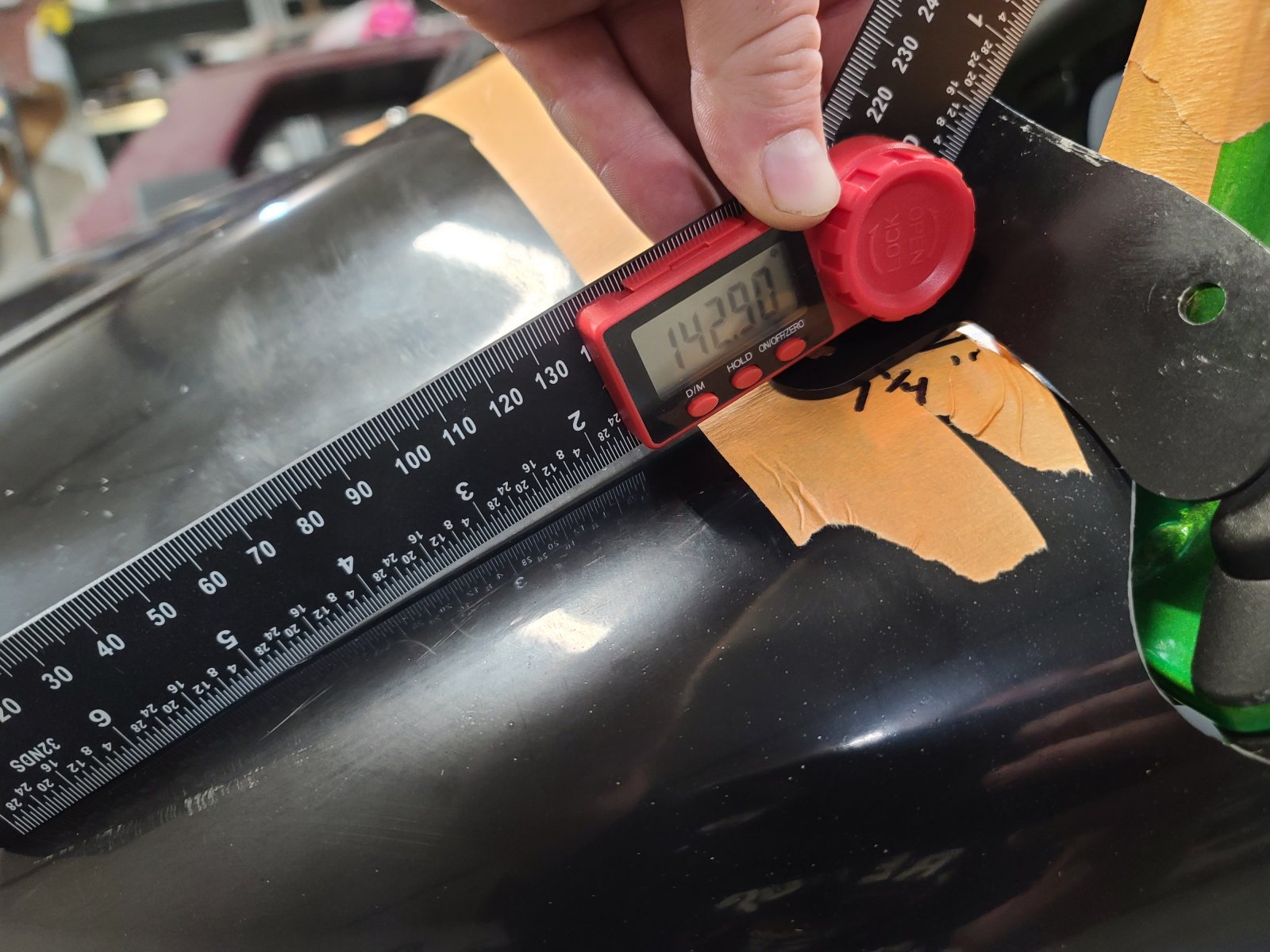

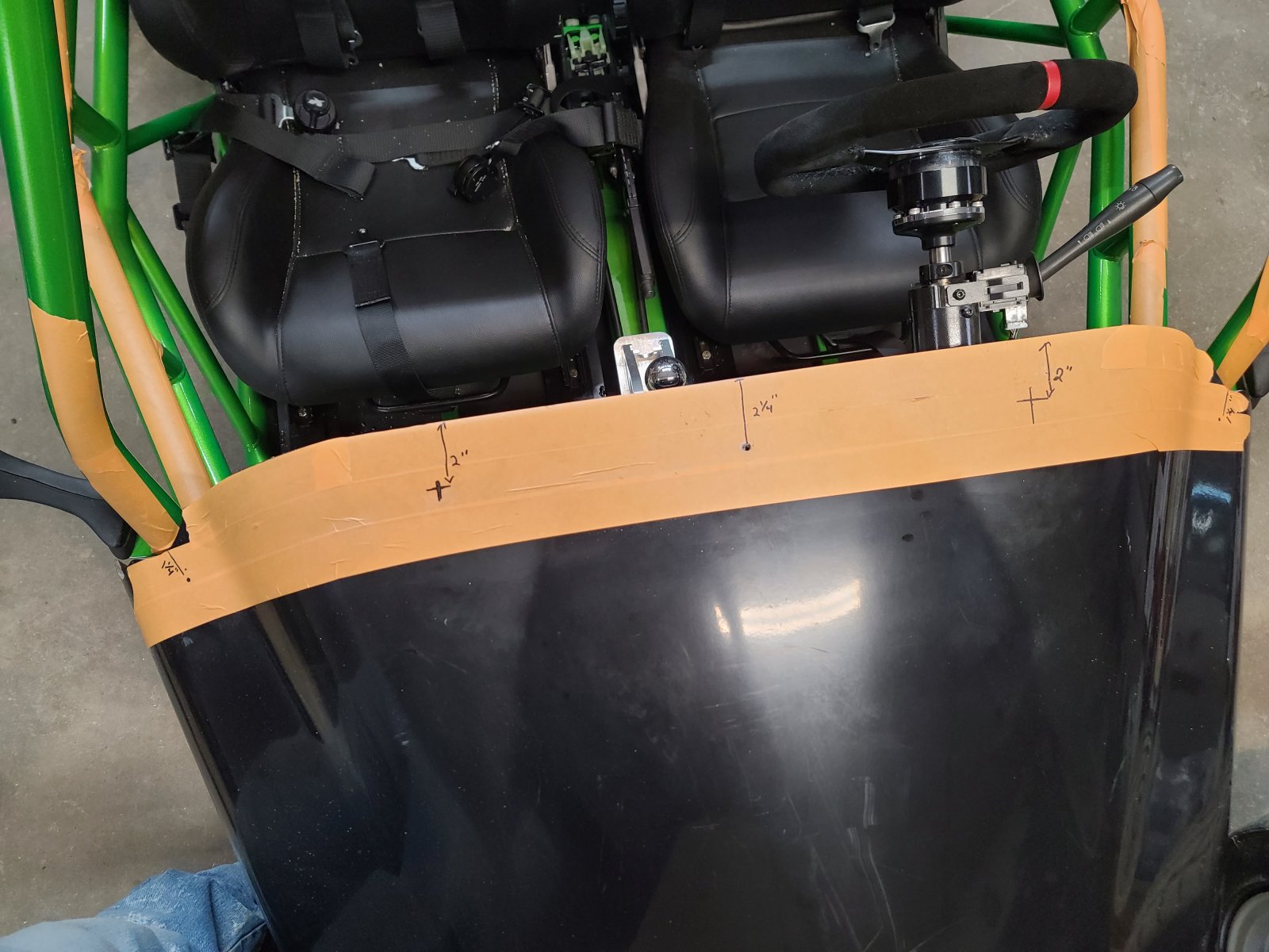

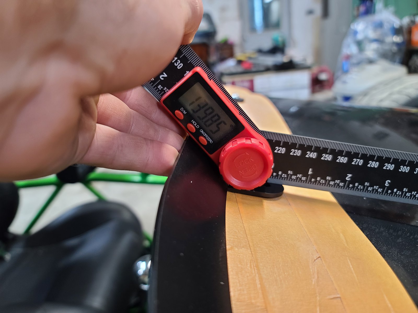

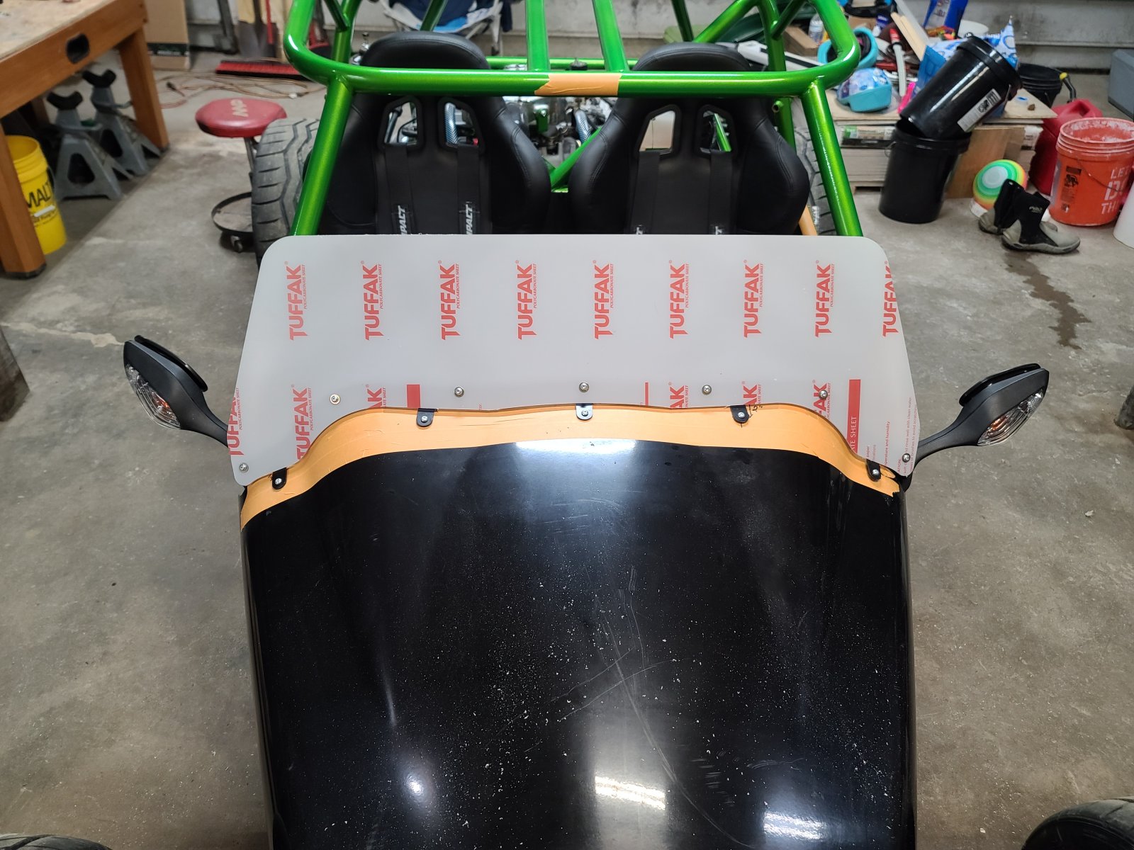

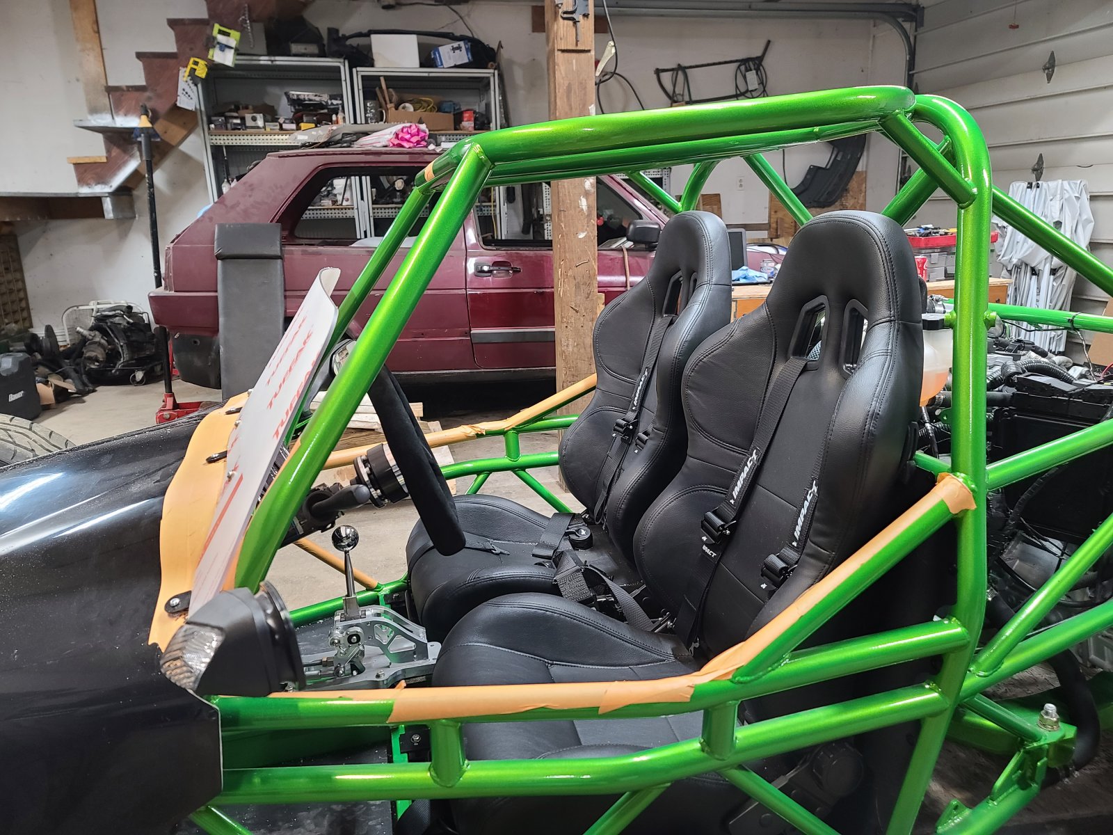

Windshield is mocked up
TheDon
Yea im not the first I saw it on another build just kept playing with it in the vice. Not bolted tight in pic. Next will be cutting for the front vents. Read a few logs but if there's any tricks let me know

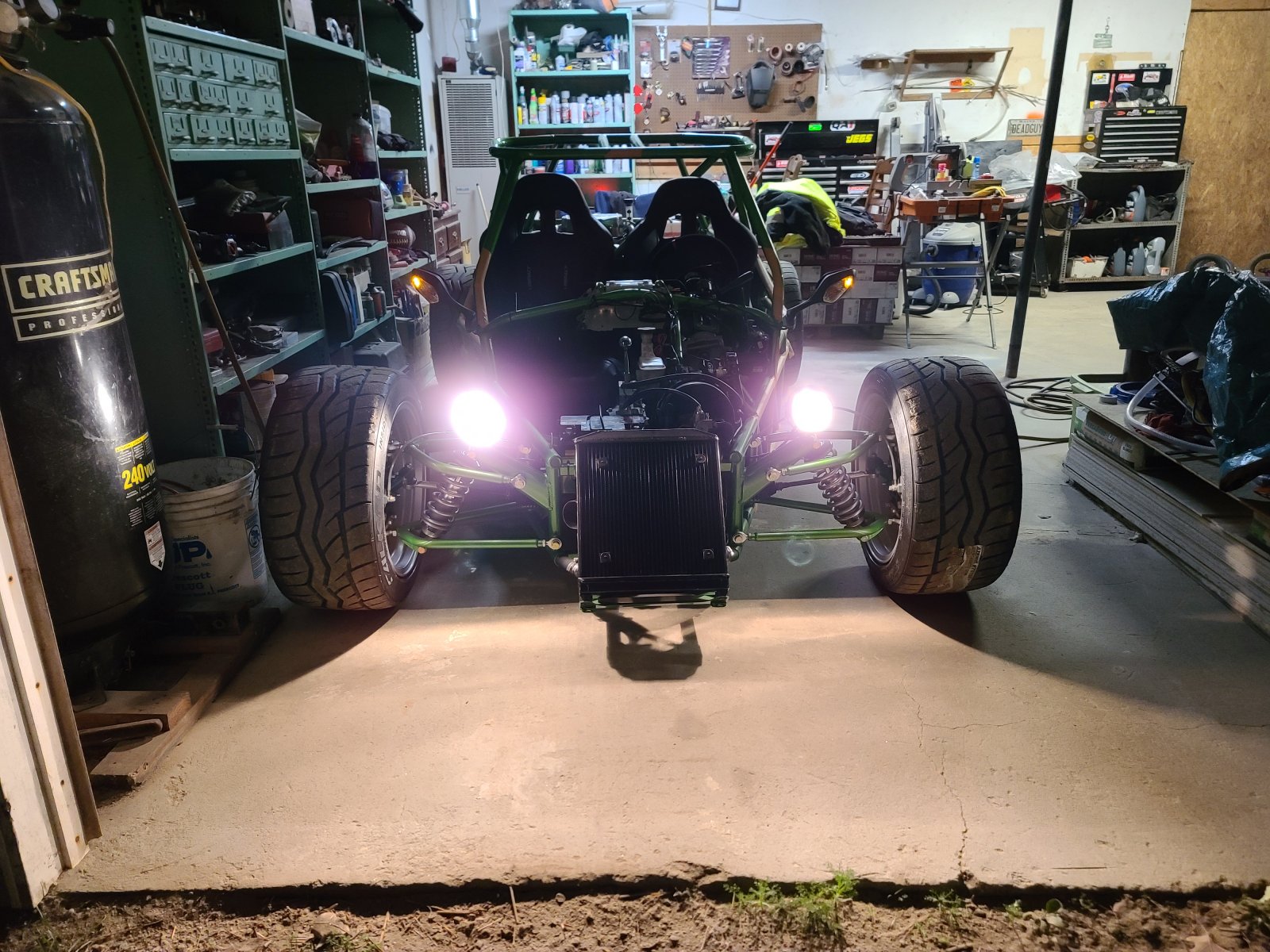

Felt like I was due for an update, the state (Maine) doesn't seem to want my money I will have to do Montana route. Verified coolant system is working as it's supposed to last night. Still haven't seen intercooler pump kick on?
There is a setting in HP Tuners that sets the delay for the coolant pump. Default is 10 seconds after the ignition key is turned on, then the pump starts, runs until the key is turned off.
Are the ECM intercooler settings relevant for an SS/TC? I thought only the SS/SC tunes had the A2W intercooler pump stock.
You are correct, not available for the TC. It's hard to keep up with who has what donor. It's in the title for this one, but I often forget to look there, and the signature doesn't show on the phone.
