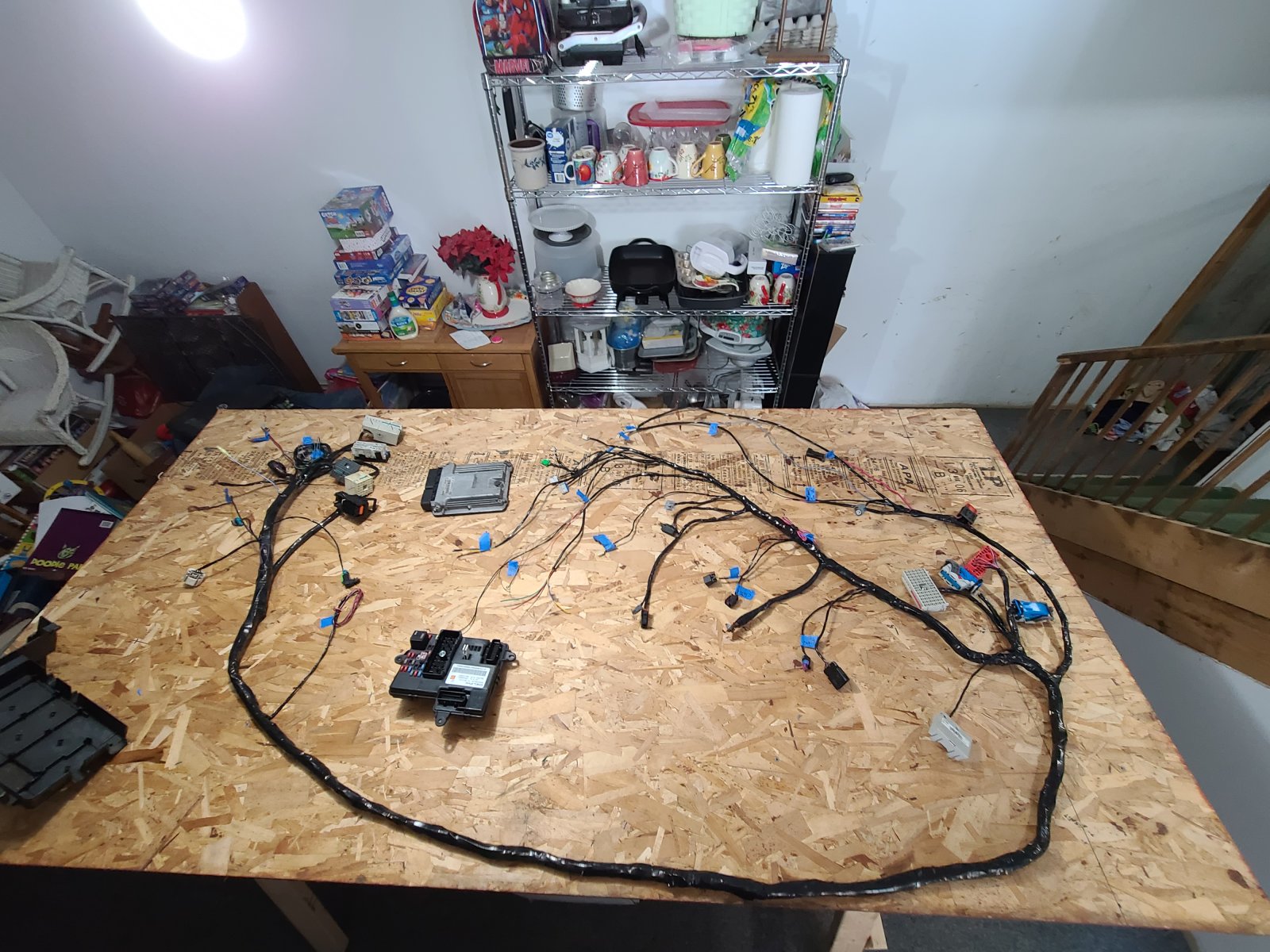

Think ill work on the harness tonight once the kids are out.
TheDon
Finished up the harness this morning time to heat the garage up and start preping parts.

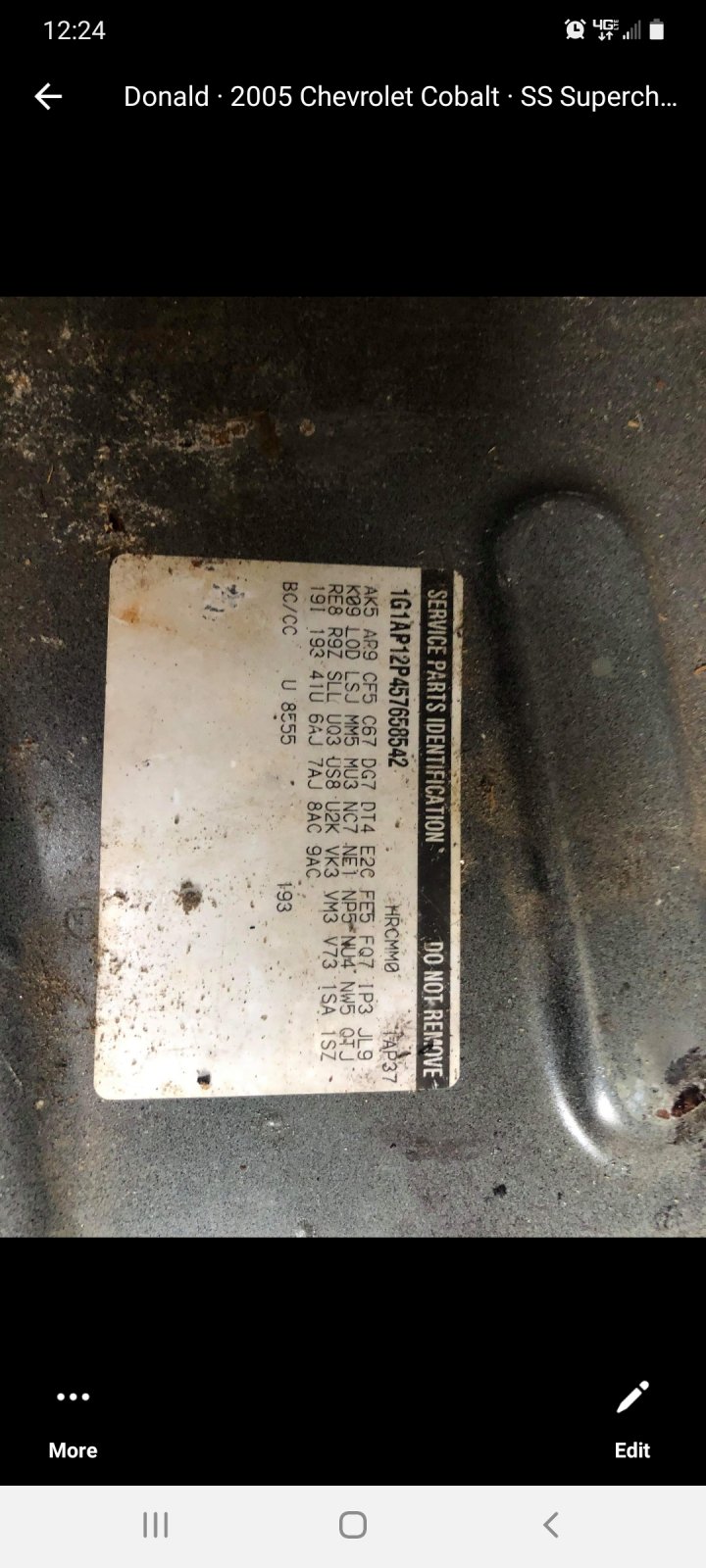

A new transmission isn't in the budget but 1st to second grinds a bit so rather than rebuild or buy new I maybe getting another whole cobalt tomorrow an 06 ss he thinks has an lsd with stage 3 zzp kit on it. The transmissions should be identical I think no issues swapping them? Price is right it was abandoned and has no title runs and drives $800. An hour away
If the seat are recaro, then it has an lsd.you can ask him that. Plus “G85” will be on the RPO codes in the trunk, which you already know.
Hope it has the lsd.
There is a manual trunk release but for the life of me I cannot remember where it is. I couldn't get into my truck either and then someone told me about it. I never had a chance to use it, so I don't remember now where it was. For what it's worth.
I think you flip the back seats down and it’s somewhere around the back deck. There’s also one on the inside of the trunk lid, as per safety something something
Gear ratio should be different. 4.05 for the SS/SC trans and 3.82 for the SS/TC. Besides that, should bolt right up.

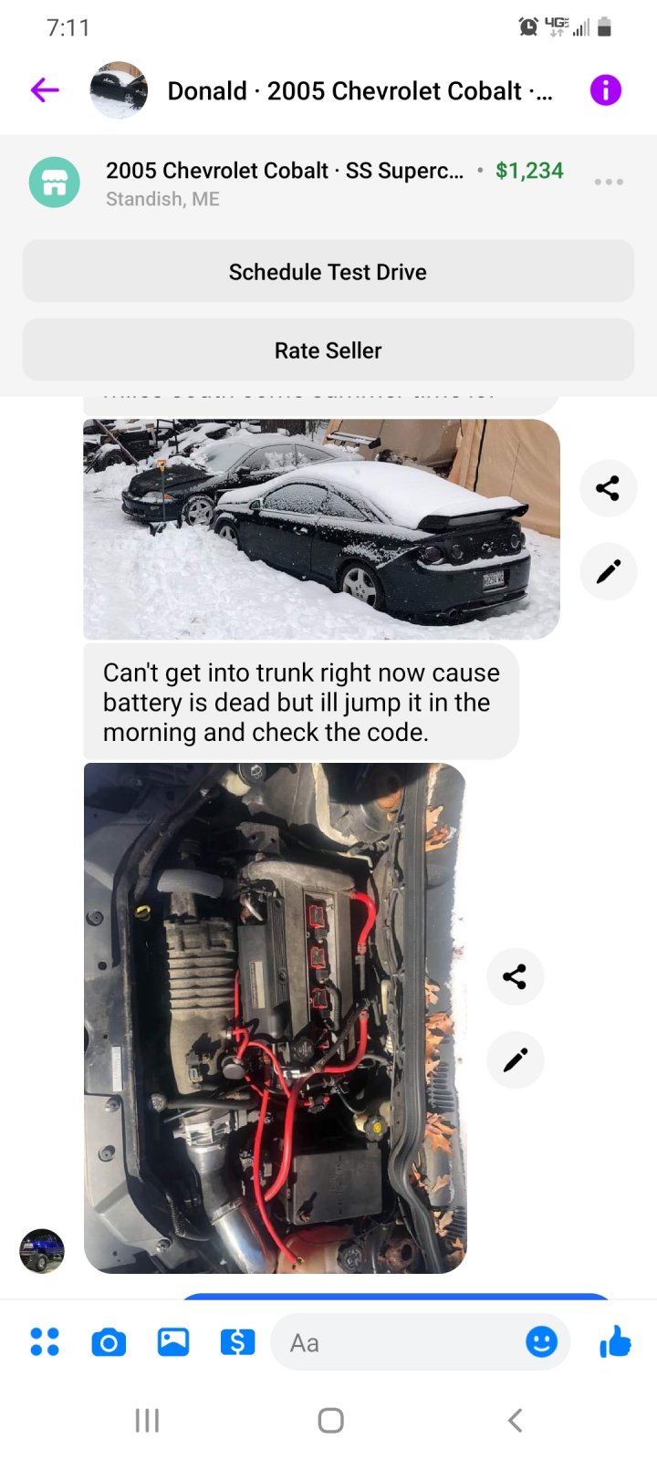

No lsd, still very tempting not sure if it's easier to just spend 300 on new synchro and try to replace in mine or pull the used one out of this trans or put my lsd in the other one, thinking I'll get most of my money back parting it?
