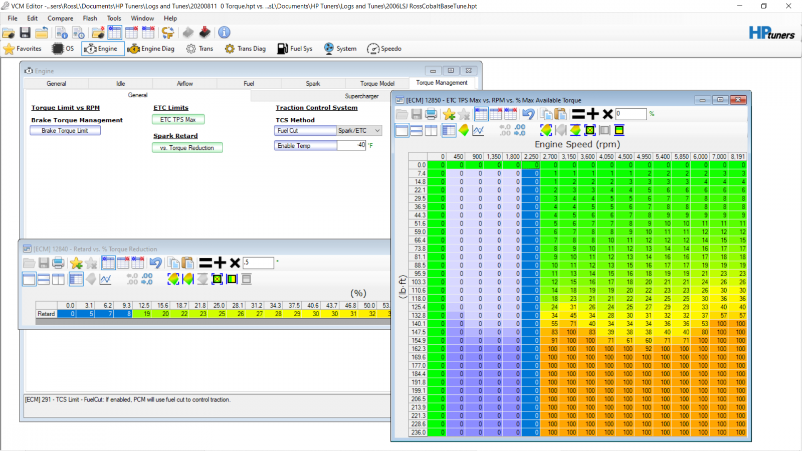

Has anyone figured out how to reduce the throttle sensitivity? Other GM vehicles that I've used HPTuners on had a table where you could change how much throttle was applied for how far the pedal was pressed. That would be super handy here for smoothing it out but I don't believe our PCM has that ability. Is there an inline device that could be plugged it or has anyone figured out anything else that would help?
ncgoblin
I believe what you are looking for is torque adjustment within HP Tuners based on RPM.

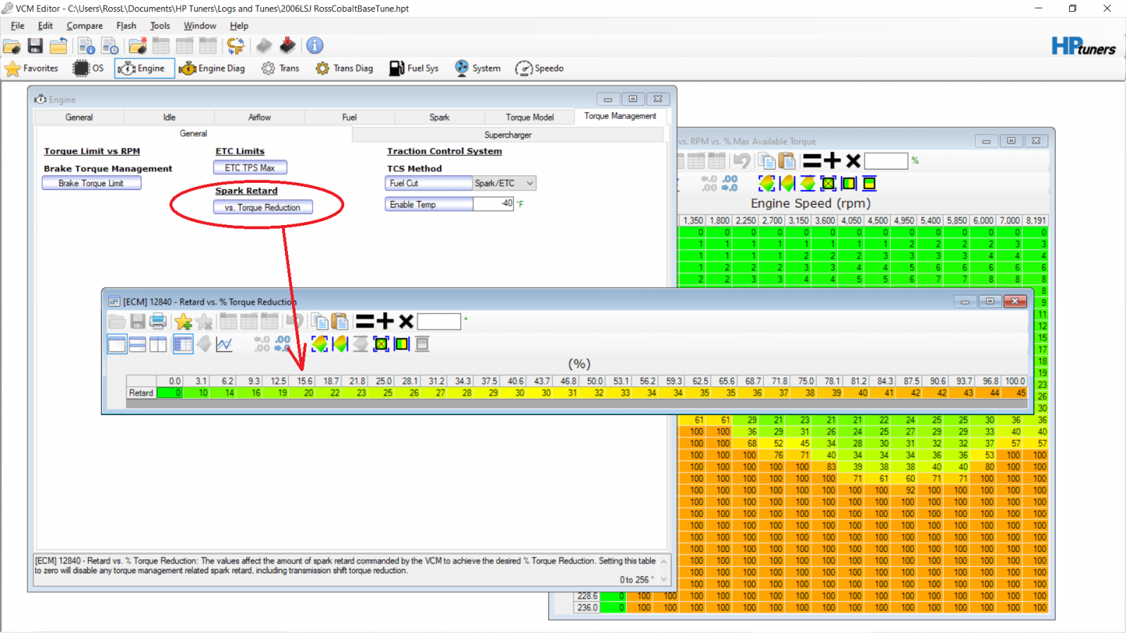

There is a table in Torque Management. It modifies the spark retard for a given desired torque. ZZP tends to change everything to 100% all the time and makes it hard to drive. I'm not st home otherwise I'd paste a copy of the table.
I also have this issue. I have an 06 LSJ, and HP Tuners. I think all supercharged LSJ ecotecs have this issue. The turbo is much smoother in low RPM.

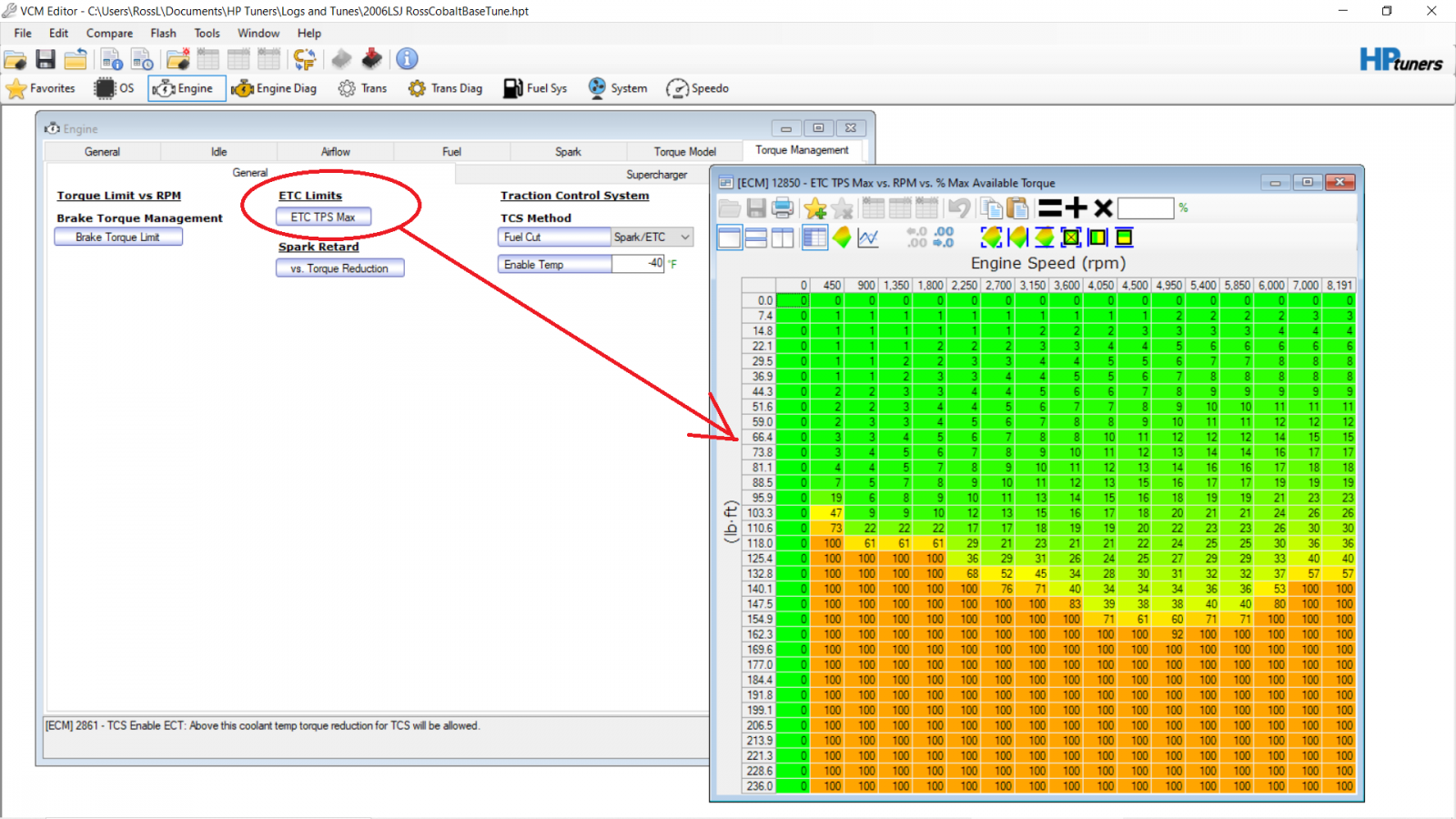

I will play with the ETC (electronic throttle control) TPS (throttle position sensor) max table.
Maybe lowering the numbers at lower RPM (say below 2700 rpm) will help with this torque issue.
16016
Good point Chad.
If this table isn't set, then the table above probably doesn't work.

Driving around town is manageable if I press my foot against the tunnel to help keep it steady but autocrossing is a totally different animal. I'm sure it'll get a little bit easier with more seat time but man does that sensitive throttle make the rear end snappy. It's also very strange now getting back into the other race car that has well over double the power of the Goblin and I actually have to USE the pedal for the car to do anything.

I wish it were as easy as just re-mapping the input to output but the table in HP tuners for the 07 or older SC, is much more different than that. It takes the input and calculates the desired amount of torque and removes spark timing to make it less responsive.
I should play with the table and really move it around to see what it does. I know what it does when it's all 100 or the timing table is zeroed out, hard as hell to drive. Currently our car is set somewhere between stock and all 100. I would still like it to be more smooth down around idle but i think there is another issue (see my thread on this).

So I zeroed out the torque below 2250 RPM.
Did nothing to reduce torque.
Then I reduced the spark commanded to half the stock values, for the cells under 9.3%
Any ideas on what parameter might be set that is preventing these tables from working?
