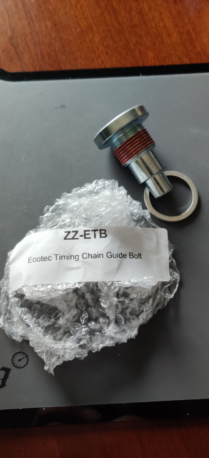

ZZP also has this replacement bolt for the timing chain guide. I has to order a throttle body harness adapter so I grabbed this also.
$12.99

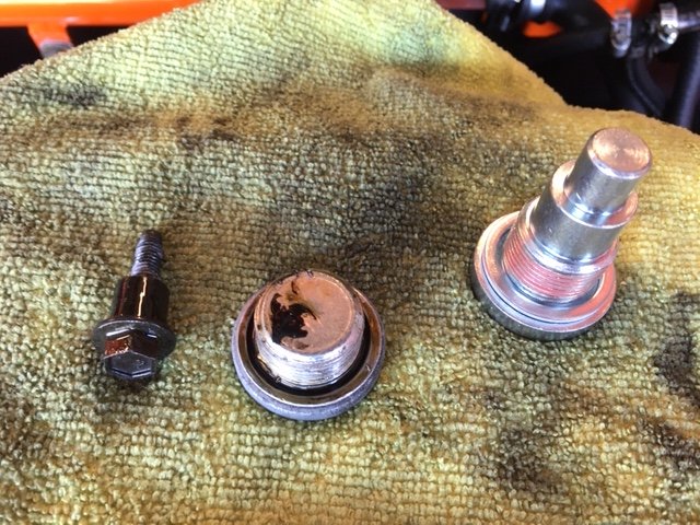

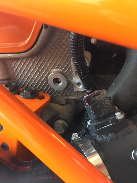

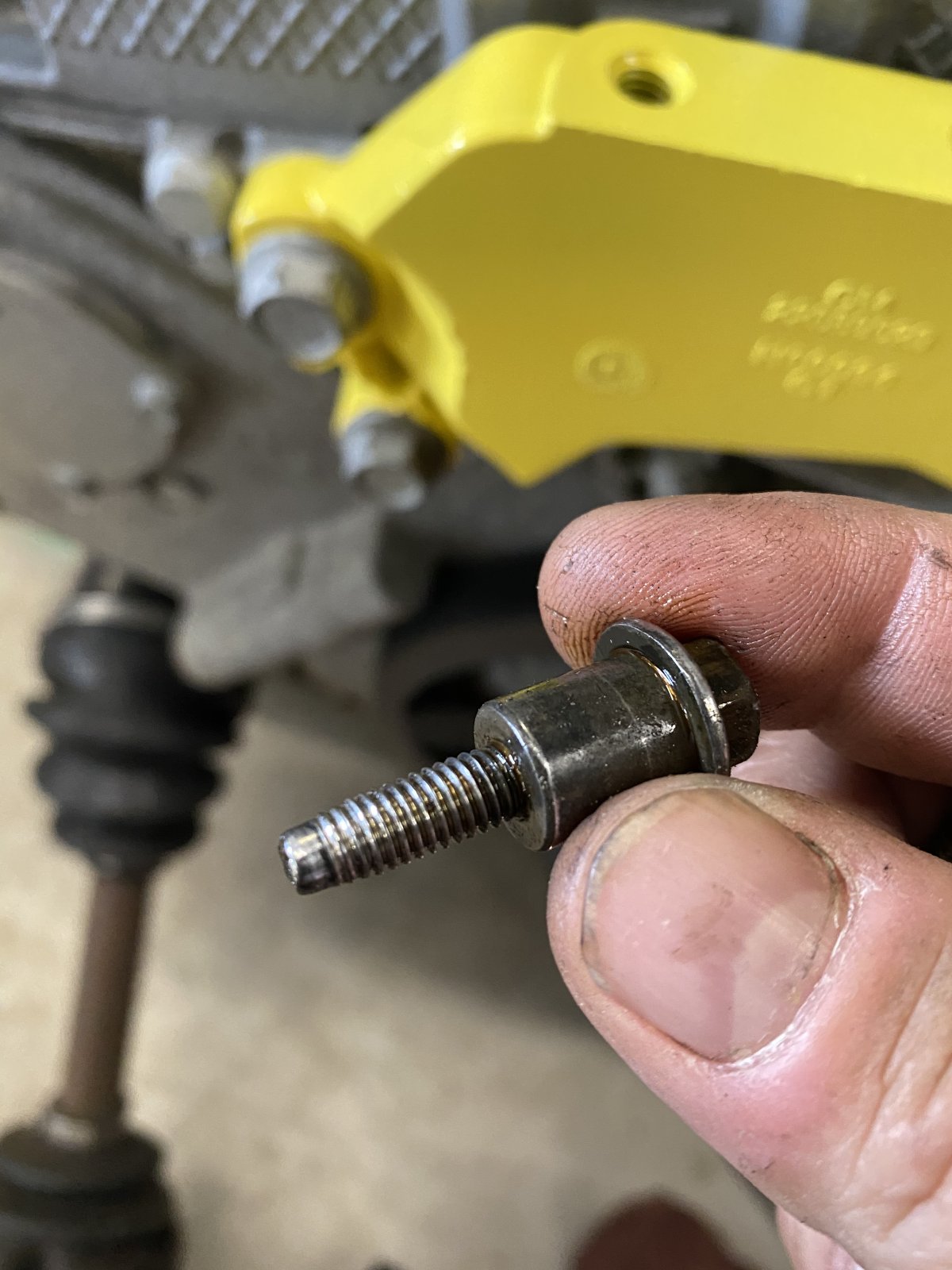

I finally did this and it took less than 5 minutes. I'm glad I did because my bolt was loose and backing out. All it took was a 10mm allen, a normal 10 mm socket and a pair of needle-nose pliers to grab the bolt to pull it out. VERY EASY! I had a friend that had a Chevy Equinox with 80,000 miles drop this bolt and took out his engine. This is a must do...

Thank you for posting these photos. I'm about to do the same thing, but I'm a little worried that the guide rail might move when I pull that bolt out. I'm guessing by your description nothing moved? No worries getting that bolt out without dropping it in the engine?
Indy Lonnie
The guide rail did not move... I don't think it is possible to drop the bolt in the engine. There is not a lot of room between the tensioner and the cover. I had all the same concerns you have. I sat on the part for 4 months now. Glad I did because mine was loose.

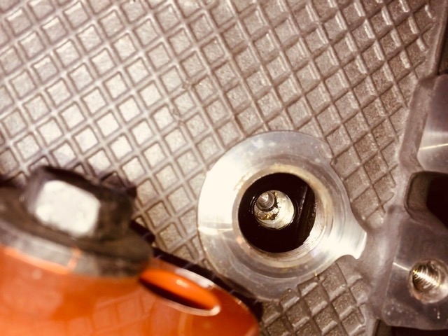

Good call on this. I did mine this weekend, just because and to my surprise, the bolt wasn’t even in the threads at all. It has been bouncing around, for who knows how long. :oops: The threads were chewed up and the cover also had marks from the bolt bouncing around in there. Saved an engine (hopefully) for less then $20.

My recommendation based on the amount of threads I have seen and my personal experience on both my engines is to replace this bolt at a minimum. In most cases the plastic guide has broken. To remove the valve cover and timing cover takes roughly 30 minutes. A lot of the balance shaft gears also discard some of the rubber around the edges which can cause problems down the road. Inspect guides and gears its a good peace of mind.

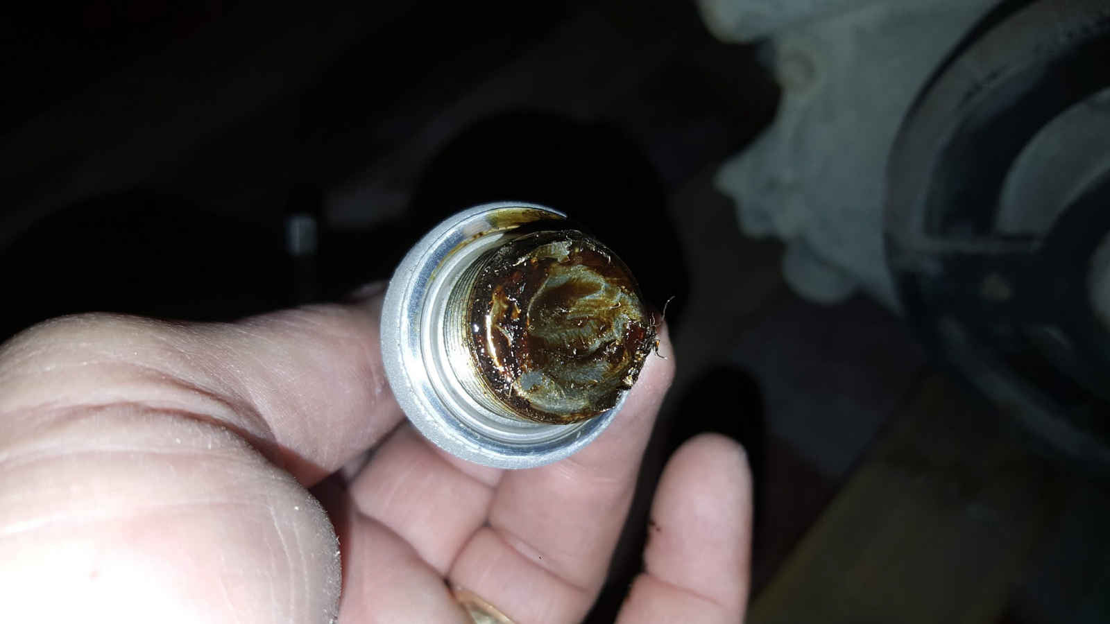

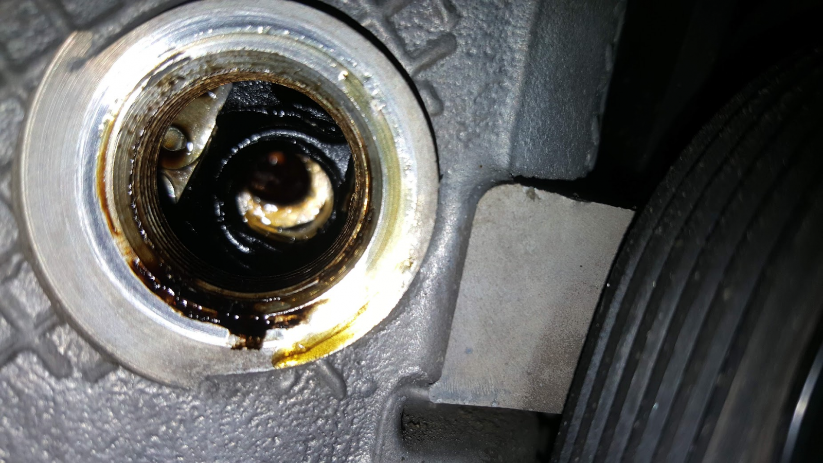

I just pulled the timing cover plug from one of the engines that we are using for our new build videos and the bolt is gone.
You can see it worked on the end of the plug for a while before finding its way down in the engine.
