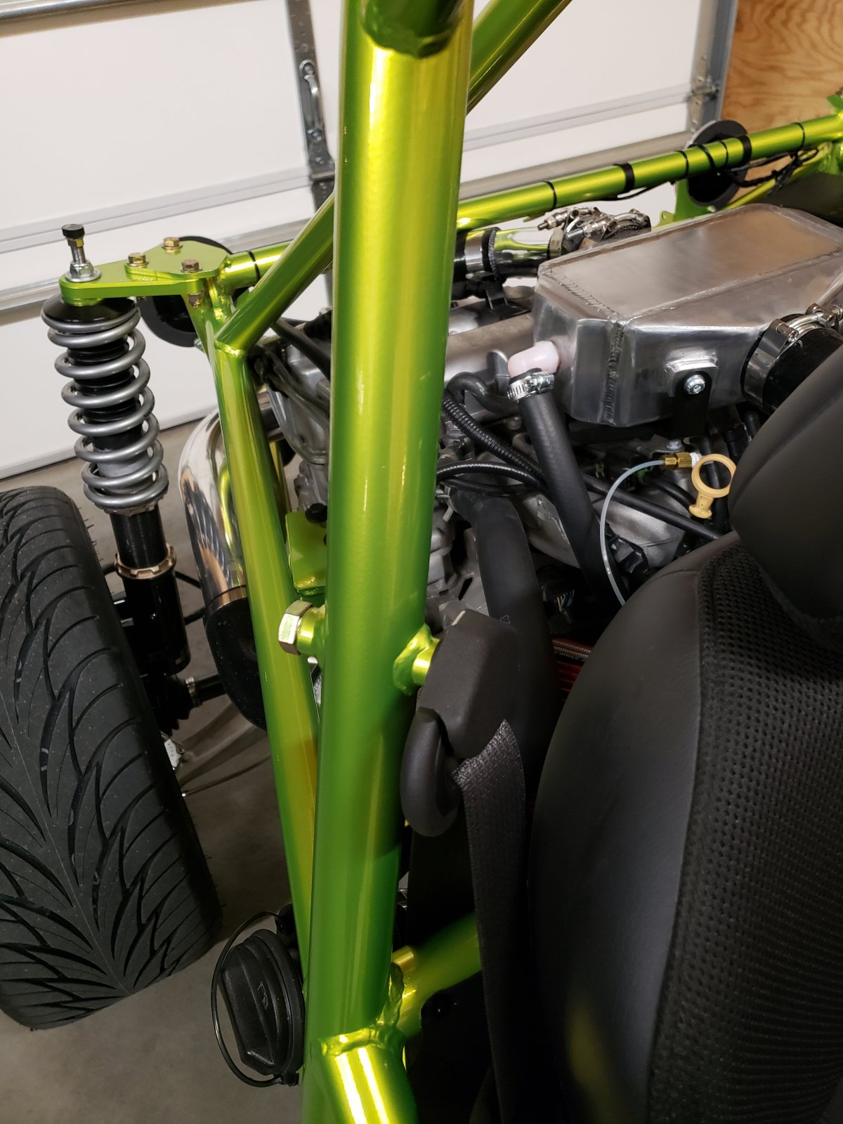

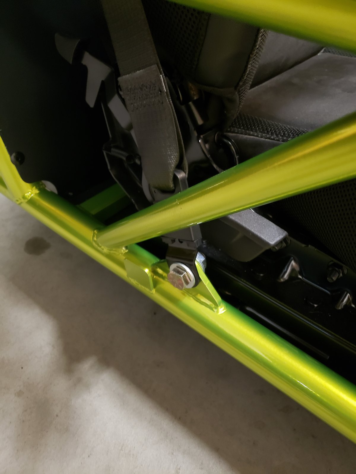

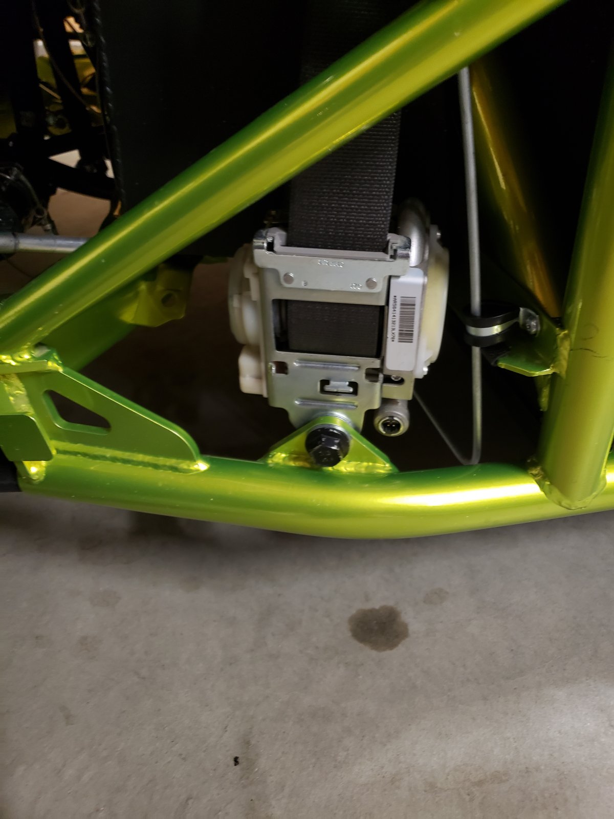

I also installed my seat belts today. I went with the original cobalt setup. Pretty straight forward, but here are some pics in case anyone has questions.
I tried to leave the shoulder bolt and the lap bolt loose on the seat belt retainer - the same as the stock Cobalt seat belts. That allows them to change angles as the seat slides forward and back. I haven't figured out the lap belt bolt yet...but I could lock it down like you did.
Tim Moland
The bolts on the main unit are tightened down. The shoulder bolt and bottom bolt have self locking nuts, so they are tightened all the way, then backed off enough for the bolts to rotate by hand. This allows them to rotate freely.

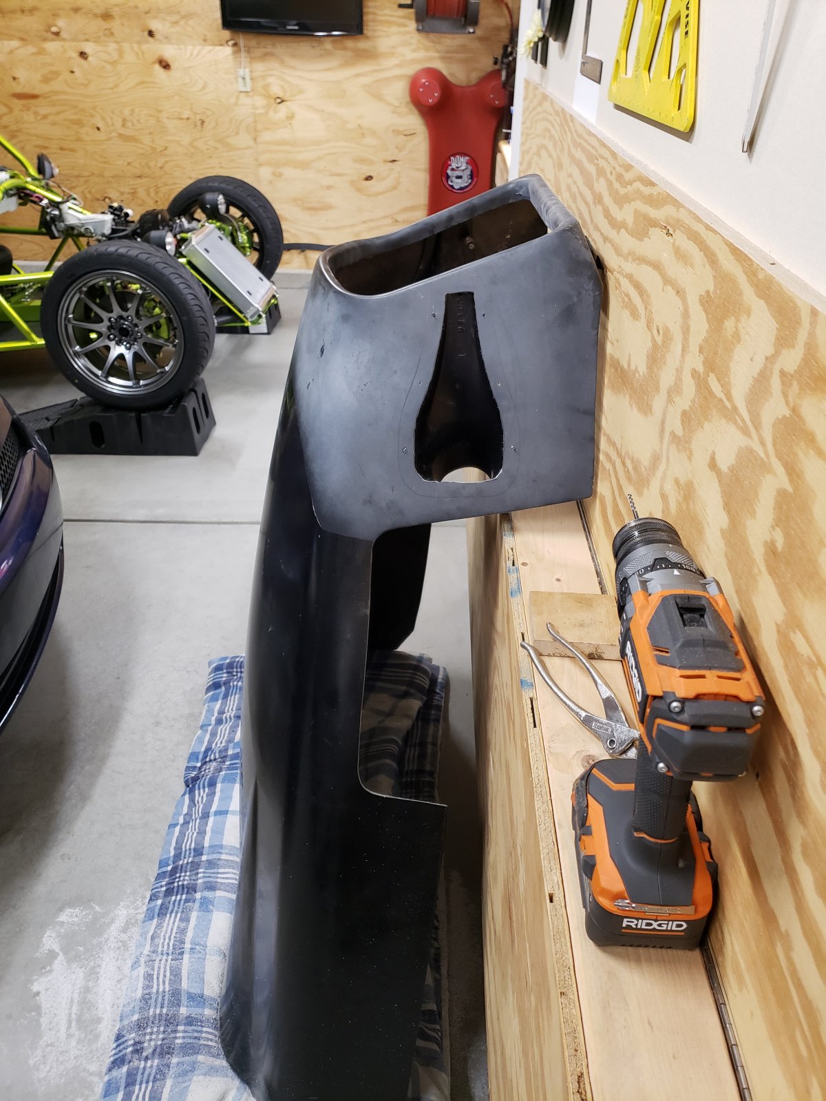

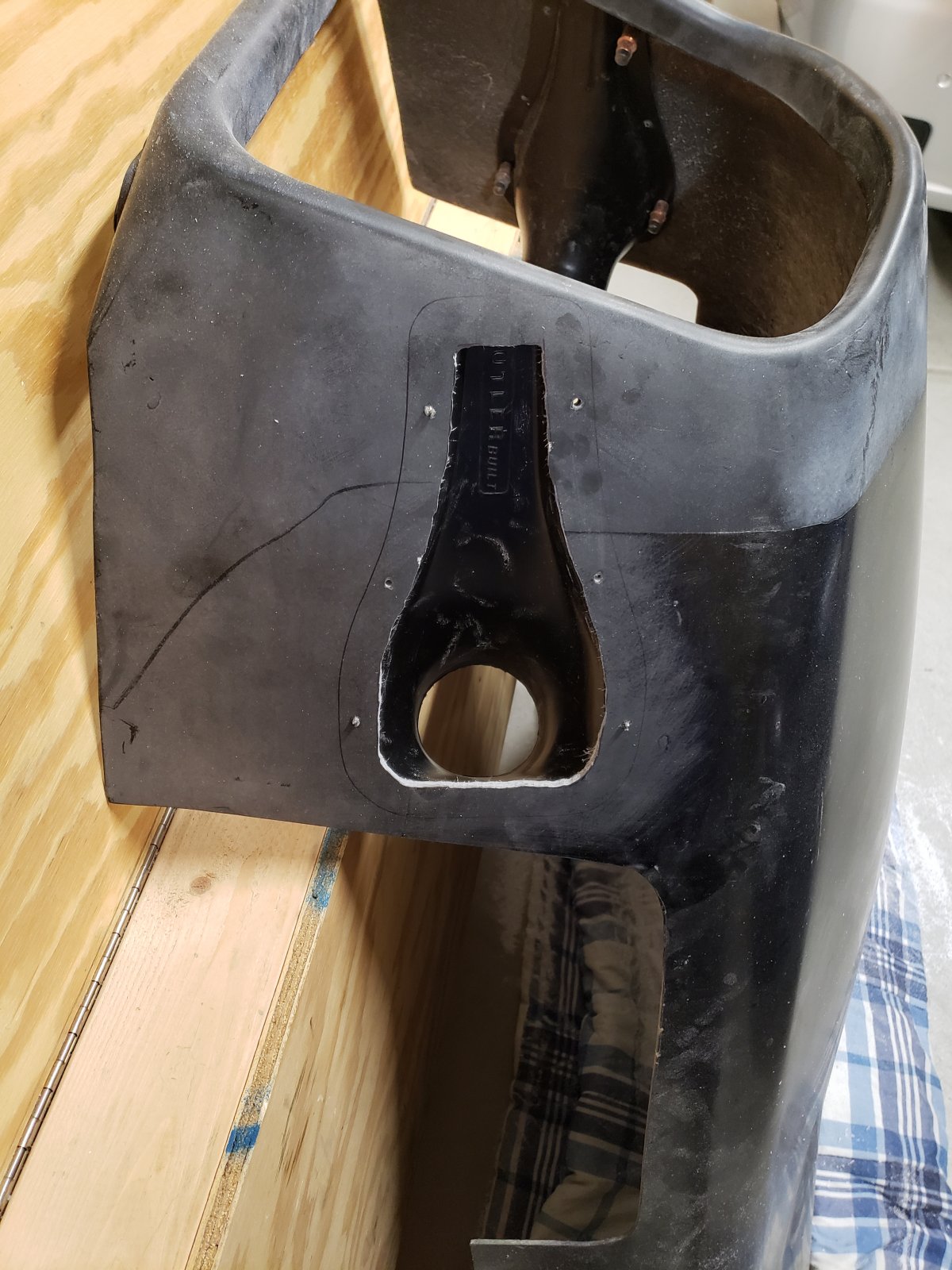

Started working on the hood tonight. Got it located and riveted on the front bracket. I decided when I ordered my kit that I wanted to install the NACA ducts on the inside of the hood to give it a smoother look. I ordered it without any cut outs so I had more options. So far I have located the ducts and made rough cut outs. Next I plan to adhere the ducts to the hood with adhesive and flush mount rivets from the outside.

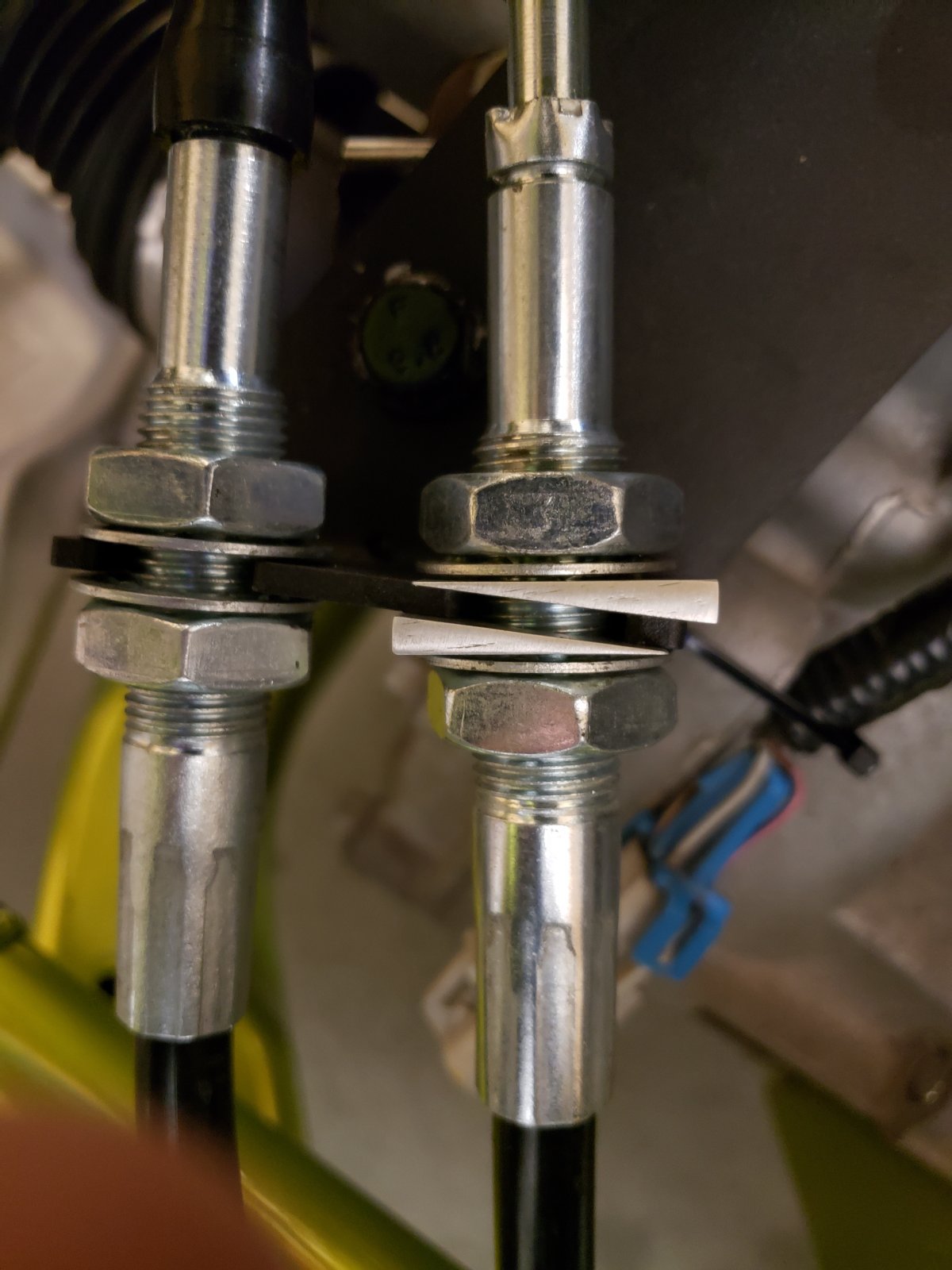

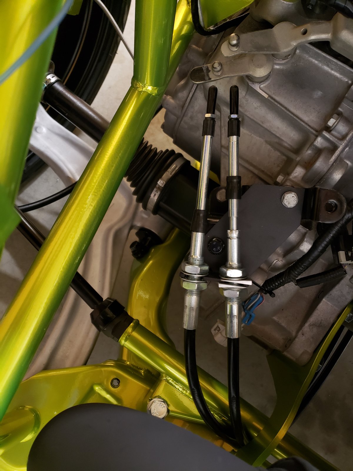

Hey guys, I wanted to post this picture a while back but forgot. When I was attaching my shifter cables to the transmission bracket, I noticed the passenger side cable did not head in the right direction to meet the shift lever. This caused unnecessary binding of the cable. So I made up a couple of wedges to go on each side of the bracket to change the angle of that cable. It turned out pretty good.

Yeah I need to do the same...Maybe itll make it smoother

My attempt at reducing cable stress.

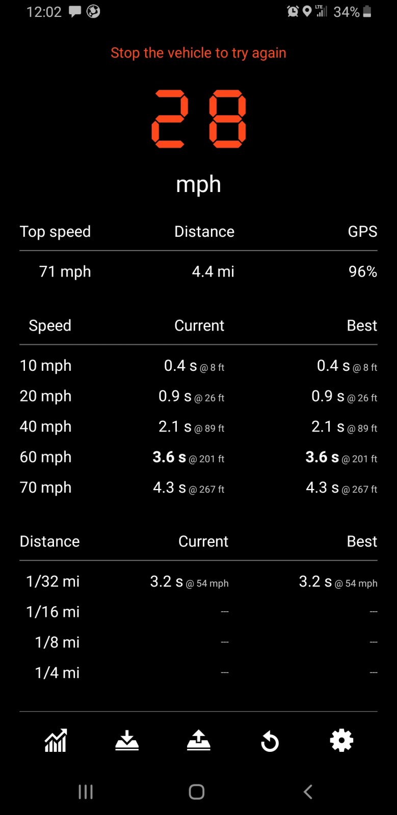

Downloaded an app called DragRacer. It's fun to go out and see what your car can really do. It uses GPS to track you. I have no idea if it is accurate, but it seems consistent. Here is my best run so far. I still need to try the No Lift Shift for a faster time.
