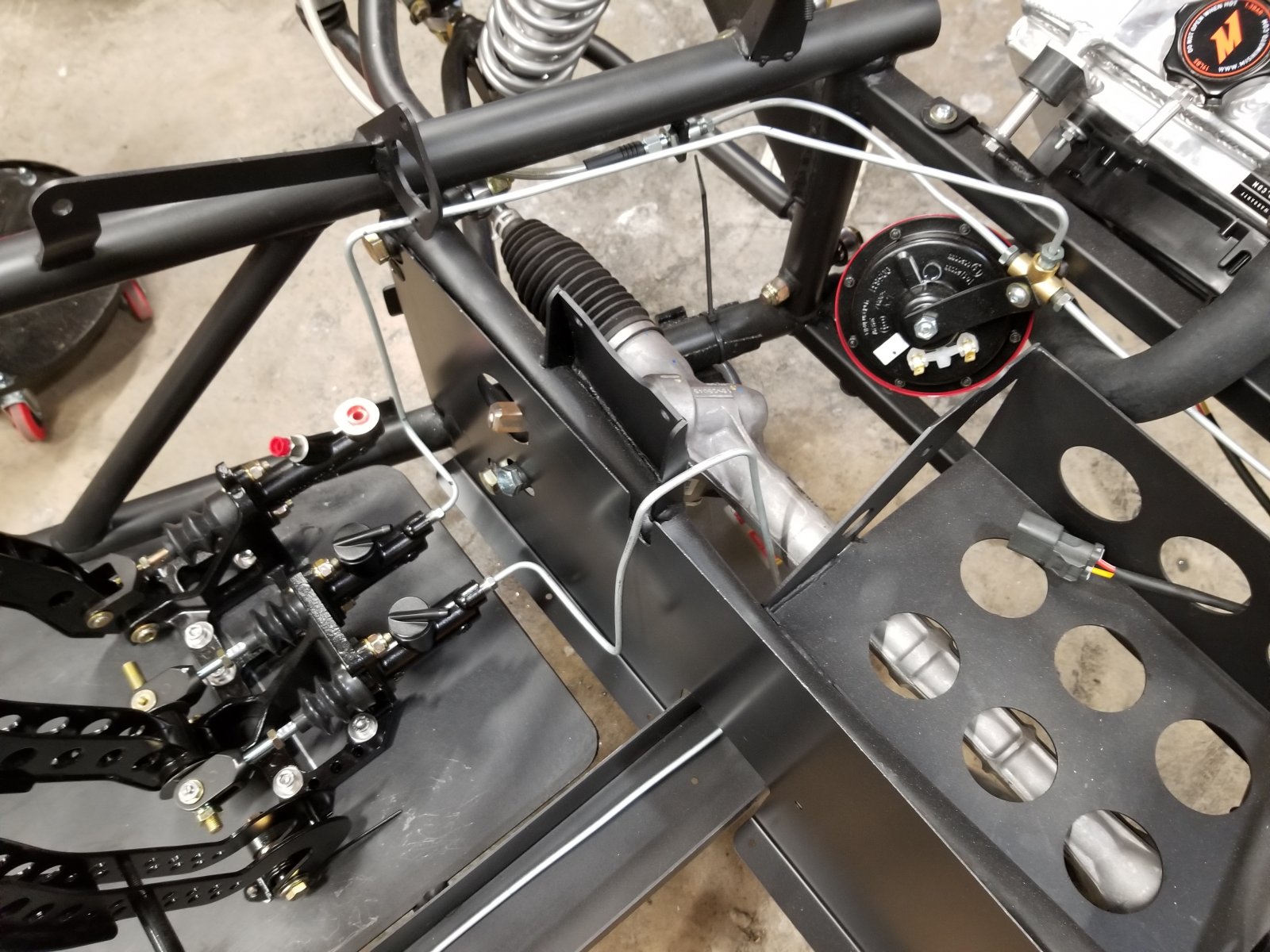

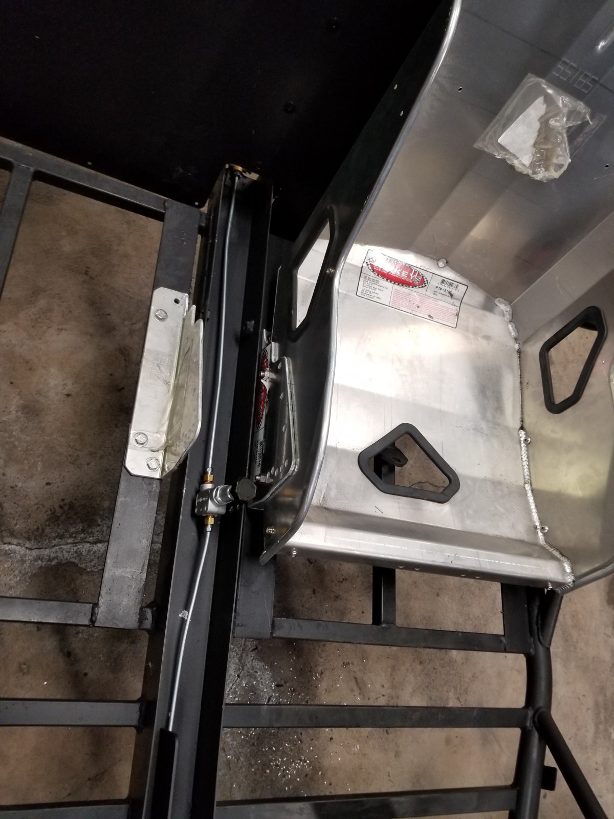

Now that it is finally getting warmer I have been picking away at a few things with the Goblin. I got the pedal box installed and plumbed. I decided to run the front brakes without an adjustable proportioning valve and see what happens. If it is too much brake pressure I will just swap to a different master cylinder.
23221
And the adjustable propositioning valve installed for the rear brakes.
23222

With your adjusting bar at the pedal you can set your balance front to rear pretty well without the proportioning valve. Also, you may find you need about a 2 psi residual valve in your rear brake line and maybe your front one too. This is du to your masters being lower than the calipers and yu may find a little bleed back of fluid from the higher caliper to the lower brake master.

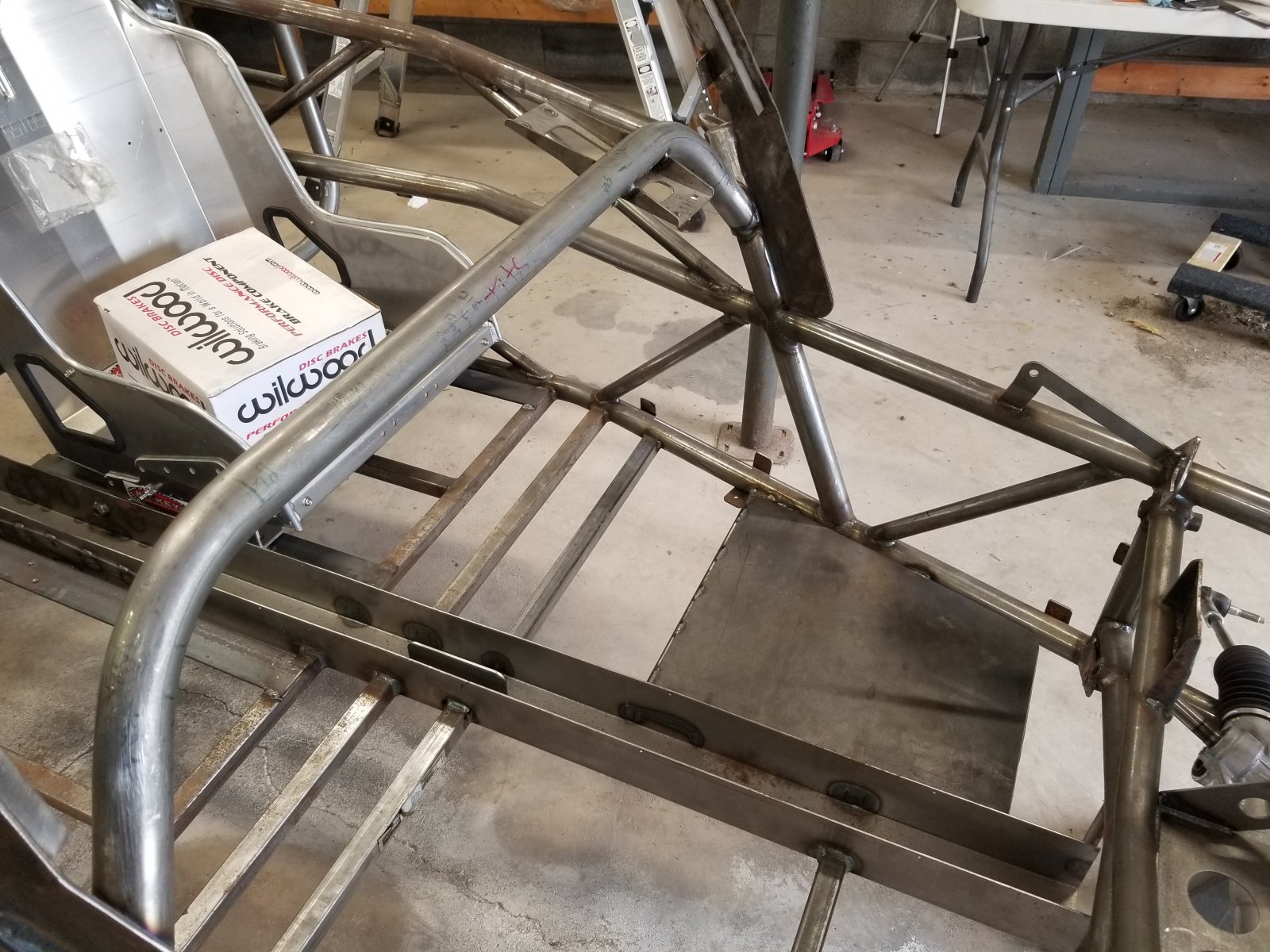

Here you can see a bunch of what was done. Windshield frame, side pods, new dash bar, harness bar, flat stock to mount the Kirkeys, and upsidedown steering column mount(will get fixed later on when they stop by to add mounting tabs for coolant/heat exchanger tanks and other misc stuff.
Close up of the top of the windshield frame. Still needs some massaging. It is flat stock welded onto a round tube and filled with weld on top to smooth it out. The mounting lip for the windshield is recessed 1/2" per recommendation of my local glass guy who will be doing the windshield. 1/4" for the glue and another 1/4" for the glass itself and hopefully it'll sit flush.
Extra square tubing in the floor again and flat stock to mount the Kirkeys to.

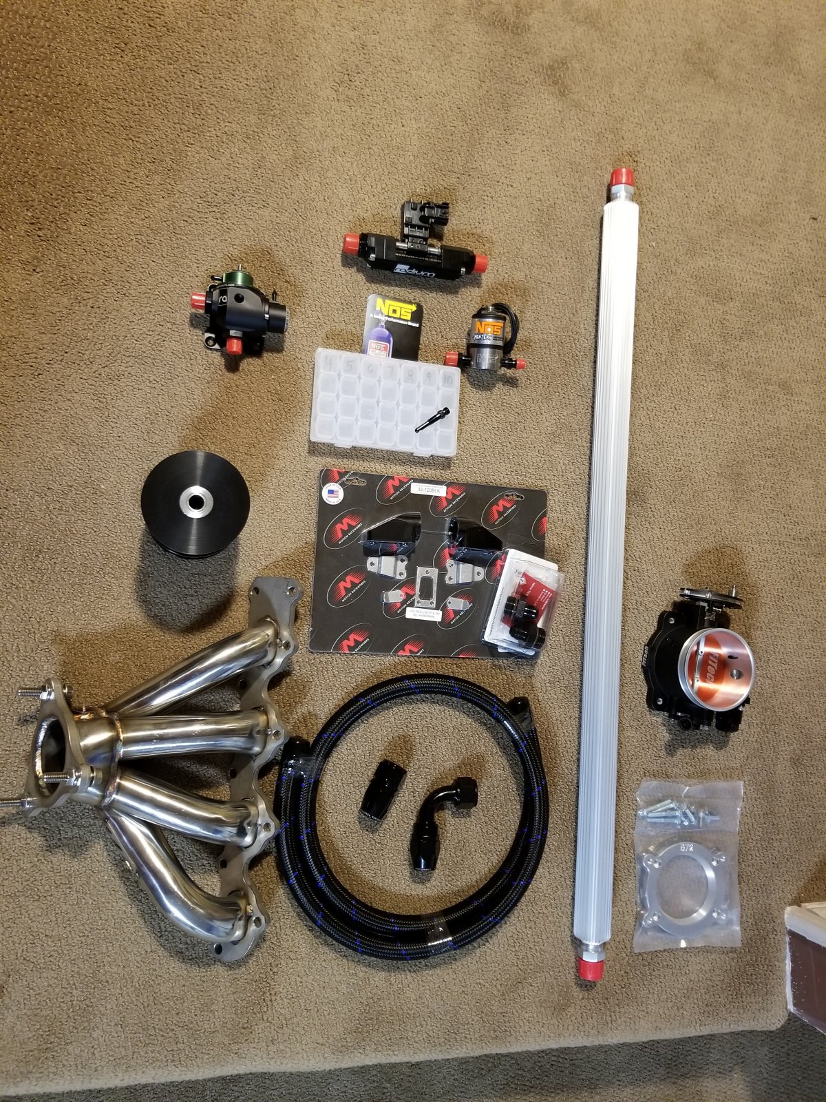

A bunch of parts that have arrived.
27722
Vibrant AN line -12 pictured, I also picked up -8 and -6.
A whole assortment of -12, -8, -6 AN fittings from Redhorse.
92mm cable driven FI Tech LS3 throttle body. I've had the ITC Billet LS3 to LS4 TB adapter for a bit(LSJ and LS4 share the same TB bolt pattern).
ZZP shorty header. Not thrilled with it, but a cheap temporary option for now.
ZZP solid poly transmission bushings.
Radium Engineering E85 sensor "housing" and AFPR with built in pulse damper.
NOS Cheater solenoid, 90* nozzles, and an assortment of jets.
Motion Raceworks bolt on PCV system. I have been eyeing this for a bit and am not disappointed with it.
Lastly 36" long All Star performance "oil cooler". 3/4" NPT threads on each end. I tossed some 3/4" NPT to -12AN fittings in the ends and it should work well as a crossover pipe between both heat exchangers.

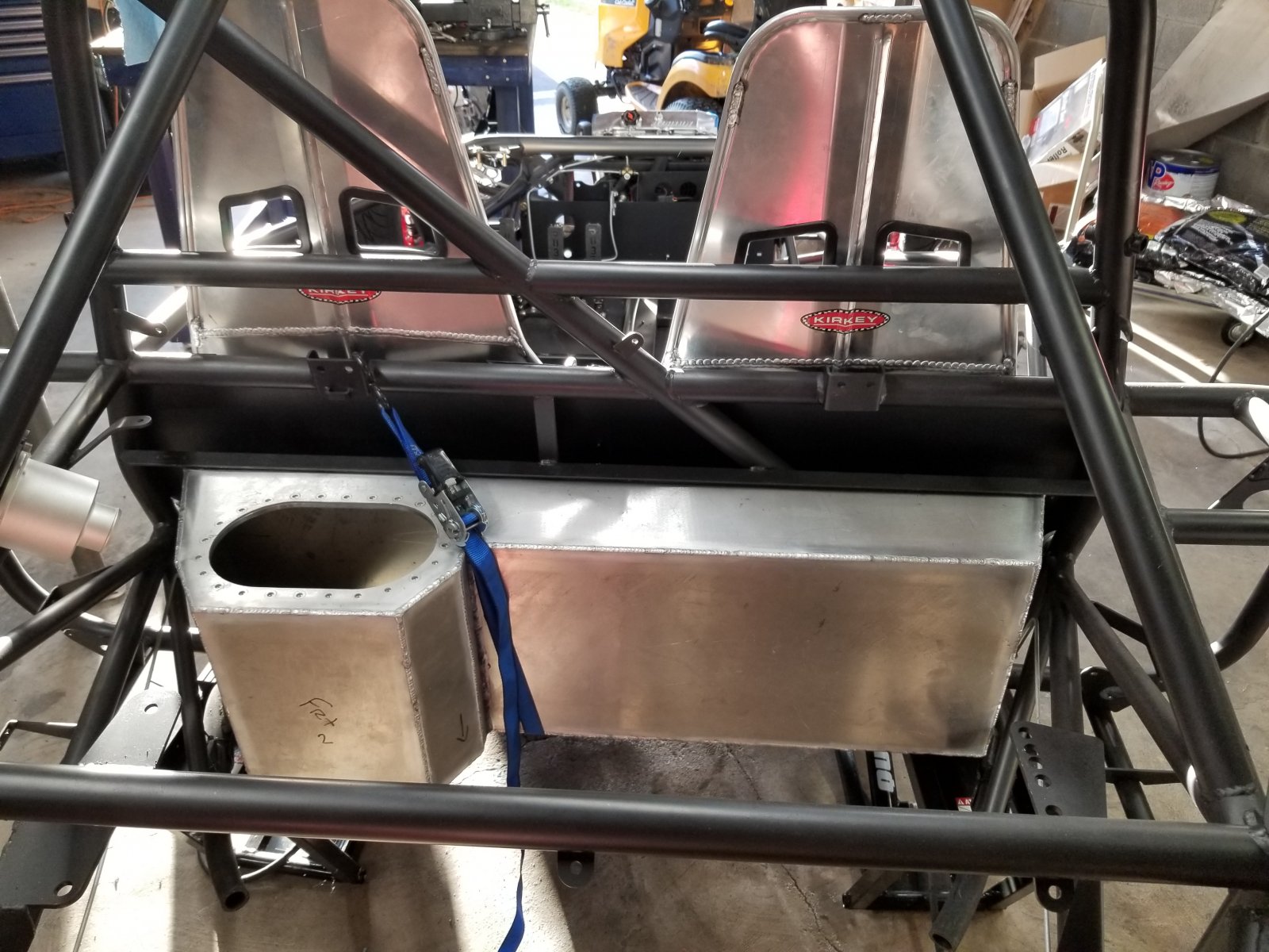

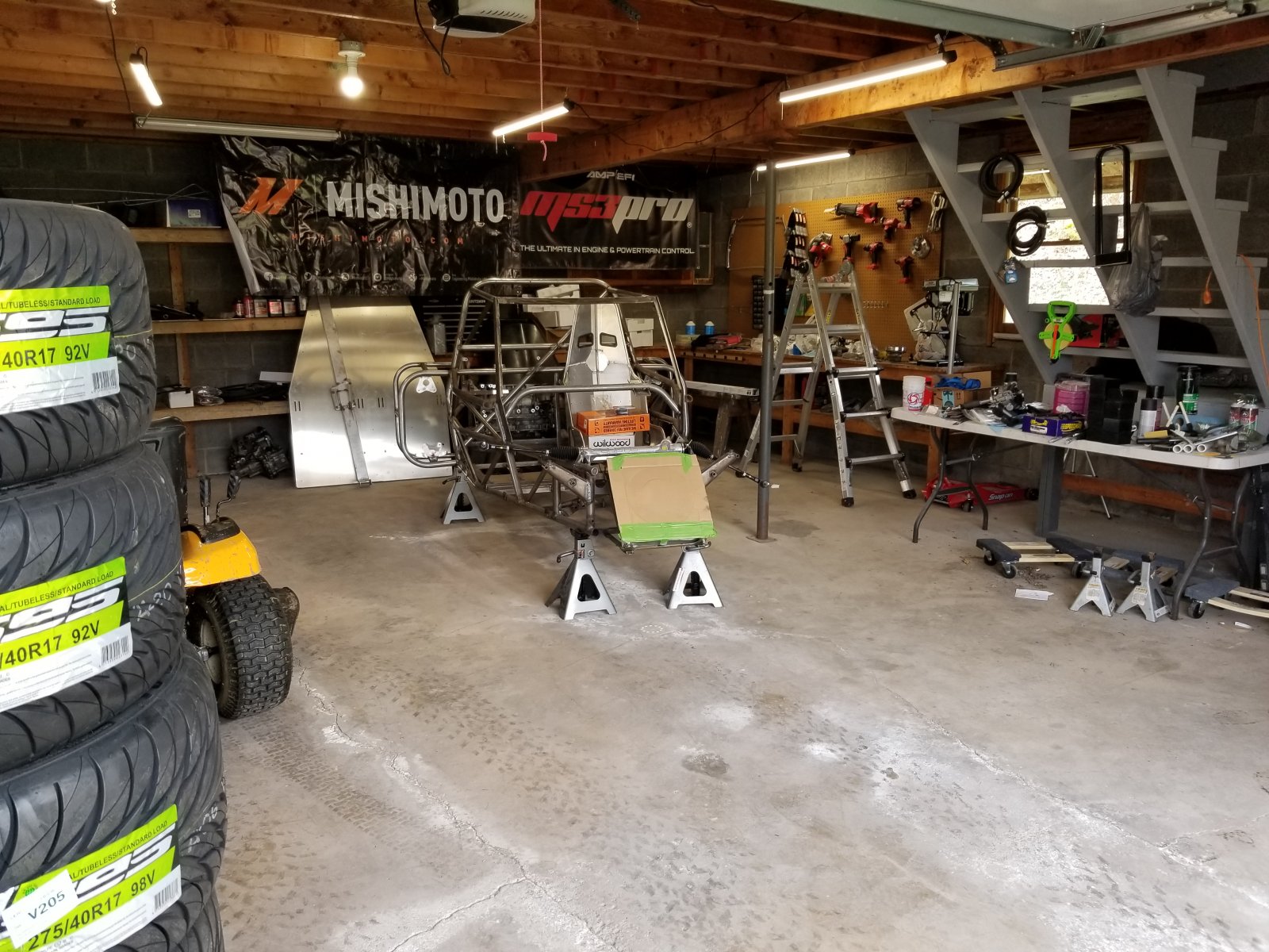

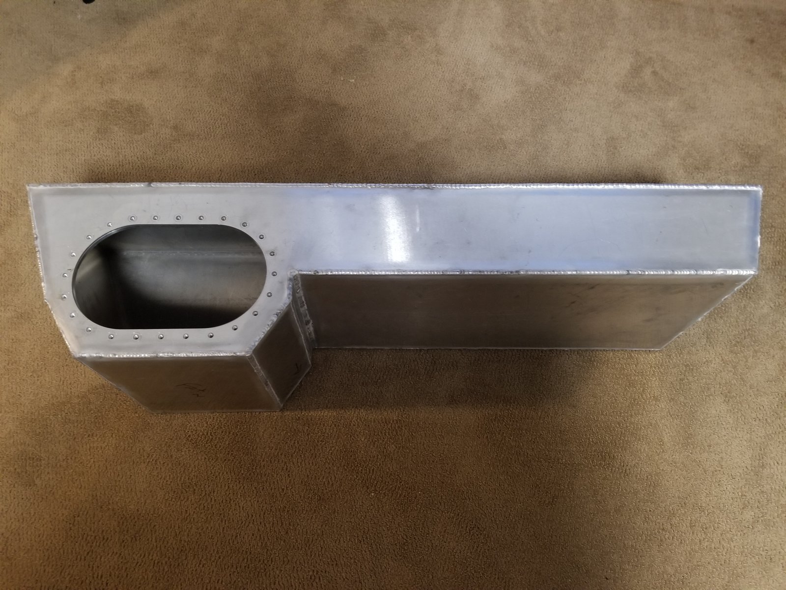

Finally. 1st off, I do not know how much the tank holds. I can get comparison pictures with the stock tank in a few days, but it is 3" taller and I think ~3ish inches wider from side to side. The 2 main goals are to add capacity do to me wanting to run E85 and to fit a Radium Engineering FCST. 1st and 2nd designs were just measurements that I obviously messed up. 3rd time around I just built it out of cardboard and actually installed it to make sure everything fit.

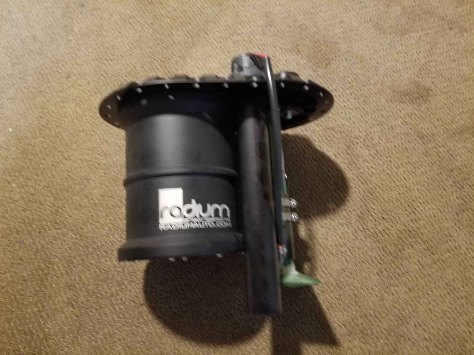

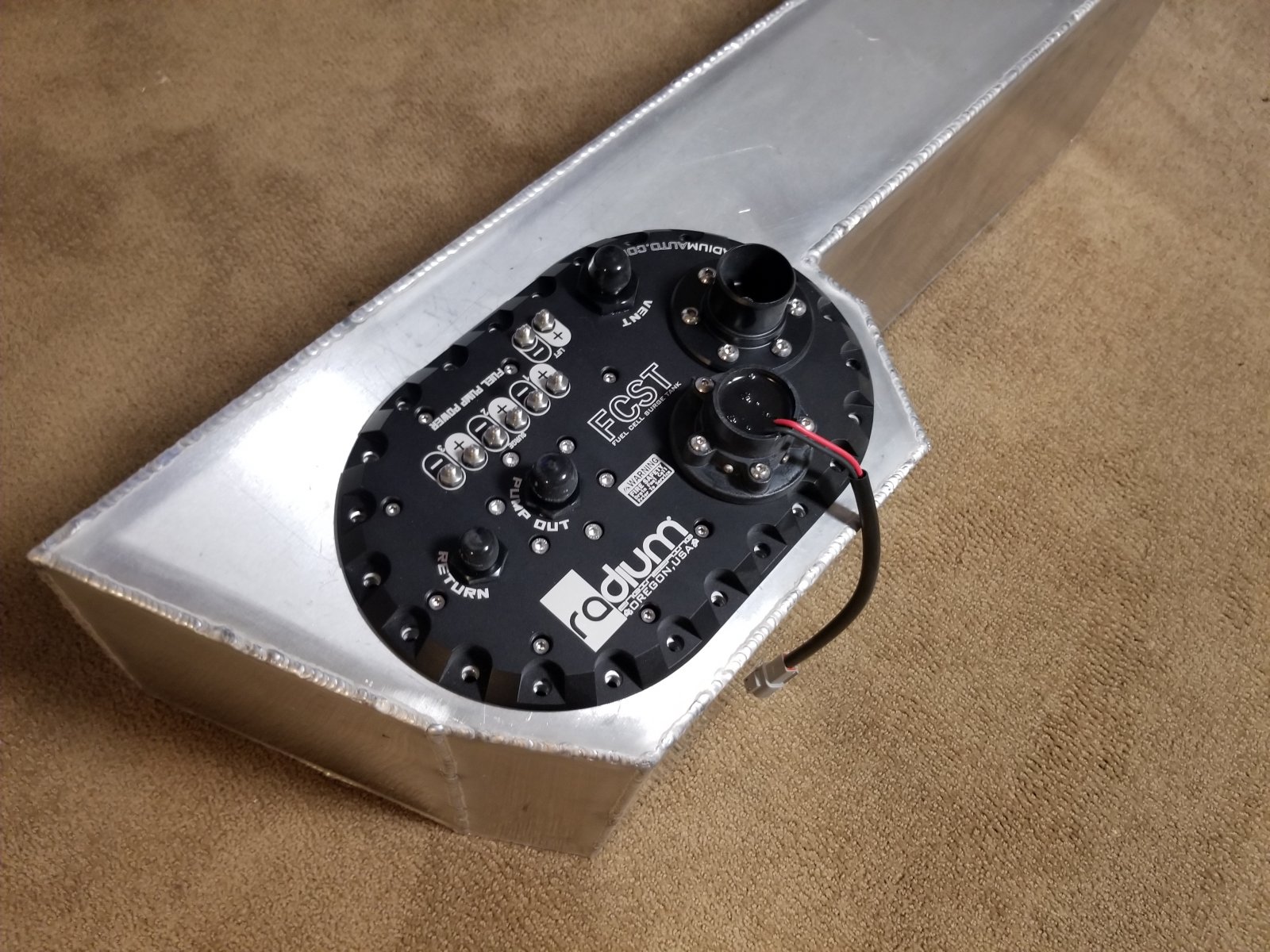

The FCST has one AEM 340 lift pump and 2 AEM 340 pumps in the 2.2L surge tank. It has EVERYTHING. Fuel fill, vent port, fuel level sensor, feed and return, and everything is already wired. I just have to swap the brackets that hold the lift pump and bolt it in.

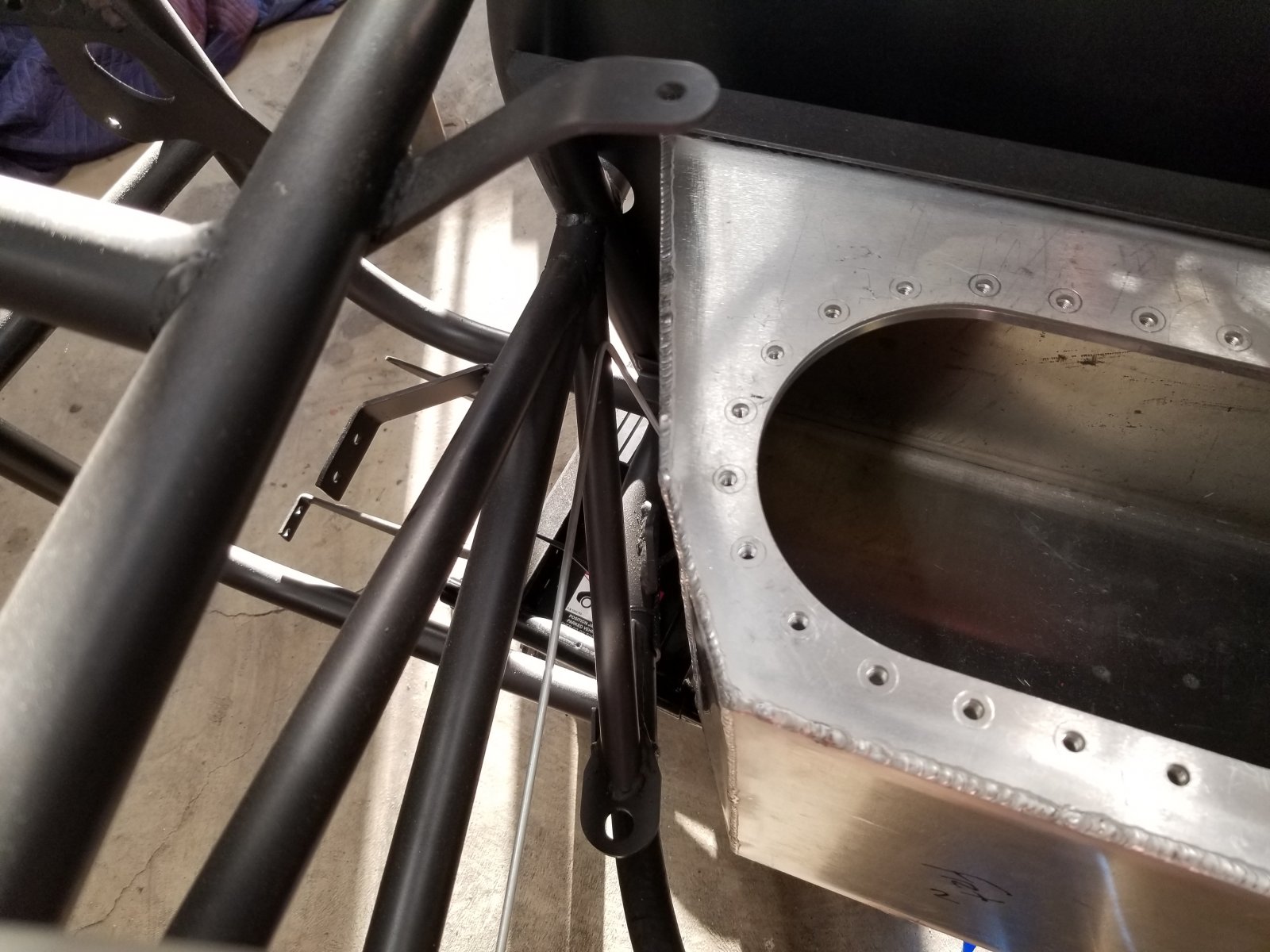

Tank fits. It is a bit tricky to get in and out. Definately not possible with the engine/trans/subframe installed. The fuel fill will have to be moved again to basically the "OEM" location, but on driver side instead of the passenger side.

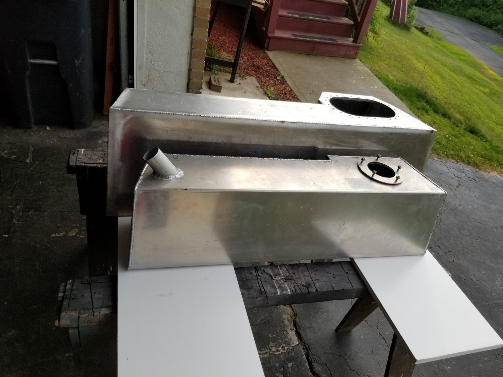

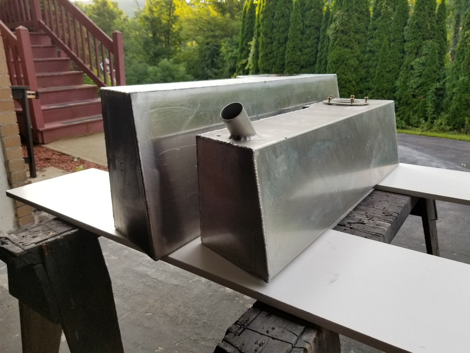

Compared to the stock tank.
34121
34122
I also calculated it's volume by filling some old gallon jugs with water and dumping them in. I confirmed that the stock tank is 9 gallons.
34123
I might be able to sneak another gallon into it, but I stopped here to allow room for the FCST. So I feel safe saying that 15 gallons is an accurate number.
