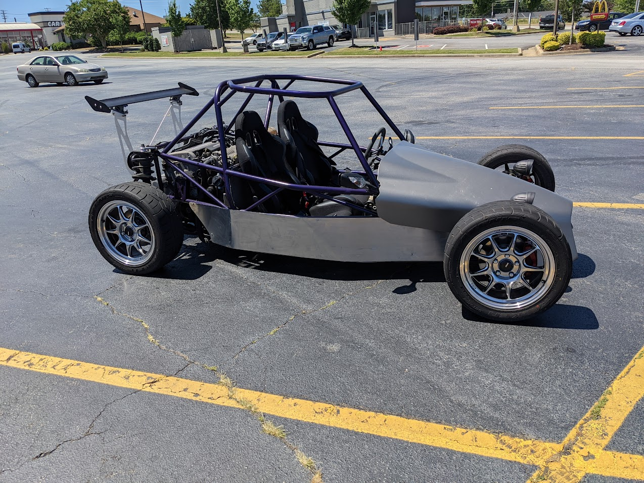

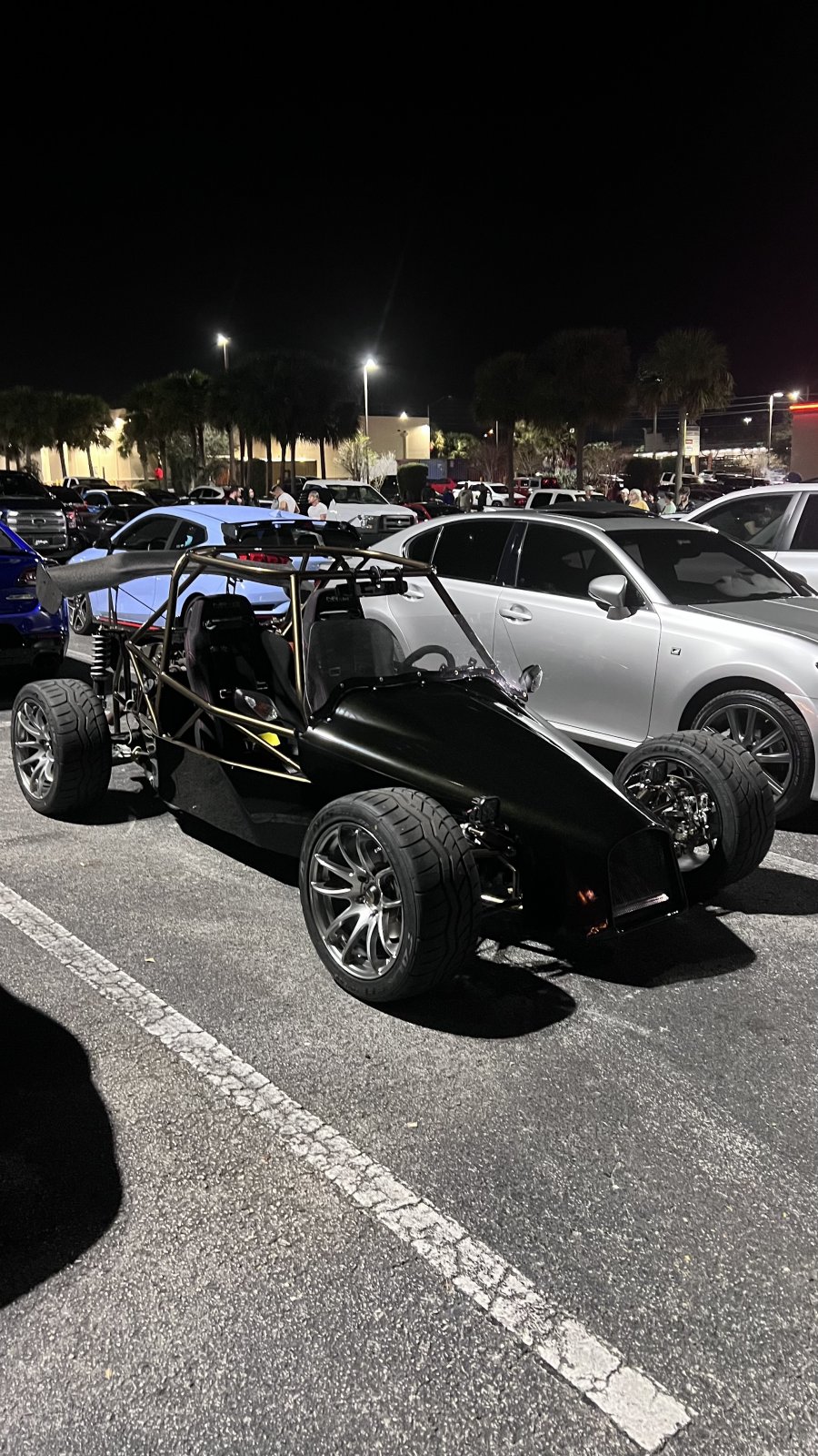

Goblin Builder: Robinjo
Chassis Number: 405
Frame Type / Color: Standard Full Cage / Red
Donor Year / Engine: 2006 2.0L Supercharged
Wheel Make / Model: Konig Myth (Red)
Front Wheel - Size / Offset / Bolt Pattern: 17x8.0" /+43mm / 5-114.3mm (No Spacers)
Rear Wheel - Size / Offset / Bolt Pattern: 17x8.0" /+43mm / 5-114.3mm (No spacers)
Wheel Weight in lbs.: 20.7 lbs
Tire Make / Model: Continental Extreme Contact
Front Tire Size: 225/45R17
Rear Tire Size: 225/45R17
Seat Make / Model: Cobalt SS Stockers!

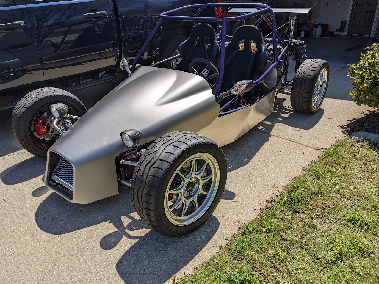

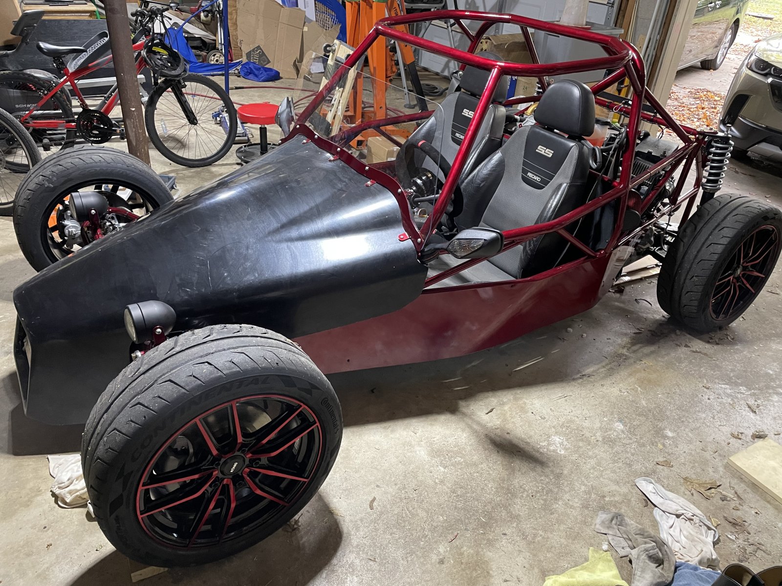

Goblin Builder: Corgithulhu
Chassis Number: 318
Frame Type / Color: Extended full cage/purple
Donor Year / Engine: ‘07 2.0L supercharged
Wheel Make / Model: Konig Countergram p/n CT8751438C
Front Wheel - Size / Offset / Bolt Pattern: 17x8 / +38mm (+25mm spacers/bolt pattern adapters) / 5-114.3
Rear Wheel - Size / Offset / Bolt Pattern: 17x8 / +38mm (+25mm spacers/bolt pattern adapters) / 5-114.3
Wheel Weight in lbs.: 17.42
Tire Make / Model: Falken Azenis RT615K+
Front Tire Size: 245/45ZR17
Rear Tire Size: 245/45ZR17
Seat Make / Model: Nothing notable, something from one of the online retailers

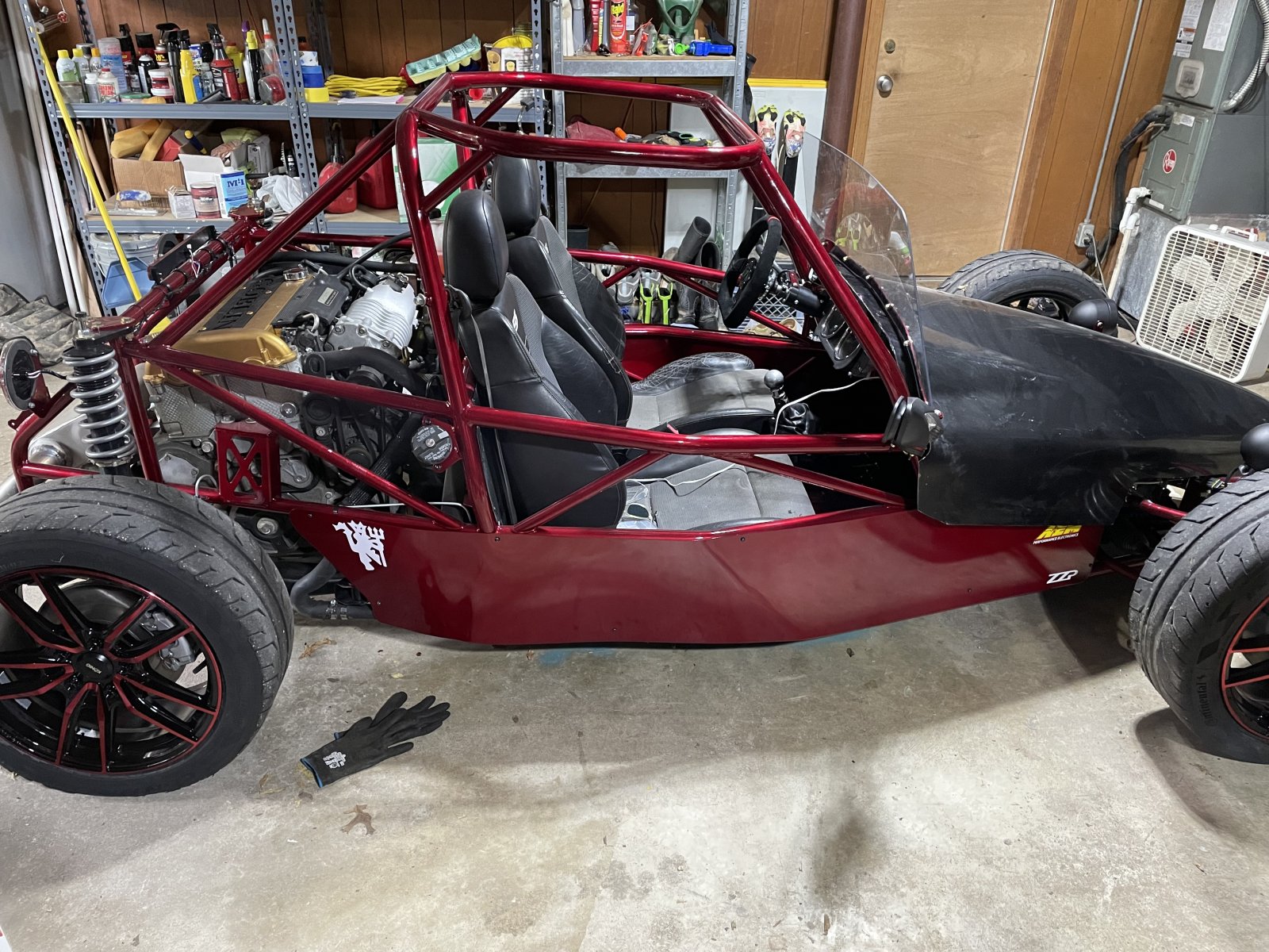

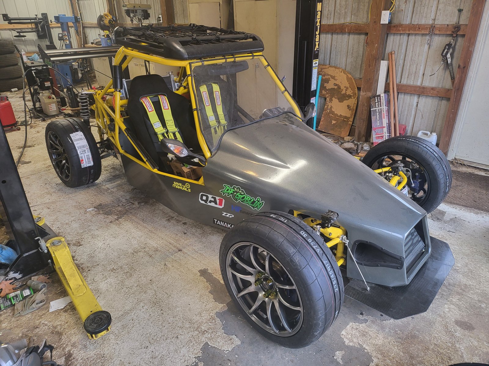

Goblin Builder: Scott321
Chassis Number: 321
Frame Type / Color: Extended full cage easy entry
Donor Year / Engine: ‘09 2.0L turbocharged
Wheel Make / Model: MST Suzuka 17X9.5
Front Wheel - Size / Offset / Bolt Pattern: 17x9.5 / +20mm / 5-114.3
Rear Wheel - Size / Offset / Bolt Pattern: 17x9.5 / +20mm / 5-114.3
Tire Make / Model: Nitto NTO1
Front Tire Size: 255/40ZR17
Rear Tire Size: 255/40ZR17
Seat Make / Model: Corbeau FX1 supplied by DF

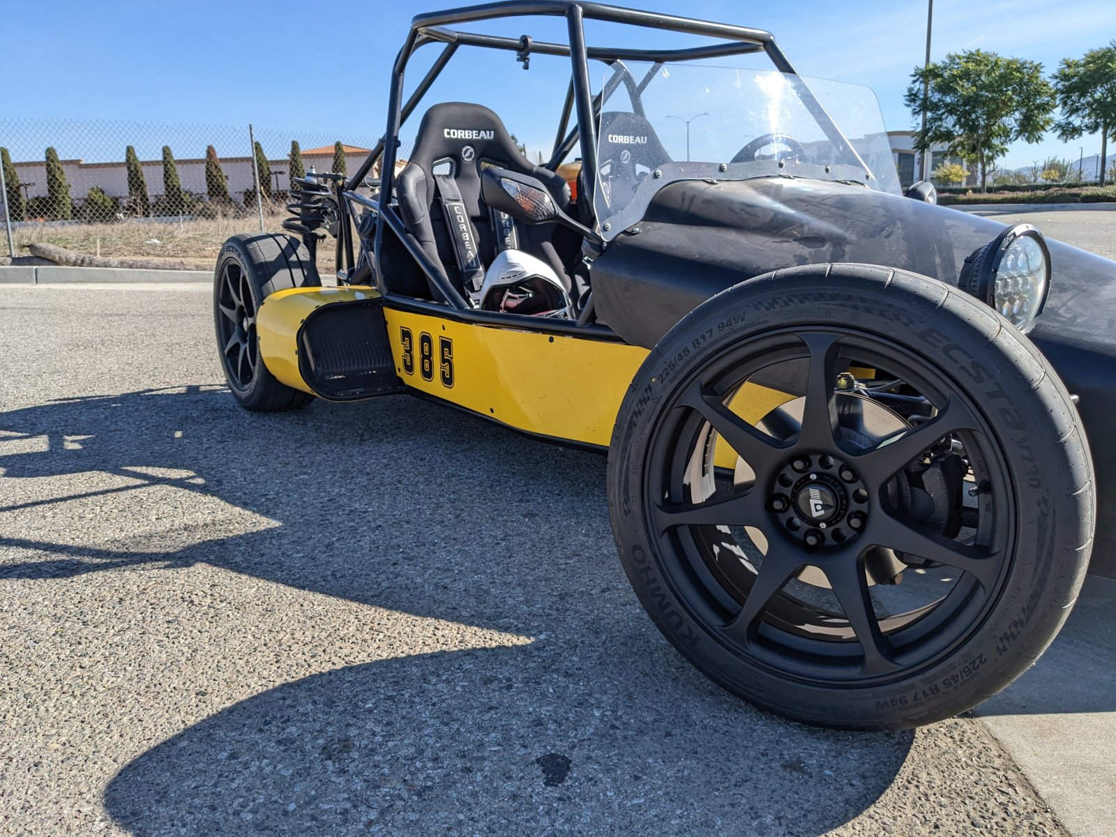

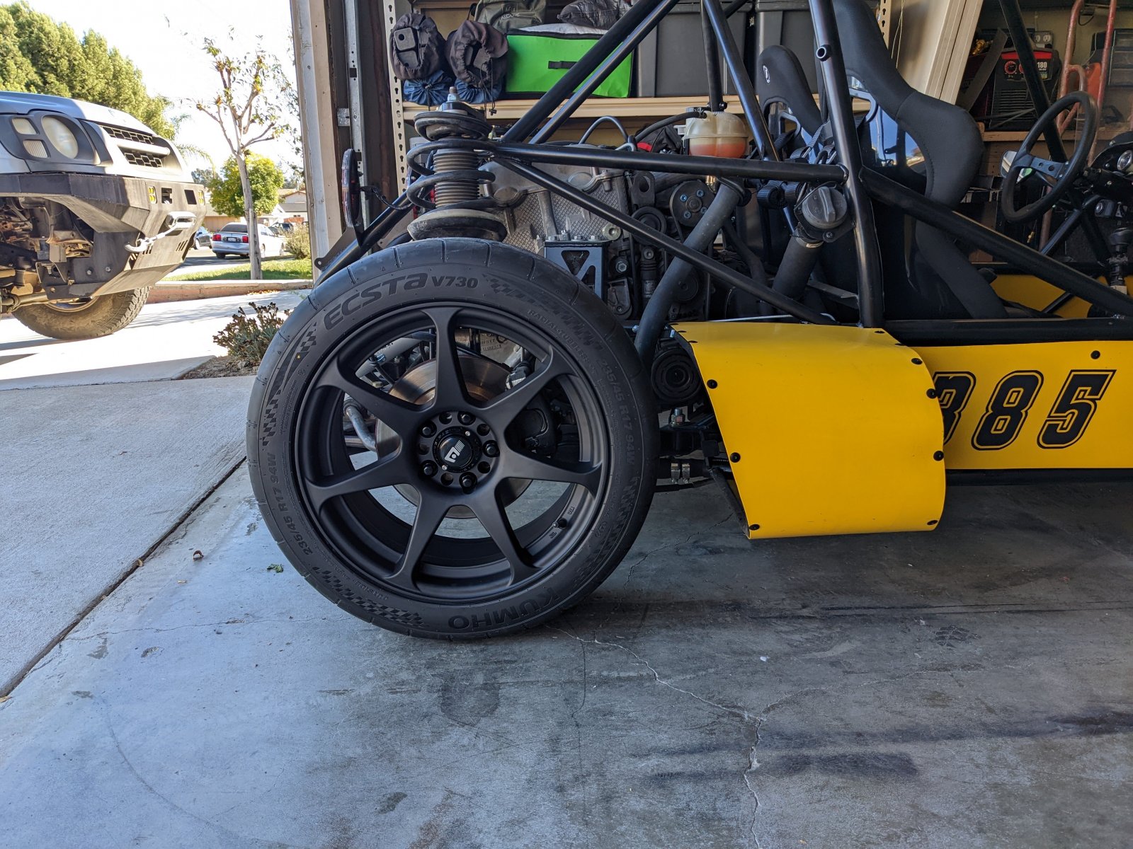

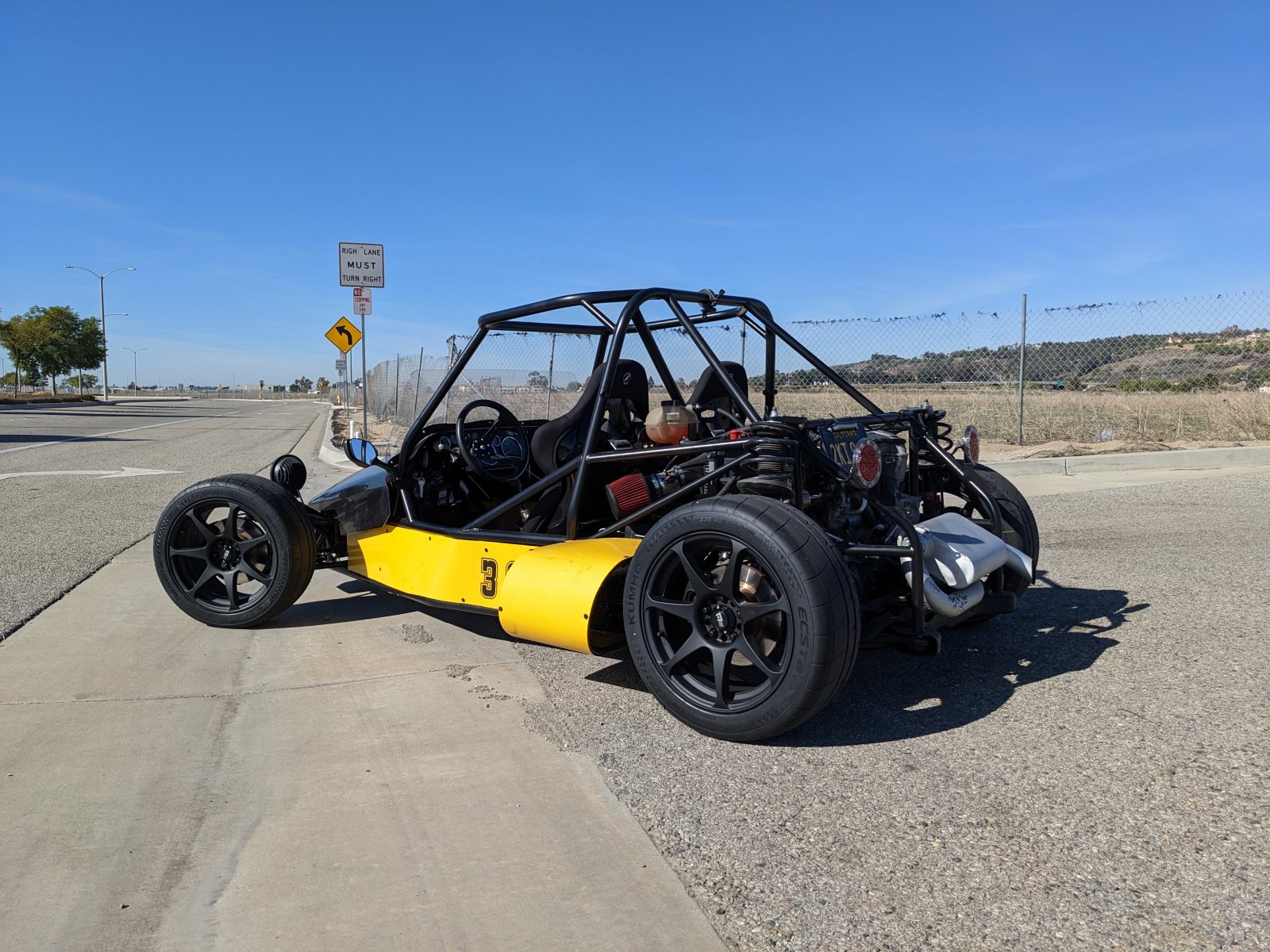

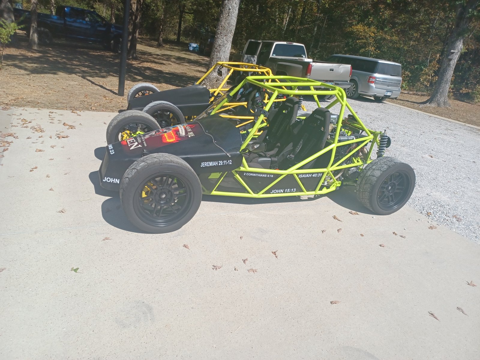

Goblin Builder: Kurbkilla
Chassis Number: 385
Frame Type / Color: Extended, track, easy entry doors / Black
Donor Year / Engine: 2007 / 2.0 supercharged
Wheel Make / Model: MOTEGI RACING MR154 Battle / Black Painted
Front Wheel - Size / Offset / Bolt Pattern: 17x8 / +30 / 5x110
Rear Wheel - Size / Offset / Bolt Pattern: 17x8 / +42 / 5x110
Wheel Weight in lbs.: 20.59 lbs
Tire Make / Model: Kumho Ecsta V730
Front Tire Size: 225/45-17
Rear Tire Size: 235/45-17
