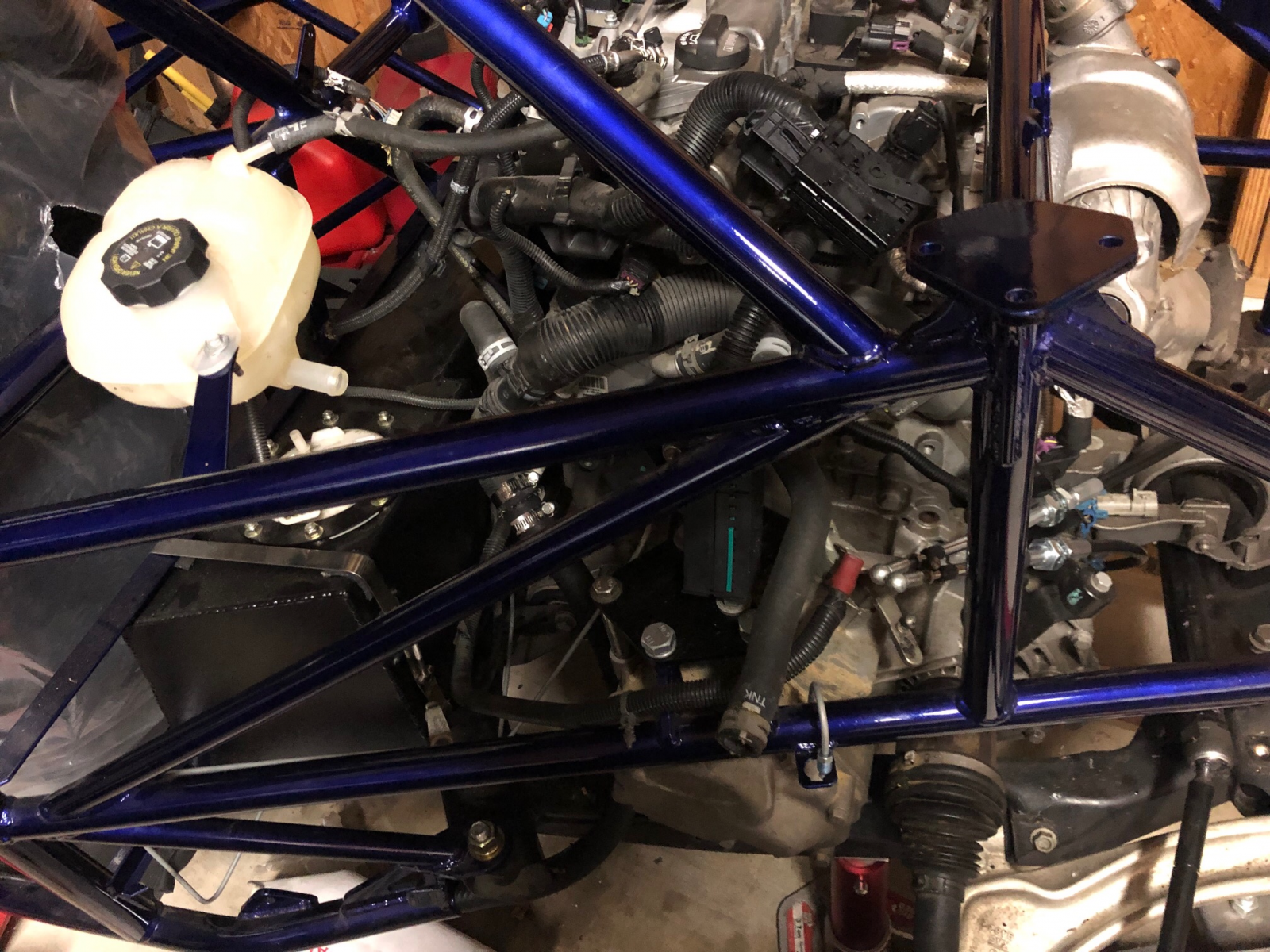

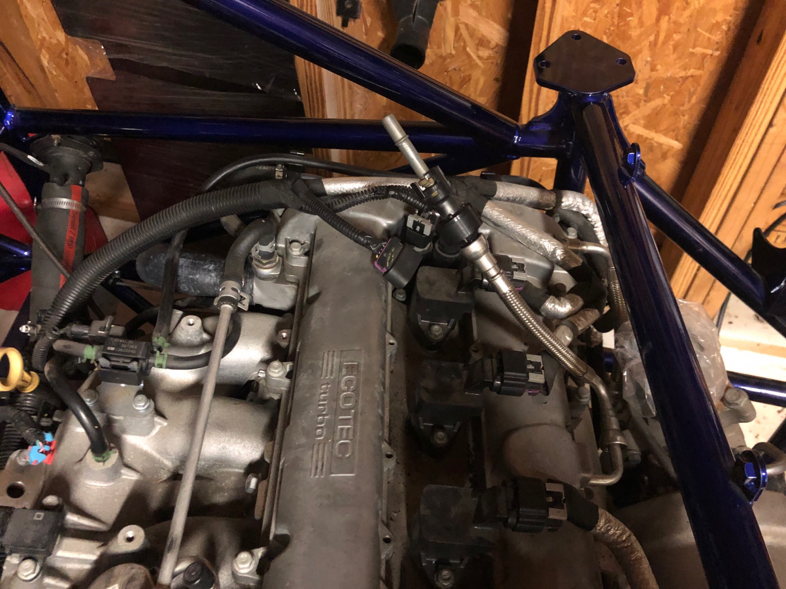

At this point have seats in, motor and subframe in, all brake and clutch lines in, all engine hoses except for coolant tank to engine hose and fuel line from tank to engine. Need to finish some things up on the wiring harness but getting very close at this point. Have several questions if anyone can chime in.

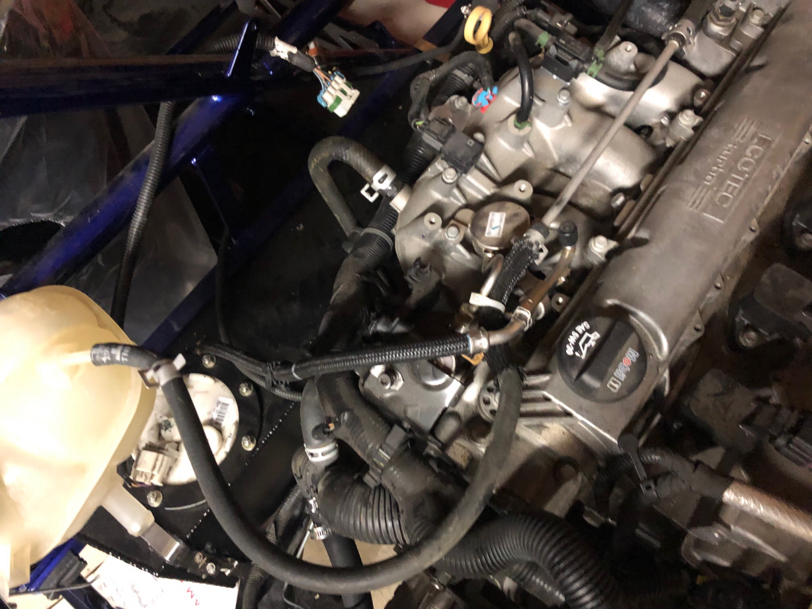

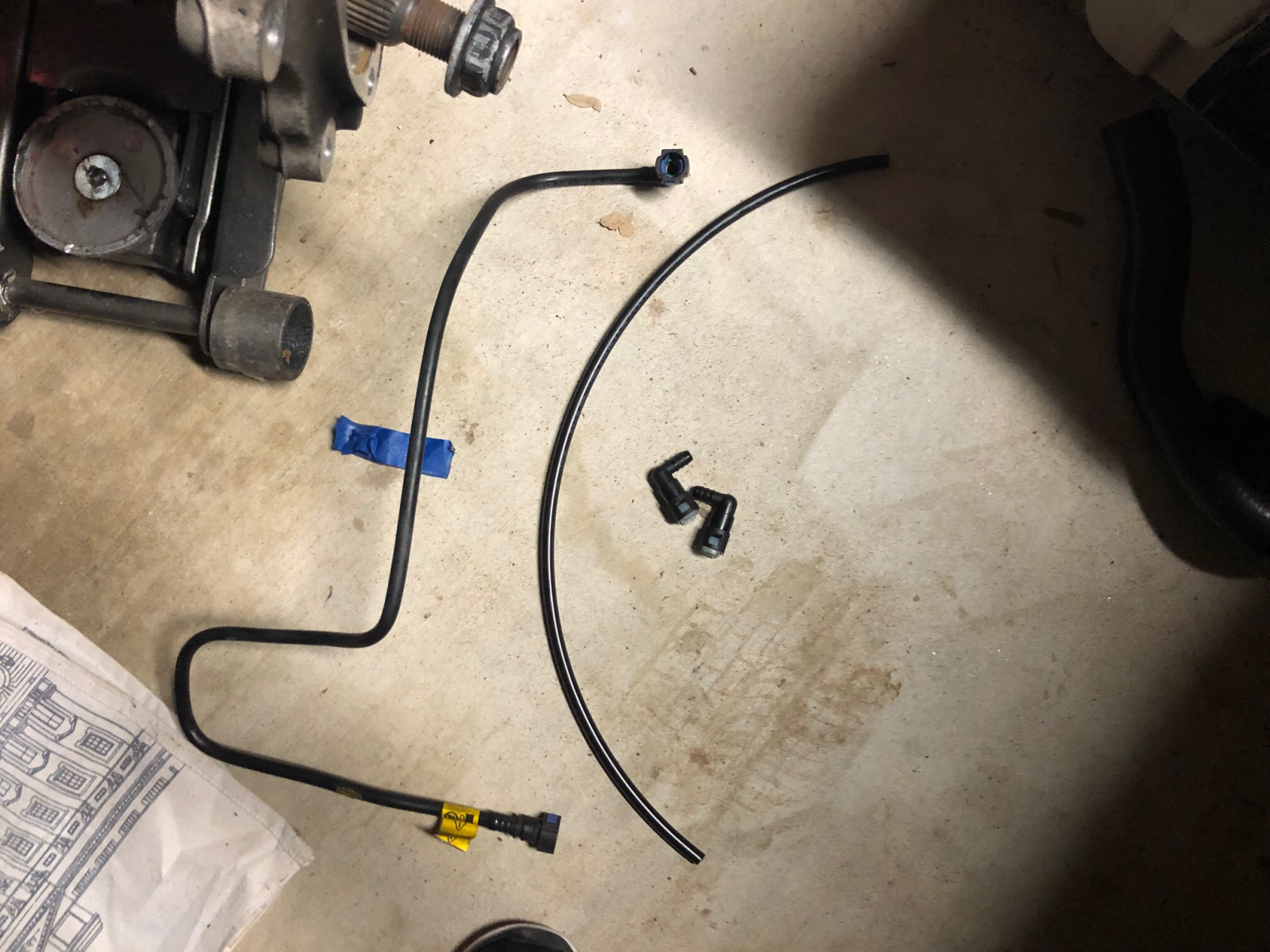

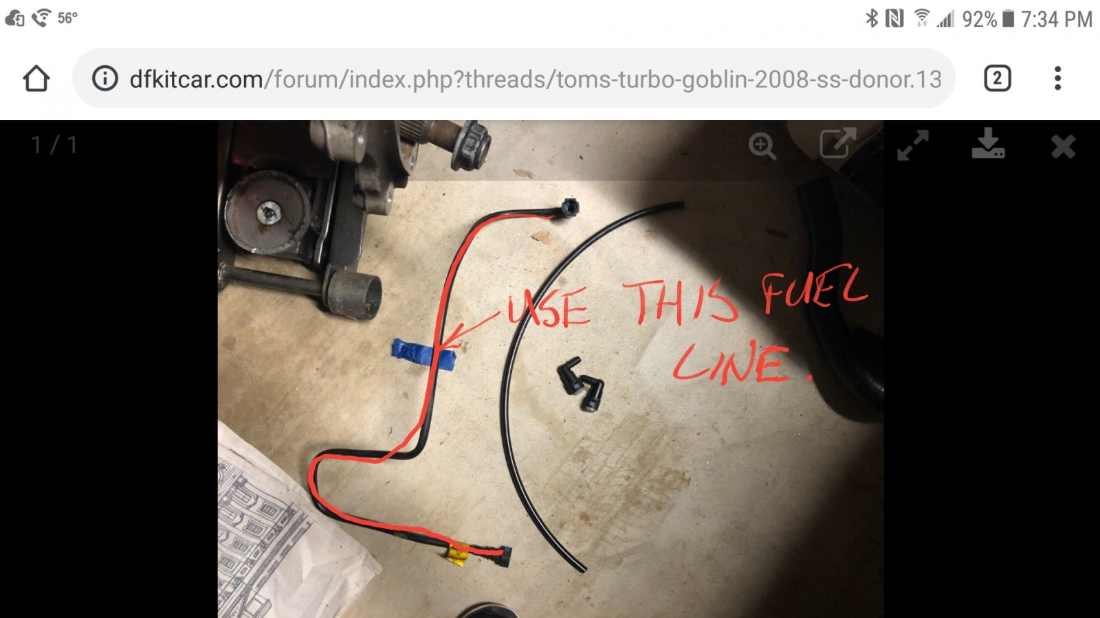

Fuel line - on the SS should I just reuse the stock one? The supplied line and connectors don’t fit the SS pump.
Do I need to connect anything to the nipple on the tank?
Do I need to connect the other hose on the manifold to intake or should I just put on a filter and VTA?

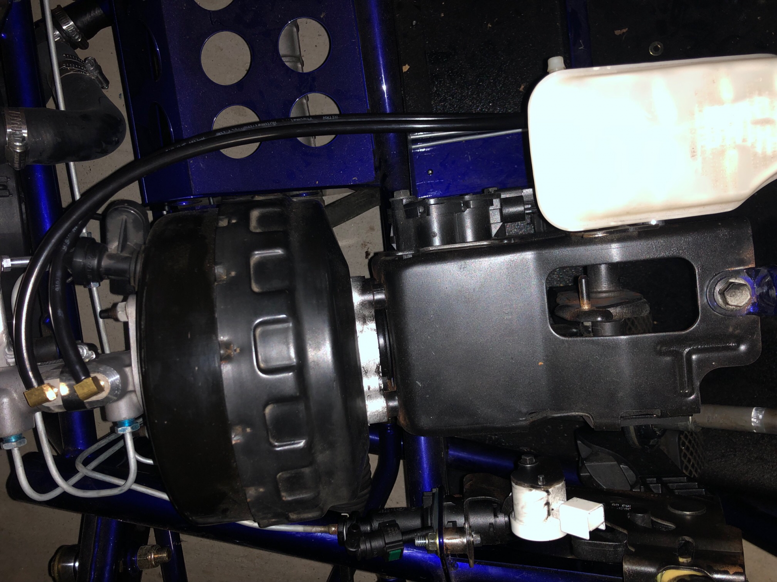

What hose do I use to connect the clutch MC to brake fluid tank?

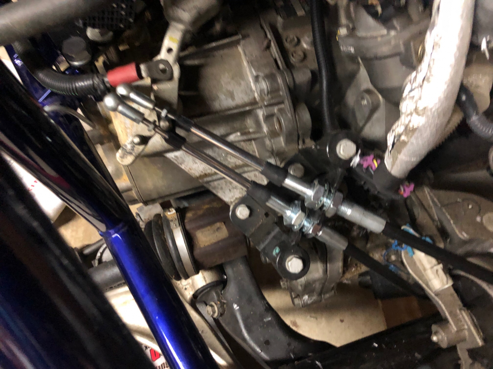

Do I need a different bracket for mounting the shifter cables?

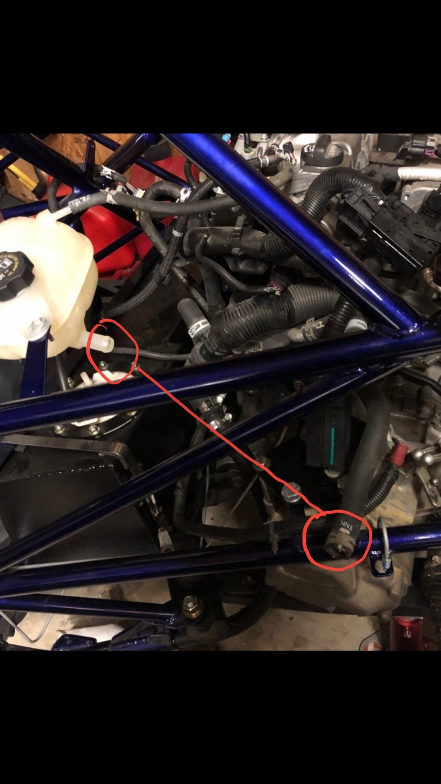

What hose do I use to connect to the coolant tank, and does it connect to the loose hose I have on the side?

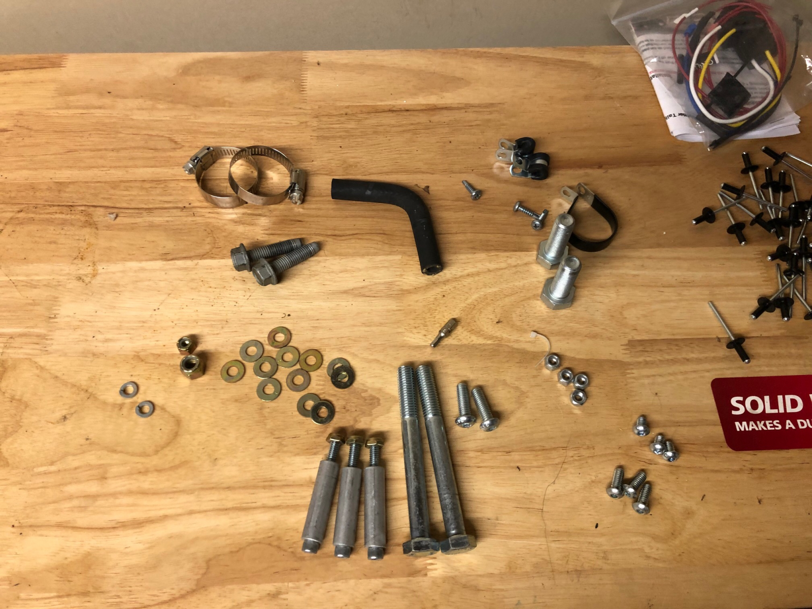

Can I get a clamp for radiator hose near alternator? Also some small hose clamps would be great too for vacuum hoses.

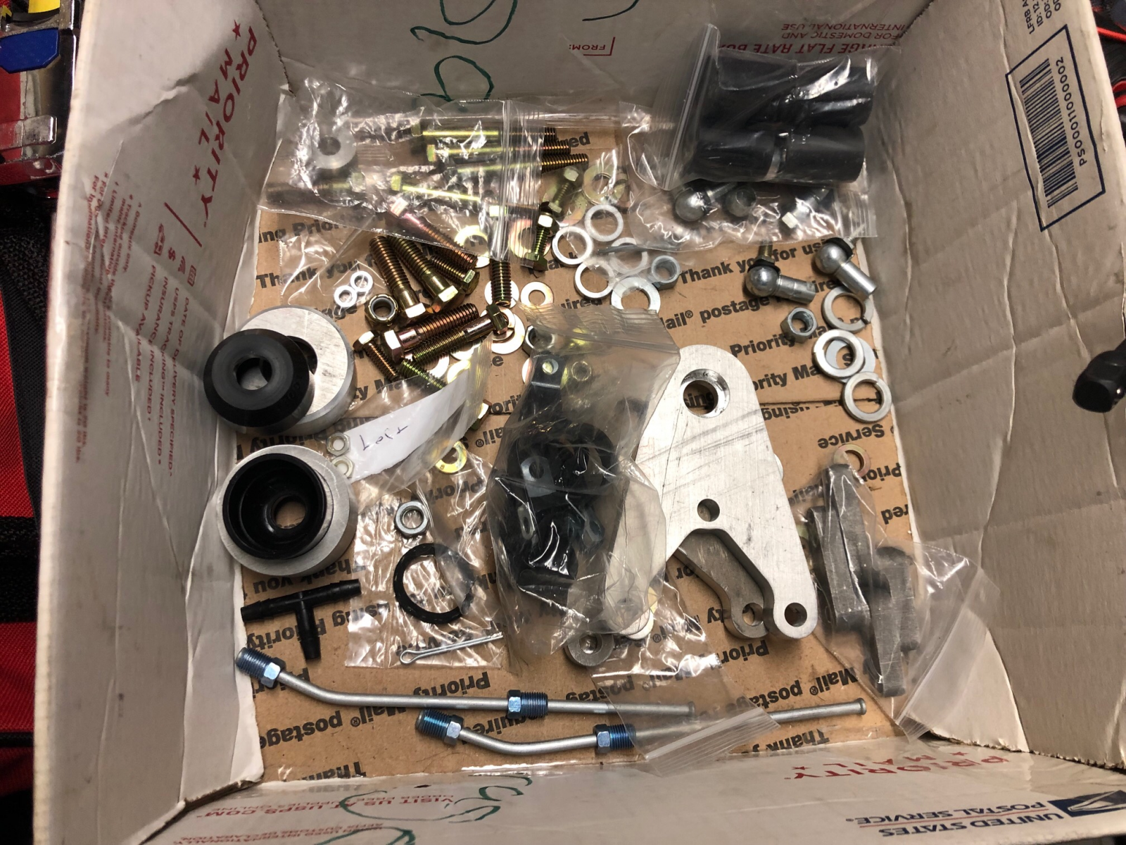

Can you tell me what the remaining stage 1/2 parts should attach to?
Can I order a set of solid motor mounts?

Let's see if I can answer some of your questions.
Fuel line - on the SS should I just reuse the stock one? The supplied line and connectors don’t fit the SS pump. Sorry, I do not know much about the T/C setup, we are supercharged.
Do I need to connect anything to the nipple on the tank? I believe you are referring to the vent line over by the filler neck. There should be a clear tubing with a T connector. Basically just vent it up to about the level of the filler neck and then back down to the ground.
Do I need to connect the other hose on the manifold to intake or should I just put on a filter and VTA? This has been debated. I used just a filter. Others say you should use the intake vacuum to evacuate any pressure. If you can, it might be best to connect this to the intake (before the turbo).
What hose do I use to connect the clutch MC to brake fluid tank? You should have a fuel line rated hose that came with the kit. Otherwise any fuel rated line, do not use any less.
Do I need a different bracket for mounting the shifter cables? Yes, your kit should have come with a custom bracket for mounting the cables on the transmission.
What hose do I use to connect to the coolant tank, and does it connect to the loose hose I have on the side? I can't be for sure where the loose hose is coming from, it should be coming from around the thermostat housing, yes this connects to the bottom of the tank.
Can I get a clamp for radiator hose near alternator? Also some small hose clamps would be great too for vacuum hoses. You might want to call them to ensure you get a response.
Can you tell me what the remaining stage 1/2 parts should attach to? Everything in the the last two pictures?! That's a lot of stuff. Mostly shifter items, strut mounts, extras. We will have to break that down a bit more.
Can I order a set of solid motor mounts? Yes, and recommended. Contact Adam. $125.
These were connected together. You will need to reconnect them with some 3/4 heater hose.

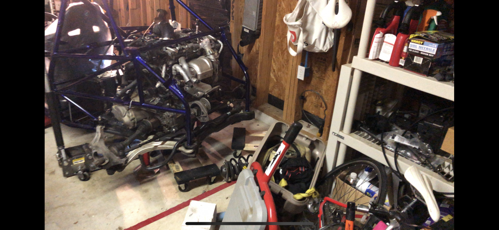

What happened to this build? I was looking forward to seeing the end product.
Ah life, I have several updates I need to post, the current state of the car is that it is completely build save for some wiring harness work. When I get a chance I'll post more pictures and I have a series of videos for my YouTube channel

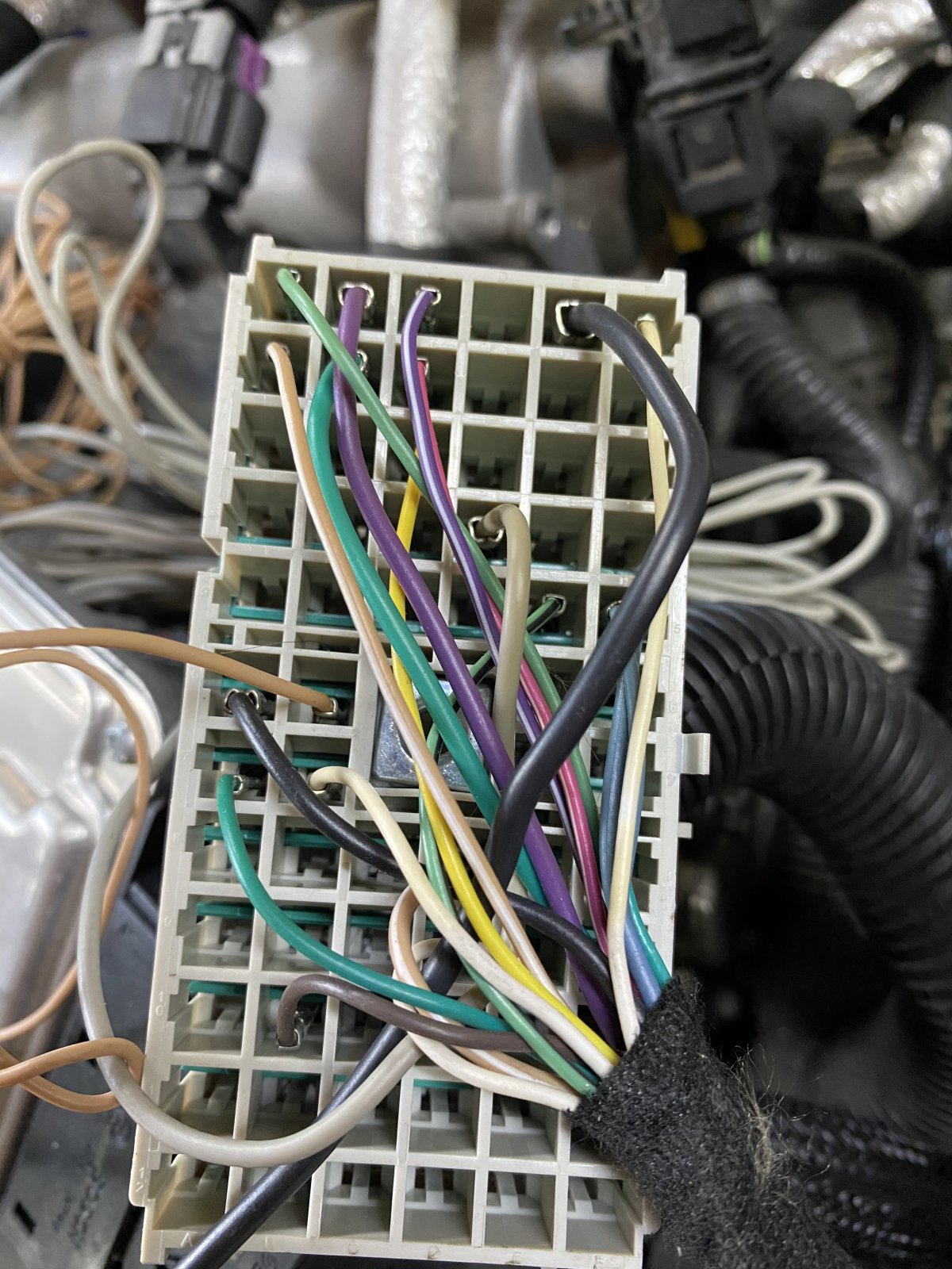

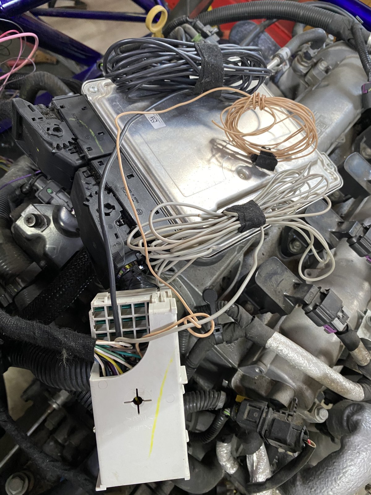

I am picking up this project in the hopes of getting it running soon. I am 95% done with the wiring.
It has been so long since it was worked on, there are quite a number of cut wires that are unlabeled.
This large grey fuse block is not listed in my wiring connector documents. Three wires are coming out of it which were cut and bundled, I’m having a hard time identifying them.
Large black wire. Pretty sure it’s a window glass defrost hookup? Spot E1 in block.
Spot B6-tan
Spot D4 grey
They were left long and bundled so I assume they’re needed somewhere.
Pin E1 is your rear defroster.
Pin B6 is your horn relay control wire. It was part of the horn switch circuitry on the steering wheel.
Pin D4 is the gray wire that runs to your fuel pump connector.
I have an '09 TC service manual. Let me know if you need any thing else identified.
