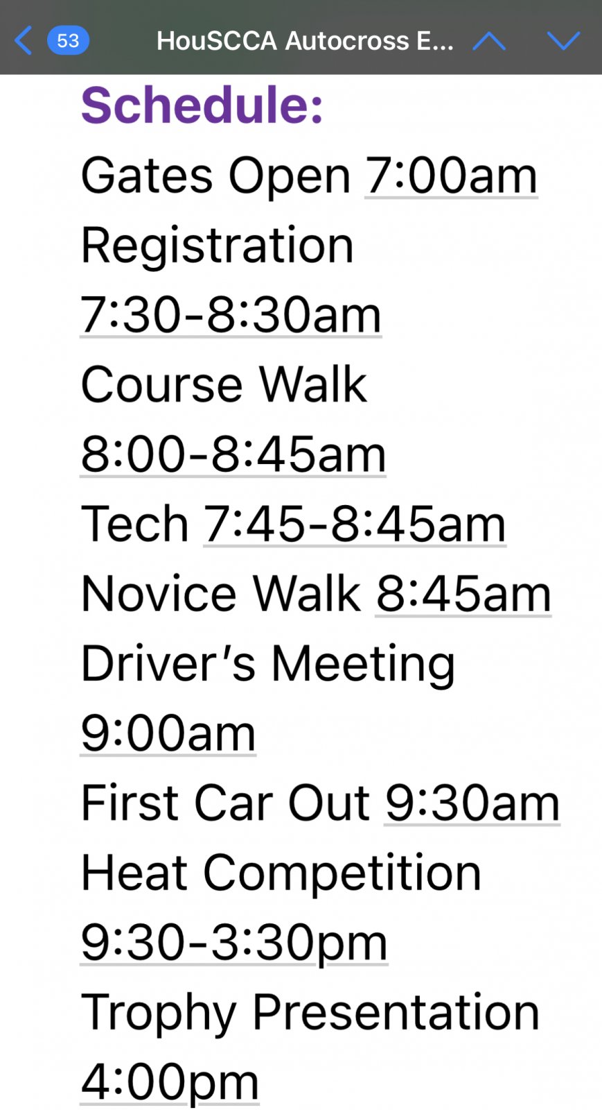

Autocross is next Sunday the 8th. There will be about 4 of us there and you can catch a ride with us if you want first hand experience with them.
Houston Police Academy
17000 Aldine Westfield
