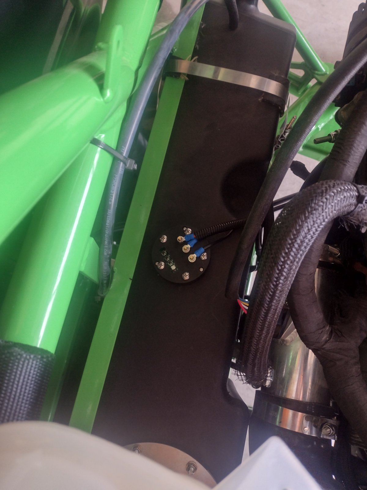

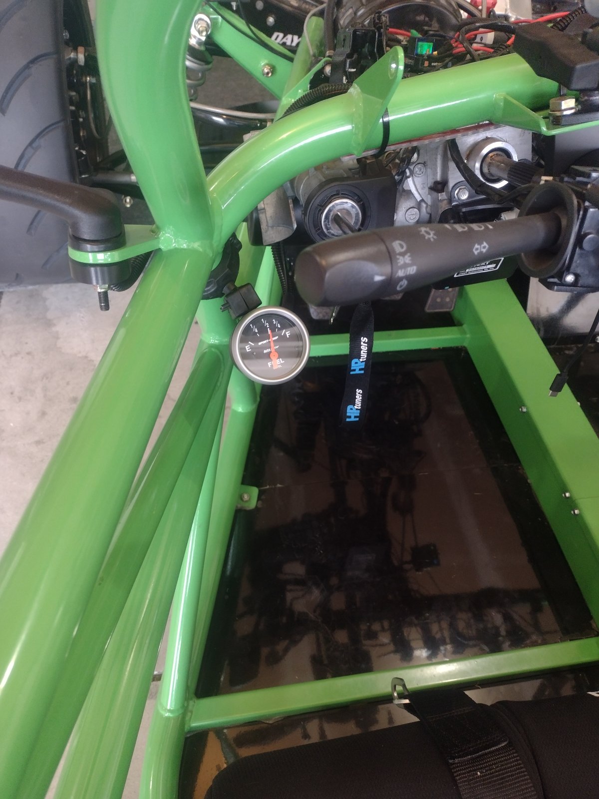

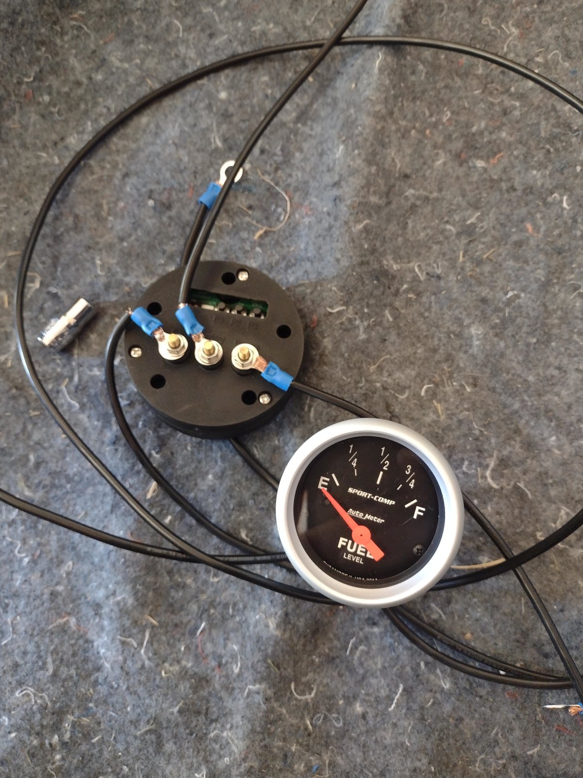

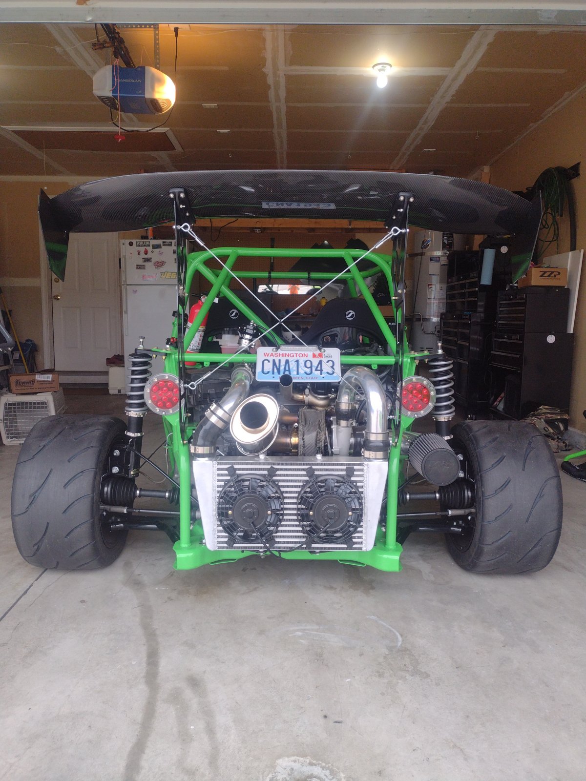

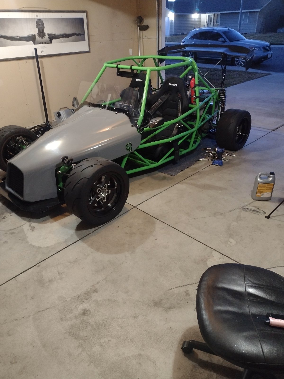

So today got the Holley Easy Level Sender wired up to my Autometer gauge, I added 5 gal on e47 seems to be accurate after calibration. Also was tired of seeing the wing slightly move around in the rear view so ran wire braces. Got the parts from Lowe's was only like $20.

Looking back at your old pictures, did you receive 2 cross braces with your wing upright kit? or buy an extra? I only received 1 but always thought there should have been 2.

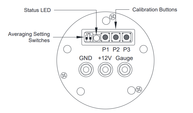

Do you know if there is a way to wire this Holley fuel sender into the stock fuel gauge? I'm trying to figure it out but the signal wire and the low reference wire in the stock connector is tripping me up. Any help would be greatly appreciated.
This document explains how to setup the fuel sender for your stock gauge.
To wire it, the Cobalt low reference wire connects to the GND on the fuel sender.
The Cobalt signal wire connects to Gauge.
You will need to supply 12V+ to the fuel sender. Find a spare pink wire, as those are ignition switched 12V+ wires.

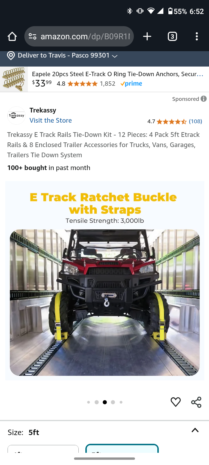

Ya was looking for how to tie down. Was looking at these e track setups. Just 4x 5ft sections 1 for each tire.

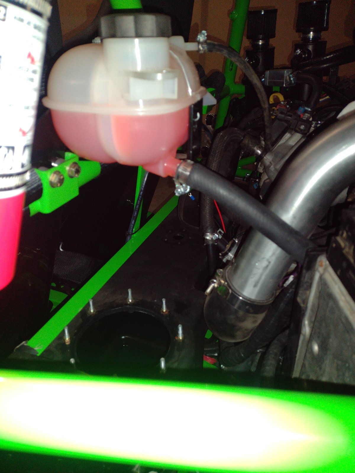

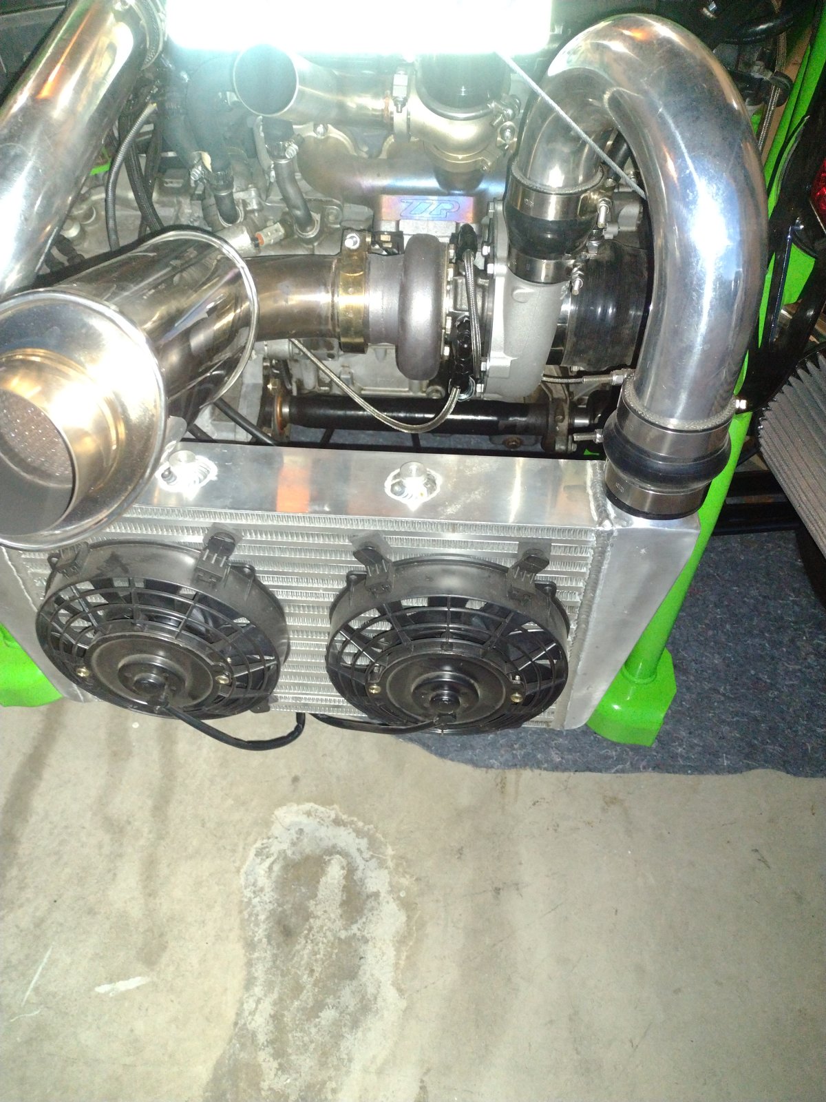

Got the new turbo on today and did a couple cruise logs, working with the tuner to throw some boost at it either tomorrow or Friday. Wasn't liking the Holley fuel level sender so going with a float again. Need to drill out the tank hole from 1" to 1.5" to accept the new float. Should be back on the road tomorrow.

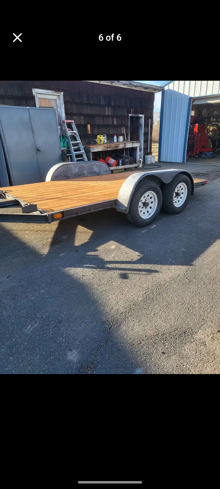

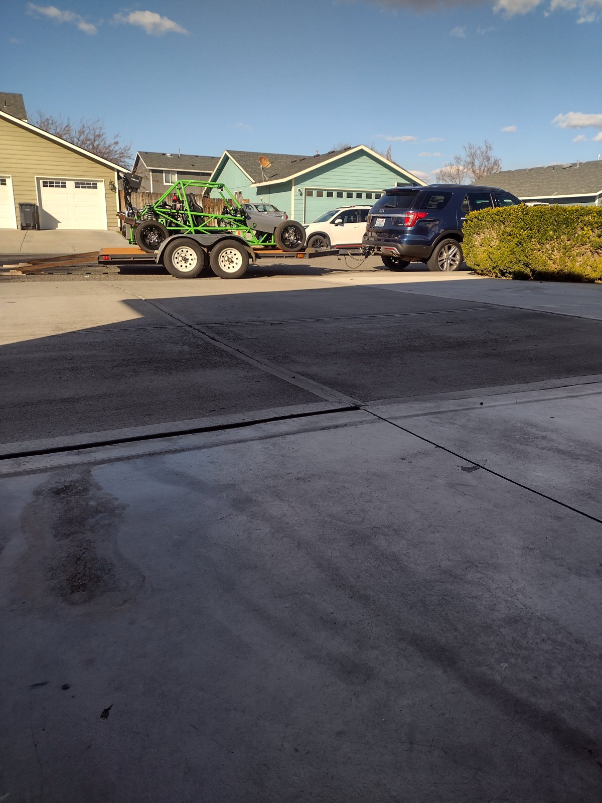

People who have trailered there cars this is a 7x12. Look adequate? I can move the trailer couple a bit but there is tongue weight just not a whole bunch. Trailer and car together are about 24-2500lb
