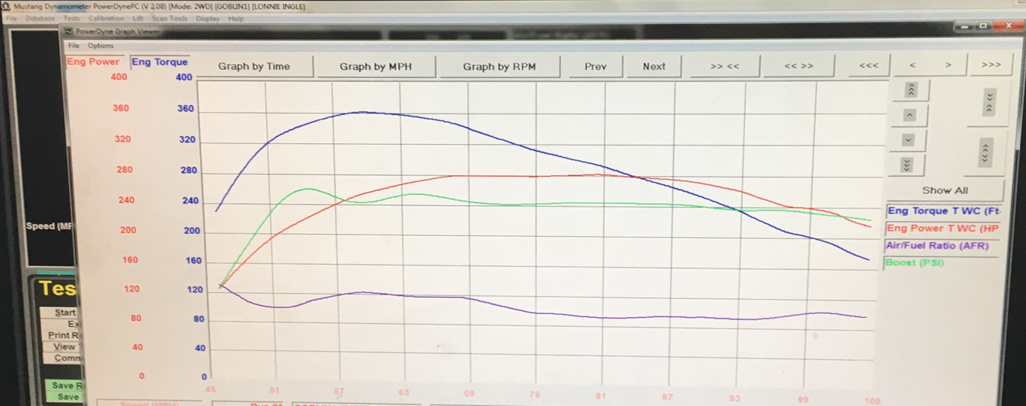

By boost threshold, I mean what is the engine speed at which you see positive manifold pressure with the stock K04?
I had my LNF dyno tuned at ZZ Performance. I see 24-25 lbs boost. It is all in at 3000RPM. I saw 360+ ft lbs at 3000RPM. A 5th gear pull will start boost @ 2000 - ramps up and gets crazy as the RPM increases. This is one of the reasons I need a new clutch - in a box in the garage. Soon to come.
Here is the link...
Here is an early run in the tuning... Engine speed (MPH) on x axis - see legend on middle right side.
