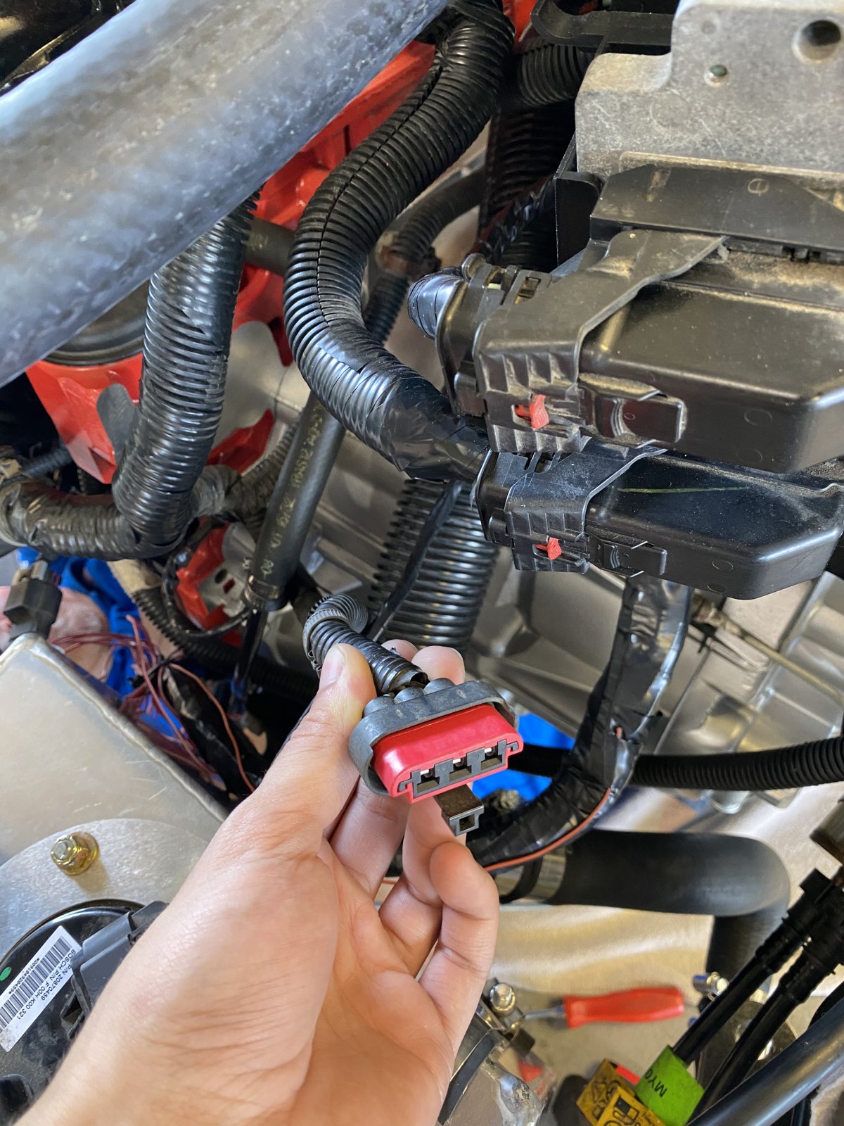

Anyone know where this plug on the engine harness goes? Or what it’s even for
24970
Looks like one of the radiator circuits. Check the wire color: if it's light blue, you'll extend it for the Goblin. If it's light gray, you can cut it out but many people seem to leave it intact for a spare.
Lndshrk Steve
Just working on removing un needed wires. If this gets extended, how? If not, I'll remove it. Because that plug he is holding is on the engine harness. Thanks.
