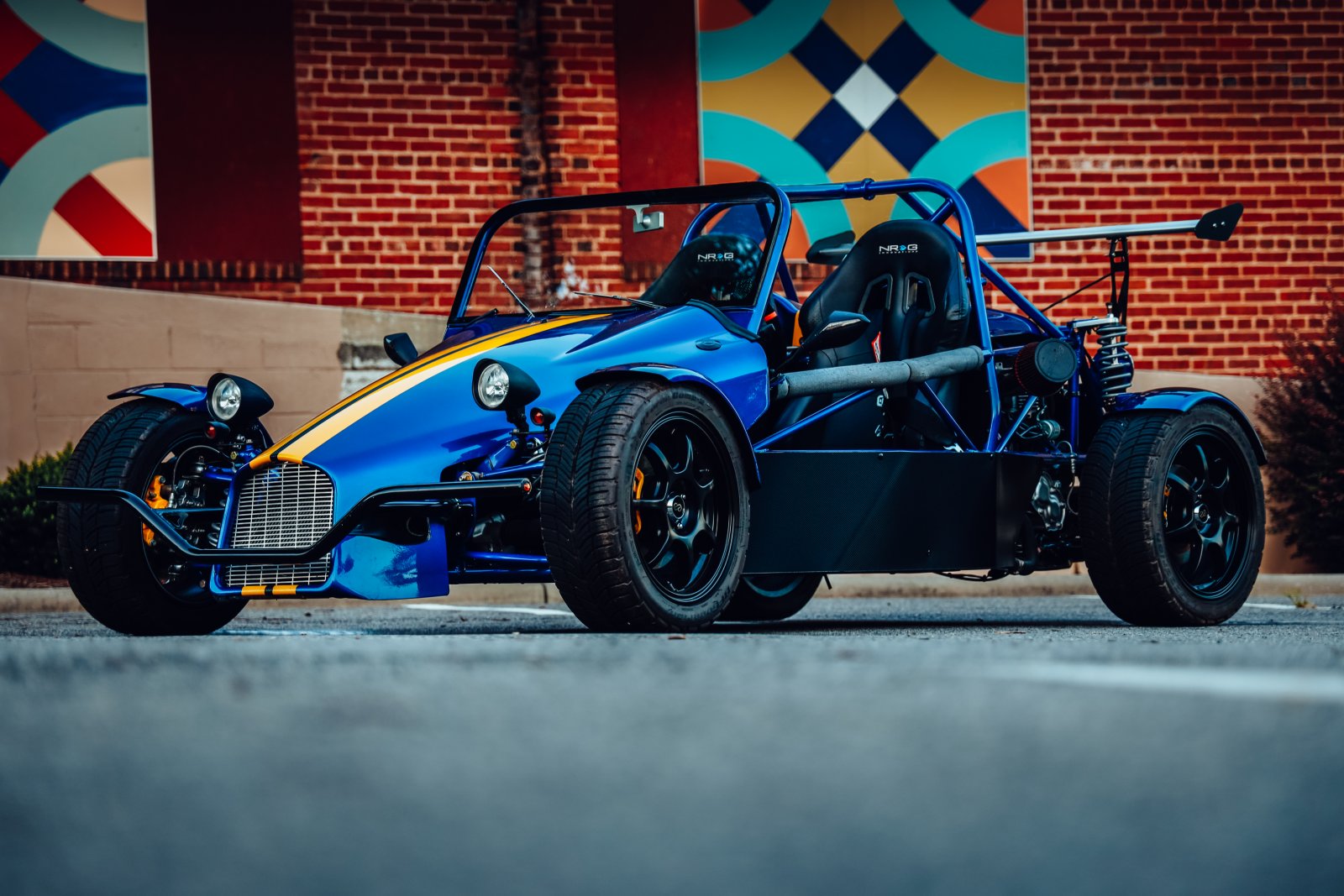

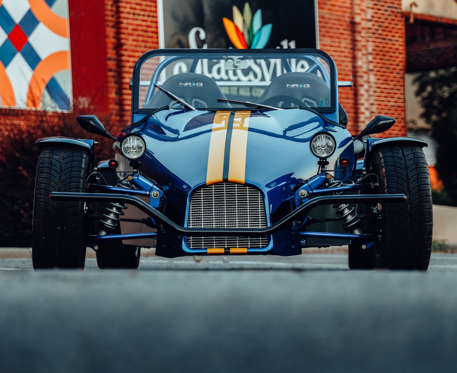

Pics attached are for prosperity. All in all, I love this thing. It is a ton of fun to drive and it creates a ton of conversation with all who see it.
