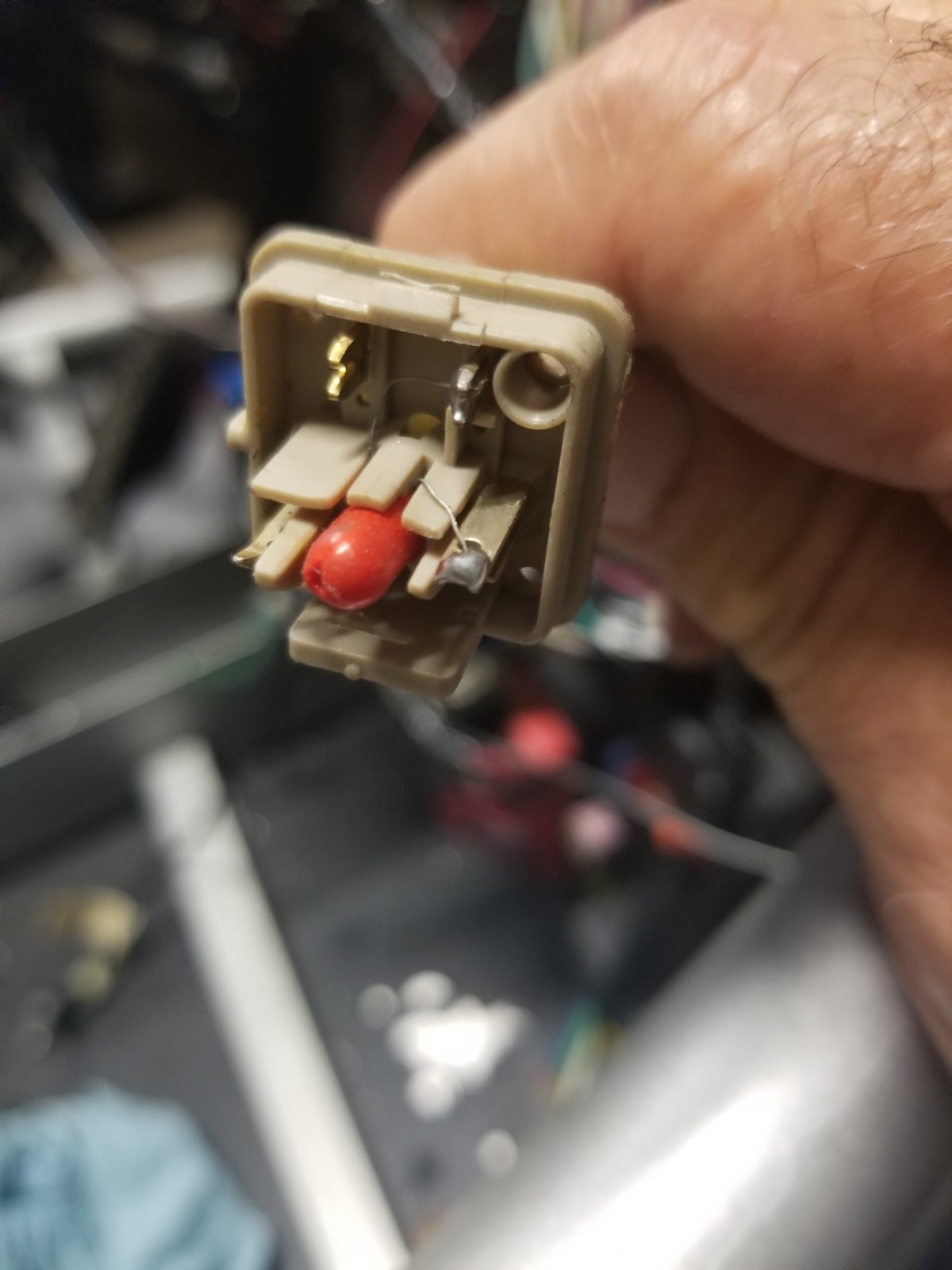

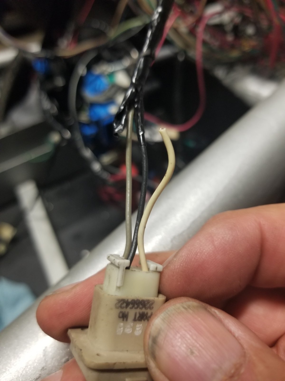

I have already wired the button panel. Now I find this thing in the dash harness area, that I marked hazzard switch. But it dosent look like a switch. Wire colors are gray, black, and white, which appears to be cut for some reason. Can anyone help me identify?

That is the hazard switch wiring. If you ground the white wire it turns on the hazards.
The gray is for lighting the button face.
Oldchevyguy
Ok, I figured it out. I removed the white wire and tied it to the other switch wires, but didnt deal with the rest of the wires going to the hazzard switch. Weeks later, going back to it I had a senior moment and forgot what I did. Thanks for the help!
