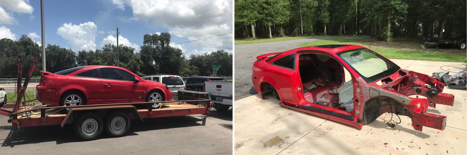

Paid $1,900 for my drivable 2006 SS with 5-speed and 2.4 NA about a year ago. Parted out a bunch and sold the high mileage engine. Wound up with about $1000 invested & luckily found a low mileage 2.4 NA for $400. I think there are still bargains out there if you look hard enough. I searched Google for "Cobalt SS for sale Florida" and found mine at a dealer 180 miles away. Good Luck.
