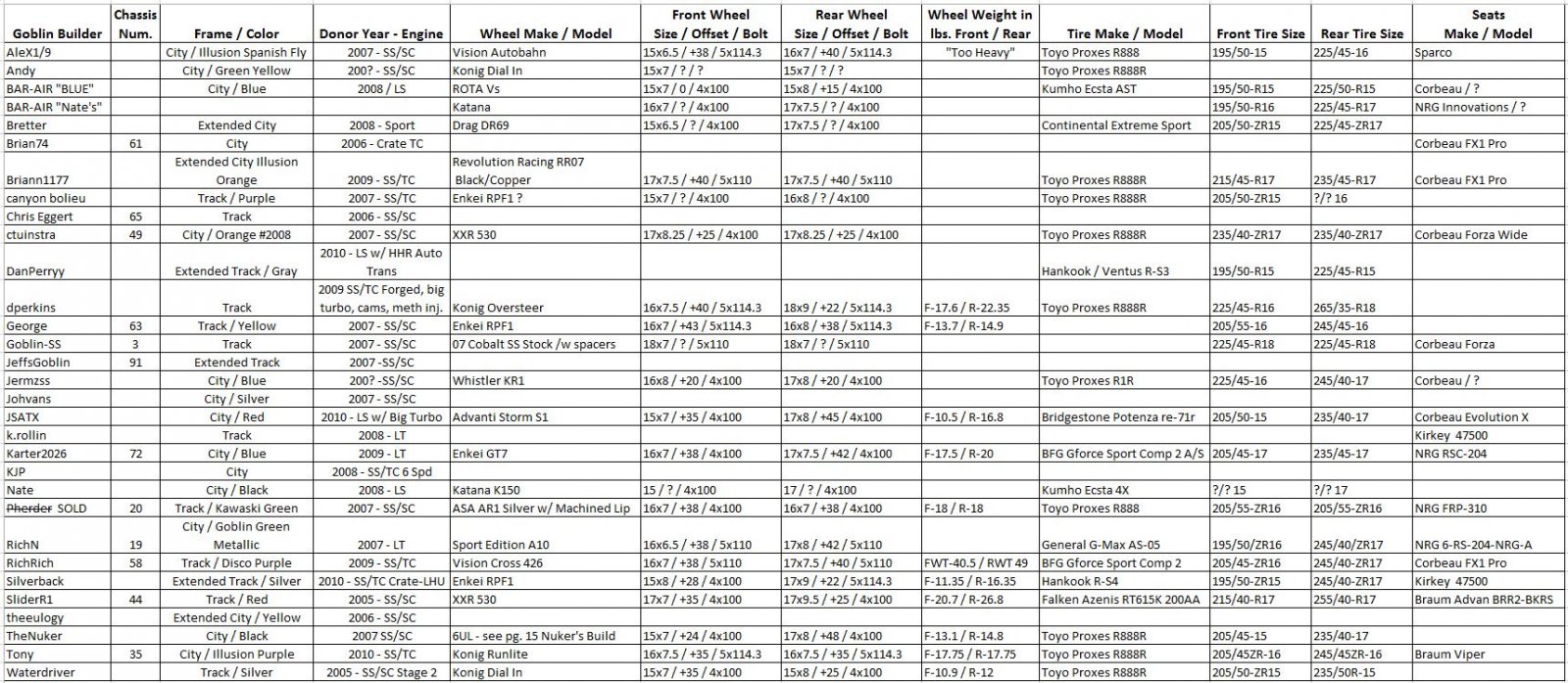

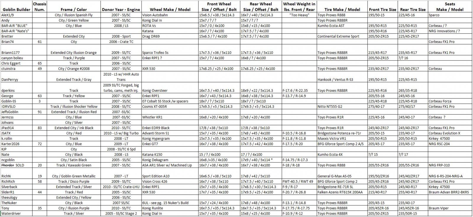

Wheels, Tires and Seats List
AleX1/9
Ordered wheels and tires, a slight change from the original plan...
Front: Enkei RPF1's 15x7-35 on 4x100 @ 9# w/ Bridgestone RE-71R SL 205/50R-15 @ 21# = 30#/corner 23.1" tall
Rear: Enkei RPF1's 17x8.5-30 on 5x114.3 @ 17# w/ Bridgestone RE-71R SL 245/40R-17 @ 23# = 40#/corner 24.7" tall
Total weight 140#
Nice choices! Looking forward to pics on the car
Silverback
There's been lots of travel recently, but consider me a self-imposed victim of "Perfect is the enemy of good." Major upgrades to my air compressor system and blast cabinet will be online next week. Progress on the Goblin should resume shortly.
k.rollin
Some updates to what's already there for mine.
Frame Type / Color: Track/Steel Gray Pearl
Wheel Make / Model: Konig Hypergram
Front Wheel - Size / Offset / Bolt Pattern: 15x7.5/ET35/4×100
Rear Wheel - Size / Offset / Bolt Pattern: 15x7.5/ ET35/4X100
Wheel Weight in lbs.: 11.8
Tire Make / Model: Maxxis Victra VR1
Front Tire Size: 205/50R15
Rear Tire Size: 205/50R15
JPas914
JPas914
Chassis #83
Ink Black Extended city frame
2010 SS Turbo
Enkei EDR9 (black)
Front/Rear wheel: 17x8 inch/+38mm offset/5x110mm
Tires; Toyo Proxes R1R
Front/Rear Tire: 245/40ZR17
Corbeau FX1 Pro seats
ncgoblin
ncgoblin
Street/satin black frame
2005 SS\SC
Konig Dekagram 17x9x275 40 offset + 1" spacer 5x110 to 5x114 pattern (REAR)
Konig Dekagram 16x8x215 4x100 35 offset (REAR)
Tires: Toyo Proxes 88R
Corbeau FX1 Pro Seats
Disclaimer: Wheels take 90 days to build and ship
IDRVSLO
IDRVSLO
Race/Standard/Illusion Shocker Yellow
2008 SS/TC
Cosmis XT-005R 17x9.5 5mm offset
Nitto NT555 G2 275/40/17
