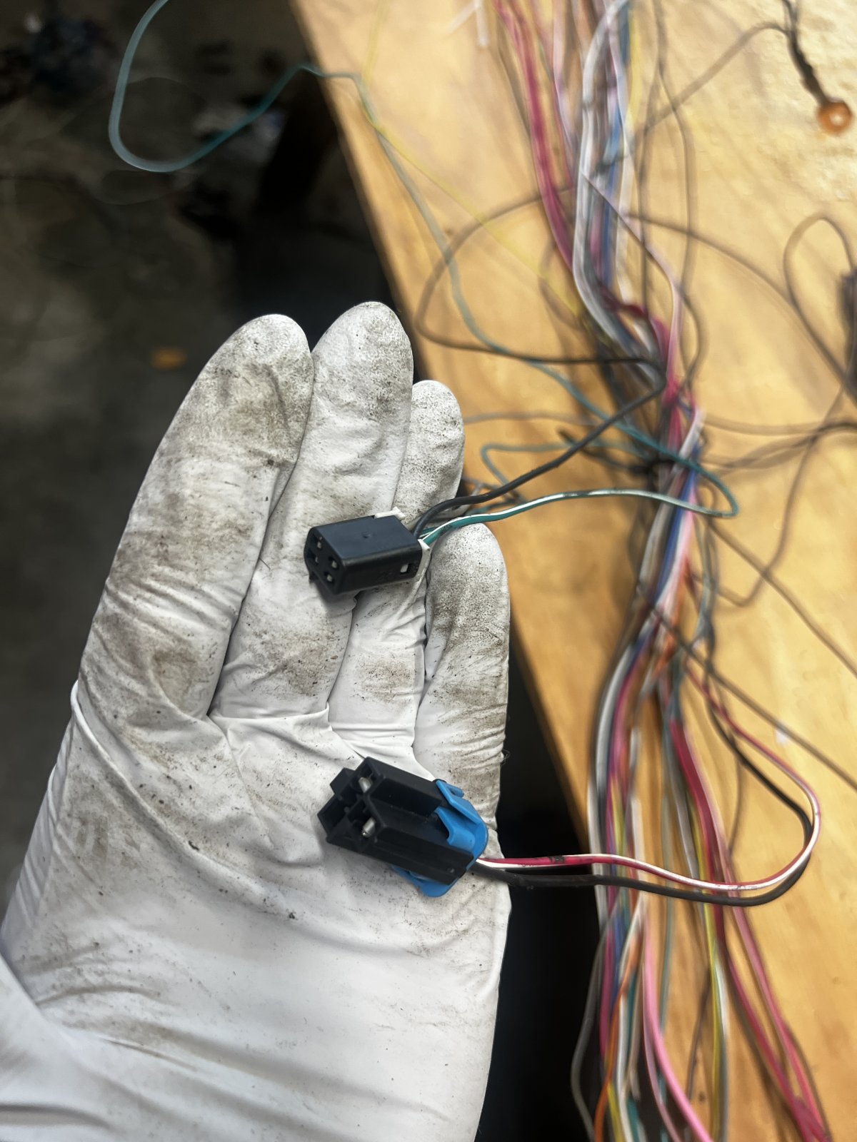

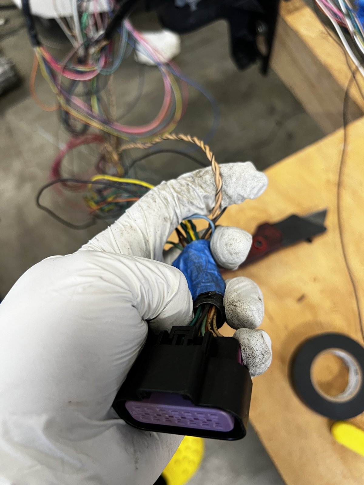

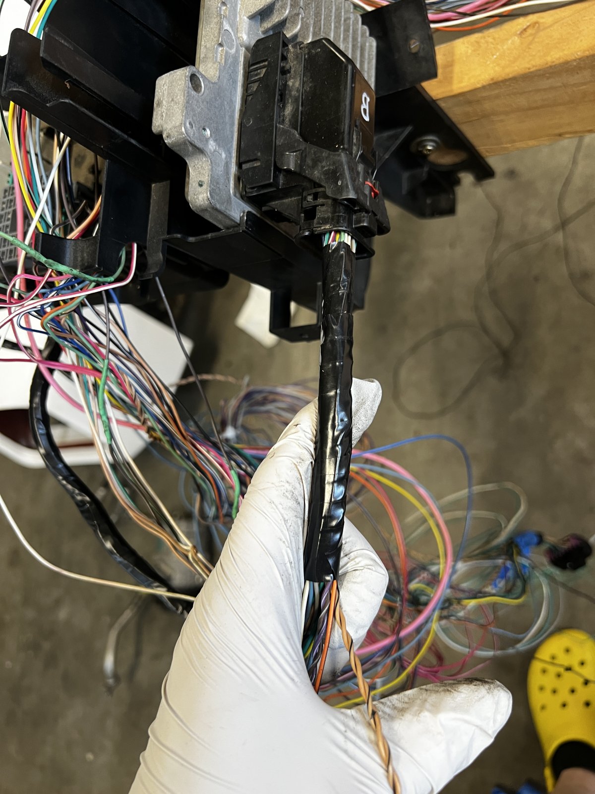

You can keep it for now. Later on in the combining videos you will tag and cut out the body connector and splice those body wires to the dash wires to the ECM. The twisted pair is the network cable running between all the computers in the system. If it does not make the complete path, the car will not run.

Thanks appreciate it!
