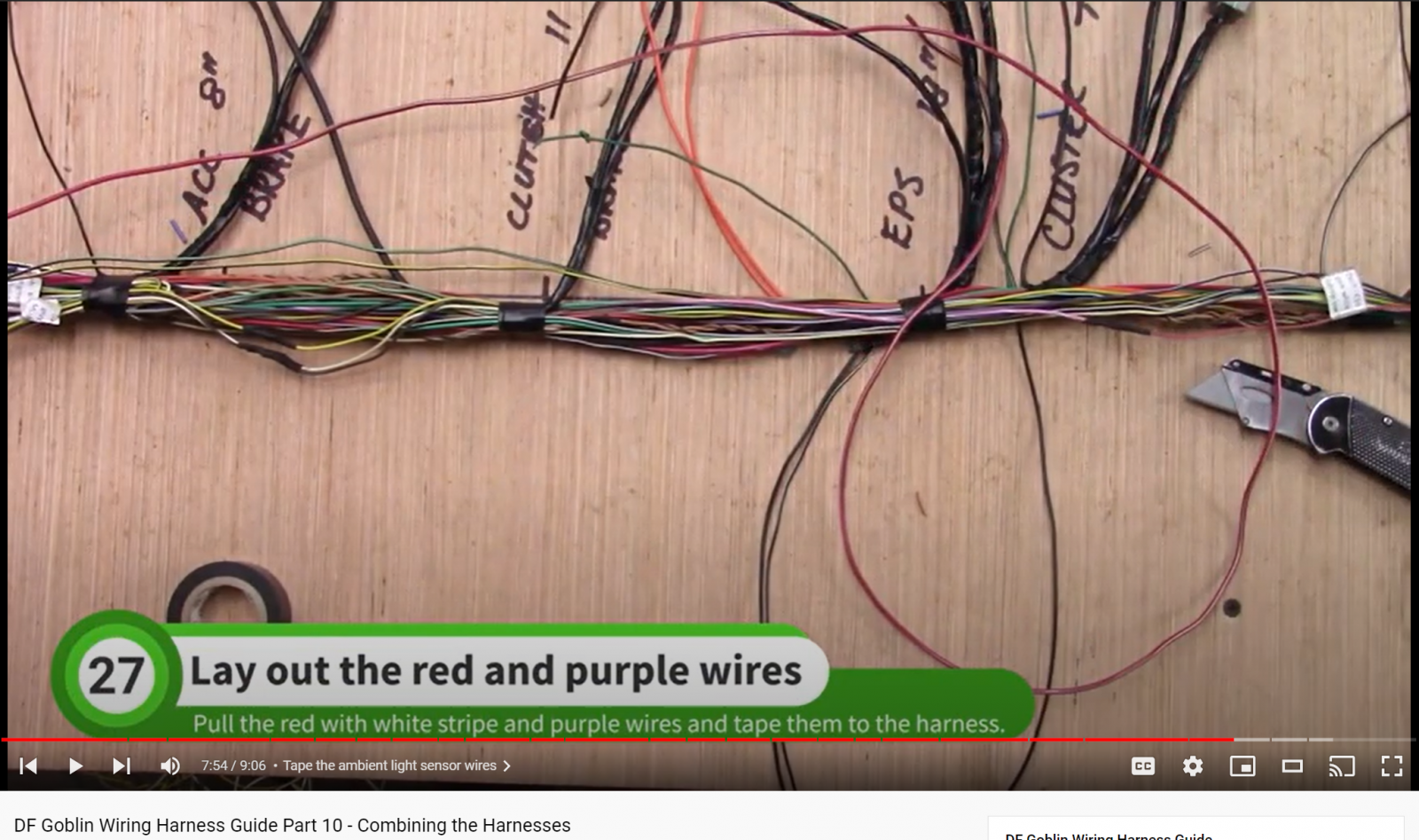

I'm working my way through the last few wiring harness videos have a question regarding some wires mentioned in video 10.
What is the purple wire and the red with white stripe wire mentioned @ 7:54?

Is the purple wire the fog light wire?

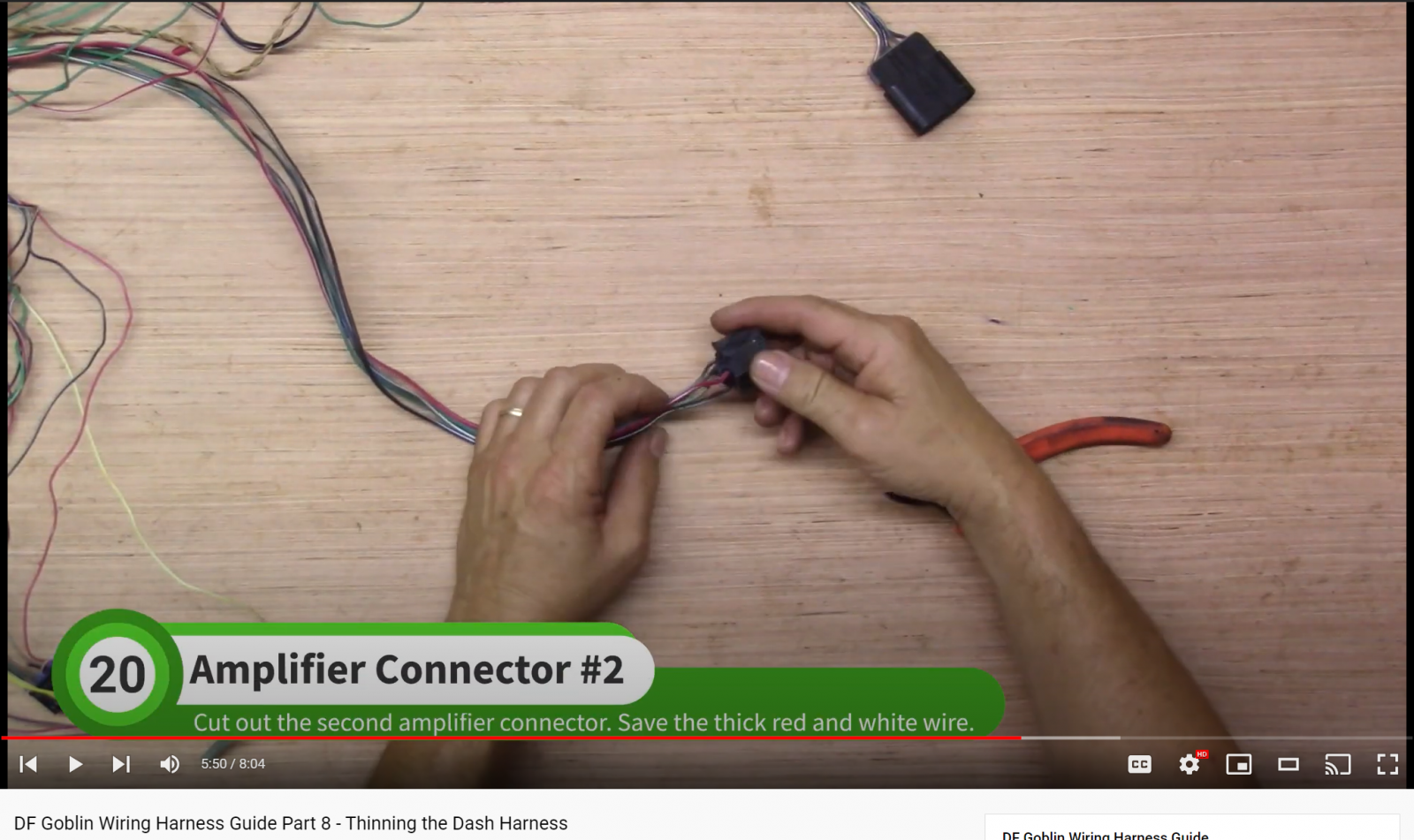

Is the red with white stripe wire the same as the saved AMP wire from video 8 @ 5:49?

that red w/white tracer is an “extra” circuit, in case you want to add something later. If
I remember correctly.
not remembering the purple wire, other than intercooler fan, but you won’t have that.
Annoyingly, since the purple wire is in fact the foglight circuit, it gets turned off if you put your high beams on. Just wanted to mention that because the first time I found out I can't run high beams AND my "a/c" at the same time, I was super upset! Haha
