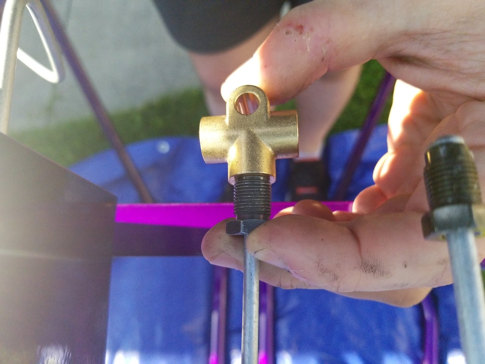

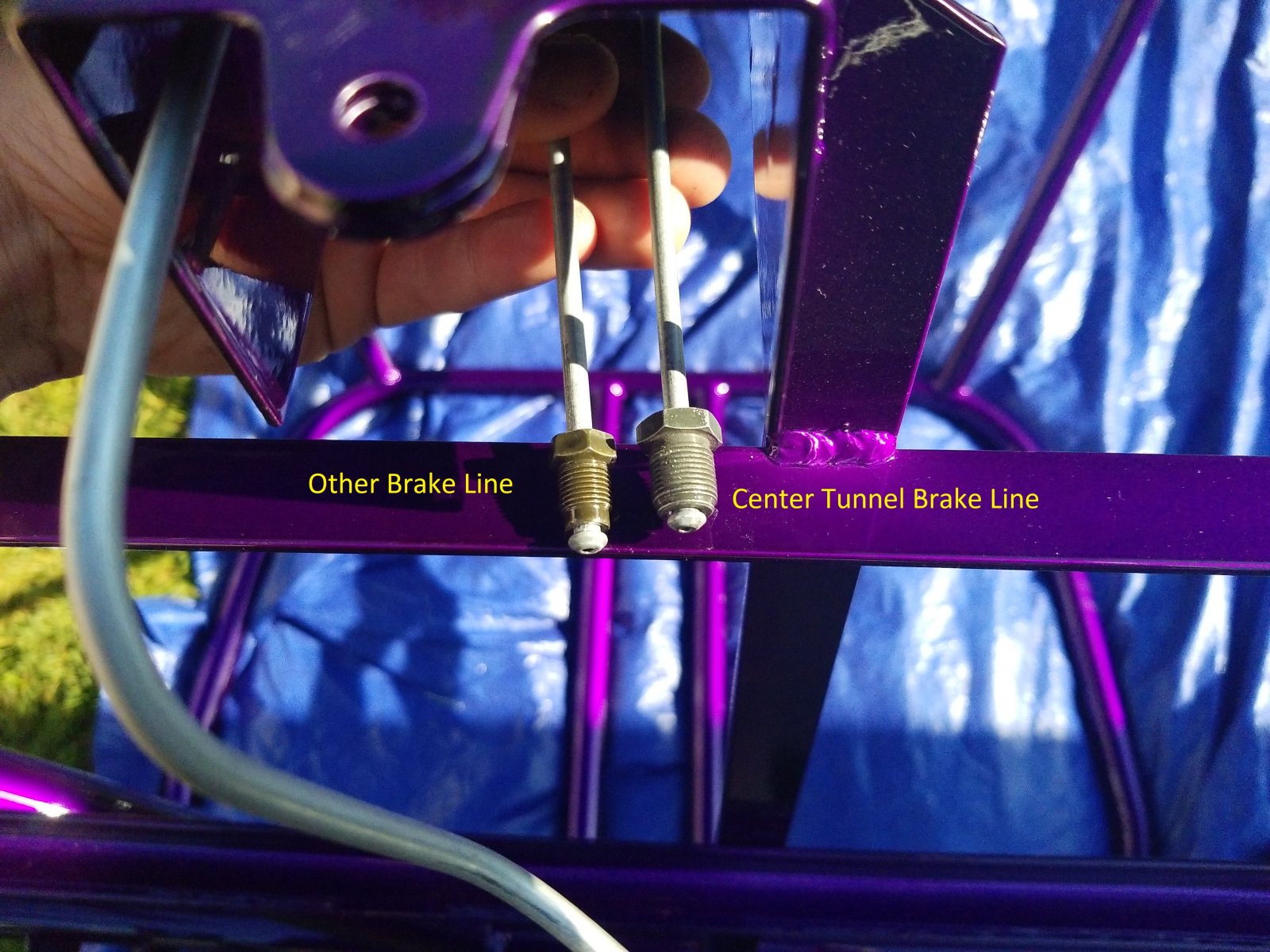

I think my center tunnel brake line may have come with the wrong flare nut size on the rear end.
When I try to attach one of the brass tees, it will not even start into any of the holes.

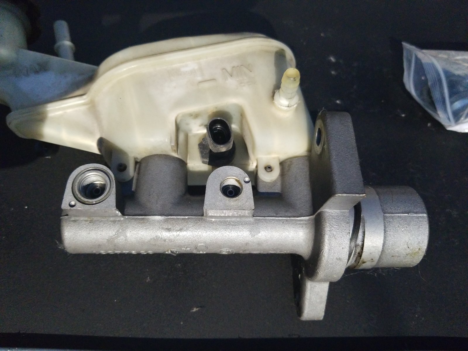

Both of the flare nuts on the long brake line fit the larger, left port on the brake master cylinder, not the smaller right side port. (I know they don't both go in the MC, this is just comparison)

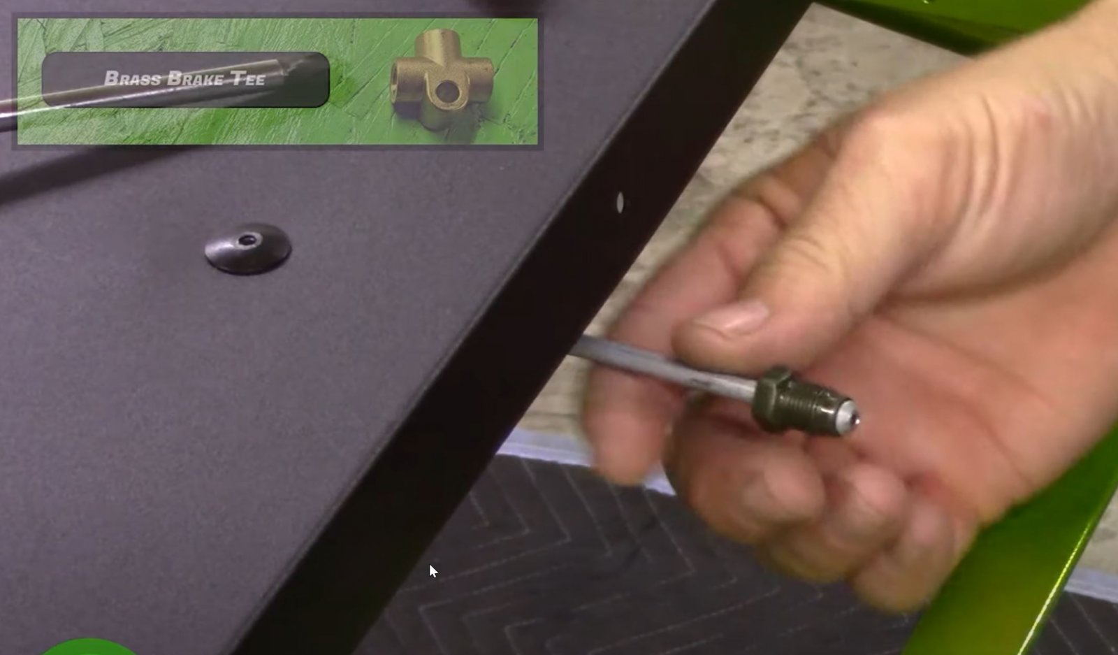

As far as I can tell, the two brass tees have all identical threaded holes and this larger nut will not fit any of them. At 1:17 of "Installing the Rear Brake Lines and Clutch Line", I got this screenshot which looks more like the smaller nut.
